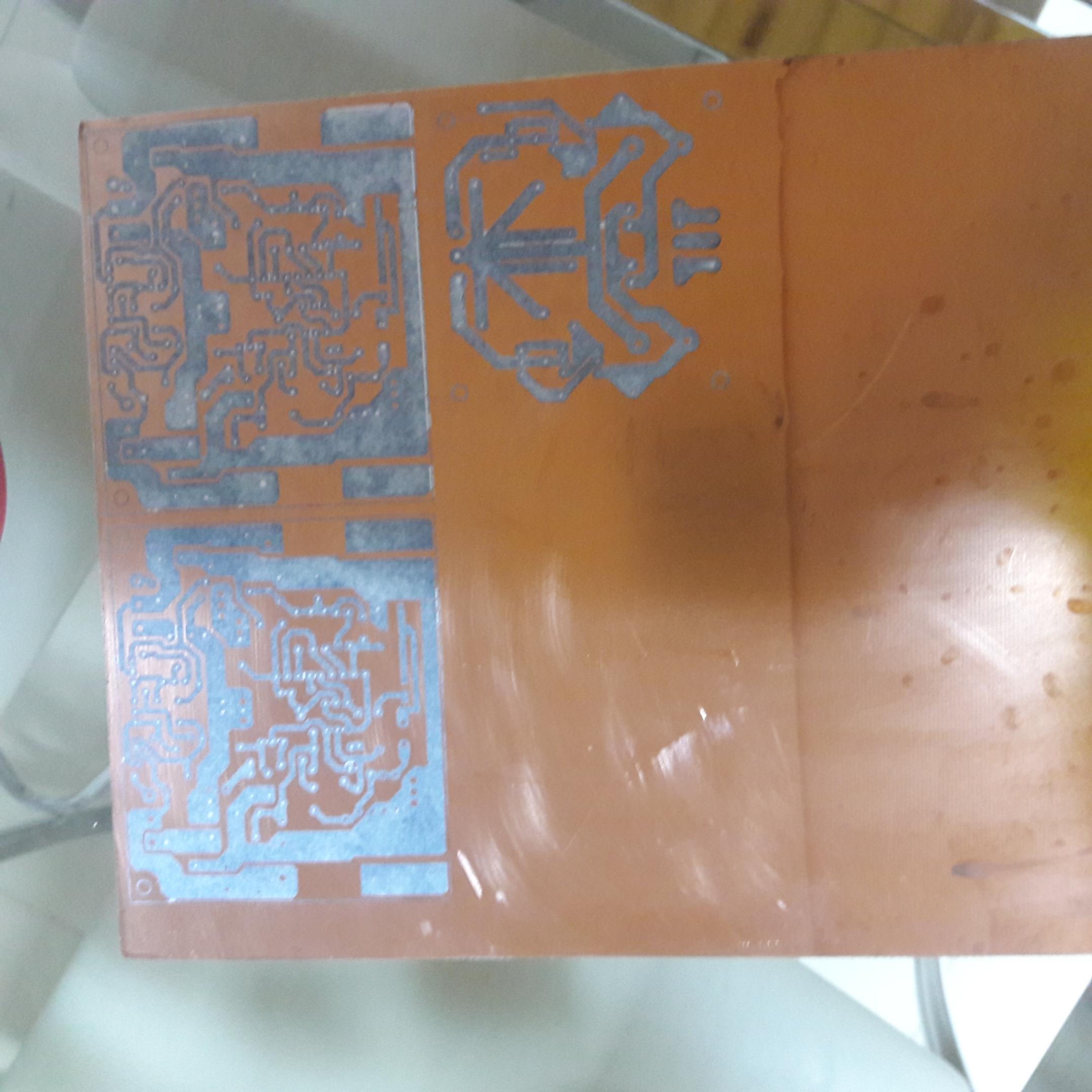

something i made just now.
wow - nice - looks like an X Wing fighter 🙂
ok, all the best for your build... please post your build...

hey guys here is the first picture of the board I hope all goes smoothly
It's great, congratulations

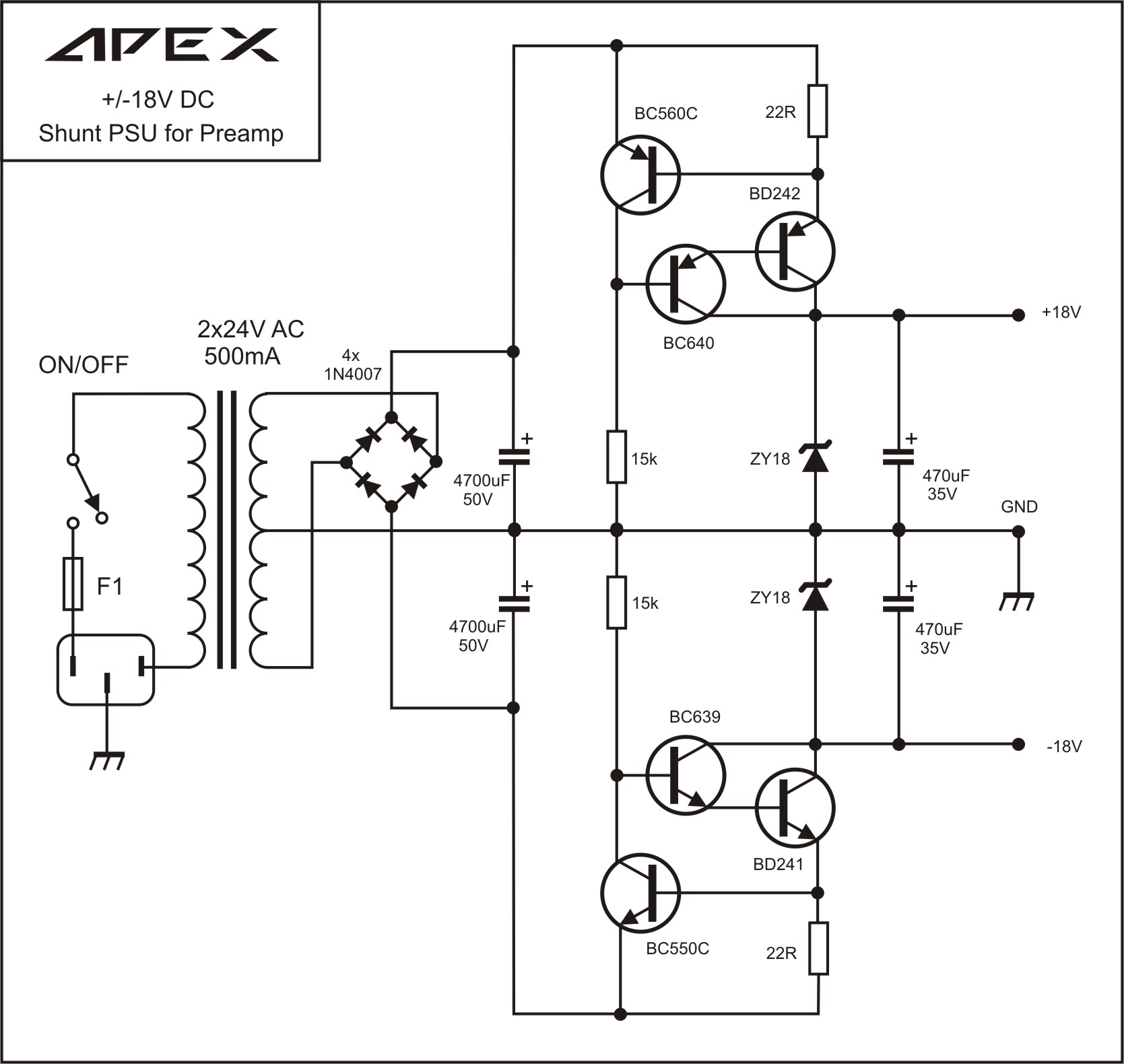

greetings which powersupply has better performance the
schematic in #256 or the schematic wich i have uploaded
i use the schematic with BF256 B mosfet
warm regards
Andrew

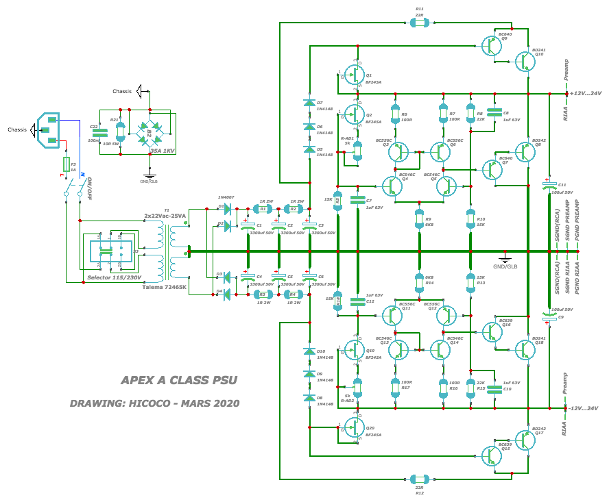

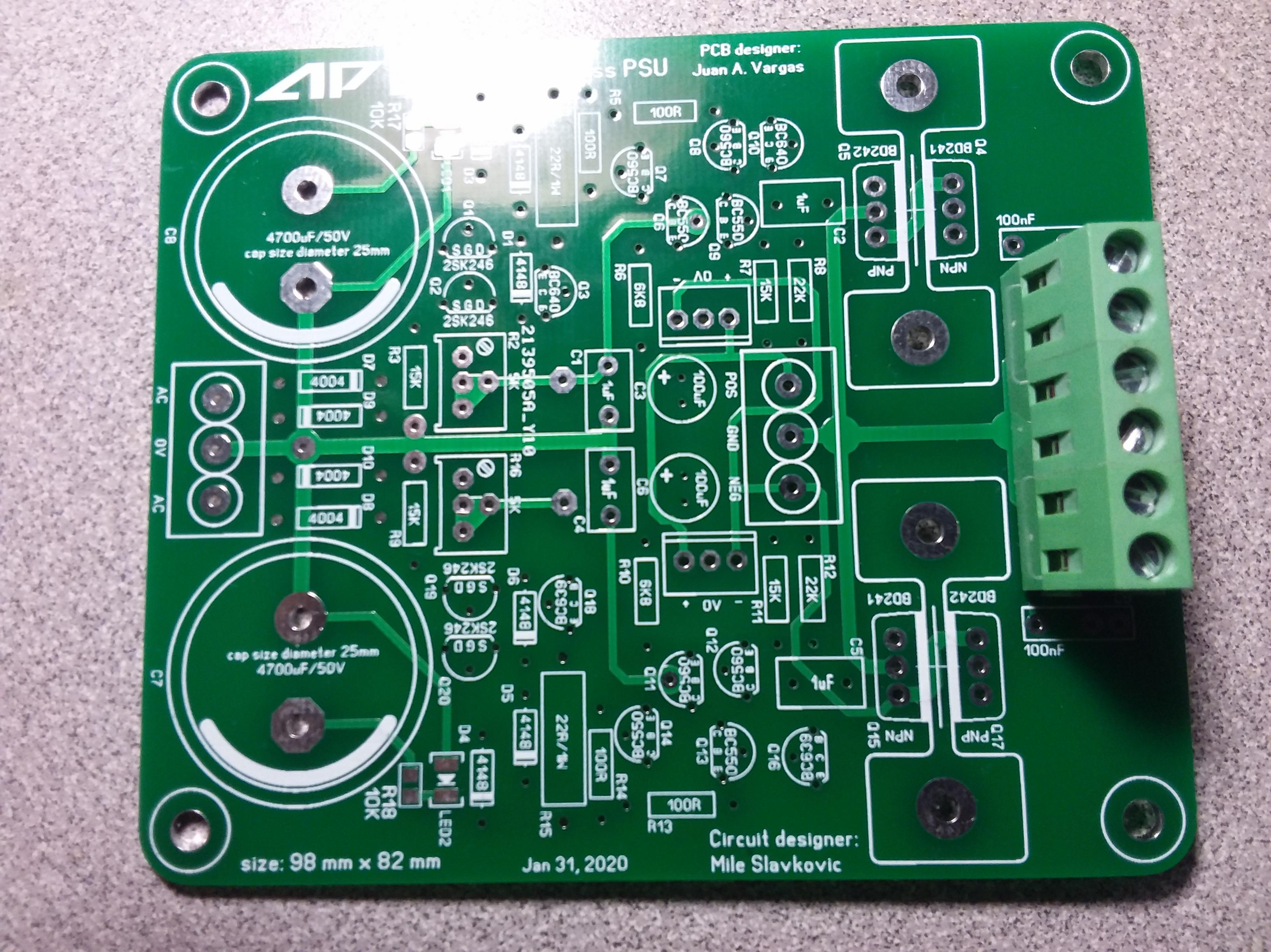

APEX design A Class PSU with AC filtering, utilizing a CRCRC filter for my Preamp and RIAA.
Simple Shunt PSU for Preamps
Hi.can share pcb for this psu.i need regulate to 15v for my preamp?

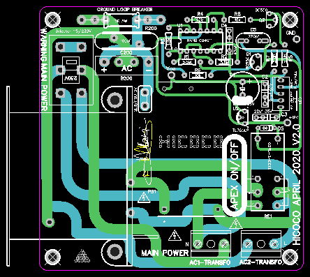

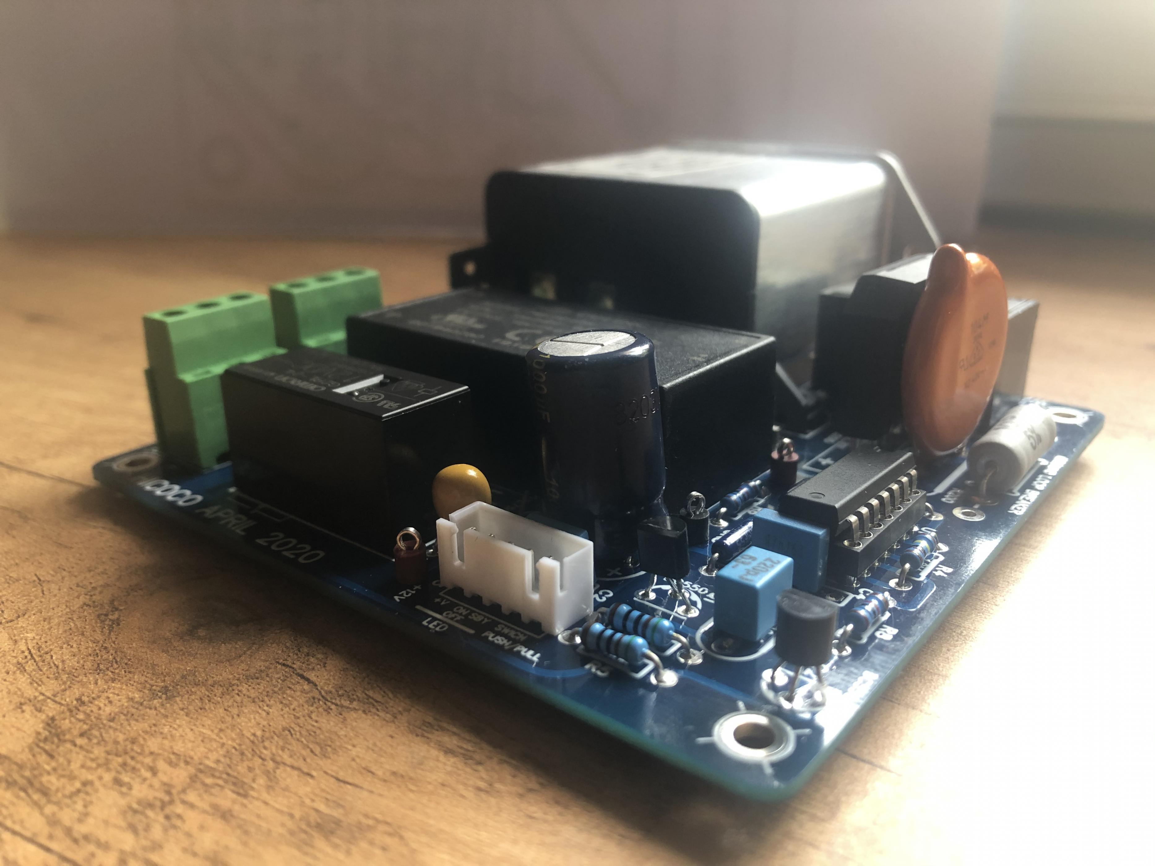

APEX START/STOP
Just a little bit adapted and modified. Board Have been tested. Gerber attached.

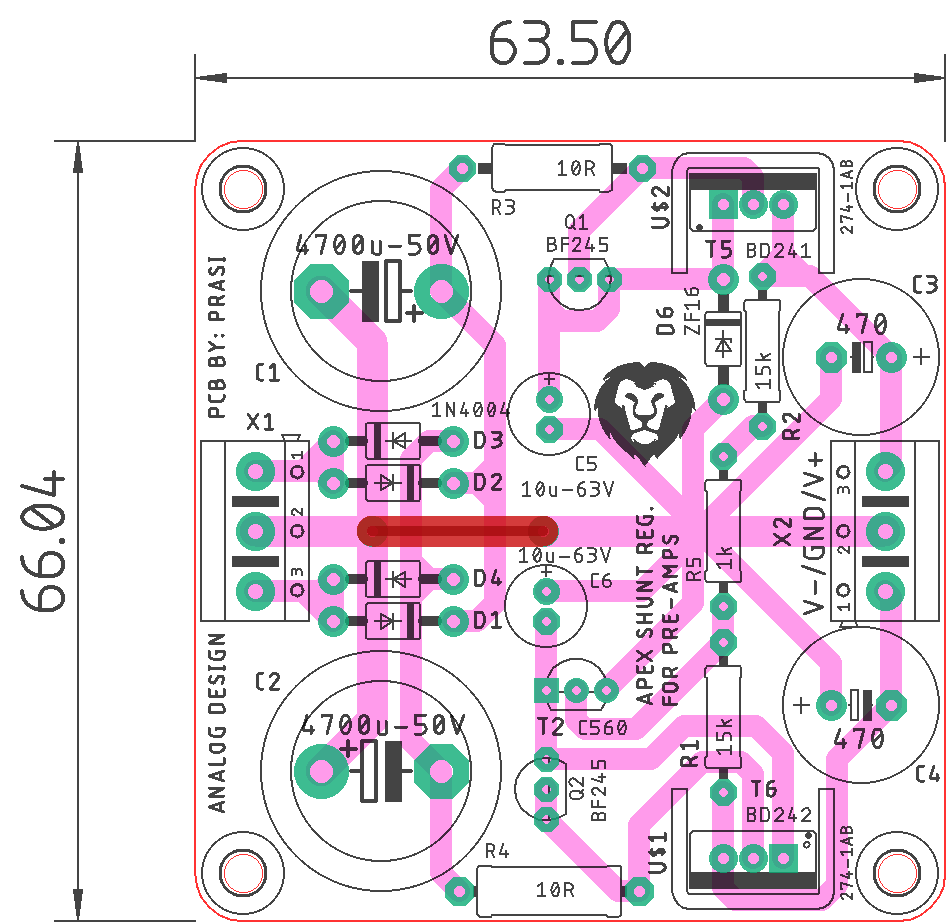

here you go. they are mirrors. is it ok?
PS main caps are 20 mm dia and output caps are 13mm dia.

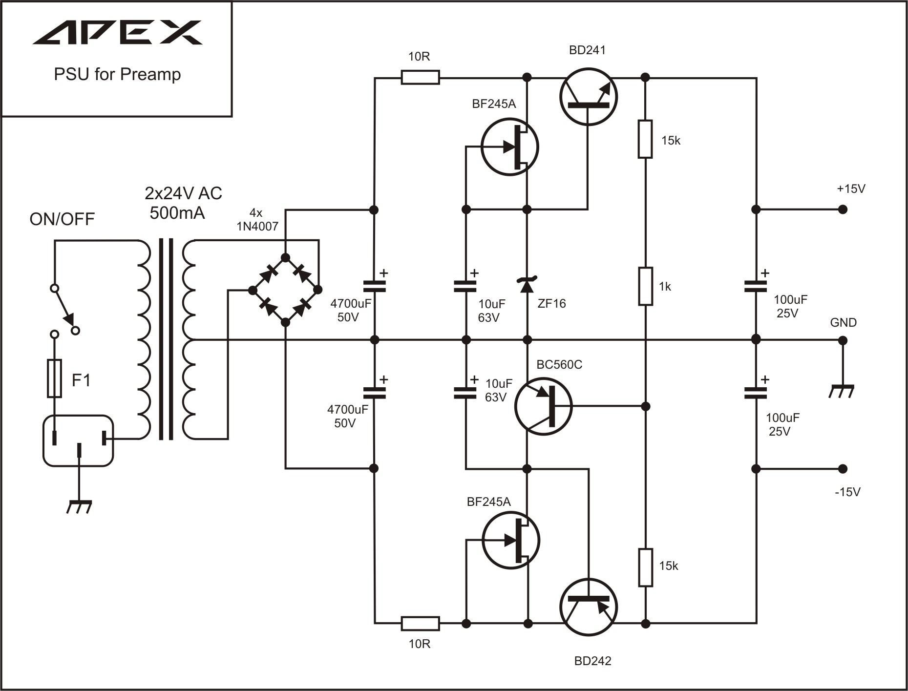

Hello, I set up the PSU with 1N4745 zener because I need + -15v, but this is in 17.5v and 17v. What should be changed to have + -15v?
The supply is + -24vac.
Use 1N4744
Use 1N4744
Thanks, made the replacement, PSU with 15.3v and 15.7v, working perfectly.

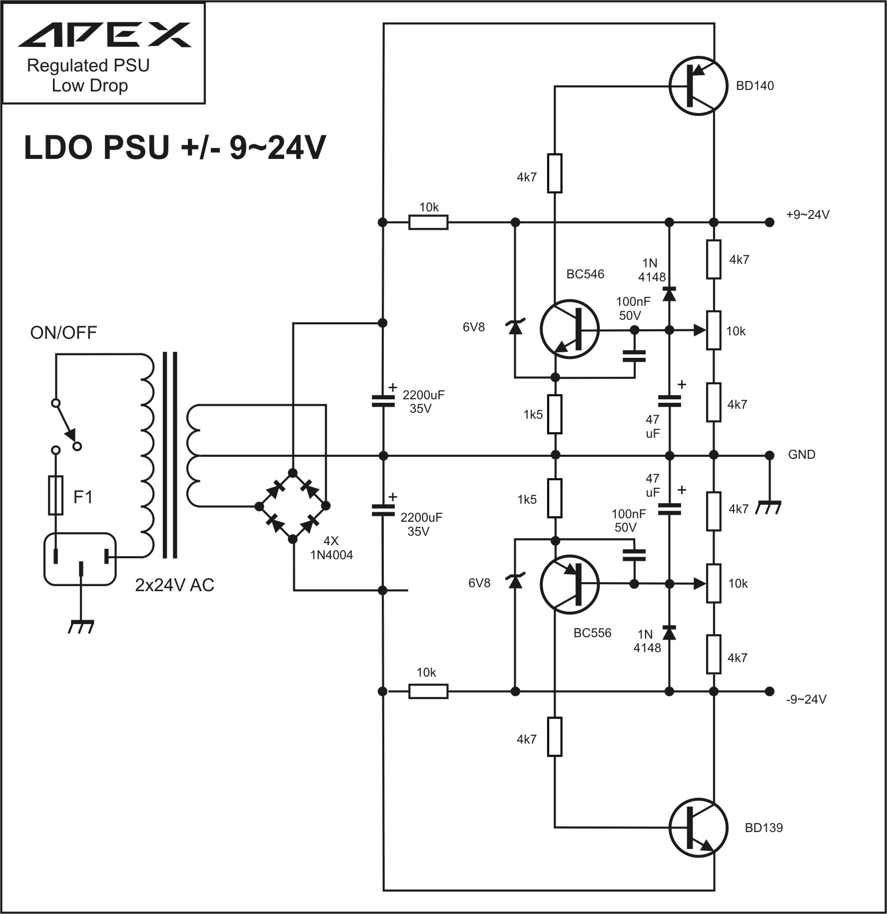

LDO Regulated PSU
Hello. I made the source of low power. I managed to adjust it without any problems. it is very stable. the question is: what current can it generate? I put the ammeter and it did not indicate more than 16mA. I expect it to be 100-200 mA.
You can load it with 500mA maximum current, 16mA is standby current.
