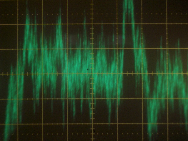

Zener string de-noised by means of a cheap cap ..
I spent some hours on the weekend to build a camera fixture for use with
my oscilloscope, because what is more instructive than a good example?
Test bed is the shunt regulator of an expensive 10 - tube preamp made in
Germany. I built this some time ago to replace the original series regulator
which is overly complicated and prone to failure.
The shunt reg is of the two transistor type: a simple LED referenced current
source of about 80mA and an amplified Zener similar to what you can see in
post 158 here (but no Darlington).
The "Zener" is a string of six 1,3W ZPY51 and ZPY56 with a parallel axial lead
cap 22μF made by Philips - this is about the worst electrolytic cap you can find.
Input voltage is about 380V depending on mains, regulated voltage is 344V.
The first picture shows output noise with Zener cap. Please ignore the charge
current peaks, I suspect some poor ground layout of the preamp is the reason.
The second picture is without this cap. Note the difference. Overload lamp lights.
Scope is Tektronix 7403N with 7A22 high sensitivity amp and 7B53A time base
set to 2ms/div. Vertical sensitivity is 100μV/div. in both cases, single ended input
of this differential amp being used.
HF band limit of the 7A22 was set to 30kHz and high pass to 1kHz in order to
reduce the current pulse noise, the Zener noise with and without cap is affected
by this setting in proportion.
In my view the improvement is impressive. I can show the same with regulators
of low output voltage (made in a similar way) on request.

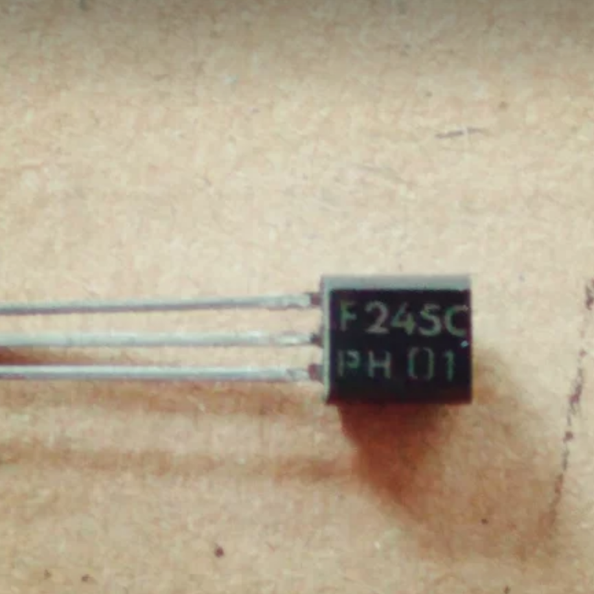

I am so sorry,this is my mistake,
Pcb not mirror when i do transfer toner.
I will post next post
You can use any kind of n-channel JFET
hi can you give me the working pcb pdf for this psu?
