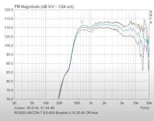

I'm pretty sure that is the case. Playing advocate of the devil here: I'm still wondering what the advantages are (except for price), vs. a compression driver that can also do 500 Hz in the same horn. Distortion? @xrk971 mentions this here: https://www.diyaudio.com/community/...lti-way-point-source-horn.285030/post-4584662 .From my limited experience the sb65 with a simple 3d printed adaptor into a easily available 1.4" cd horn is a great place to start.

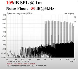

-50 at 105 dB? The SB Audience 65CND-T can do that as well:
Note that below 1 kHz is missing, I wonder why 🙄? I'm pretty sure the CD will inevitably go louder, but who needs that in a home setup?
Also note though, that this driver is 6.5x as expensive as it's little SB Acoustics sister 😉 Most definitely the tiny SB driver and horn is an exceedingly amazing combination! The € 394 saved can easily be used to finance a 3D printer.

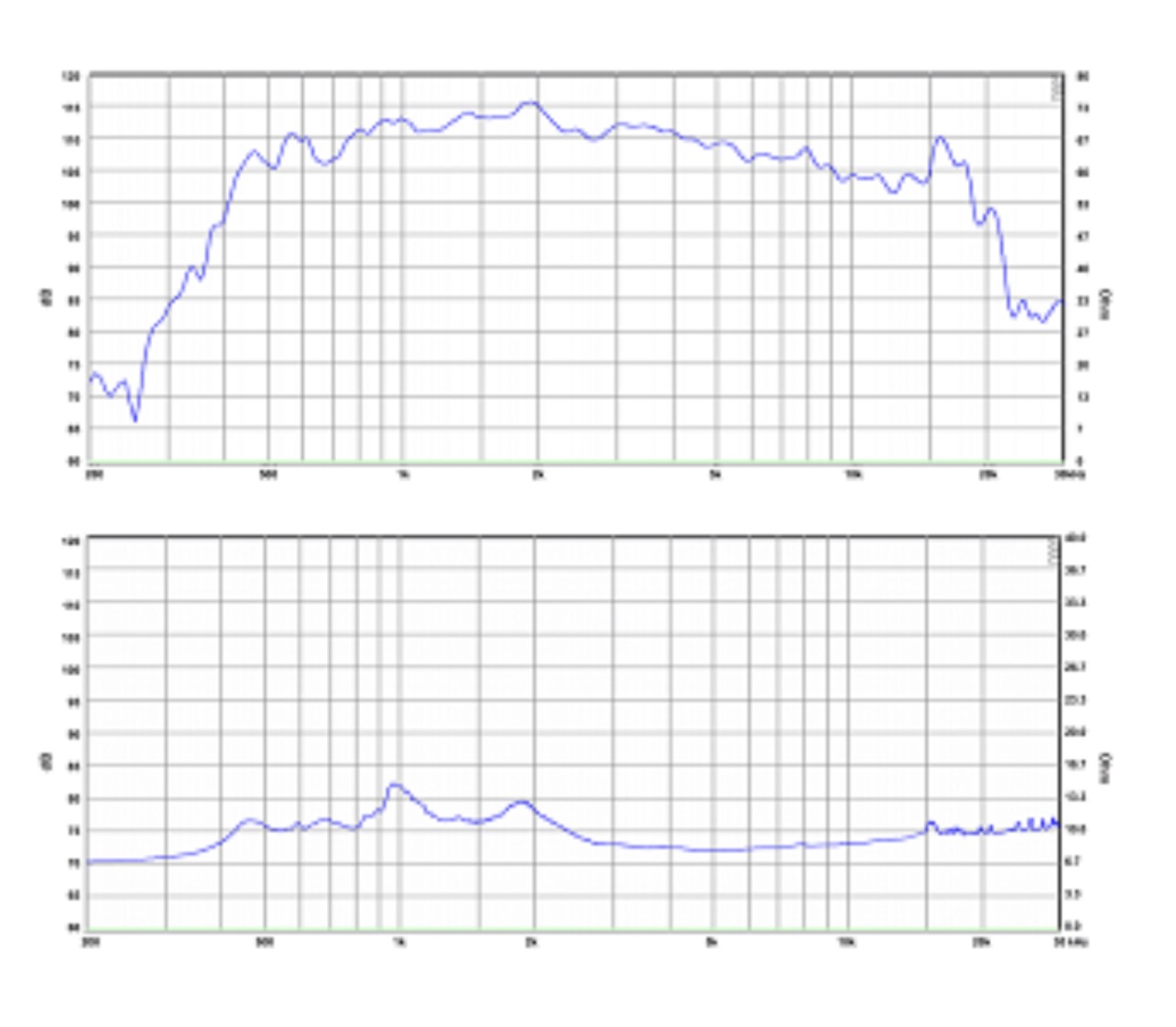

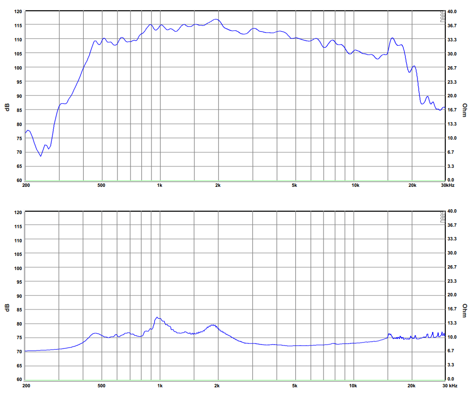

SB Audience CD specs are here:
https://www.madisoundspeakerstore.c...audience-rosso-65cd-t-compression-driver-1.4/
Screenshot of frequency response and impedance or THD plot - I cannot tell as units are illegible:
Resolution is not that great but does look like it goes to 500Hz.
I think it might be asking a CD membrane to be pushing too much air at those frequencies.
Possibly. Remember that the horn used is the SB H280, and that the response that @CooperH shows here is very similar. I think what we see is mostly due to the horn. In a different horn it looks much smoother:I think it might be asking a CD membrane to be pushing too much air at those frequencies.

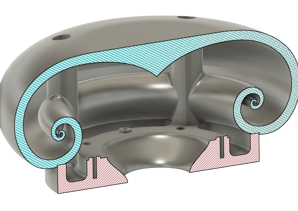

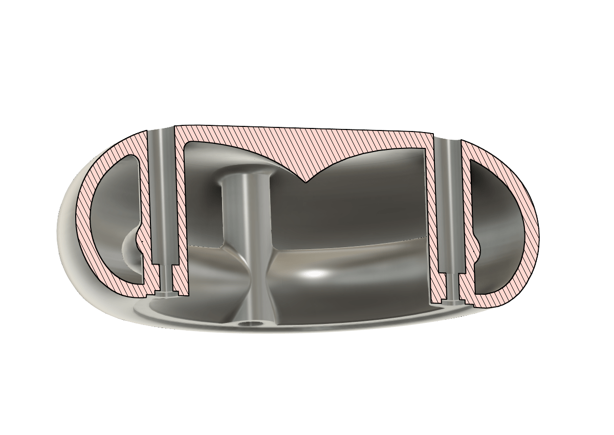

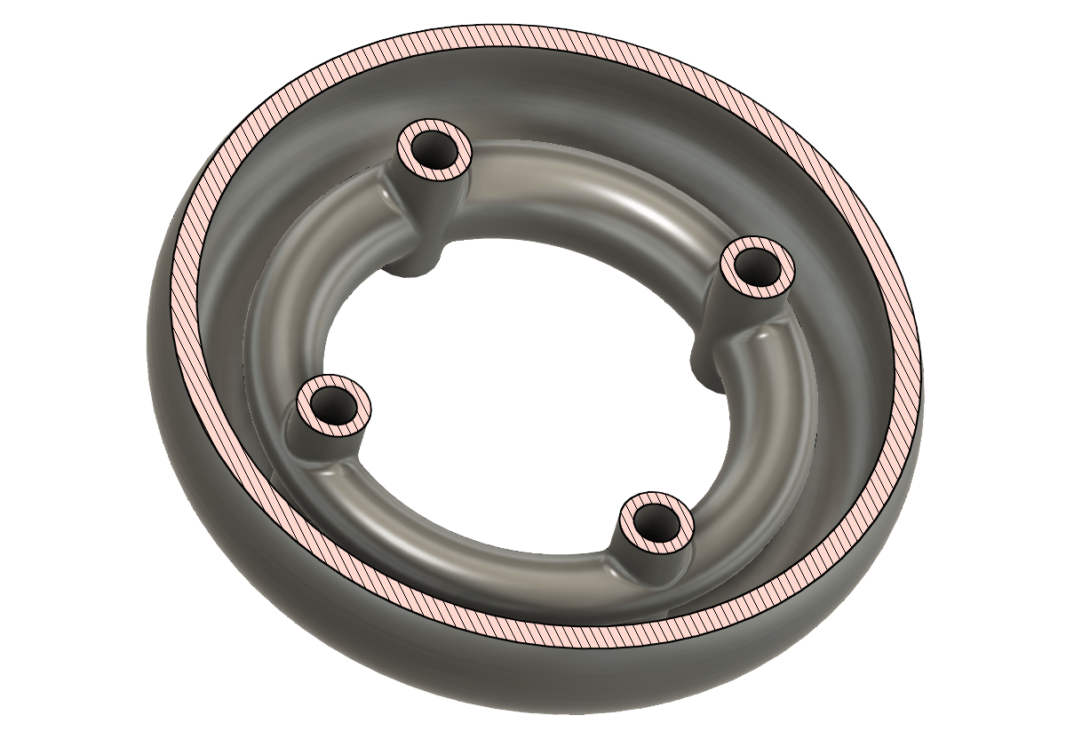

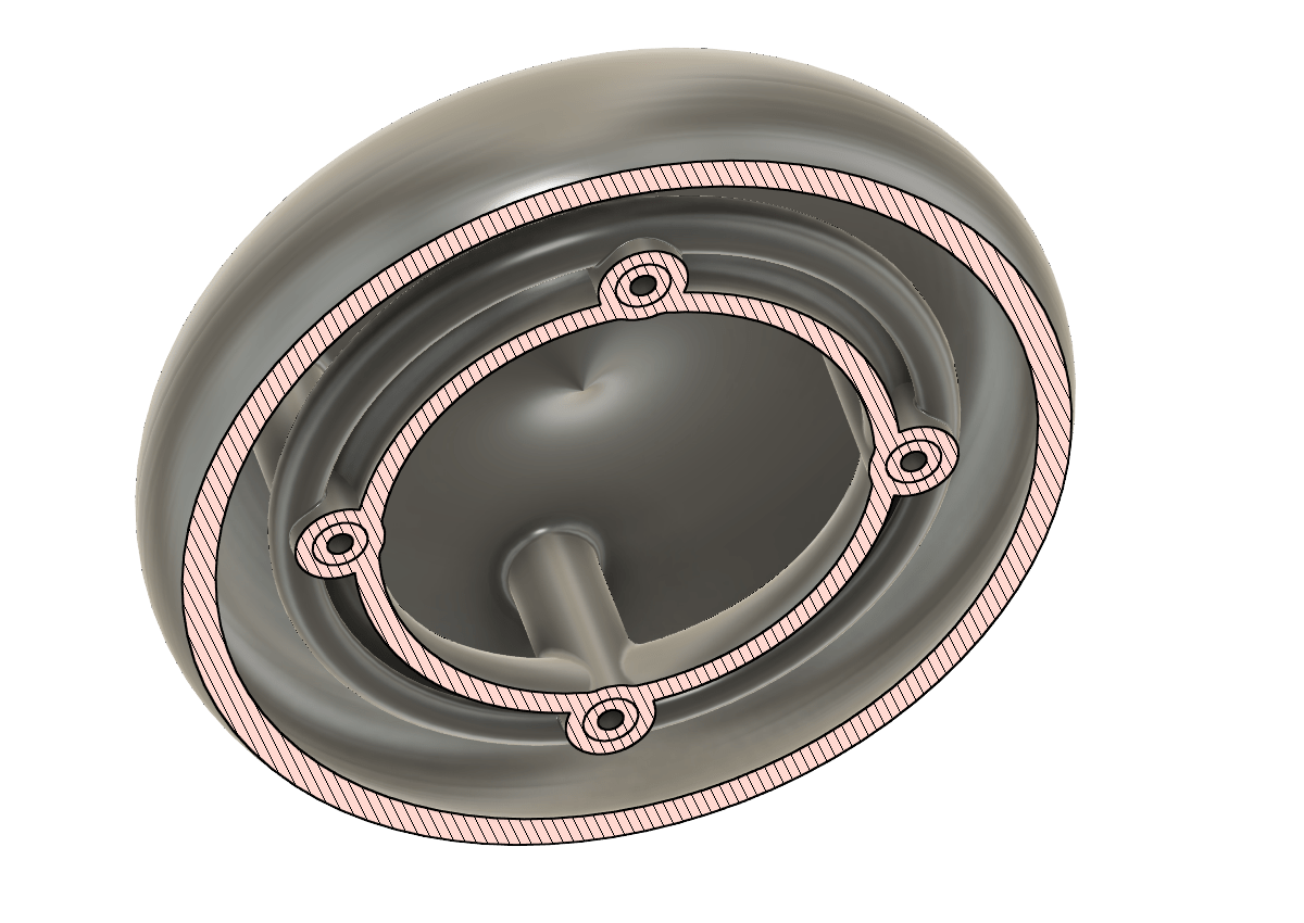

Being a sucker for punishment, I decided to stay up late and see if I could actually model a fibonacci spiral back chamber.... turns out you can! (+/-10%)
I will buy anybody a very large beer at the pub if they can work out how to 3D print this. 😉
Ps. Notice the pockets in the adaptor, plan would be to stuff with absorption.
Pps. Change .txt to .f3d
One obviouse down side of this design is that we have a rear chamber wall reflecting waves directly back at the SB65 rear cone profile, the only way to avoid this would be to scale the spiral/entry by approx 2x and have the rear chamber being oversized in volume for the driver and overhanging the ouside of the lower driver/horn adaptor.
Also, at a guess, I think to actually 3D print this a support structure would have to be printed and left in place inside parts of the spiral.

Would a resin printer part be adequately strong for this piece? A resin printer would likely have the detail to print this out with minimal support structures.I will buy anybody a very large beer at the pub if they can work out how to 3D print this. 😉
I don’t think it matters that much. It will need about the same support structures.Would a resin printer part be adequately strong for this piece? A resin printer would likely have the detail to print this out with minimal support structures.
The only way I see is to print in 4 or 6 parts on its side, and then assemble it together.
I’ve printed significant overhangs and what not with resin printers and minimal supports. The beauty is you can also print the inside of the spiral with supports then just use a finger or some such to wipe them out before curing.
The only thing that spiral will do as drawn is be a source of resonance, I wouldn't put much effort into trying to make it.I will buy anybody a very large beer at the pub if they can work out how to 3D print this. 😉
