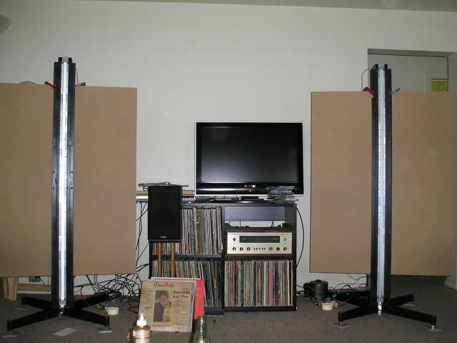

My apologies for not posting an update sooner...been to busy listening/tweaking to a pair of glorious ribbons 😀. I don't have time for a detailed report right now (have to get to work), but I just wanted to let you all know that they live and are freaking awesome. They are usable down to 75hz at low to moderate volume (ever hear a 3/4" ribbon convincingly recreate a kettle drum?) and 150hz at ear damaging volume. Huge sound stage, amazing detail (duh..it's a ribbon), and a mid range to die for.
I'll post more when I can.

I didn't take as many pictures as usual because things moved to fast. I must of strung up a dozen pairs of foil experimenting with crossover limits/foil thickness.
I'll try to pry myself away from the listening chair to post a more complete log.
Casey

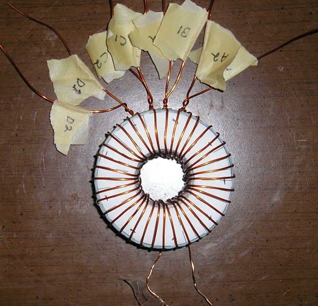

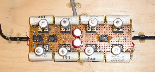

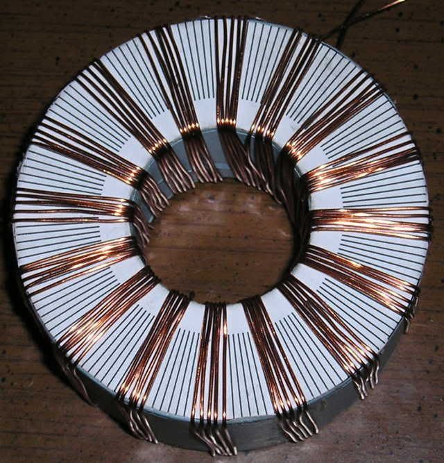

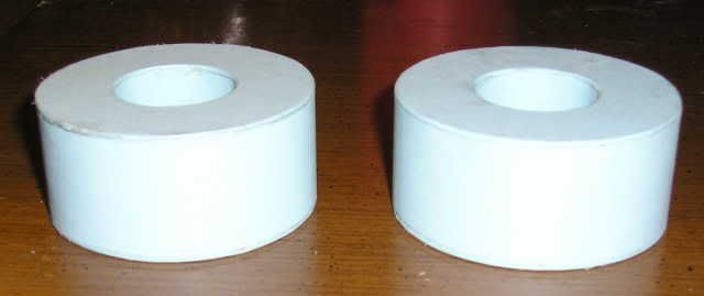

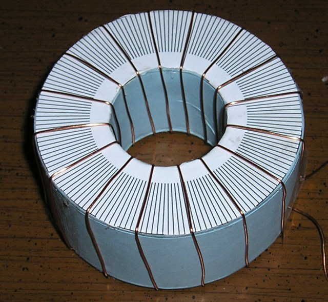

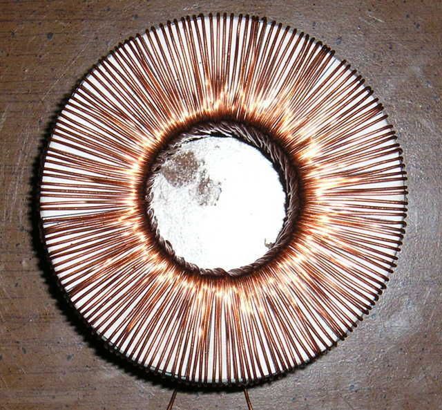

Ok..it's a little past the weekend but I creamed myself with a marathon transformer winding episode that I started Saturday morning and didn't finish until 4:00 AM Sunday..Sunday was spent sleeping/recovering.
The last 2 weeks has been a blur of activity, but I'll try to recap. The first obstacle that I had to overcome was getting a ribbon strung that didn't rub the sides. No matter how I tried I couldn't get the foil to clear both sides. I figured at first it was me not cutting accurately, but after a few ribbons I decided to go back and do some careful measuring. I had 2 problems. First, due to the insulating tape, glue, and slightly out of spec magnets my .8" gap is actually .78". Second, my straight edge is bowed .015"...the combination shrunk my .05" clearance to .015" clearance. The first thing I did was to re-drill my spacing block on my cutting table to slice a .73" ribbon. This gave me back most of my clearance, but my ribbons were coming out bowed making tensioning them evenly impossible. I compensated for this by flipping my straight edge over on the second cut giving my foil a slight convex. Not ideal, but workable. Once i had a foil that didn't touch either side I cobbled together a couple of composite resistor of 5 ohms out of a bunch of wire wounds i had in the junk pile. Hearing these things come alive for the first time was magic. I then fasioned some make due baffles by clamping some 20" wide mdf to the frames...
Even tough I only had around 1 watt making it to the ribbons I was mesmerized enough to stop work for a coupe lof days and just listen. During this time I was using a line level 6dB/octave @ 150 Hz fasioned with a cap between the CDP and amp. Other than an upward tilt in the frequency response it sounded damn good. As I mentioned before the bass was suprizing. No doubt some of this is due to baffle step and room gain, but I could follow the bass line easily. I knew that I needed a better high pass, so the next leg of my journey was to fabricate an active filter. I dug through my parts bins and came up eith the components to build the high pass portion of a 24dB/octave LR crossover...

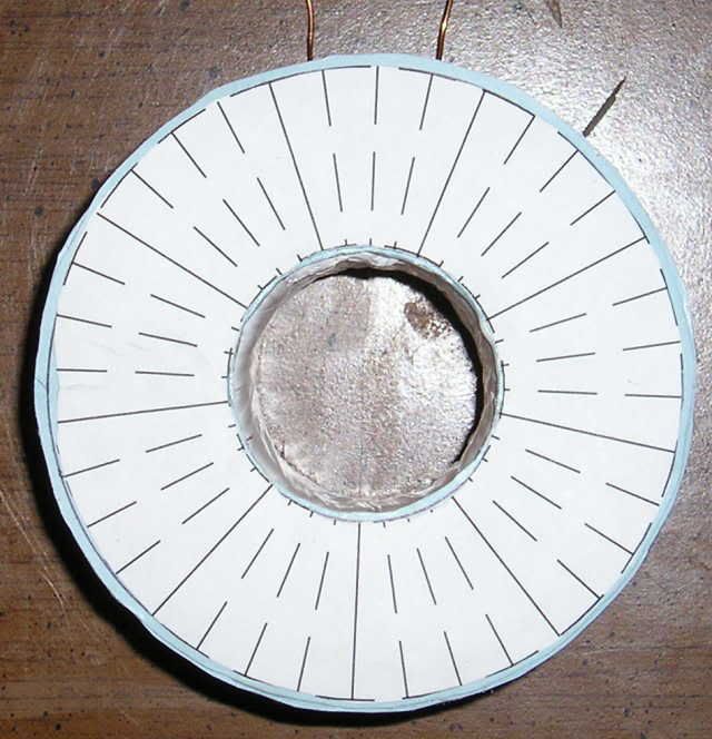

I had purchased a bunch of Soviet surplus trim pots and used these to make an infinitely variable filter between 20-500 Hz. I found that I could go as low as 75 Hz before frapping them with my 1 watt of power. Oh..with the 6 micron foil the efficiency is in the high nineties so 1 watt gave a reasonable volume. I knew that the next step was to match the amp with a transformer and I tried a quicky without properly wrapping the core and managed to cut into the insulation shorting it out. On a lark I decided to try some 115v-40V toroid power transformers I had and OOFTA!!..they sounded suprisingly good. The exaggerated top end dissapeared and the midrange became, for lack of a better word, lush. I dicovered in short order that 75 Hz was to low of a cut off point and stretched the ribbon. I then turned back to winding a proper tranformer. Here is one of the cores. I purchased a pair of surplus power transformers a while back to get the cores for this purpose. They are rated at 30VA...

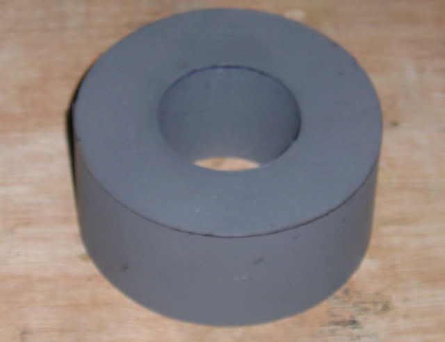

This time I carefully covered the cores in layeres of heavy paper...
Since I didn't want the tranformers cutting off the low end while I determine my crossover point I made them full range with around 160 mH primary inductance. This required 160 turns on the primary. I drafted a turns template in CAD and glued it on...

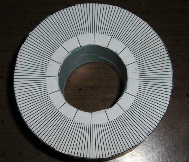

I wanted to keep the capacitance of the windings a low as possible so I went around in groups of 16 ten times. Here is the first group of turns...
Half way done...
And some time later, one completed primary...

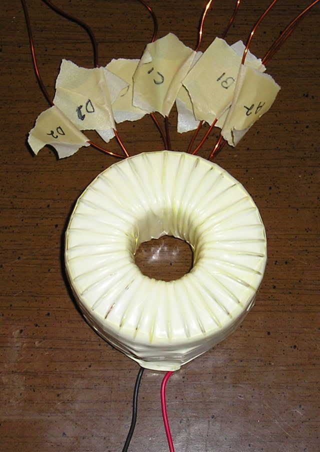

I then wrapped it in Teflon tape and glued the secondary template on. I decided on 4 seperat windings of nine turns so that I could match different foils of of different thicknesses, as well as give me different loads to the amp by using different series/parallel combinations...
After the secondaries were turned...
..I soldered on leads to the primary and wrapped the assembly heavily in heavy duty Teflon tape used in gas fittings. One completed transgformer...
Currently I have the first 12 dB/octave section of the crossover set to 75 Hz, and the second section set to 125 Hz. This allows me to play at a reasonable volume and still hear enough of the bass to enjoy them until I get a bass unit hooked up.
I still have a couple of things to work out, but the bottom line is that they are a success, and I now have the best speakers I have ever owned..with the potential of being truly world class.
I'm probably forgetting something..it's getting late and I'm still trying to catch up on my sleep...so ask any questions you may have and I'll get back with an answer.
Casey

I'm fairly new to speaker building but have done a lot of high frequency power transformer design.
A couple things to consider. The total wire area of the primary and secondary should be about the same. If your turns ratio is 5:1 then the wire on the secondary would have 5 times the area as the primary. A simple way to do this is to use all the same wire and parallel the secondary windings.
Your secondary looks a bit light. You could parallel a few more windings to reduce the losses on the output.
What is the core area and saturation flux density of the material you are using? I wouldn't worry as much about primary inductance as I would about the linearity of the core. A low primary inductance puts more load on the amplifier but in an audio transformer, if you design to stay away from saturation, you won't have problems with low inductance.
The teflon is fine but keep in mind that a ribbon tweeter is low voltage and high current so the insulation on the wire is more than adequate. The more tightly coupled the primary and secondary are, the lower the leakage inductance will be. What you have should be fine.
You might consider filling the window a bit more to lower the wire and/or core loss. A low leakage method is to wind one layer of primary, then two layers of secondary and then a second layer of primary. Then hook the two primary layers in series. This minimizes skin and proximity effect in the wire as well as the leakage inductance.
