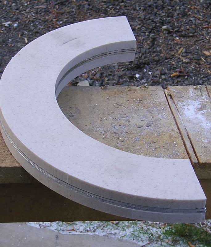

Sheesh..you know it's been too long since your last post when you have to do search to find the thread 🙄
Before I get into the much delayed progress, an example of what happens when you unplug the patch going to the UcD400 feeding the ribbon by mistake (well second mistake actually..I should have turned off the system before reaching for the cable)...
Oopsies 😀 . Can you imagine how a fella would have felt doing this to a comparable commercial ribbon? As it is, an hour later it was online again with a fresh ribbon..VIVA la DIY!!!
The delay in any work was due to a couple of reasons, life kept getting in the way stealing my time, and I really needed to gird up my loins for the task ahead. As I put my thoughts on my new baffle design in CAD I came to the inescapable conclusion that I was FAR from done in spite of the tremendous effort expended thus far. I had to wait until I tired of "listening around" the aberrations of my "scabbed" together baffle.There are 4 basic problems that I can no longer tolerate. 1)An unholy alliance between the baffle step, natural resonance of the poorly supported baffle, and a room node. These three things conspire to give a mid bass bump that makes a lot of music un-listenable. 2) The bass driver vibrating the speaker as a whole smears the leading edge of percussion instruments smearing the "attack" considerably 3) The single Extremis per side bottoms way to early...this has gotten worse as the drivers have broken in. 4) The edge diffraction off the magnets imparts a "hardness" in the upper registers of some music.
I have come to the same conclusion that many of the top cabin ribbon mfg.'s have...the portion of the baffle supporting the bass divers MUST be completely Isolated from the ribbon itself. It took me a bit to figure out how to do this with the baffle shape I had in mind. Once I did I realized just how much work is involved. I'm not going to explain it all, but it will reveal itself as I post the progress.
The first part of the work is unfortunately not documented..kept forgetting to charge my camera batteries...but it involved cutting out, and routing, 64 pieces of 1" MDF using this jig on a makeshift routing table...

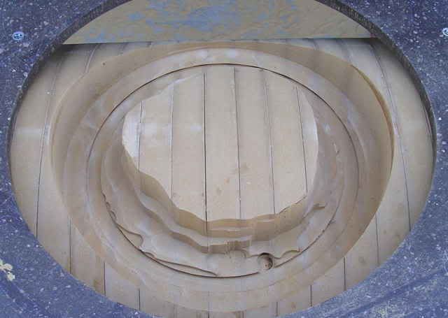

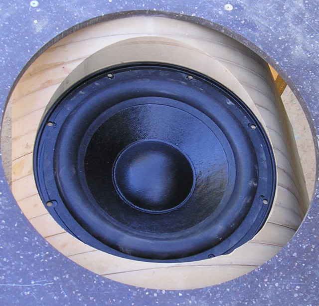

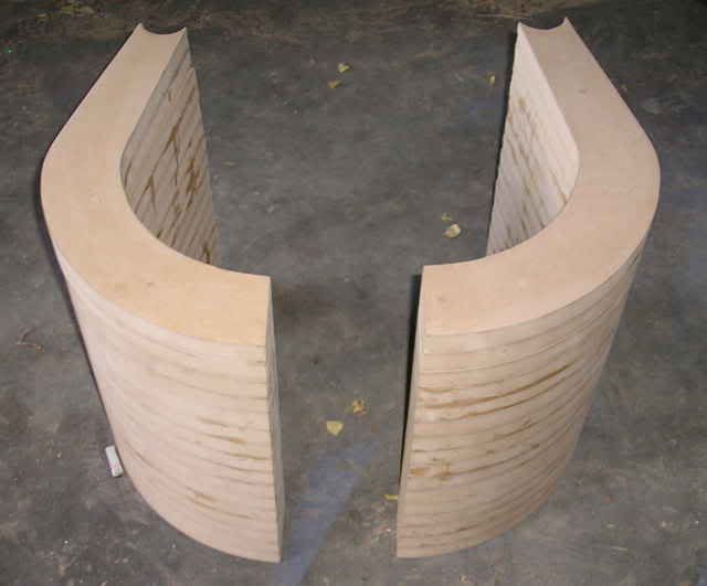

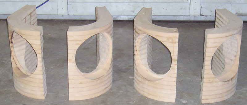

What seemed like an eternity later, I had the basic pieces of the bottom of the baffle laminated together...

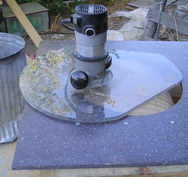

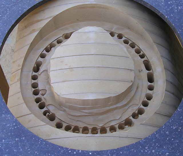

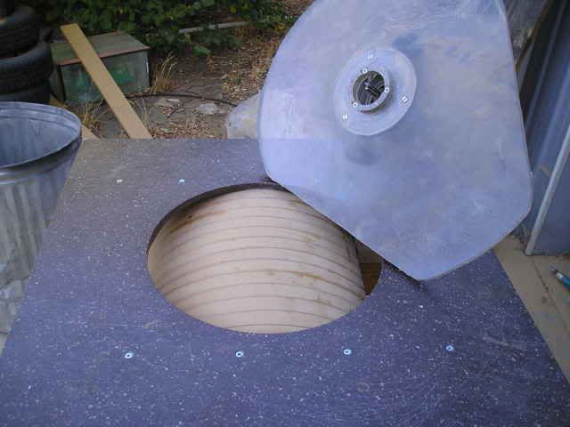

I then fabricated the tooling needed to cut out the spaces for my drivers in the curved section of the material, layed out my angles and mounted the piece up...
The ring around the router bit rubs on the circle cutout giving me my circle guide. Let the games begin...

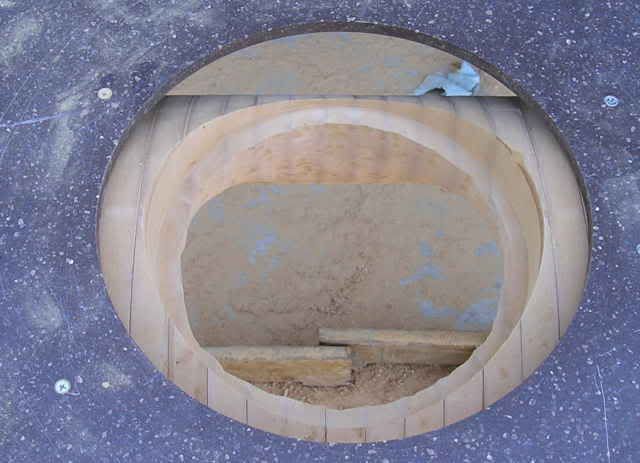

About 3 hours later, and a final pass with a bigger ring to give me a guide for the hole

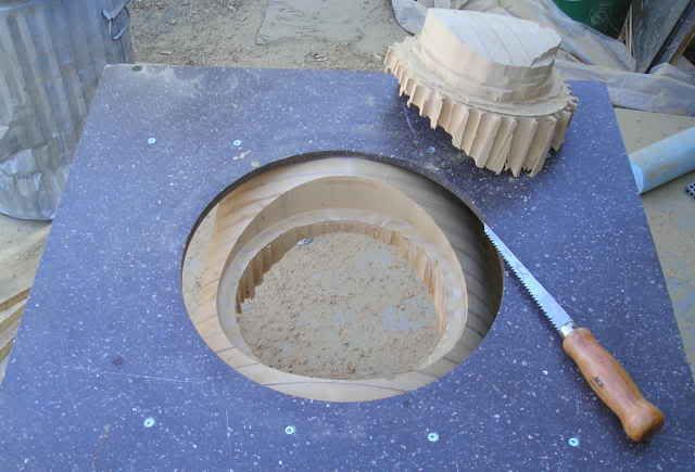

...I'm ready for the chain drilling...
...and the sawing...
...and the grinding/sanding...
An hour or so later a Exodus DPL-10 test drives it's future home...
Repeat as needed...
All told I estimate about 80 hours of labor intensive work to get to this point. If I never turn my router on again, that would be OK 😉. I literally filled a garbage can to the halfway mark with MDF dust.

Casey, Nice to hear from you again. I sure hope you were wearing a respirator and had a fan going. Nice shape. Router bit turned kinda red did it not. The mdf glue is murder on tools.
How did you come by the math for that particular piece of artwork?

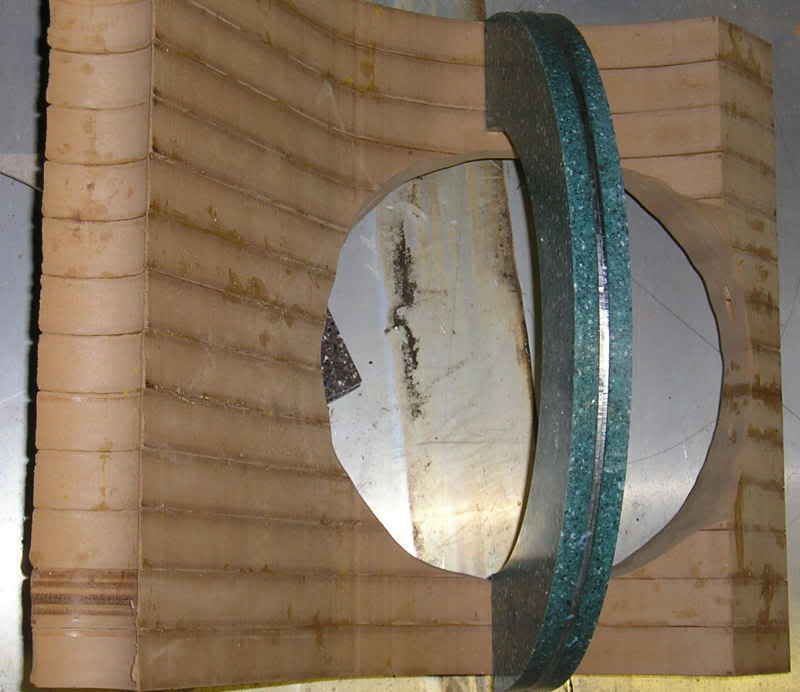

All this work was done outside in the breeze.
In the next to last pic you'll notice the piece on the left got a little crispy. I had to cut in 2 1/2" at the deepest point and the only thing I had on hand to reach was a metal cutting endmill...smoke city. After that I went shopping and found a proper router bit that would work. Going slow with shallow cuts prevented any more burning.

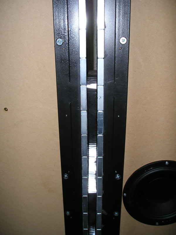

Approximately 6 micron harvested out of a capacitor..I would like to experiment with some thinner stuff if I could find it.

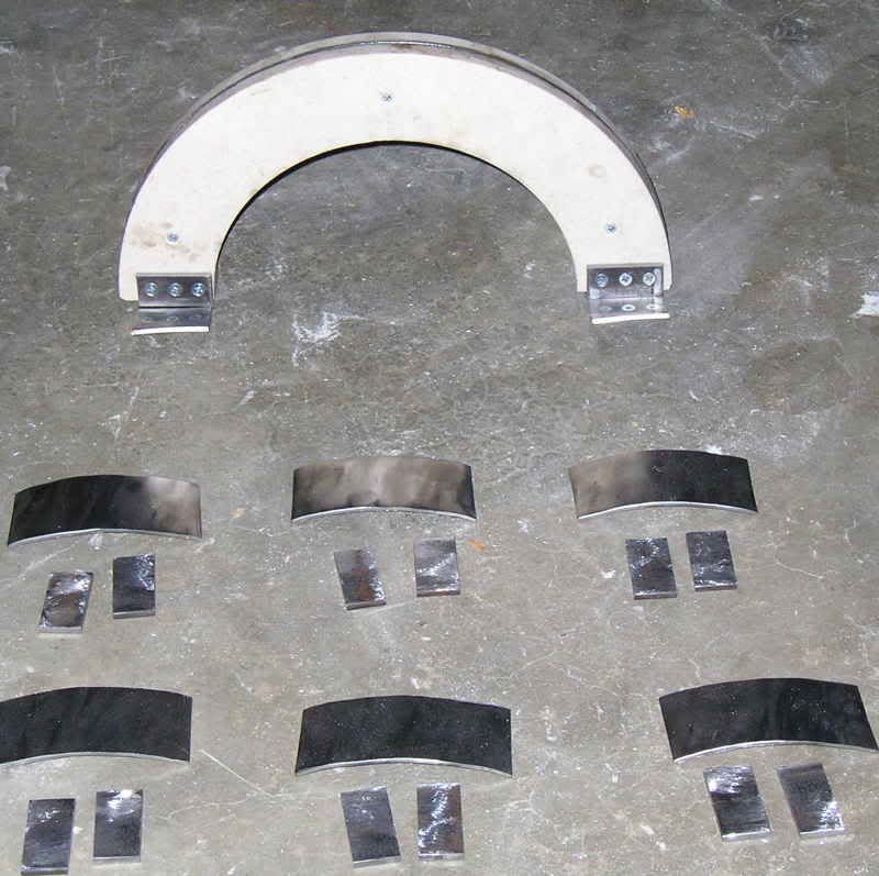

Due to poor planning (didn't get my epoxy ahead of time), and an equipment failure (band snapped in my saw) I didn't get anywhere near where I wanted to this weekend..oh well.

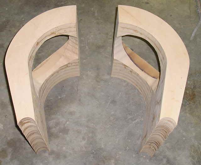

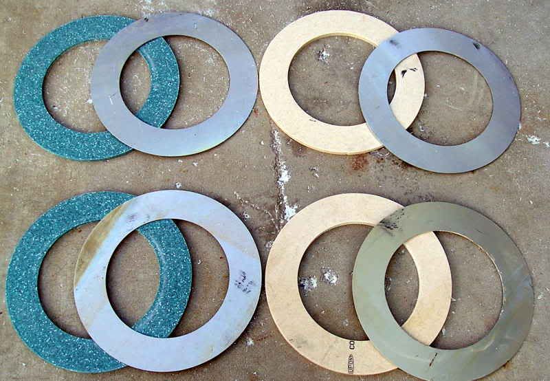

First up some more quality time with my router. I sandwiched up some aluminum sheeting with some Corion, and cut out four sets of circles...
These I bisected and glued/screwed together (this pair hasn't been glued yet, but you get the idea)..
These Corion/aluminum laminates will fit on the back of the baffle perpendicular to the drivers thusly...
When done, the two braces will meet at a sand filled pipe spiked to the floor..yeah baby!!
I was really hoping to have everything ready for assembly next weekend, I guess it wasn't meant to be.

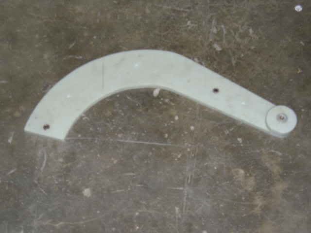

I started on the custom brackets to fasten the braces behind the drivers. The only suitable material I had on hand was a piece of hot rolled steel and some powder coated pipe. Since these need to be welded, I spent a big chunk of my time grinding scale, and wire wheeling off powder coating..good times 🙄 . Here is the progress made. Pieces cut out, and one set almost done..
As usual, I didn't get near as far as hoped..I'm learning to take it in stride 😉 .
