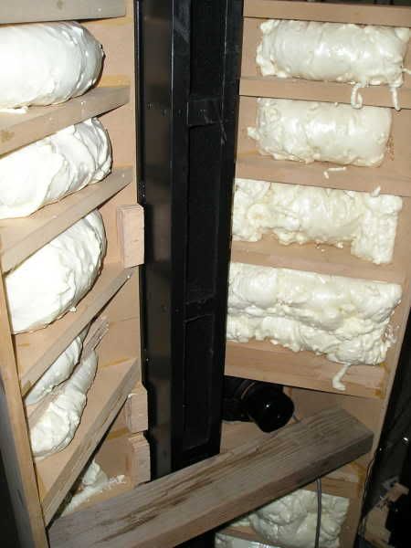

One thing that you might consider experimenting with is horn loading em. If you test the directivity in the higher frequencies you can use a horn with low density open cell foam lining the outsides to match the directivity/minimize defraction above the throat frequency.
I've been doing some experiements with Neo8 arrays and am getting much more LF extension this way. Even in smaller horns, with only two neo8's I can get down to 150 at loud levels with an active 36dB/oct XO.
I still have much more to do try though. . .
You could probably give it a shot fairly easily with some 4x8 sheets of drywall, clamped to the horn to make the angle on the horizontal axis. Carpet padding worked well in my smaller ones, and foam better. But if you like what you hear, it could be worth looking into.
The foam also seems to lower the effective freq on the horn, so they might not have to be as huge as you might think.

I've thought about it, but since I can go down to around 100hz without loading them the idea is in the back of the cue of things to try for now.

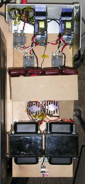

Turns out my transformers are not that great. I found that on certain material they had a rather obnoxious ringing problem. At first I believed it to be an interaction with the output transformers of my Fisher..but it's not. I'm back to using the power transformers for now. Thats not as bad as it sounds..they actually work amazingly well. I will be attempting another pair soon though.

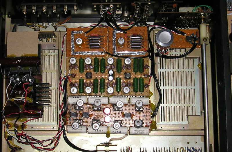

I decided it was time to flesh out my electronics needed for development, so I set out to finish my crossovers, and put together some amps for bi-amping. I gutted a Kenwood KA-7200 and used it for a case and volume control. I then built the variable crossover in it...
On the bottom is the high pass that I built earlier, and at the top of the photo is a single pole passive high pass that I added. This gives me a total of 5 poles. In the middle is a 4-pole low pass that feeds a 12 dB amp. The knob next to it adjusts the bass level out.

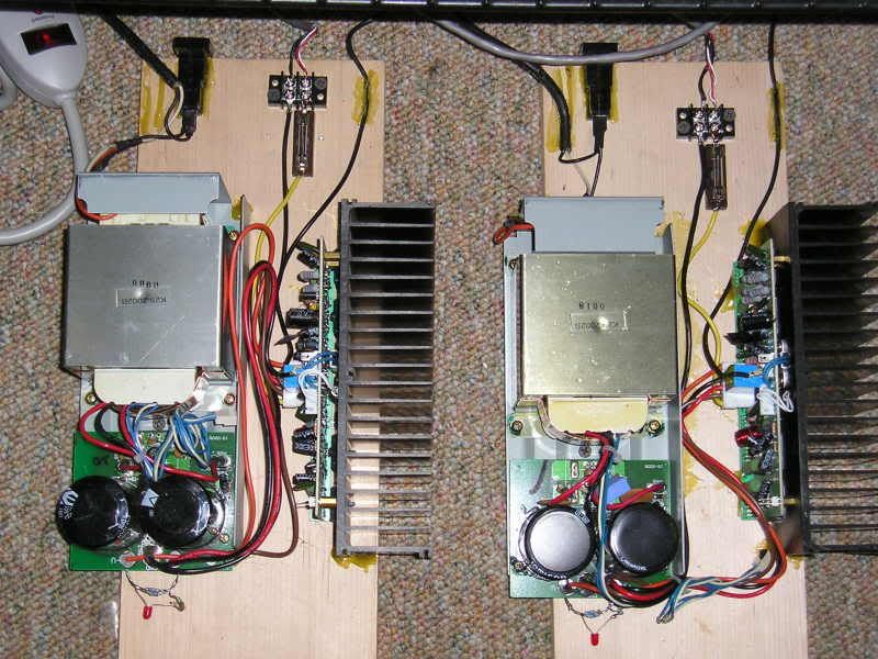

Next up is my "Amp On A Stick " collection. My dual mono UcD400 amp...
...and my 250 watt NHT mono blocks...

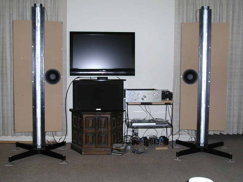

Aren't they a beaut 😀. I'm amazed at how good they sound in spite of how "wrong" they are. Thats been the main reason I haven't posted any progress of late...there hasn't been any to speak of. I can't seem to pull myself away from listening to them.
The progress that has been made is in the future design. I've been working on a new baffle design, here is the plan view (from the top)...

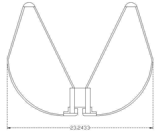

They will have an effective width of around 45" giving me an Fp of about 300 Hz, and an Fe in the neighborhood of 100 Hz. I'm hoping I can be clever and have the x-over start early taking care of the baffle step and highpass at the same time.

I experimented with bass placement using my Paradigms and discovered that due to the low x-over point placement wasn't that critical. I plan on having one on each side at the bottom at 45 deg. This way I can have a curved grill cloth that matches the baffle contour. The sims predict they will have an F3 at 25 Hz.
