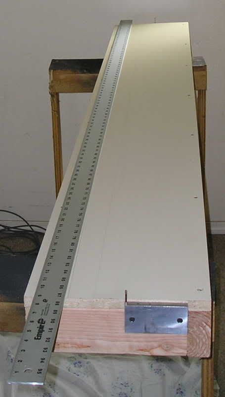

Made several steps forward, and one step back this weekend. First up was the cutting table for the foil. I bartered some labor with my brother and he spanked one together for me...

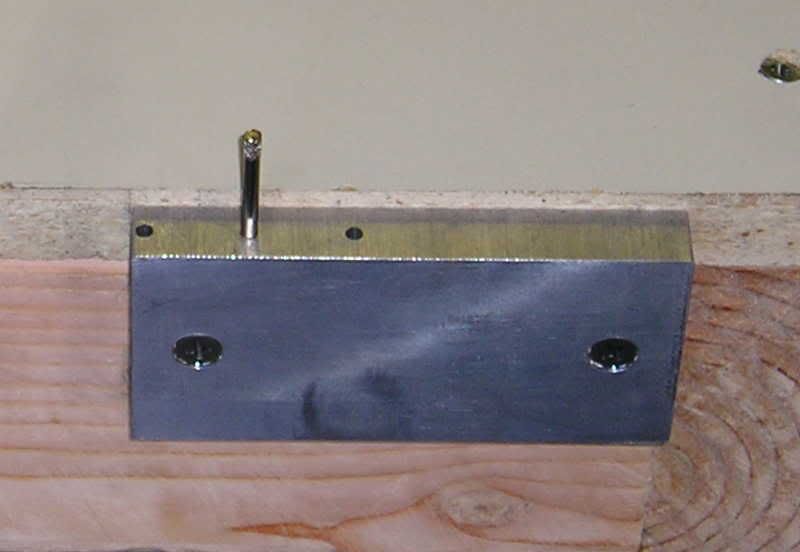

... and I machined a couple of guide pin blocks for the straight edge...

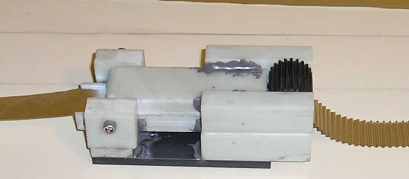

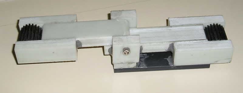

Next I went to work on a crimper to corrugate the foil. After playing around a bit I realized that if I wanted the corrugations to be square with the edge of the foil I needed to come up with something other than relying on my eye-hand coordination to feed the foil straight. I was up till 2 AM working on my gizmo, but it was worth it....
It works perfect...
I later discovered it works best pulling the foil through rather than rolling the top gear. It corrugates and stretches it out at the same time making for a truly straight ribbon.

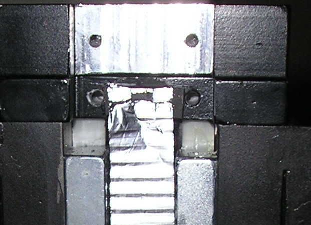

So, I get the ribbons strung up and happily went to work wiring up resistors so that my amp could drive them at low power for their maiden voyage. This is were my balloon deflated. I wasn't getting continuity through the ribbon...hmmm. It turns out that the Sorbothane on the insulator blocks was the culprit...
As the rubber was compressed its width expanded tearing the foil...on both ends of both ribbons. Oh well, live and learn. I have a couple ideas I'm kicking around to address this but I'm going to think on it a bit.

I like your little corrugator gizmo. More corian or just spare plastic? Why is the foil a brown color? How about the gears. Tad

As the geometry stands...yes. I set it up so that each piece of rubber needs .025" of crush(.05" total) in order to place the ribbon in the center of the gap and to bring the clamp flush with the mounting block (for bezel clearance). I have to replace the current rubber with something else.

Yep Corian, I love the stuff.
Only in the picture. must be a reflection.
I had a hard time finding a plastic gear wide enough and ended up buying four compound gears. The wider gear was a 1/2" so I cut off the smaller gear and glued two gears together to make a 1" wide gear.

Do those blocks really need to be that tight? Don't clamp it down so hard.

Casey, The sorbathane might be a little bit soft. Try something like neoprene or silicone hose. The nylon fibers should help maintain shape during compression preventing the edge from curling in. You could cut some strips and give it a try. Maybe even latex rubber. Tad
Automotive vacuum line...BINGO! Here I was conjuring some elaborate scheme and you drop a "Duh" bomb on me 😀 . Thanx Tad.
