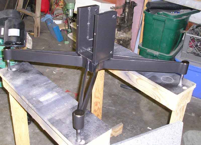

Finishing the stands. I neither enjoy, or am particularly good at finish work. I do manage to get acceptable results eventually though. I finally finished one stand this weekend (minus the spikes)...
The other one is about half done. I know I will be looking at these things a l-o-n-g time so I can't take to many short cuts with them.

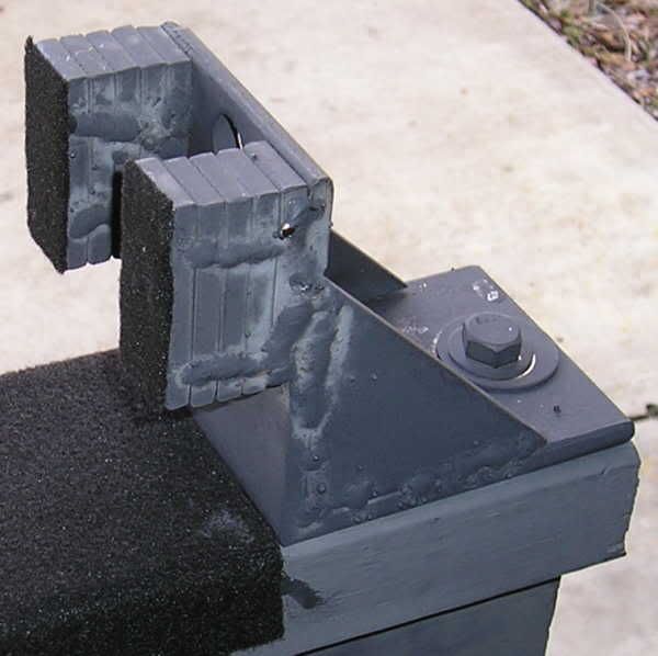

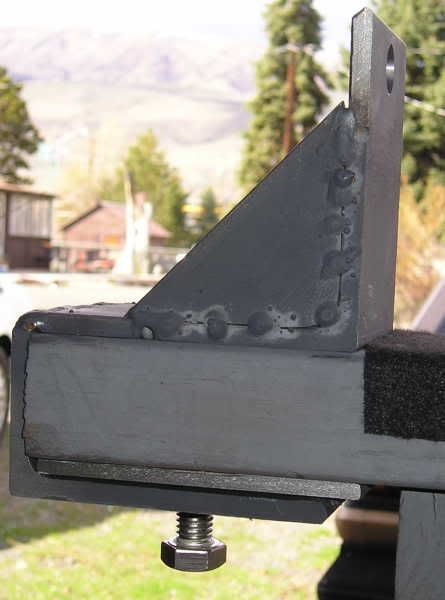

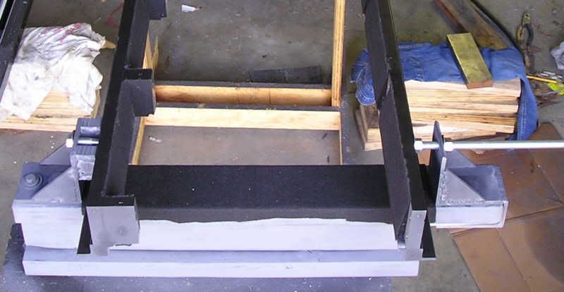

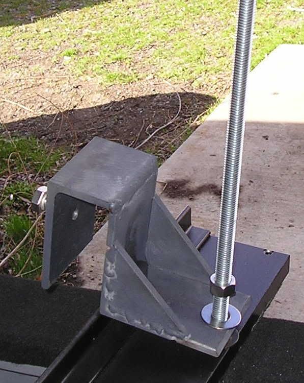

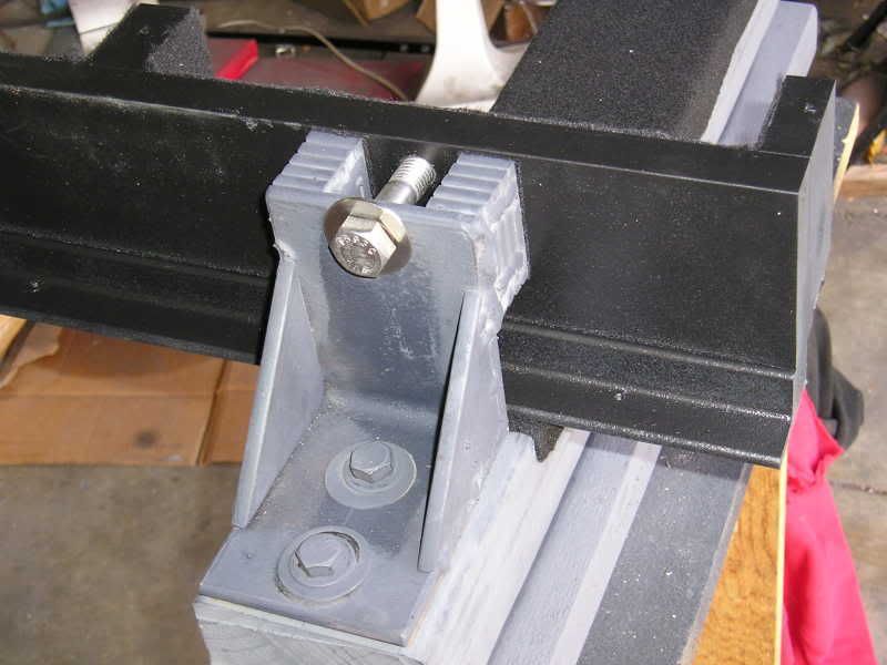

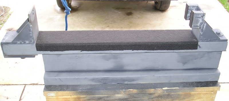

I finished the other stand last weekend so I was able to focus on the next hurdle...the jack needed to assemble the two halves once the magnets are laid in. It needs to handle both a lot of mass as well as force. After thinking about various temporary options I came to the realization there was no "quick fix" that I felt comfortable with. I've gone to far to muck up the most critical phase. A weekend of welding and cutting later...
This is one of two. One end (on the right ) is bolted down to the wood "I" beam, and the other is removable and clamps on. Here is a close up of the fixed end...
...and this is the movable end...
The rail with the cross blocks bolts to the fixed ends...
...and the movable ends are attached with thread rod to the other rail...
...which is then slid over the beam ends and tightened, and its ready to be jacked together...

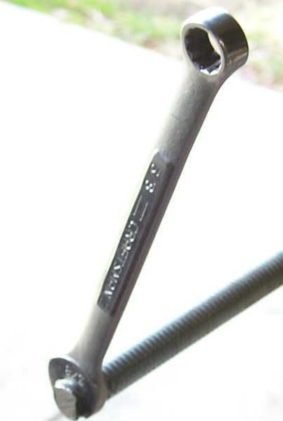

The ends of the of the thread rod are flattened to accept a 3/8" wrench so if the locknut on the rod slips I have a backup to prevent the rod from backing out....
I have a little minor tweaking to do yet, but I expect to lay in the magnets and do the final frame assembly next weekend.

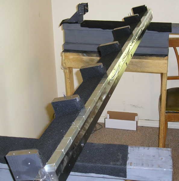

The fine tuning of my jack turned out to be a big pain. As I had drilled the holes that the thread rod screws into the rails free hand the weren't perfectly square (duh). This caused the rod to be under a bind when the rails were close together. I decided to assign a rod to each hole and bend it straight after heating it with a torch. Unfortunately the weld shop is closed on Saturday so I had to wait to refill my O2 tank. After hooking the tank up I discovered that my regulator had gone south and I charged my line with the full 2000 psi of the tank. Fortunately I was able to shut down and bleed off without a "POP!!". After spending a day rebuilding a regulator I was finally able to bend the rods. I then installed and chamfered my alignment pins...

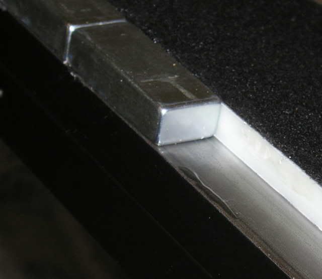

Then I went to work laying in magnets. Here is a shot showing my glue pattern...
Its hard to see, but thats super glue on the left and slow setting epoxy on the shoulder. As I mentioned a couple of times before, one of my rails has a slight bow in it that prevents it from laying flat when relaxed. I had about .05" clearance on the 2 end blocks. If the magnets were butted up to each other I was concerned that I wouldn't be able to pull it down flat when assembled so I placed a .0005" piece of shim stock down before I glued on the next magnet giving the space I needed...
I would then pull it out after the magnet was set. After laying in around half the magnets on the first rail I was curious to see if it had magnetized the rail significantly yet...
Yep 😀 . After all 30 magnets were glued to a side, I cleaned any glue off the surface and put a layer of packing tape down to insulate the nickel plating...
Then folded it over, trimmed it to the edge, then went back and puntured any air bubbles so that it layed flat...

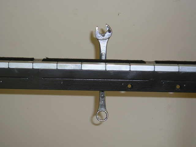

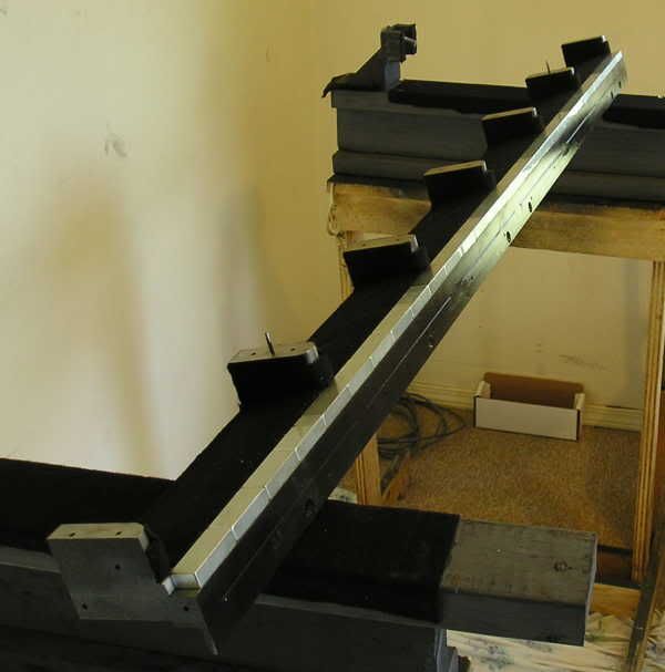

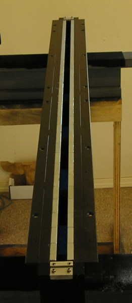

After gluing all 60 magnets down, it was time for the moment of truth. My jacks worked a treat..in fact I don't see how I could of controlled the assembly without them. The force was intense. When I got to this point...
...I had to use a decent amount of force on the nut holding them apart to turn it. The only really nervous point was when they were the last 1/4" apart. At this point the magnets were pulling harder than the cross blocks and was toeing in slightly. Fortunately the pins did there job, and as soon as the lower edge of the cross block made contact it righted itself and aligned perfectly. I can't over state how freaking powerful the force I harnessed is. When I was test assembling them I had to use 2 clamps at each end to overcome the bowing of the rail to screw it down flat...when it came together it pulled itself flat!! I then mounted my end blocks for the final time...
One completed motor assembly...
It took approximately four hours to assemble, and I feel like I have been beat up. I'm literally sore from my feet to my neck after wrestling with these magnets. I'll be waiting a few days to recover before tackling the second one.
One final point for now. Any concens about the ancillary steel (mounting flange and stands) "draining" any of the magnetic flux has been put to bed. I experimented with my shim stock and a razor blade, and I could detect NO residual magnetism anywhere in the frame...the energy of the magnets is completely harnessed in the gap.
Casey
