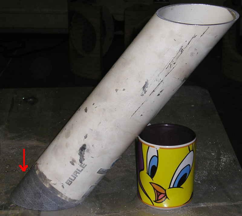

Set the tube bottom down on the drill press and drill completely through from the top (in the direction of the red arrow in the attached photo). the tube will be sitting at the correct angle since the bottom is presumably cut at the proper angle. since the drill bit is perpindicular to the table on which the tube will be sitting, the hole will be at teh proper angle. all that will be necessary then will be to patch the holes where the drill cut through from the top.
Ahh...this misunderstanding was mine 😀 . Hmmm..thats doable, I would rather not generate more work of plugging a hole if I don't have to though. I will call this plan "B", thanx for the input kind sir 🙂
Well ya..if I had to build something to hold it, then I would be shy a 6-pack, but if I can "red-neck" up something I'll be flush with brew 🙂 . I will still need to have it stabily supported regardless if I go through the top or bottom.
