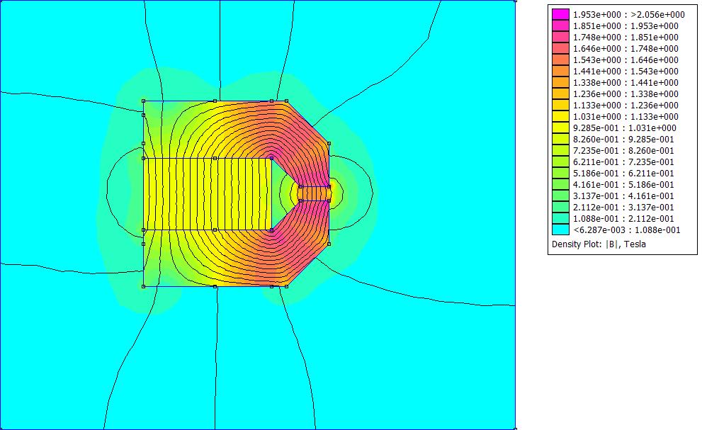

I spent some time thinking about this approach, and as attractive as it seems to be at first blush, there are some potential obstacles to overcome.
1) The magnet is ultimately only as good as the core. Common materials like iron and steel can't handle the flux density that Neo magnets have. To build an electro that can keep up would require an exotic core like a Cobolt alloy (and you thought the Neo's were expensive 😀 )
2) With an electro magnet you would have essentially a very big transformer with the ribbon as the primary and the magnet windings as the secondary. If the windings are connected to a conventional supply it would load down the amp driving it.
In my FEMM simulations I get higher flux density with pure iron than with the two cobalt alloys.
el`Ol-
I haven't done a sim on anything but Steel/Neo combo's, but that makes sense. Cobalt has a much higher saturation point than iron so it stands to reason Iron has a higher permeability. What I was trying to point out is that I think Iron will saturate before it reaches the flux density of Neo's. The massive frame I built was out of necessity not desire. It was the smallest I could get away with based on hours of FEMM. Anything smaller and the gap flux dropped off radically as the steel frame saturated. From this I assume (possibly wrongly) that the max flux density is limited to below Neo's. Enough to matter ? Maybe not. You just might be looking at a slightly less efficient ..if at all..ribbon. Assuming you can only get half the flux mine is projected to get still puts you in the mid 90's at 1 watt.
I hope you do some experimentation and get back with the results.
Casey
