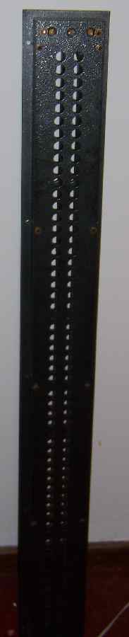

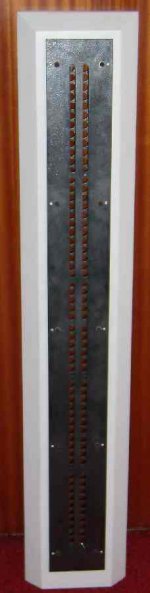

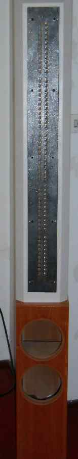

Mounting of magnets
Hi
I have build a set of one meter ribbon drivers using three rows of magnets to mount two strips of ribbon which was then used in series to give me an impedance of .5 ohms.
I useds 3 mm sheetmetal as a backplate and a aluminium faceplate and two pieces of superwood 10 mm thick between the magnets which I glued to the backplate. Once the glue had set I simply removed the wood spacers.
In my first attempt I used a metal faceplate and made the following "discoveries":
a) With a metal face plate the ribbons assembly became a lightning fast guillotine.
b) The metal face plate reduced the magnetic force field so I had redone in aluminium.
c) If the metal back plate is to thick or wide it also reduces the magnetic force field - so keep it as small as possible.
d) With a meter long ribbon with no ribbon support the sound was the most incredible I have ever heard but you could not play it very loud or the ribbon foil would move outside the magnetic force field area. So you need to provide "ribbon support".
e) I used 60 watt class A amps (Stan Curtis design) to drive the ribbons using an basic 12 db (big mistake at the time) active crossover. Listening at night (in the dark) I would get carried away and turn up the volume only to find that a unexpected cresendo would cause a meter long flash as the amps vapourised the ribbon and then a deathly silence would follow....
The effort to replace the ribbon eventually killed this project and I converted to commercially made ribbons.
I still have the ribbons but I still need to revive them using a Behringer digital crossover which I suspect will give me more leeway with crossover options.
If there is interest I will post a picture.
Jozua
Cape Town
South Africa

Hey LineSource,
Thanx for the explanation. I too base a lot of how I do things on what I have on hand, and if I had a floor for assembly I wouldn't bother cutting the rod either. My big shop is a metal shop, and my magnets will never see inside it...I can just see the filings launching out of every nook, and cranny to land on them. After the magnet frames are completed, the 2 halves will be dissassembled, and after a thorough cleaning will be brought into my electronic shop in my house for final assembly. I have some ridiculously strong aircraft aluminum blocks that I will fabricate the jack plates out of that will bolt in place of the end caps. I will use 2 rods per side for a stable "box" of support. The 4 rods will hold the sides apart, and the blocks will only be between the magnets as a safety net in case something fails. I will bolt one rail down to the bench, and jack the other side in horizontally.
Hi Jozua,
No time like the present 😀
I'm always interested in seeing others efforts.
Casey

Making your own ribbons
ValveItude
Your design and metal work looks very impressive. I wish I had access to your tools.
My gut feeling is that the steel you using is to thick and will cause a significant loss in magnetic power from the magnets.
I found that I had to make quite a few ribbons so your stock of 4 caps is not going to last long. I went to a aluminium manufacturer and bought sheets of aluminium foil of various thickness until I found what I thought worked best.
I used a very thin layer of Kapton foil "sellotape" (used as isolation material in electrical motors) which I stuck to the back of the ribbon to give it strength. The commercial manufacturers use Mylar. Once it was glued on it also simplied the process of cutting (very tricky process) the ribbon out of the sheet.
If you dont support the foil once mounted you will find that the ribbon movement/tension (which can be quite severe!) will cause hairline cracks to start developing across the "ribbon" and eventually it will simply break.
It all looks simple but believe me it is not.
Regards
Jozua
