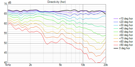

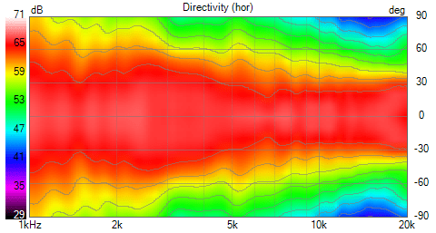

Here is the above mentioned kind of graphs for the 3 way 🙂

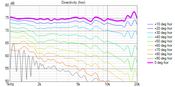

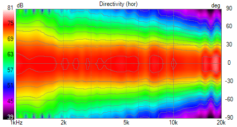

Now the corresponding ones for the 2 way:
(There is some phase issue with that 90 degree measurement)
Wow.. looking at them this way, the 2 way response does look nicer to the eyes 😱

Getting 10 dB of directivity (i.e. DI) at 1k, rising to 12 dB at 10k... that is A LOT of directivity, and it will have a very different perspective than a wide dispersion system, even one which uses a waveguide like the 3-way system. Vineeth - you are so wise to experiment in this way, to find out what you like, and what works well in your room.

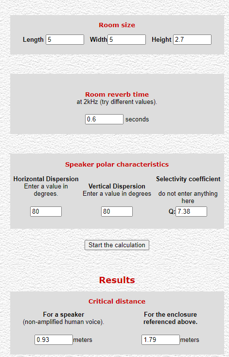

Vineeth,
2 observations:
_i think you are too far away from loudspeaker: from visual cues and the recording you were probably located past critical distance of your room.
In this video as you move i felt the 'room sound' dominate the direct sound, iow we listen more to your room than the loudspeaker.
Here is a calculator to help you determine critical distance approximately ( your room seems to be open on one end and it'll change things a bit in reality) :
As it is in french:
_ first box is room dimensions
_second is reverb duration @ 2khz
_third is loudspeaker's directivity with horizontal and vertical coverage
http://www.rt60.net/dist_crit.htm#:~:text=La distance critique est la,critique de la source sonore.

I tried out the RT60-based calculator to find out the critical distance. These are room & system parameters I used
Horizontal and vertical dispersion values I entered based on below plots from the speaker. Vertical might be slightly wrong as the horn is a little bit different in its vertical profile compared to the horizontal. But around 2kHz I think it will be close enough

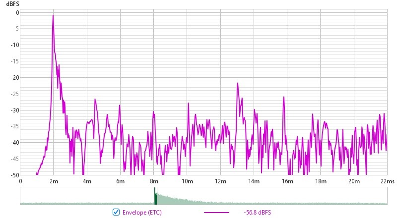

I entered the RT60 measurement at 2khz based on the following plot

The calculator says 1.79m is the critical distance. In that case I will try out with moving around in a 1.5m arc. I will also try to carry out other tests.. They look like fun 😀
