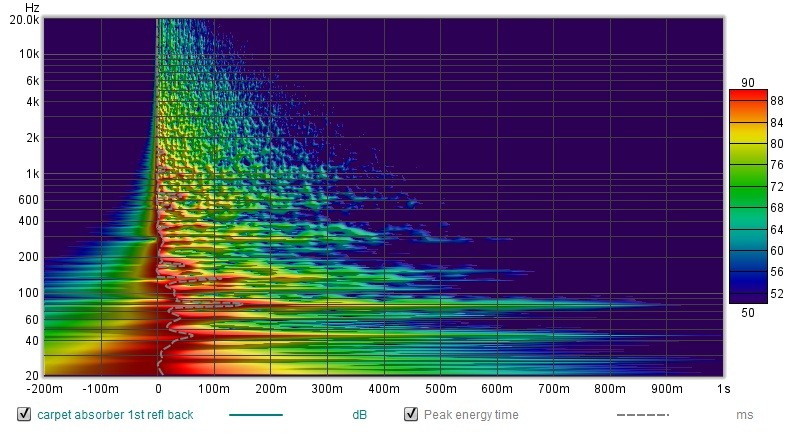

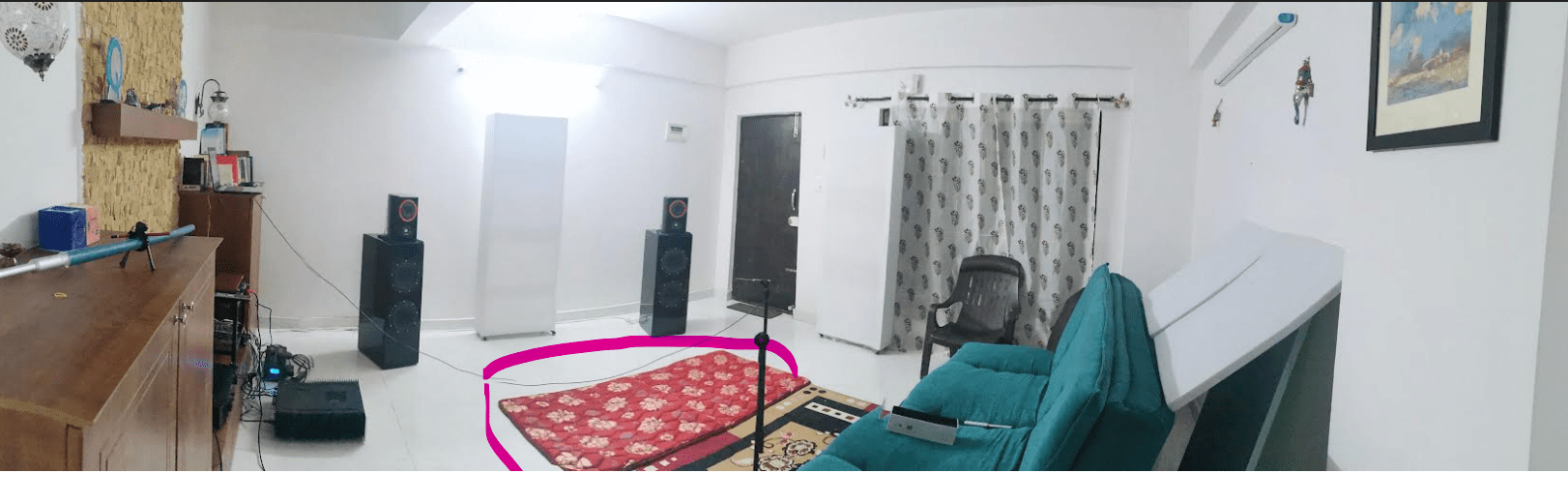

So I did some experiments today. My sonar works mic cable got damaged so I had to adjust with my MiniDSP UMIK-1 which has a problem with a little too much tilt down at higher frequencies.. 😀
But still, there are a few interesting observations (I measured only the right speaker seen in the pic with the big absorber panels positioned at the best locations in terms of measurements I got)
1) A good, thick carpet will make some measurable difference in this room, as many of you have pointed out.. 🙂
I just placed a relatively thin foldable mattress on the floor, as shown below and it shows some good trends.

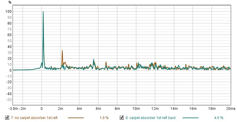

ETC showing the effect of that mattress (/carpet). The mattress attenuates the first peak in ETC and helps with some absorption at mid to high frequencies.

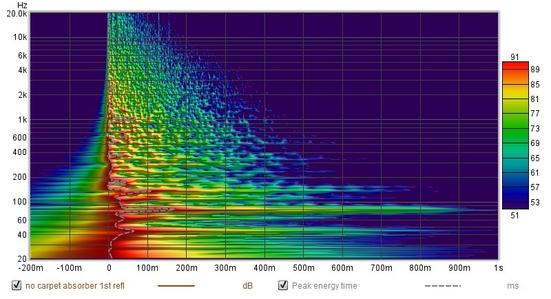

Spectrogram (with no mattress)
Spectrogram (with mattress)
2) The panels seem to be more effective placed at 1st reflection points than both of the panels behind the speakers. Due to the toe in of the speakers some absorption happens due to the panel at back wall also, I think
3) Some absorption at the back of the sofa might help (For the experiment, I used only 1inch thick basotect panels, but a better thicker panel might help more, I think)
I cannot bring in much new furniture due to the rented house from which I may move soon. But I need to buy a good carpet and a few more manageable size/ wall-hangable acoustic panels.. 😀
That is all I have for now. I need to do some more experiments with panel positioning and then start with using the DRC software.. 🙂

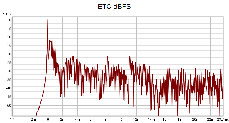

Not that it matters but I find it easier and more helpful to look at the ETC in dBFS rather than percentageETC showing the effect of that mattress (/carpet). The mattress attenuates the first peak in ETC and helps with some absorption at mid to high frequencies.
Hi fluid,Not that it matters but I find it easier and more helpful to look at the ETC in dBFS rather than percentage

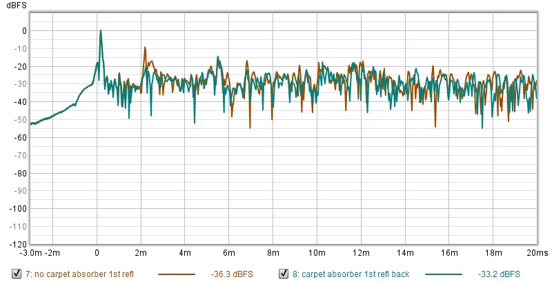

Here is the same data as above in dBFS:
Please let me know if any additional insights can be got from this plot?
The panels are knocking the 2ms reflection down by 10dB which is good and keeps it less than 20dB below the main peak. The next candidates would be at 5.5ms and 10 to 12ms.
My aim was to be at -20dB or below for at least the first 15ms. If you stretch the vertical scale it will be easier to see as 120dB of range in the graph will make things look flatter.

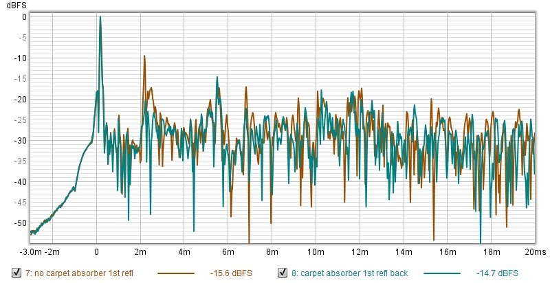

Below is the zoomed-in graph for completeness
Is there an easy way/a calculator sort of thing to identify which surfaces contribute to all these reflections based on room geometry? (Just to avoid working out manually/pen and paper analysis) 🙂

For each 1ms there is 344mm of path length difference, so either pen and paper or getting a tape measure / piece of string and adding on the extra distance to see which surface could account for it, Vituix has Auxiliary calculators that can help, window length would tell you floor and or ceiling delays and the wavelength can work out the distance based on ms just put it in the full wavelength box.Is there an easy way/a calculator sort of thing to identify which surfaces contribute to all these reflections based on room geometry? (Just to avoid working out manually/pen and paper analysis) 🙂

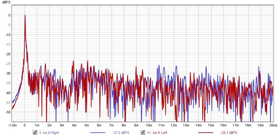

As long as we're talking about, and sharing room tweaks, from my most recent measurement session, here's my left and right speaker results:
In a relatively 'normal' looking living room. Planning for it helps 😉. It still is a lively enough room though.

My eye catches lots of reflection decay even after 100ms in wavelet spectr... despite of remarkable attenuation of first reflections
Even I have the same doubt..My eye catches lots of reflection decay even after 100ms in wavelet spectr... despite of remarkable attenuation of first reflections
I think that the attenuation of the first reflections with the relatively less wide panels that I have might help reduce interference to the direct sound and some amount of absorption of energy. However, it is still nowhere near enough to tame/bring the room under control w.r.t decay of energy at different frequencies, as seen in the spectrogram. Maybe a lot more absorption is needed for this room..

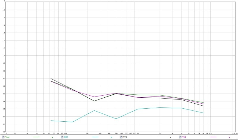

What does the RT60 tab in REW look like? Before and after the panels/mattress on the above measurements?
I am not sure about which metric in the RT60 tab is relevant in this case.What does the RT60 tab in REW look like? Before and after the panels/mattress on the above measurements?

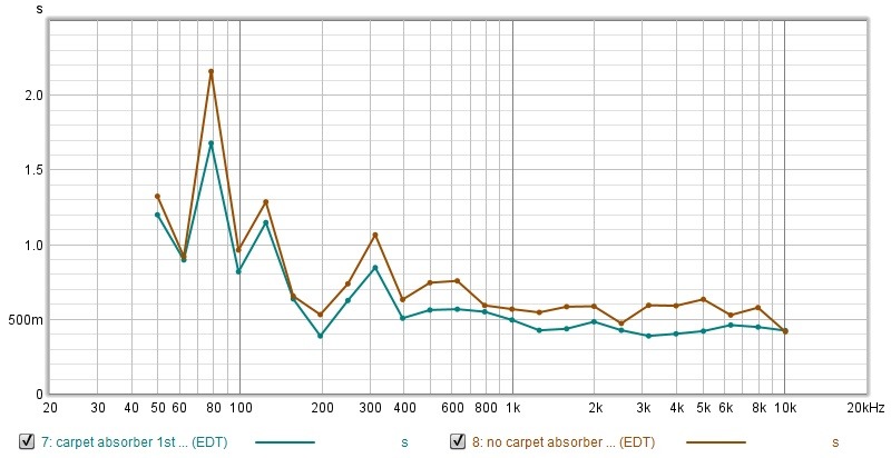

This is how the EDT looks like with and without absorption:

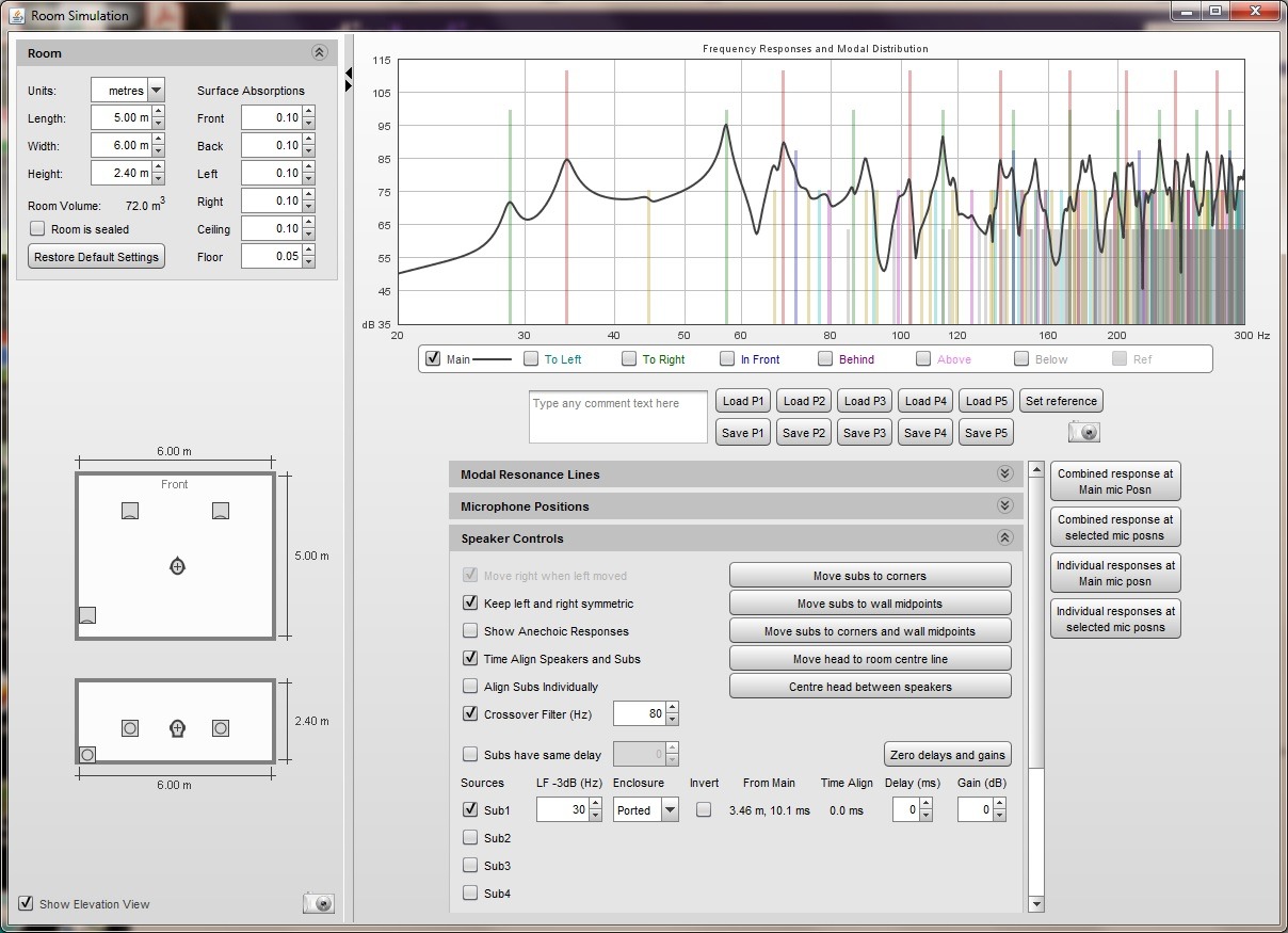

You could use REW's built in room "Room Sim" app.
Could you show Topt? This EDT graph isn't an RT60 graph, as it shows:
REW help said:Early Decay Time, based on the slope of the Schroeder curve between 0 dB and -10 dB. This is not an RT60 figure, but rather an indication of how quickly the initial sound at the measurement position decays - it is much more location dependent than RT60. A fast early decay (low EDT figure) indicates better clarity than at positions where the EDT is higher.
It does indicate that your clarity must have gone up 😉.
Topt explanation reads:
REW help said:An "optimal" RT60 decay time based on the slope of the Schroeder curve over a variable range chosen to yield the best linear fit. If the early decay time is much shorter than T30 the Topt measure uses a start point based on the intersection of the EDT and T30 regression lines, otherwise it uses -5 dB. REW tests every end point in 1dB steps to the end of the Schroeder curve and chooses the one which gives the best linear fit.
For a reference, here's an old one of mine with a Stereo pair of speakers running:
I kind of aimed for that 500 ms average, you see the EDT being lower. This is an old graph (unshaded arrays), I didn't make any new comparisons with everything running yet.
