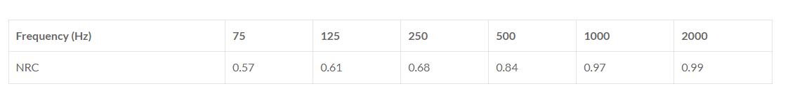

absorption coefficients for the above material taken from the above website:

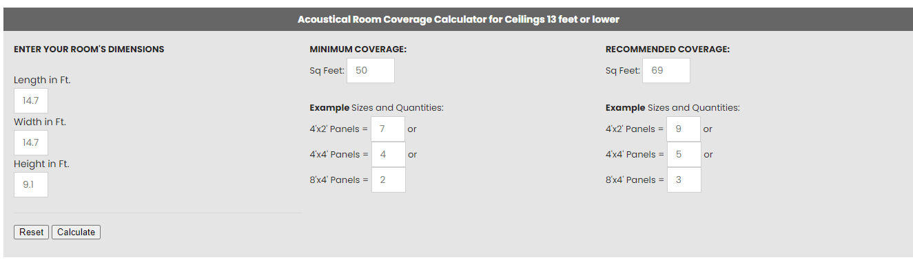

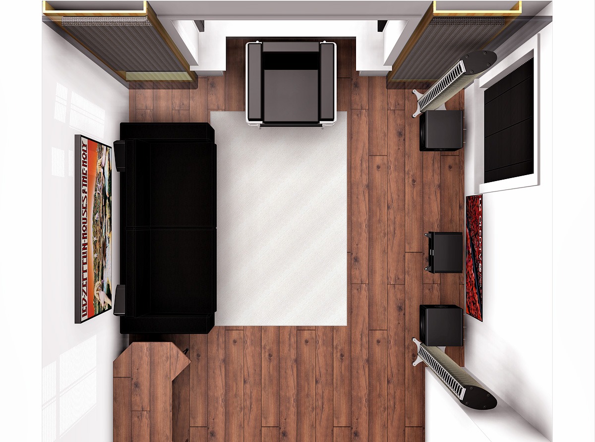

I went to the following site to get an idea about the coverage required in my room and got the below results:
https://www.acoustimac.com/room-calculator/
I am considering getting 4 numbers of 6ft x 2ft gobo-type panels, which have wheels so that they can move if required. Since I will be living in this or another rented accommodation for the foreseeable future, I may have to adjust with non-wall mounted panels if possible. I am not considering buying more such big panels at the moment since a bit more furniture might come into the living room eventually, and a bigger & thicker rug. Diffusor is out of consideration for the moment..
Please let me know if the above ideas would be of any use..

I guess if the numbers for that option "1) Geofill" are right, it performs broadband and isn't that far behind the Rockwool and achieves even better absorption at lower frequencies.

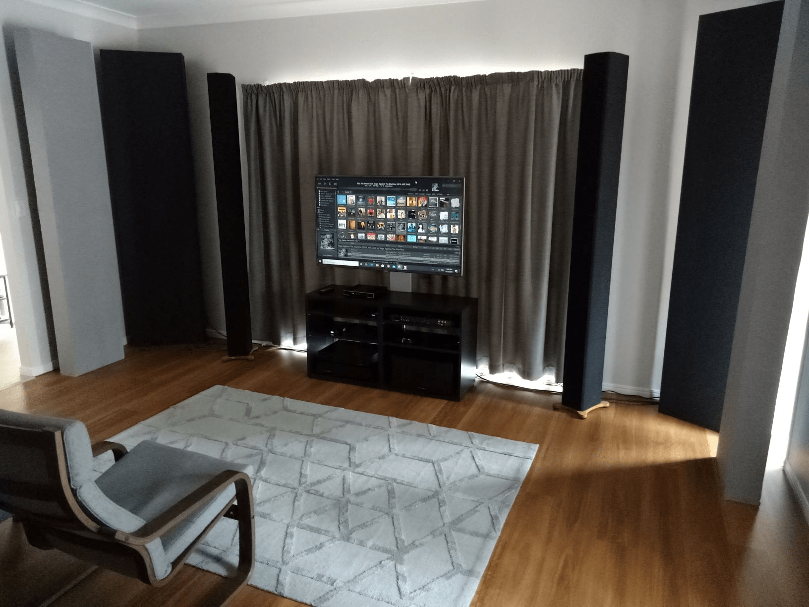

Movable panels are great and it is better to have them off the wall, porous absorbers work best 1/4 WL away from the wall for the lowest frequency but that can become impractical. An air gap works like adding thickness and is advisable.I am considering getting 4 numbers of 6ft x 2ft gobo-type panels, which have wheels so that they can move if required. Since I will be living in this or another rented accommodation for the foreseeable future, I may have to adjust with non-wall mounted panels if possible. I am not considering buying more such big panels at the moment since a bit more furniture might come into the living room eventually, and a bigger & thicker rug. Diffusor is out of consideration for the moment..

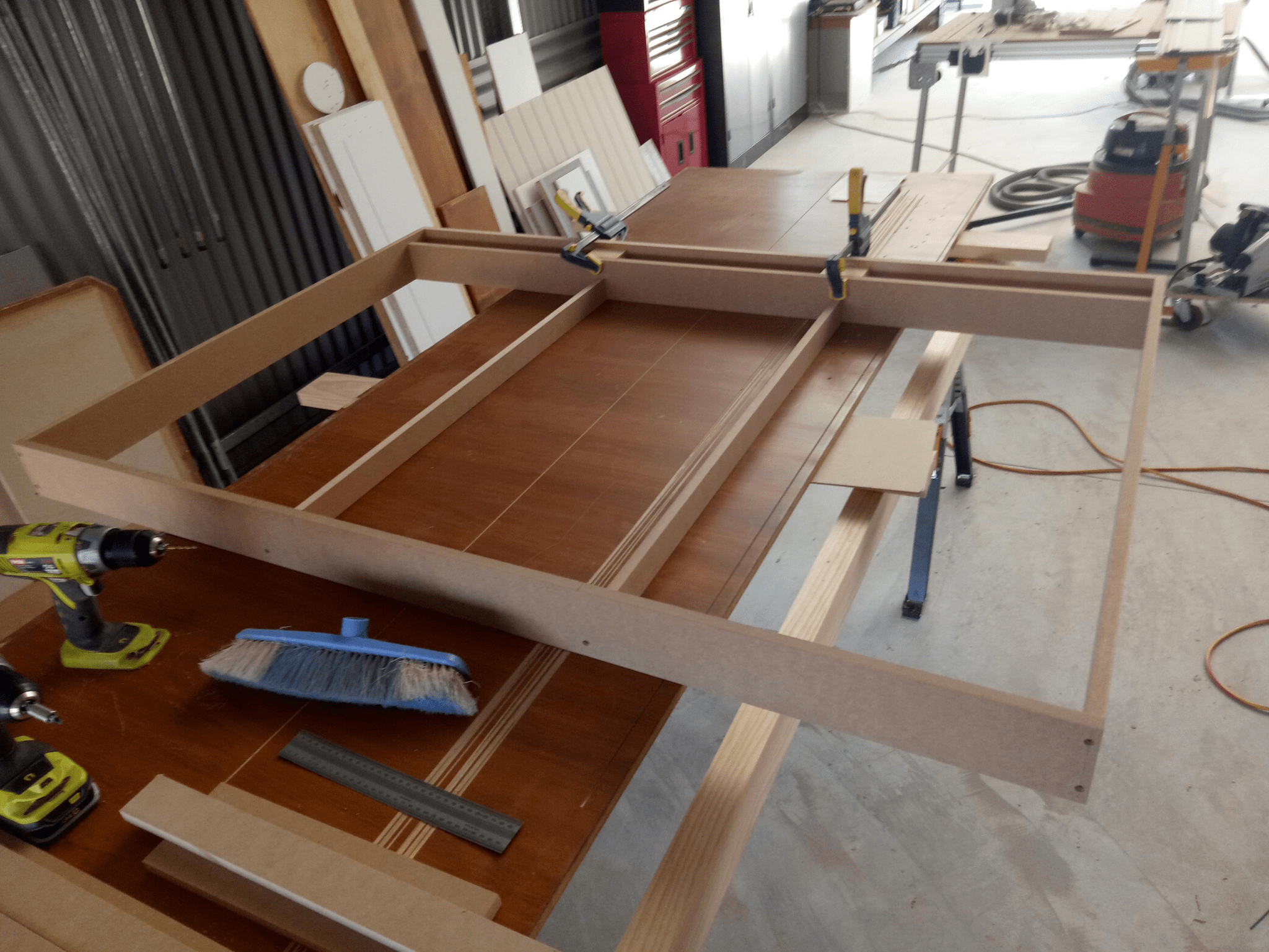

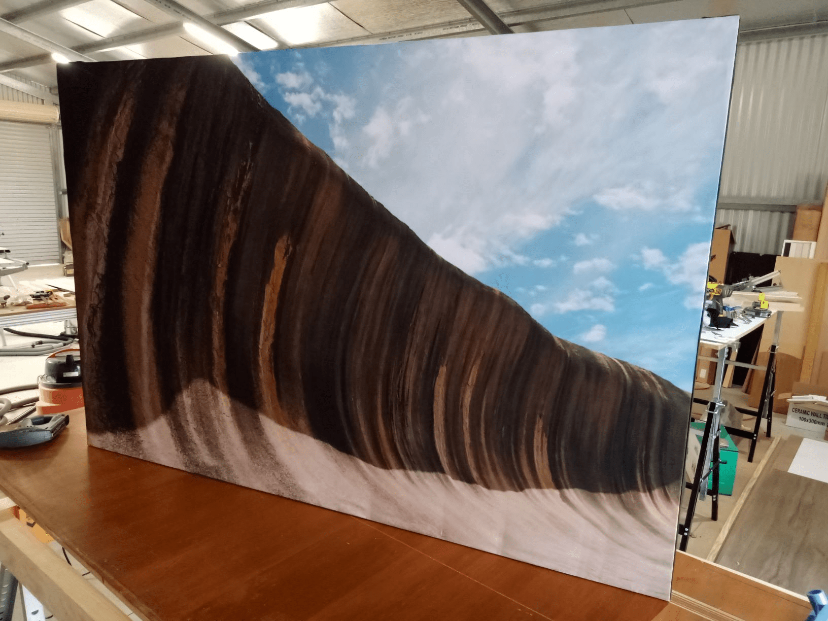

My panels are 150mm or 200mm thick sized to fit the width of the roll of insulation. They both free stand quite nicely with an MDF frame and are covered with fabric on both sides. The dark grey panels are 200mm and straddle the room corners and the light grey panels are 150mm spaced away from the wall. I don't find them visually intrusive.@hifijim decorative kind of fabric, I am definitely trying to get.
I have another printed panel that is not as thick as it is wall mounted.
Frames are quite basic
