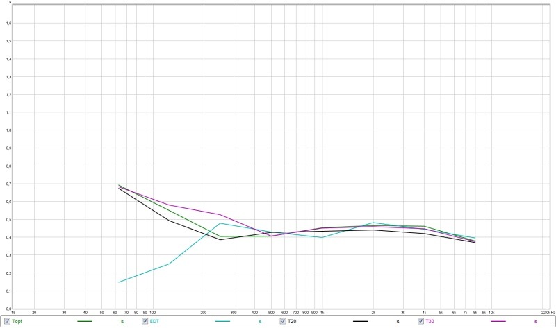

As a comparison to the previous posted data in this room...
RT60 measurement, mains + ambience of a straight, unshaded straight array in a living room at listening position:

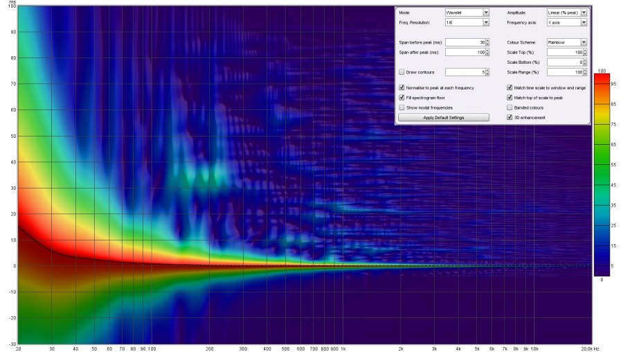

Wavelet of the Stereo pair (after DSP and room treatment):

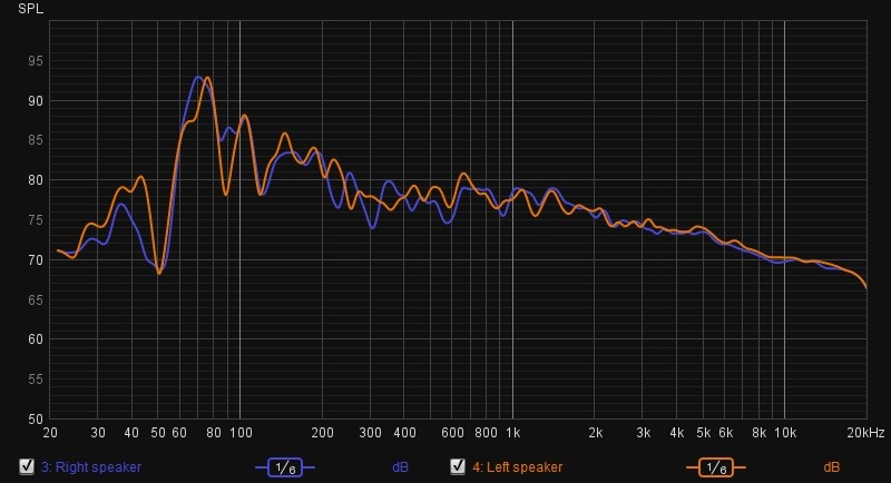

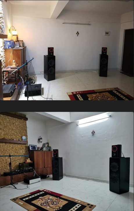

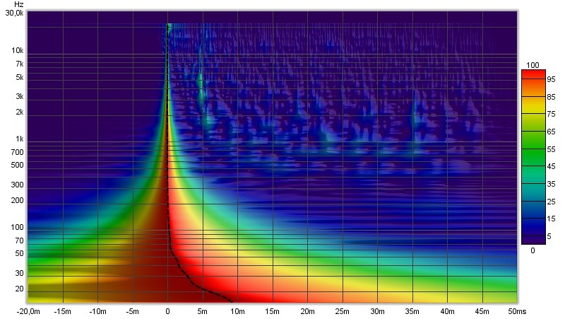

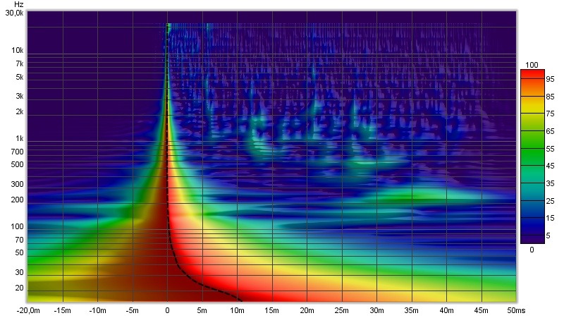

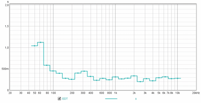

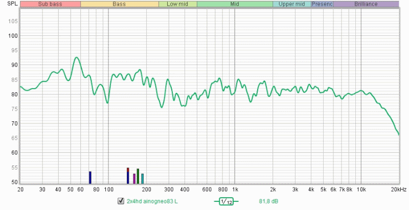

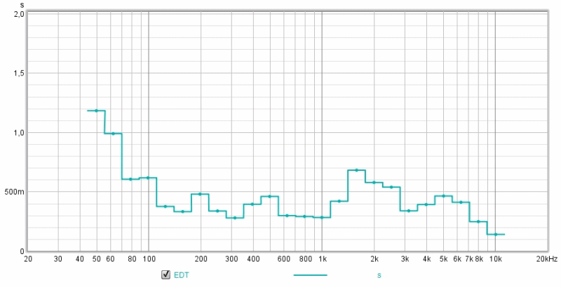

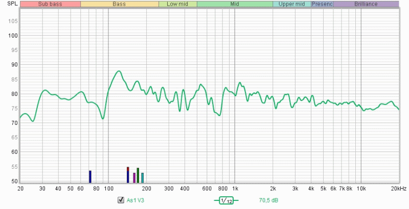

So here is where I start from for the new speaker locations (echo chamber v2) 😀
Frequency responses of L& R speakers from close to listening position 2.5m away

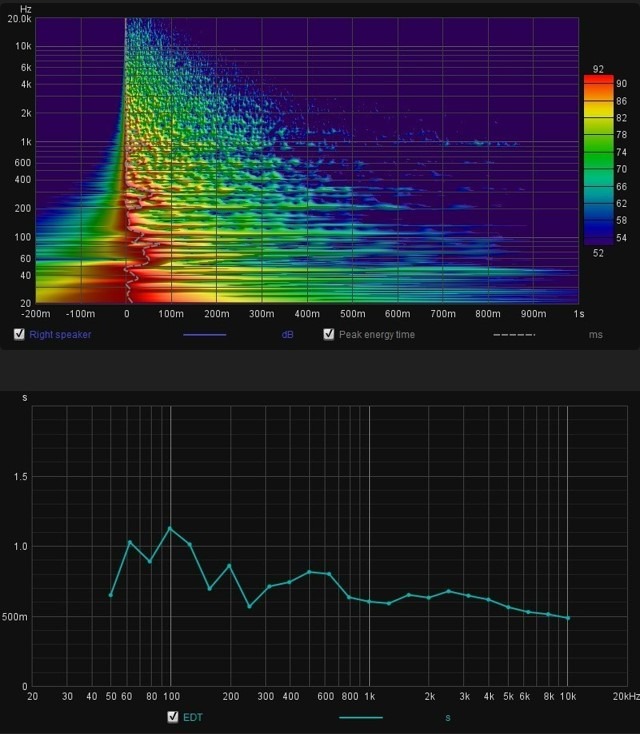

Spectrogram+EDT
It sounds better than before though already.. 🙂
Now need to get some absorption panels.. If I am going to cover about 25% of the wall surfaces itself, there is lot of area to cover and that too in a living room.. 😀

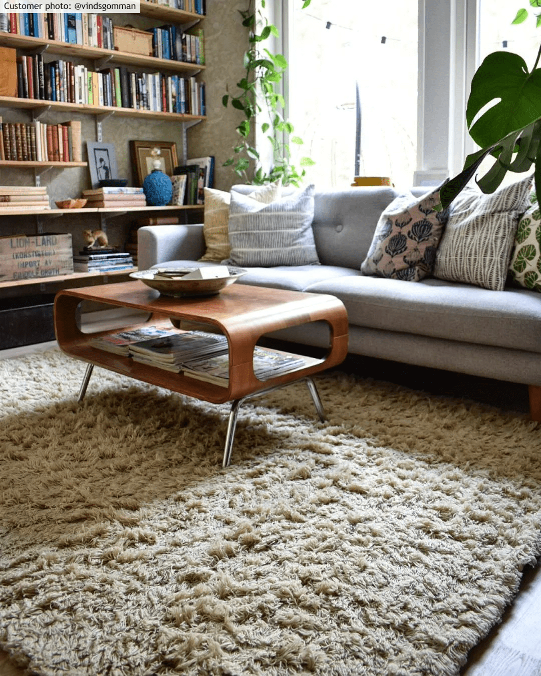

That looks like a very very cozy place..Good ole bookshelf half filled with books etc. useless crap could take other sidewall...
A big woollen wall cloth (carpet?) hiding acoustic panels behind the listener...
Lamb's fur rug on the floor and a small table...

Vineeth,
if you can, just for test, put bed mattres (or two) vertically on the wall between speakers. Two chairs left and right from speakers on first reflection spots and hang two blankets over chair rests. These can be close to the speakers, away from side walls. Also one blanket on the floor. It is quick and simple and covers large surface area. You will not believe how big is the dfference. It could happen that you change opinion on your speaker sets...
After my tests I bought another layer of curtains, thicker carpet, and TV screen was kicked out from the wall between speakers...when you make good apsorption and midrange decay, imageing is getting really razor sharp, almost unbelievable, even from midfi speakers where you would never expect something like that...
I also like in bad rooms Gerhard placement, it can give very good results, especially if you have problem with bass modes...
Yes TV between speakers is not ideal. A projection screen is better. But no screen is the best. But you have to make do with what you have. My current home since 2022 is northern Australia; tropical climate with temperature ranging between 22 and 34 C on any given day. Wild wet weather and risk of tropical cyclones requiring bunkers for shelter/safety.
So as much as I would love to have thick rugs, (this is really good, as Juha suggested) just looking at thick rugs my home makes me feel ill.
Just add your mix of furnishings as how you would live. Asymmetry is good.

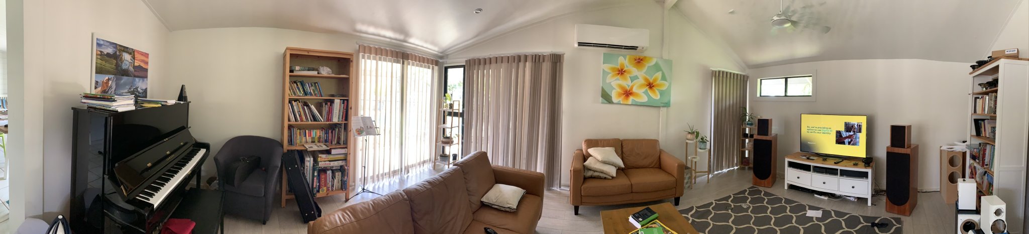

Here's a panoramic view of my current living room in 2022.... the curtains, bookshelf and chairs really helped for the piano...

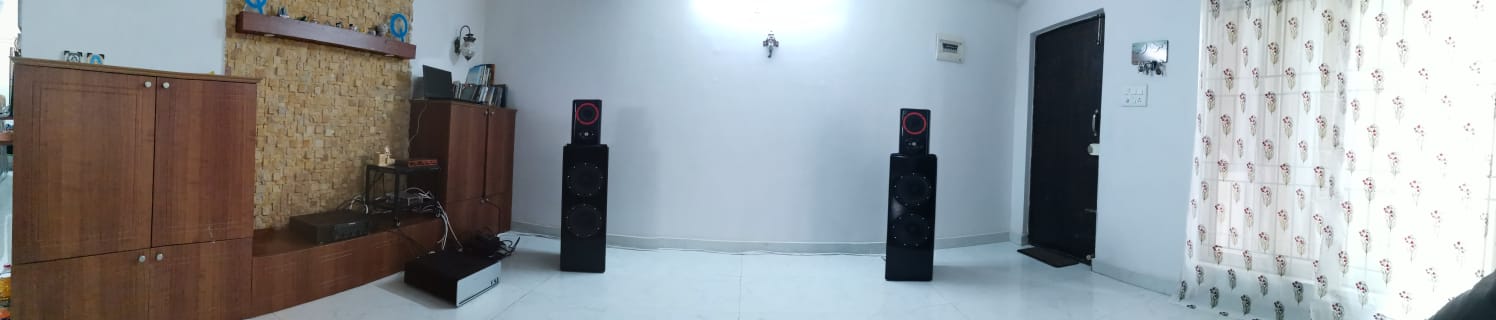

Below is a panoramic view of the room from listening position 🙂

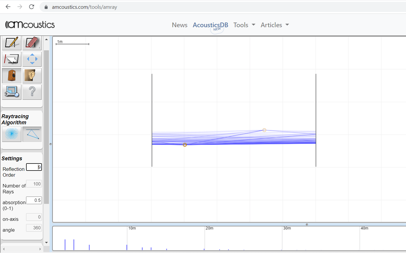

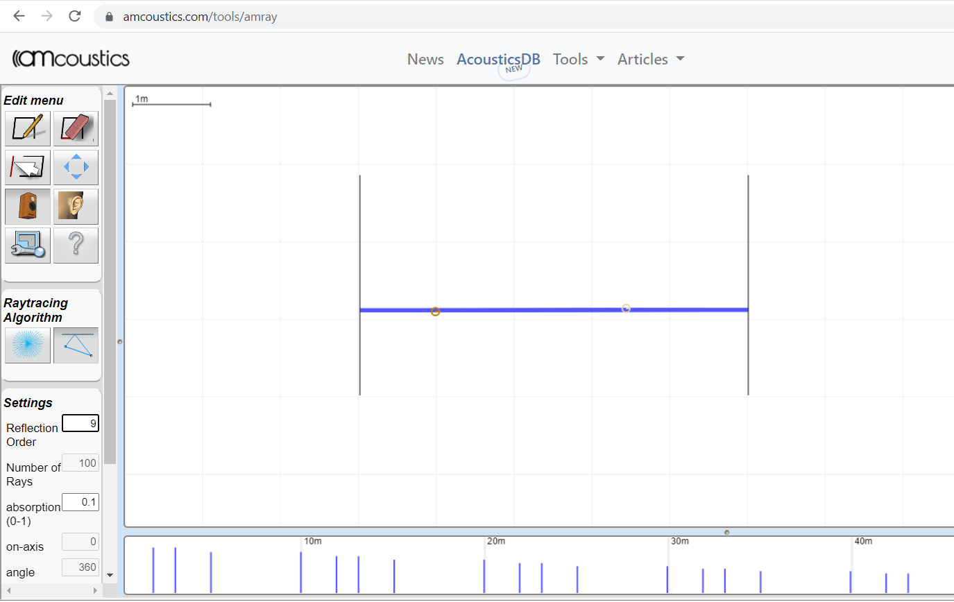

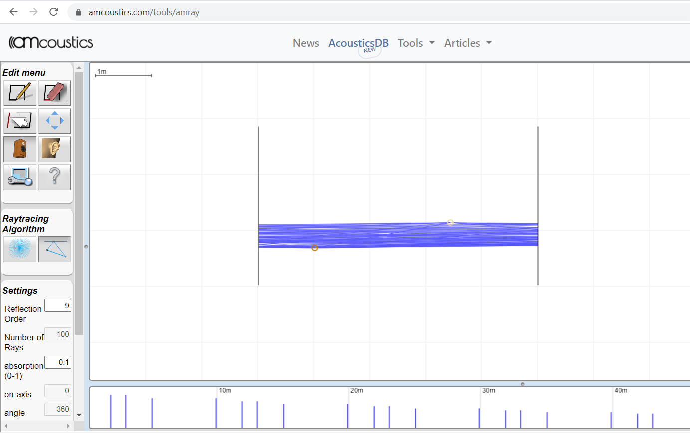

Here is simplified demo for flutter echo, sound bouncing between two walls, to illustrate the thought process. Two parallel walls, front and back wall, point source loudspeaker on the left, listener on the right, 9 order reflections showing meaning in this 5 meter deep example room a flutter with 9 reflections, or 45 meters of roughly 150ms for easy calculation.
About nothing happens if the source is lowered, if you check out the repetitions they happen about the same time and same intensity. Clapping hands in front, above or below the ears would probably sound about the same if there was only these two walls and their flutter.
But if we emulate effects of furniture below listeners head by adding attenuation to the sim we see amplitude of the reflections reduce. In reality a sofa the listener sits on would diffract and reflect and attenuate breaking periodicity and reducing flutter even more I think, line of sight between the parallel surfaces is broken. The purpose here is to demonstrate that furniture can intercept the reflections that happen between walls from sound source below listener head without affecting the direct sound.

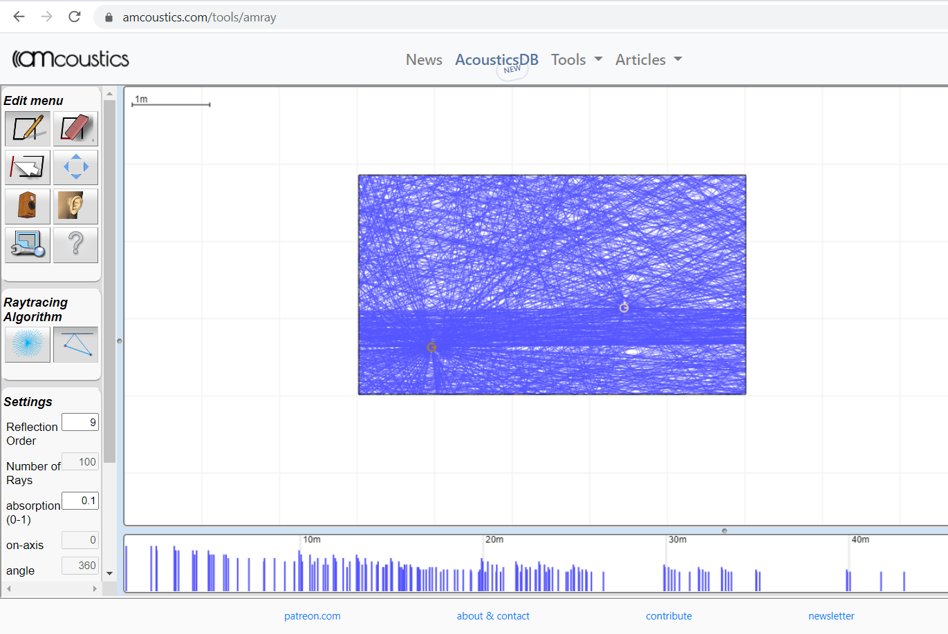

This is fun simulator, floor and ceiling boundaries added in with 9 order reflections includes sound bouncing through multiple boundaries like from floor to ceiling to back wall to ear and so on. Coincidence or not but wall flutter kind of whows up nicely as the source and observer are nearly on same plane and lines bold up, while everything else looks more or less chaotic, reverberation.
What makes flutter the distinct sound is resonance, periodicity of the distance between the boundaries, and quite many reflections. In a really bad situation the flutter duration is quite long, easily this ~200ms or half a second or even more.
