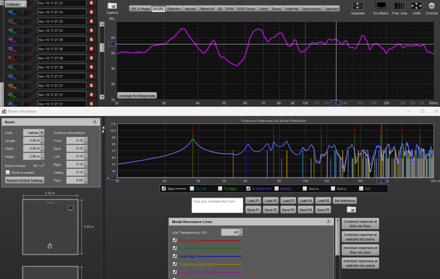

I played around with REW room mode simulator to see if the things I see in the MMM measurement correspond to some room-related issues. I can see a good agreement between the room-mode sim and my measurement, especially below 100 Hz. Here is a comparison plot.
The top pink plot is my right speaker's MMM (spatially averaged) response in my listening area.
The purple one below it is the room mode simulator output (based on room dimensions shown on the left hand side of the above pic). I left all the absorption coefficients as default values.

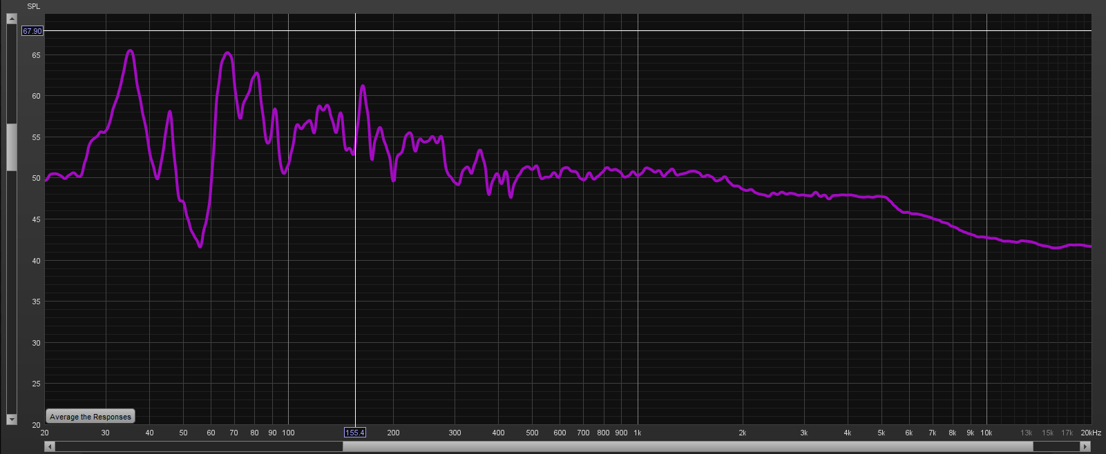

Here is the speaker's full MMM response just for reference
It seems like the axial length and width modes are aligned due to the same dimesions and causing some damage in the form of peak. The more destructive one seems to be the Tangential length/width mode causing that deep notch in the 50-60 Hz region..
Now I need to find out what to do about them (alternate placing of the speakers in some other location in the same room/another room is nota possibility for me)...

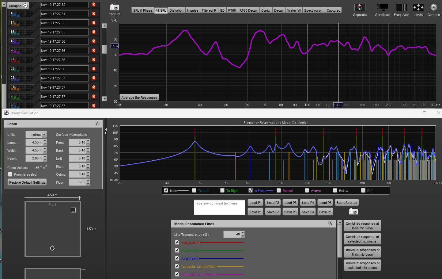

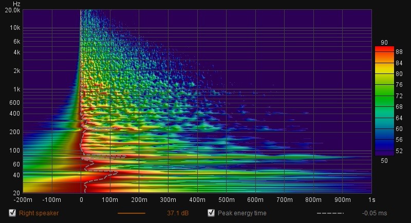

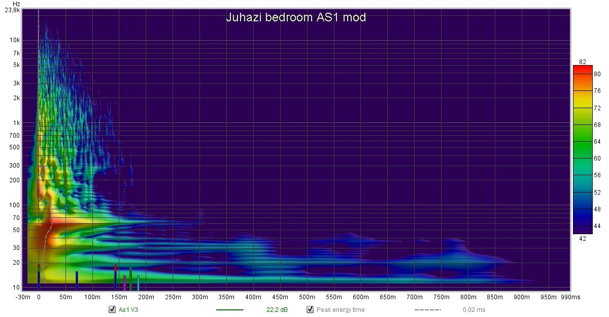

There is a considerable difference between the MMM and the spectrogram, the null pattern is not the same. This isn't unusual and depends to some extent on how wide a circle you used to move the microphone.I played around with REW room mode simulator to see if the things I see in the MMM measurement correspond to some room-related issues. I can see a good agreement between the room-mode sim and my measurement, especially below 100 Hz. Here is a comparison plot.
A test you can do yourself is to sit in the listening position and sweep REW's generator up and down in the low frequency region to see if there are any frequencies or areas that disappear or are quieter, the modal peaks should be obvious. You can do this with either speaker separately and both together. Often how the two speakers combine in frequency and phase will be different to the two individually.
The peaks can be dealt with by EQ and are not much of a concern but the nulls require a different position between speaker and boundaries as under 100Hz becomes difficult to deal with simple treatments.
In the spectrogram you can see that where there is a frequency response dip there is a time delay, the peak energy is pushed to the right. Does this actually sound like a frequency response dip? These are some of the things to consider to determine what you see in measurements and what you hear.
When you can equate a measurement to something you can hear it makes it much easier to decide what to do.
