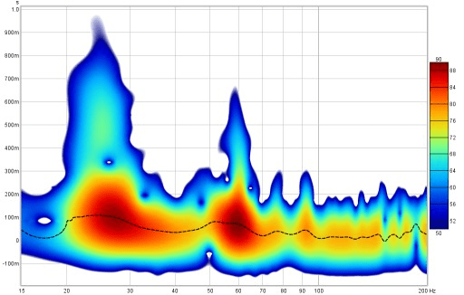

I don't like the idea of Dirac either, and haven't installed it. Basically, regarding timing/GD, it tries to correct the highest amplitude of response to same arrival. But it can't do anything about "tails" ie. modes/reverb unlike room treatment or positioning of speakers and listener. But I'm not an expert...
Wavelet of a room response in REW https://www.roomeqwizard.com/help/help_en-GB/html/graph_spectrogram.html
https://www.ohl.to/
