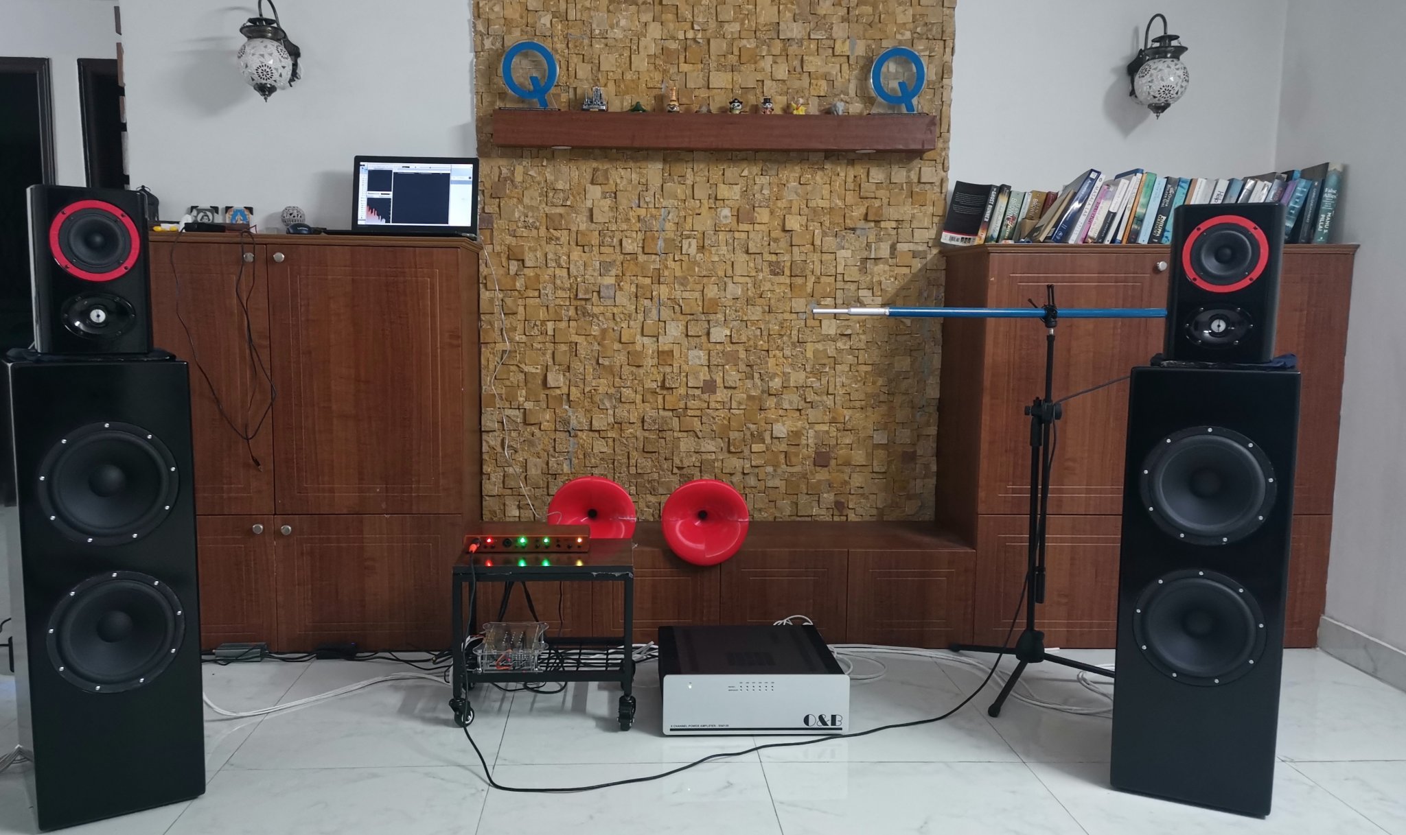

Today's system under evaluation
First impressions: Sort of slightly "relaxed" overall than my previous 2 way horn configuration. Placement of instruments, vocals etc within the soundstage is a little less clear than before.. In the horn system, it can be easily identified to sort of different points in space. In this one, that definition is sort of blurred..
Maybe for longer listening sessions, this will be easier to listen to I guess..
But I like both.. This is getting really hard..

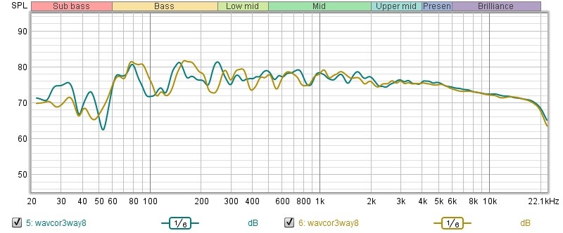

But I just took measurements at my ear height (on tweeter axis) from my listening position about 2+m away near the sofa. This is how it looked for both speakers
Then I allowed REW to make some auto correction.. The result was this

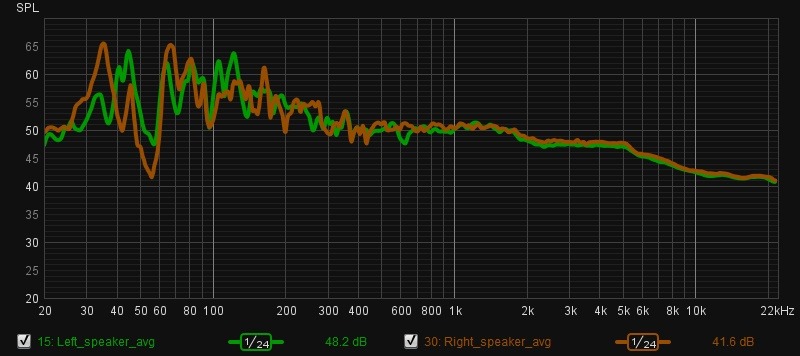

So I did the MMM measurements of the left and right speakers..
Here is how it looks like:
I have many questions now.. Some of them being the following.
Is there a standard reference for room correction (book/webpage/document/thread)?
1) In the video, they say look at the measurements only up to 700 Hz or so for room correction. Do I need to apply some averaging (more than 1/24 per octave)?
2) The left and right speakers look like having huge dips at 50-60 Hz region.. what will that be caused by? (strangely, the AC power supply in my region is at 50-60 Hz frequency, so I had doubts about is it being caused by some hum due to that or actual room modes)
3) Are there standard room correction target responses (other than the Harman target curve)? This is so that I will have some reference to start with
4) Do I allow REW to do the correction as per a target curve or need to apply manually (at least in some frequency bands)? (what Q and max gains am I allowed to use while doing this correction) ?

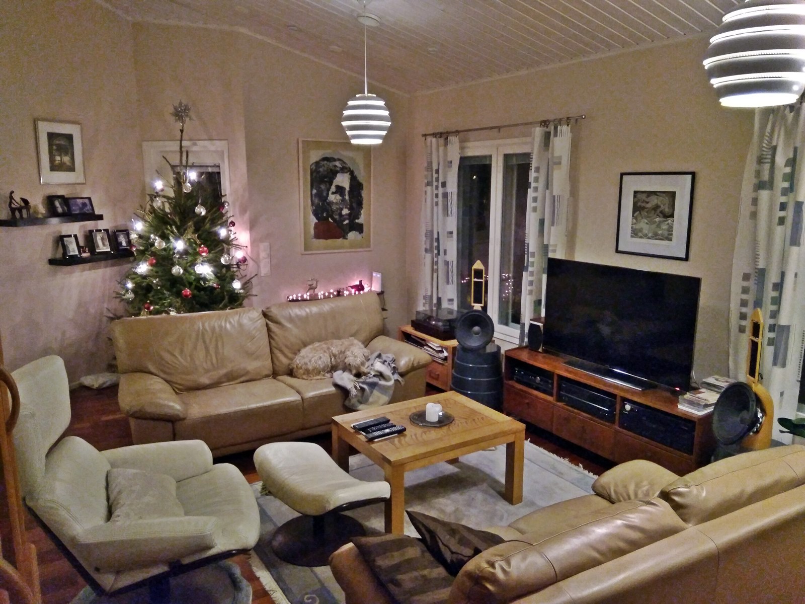

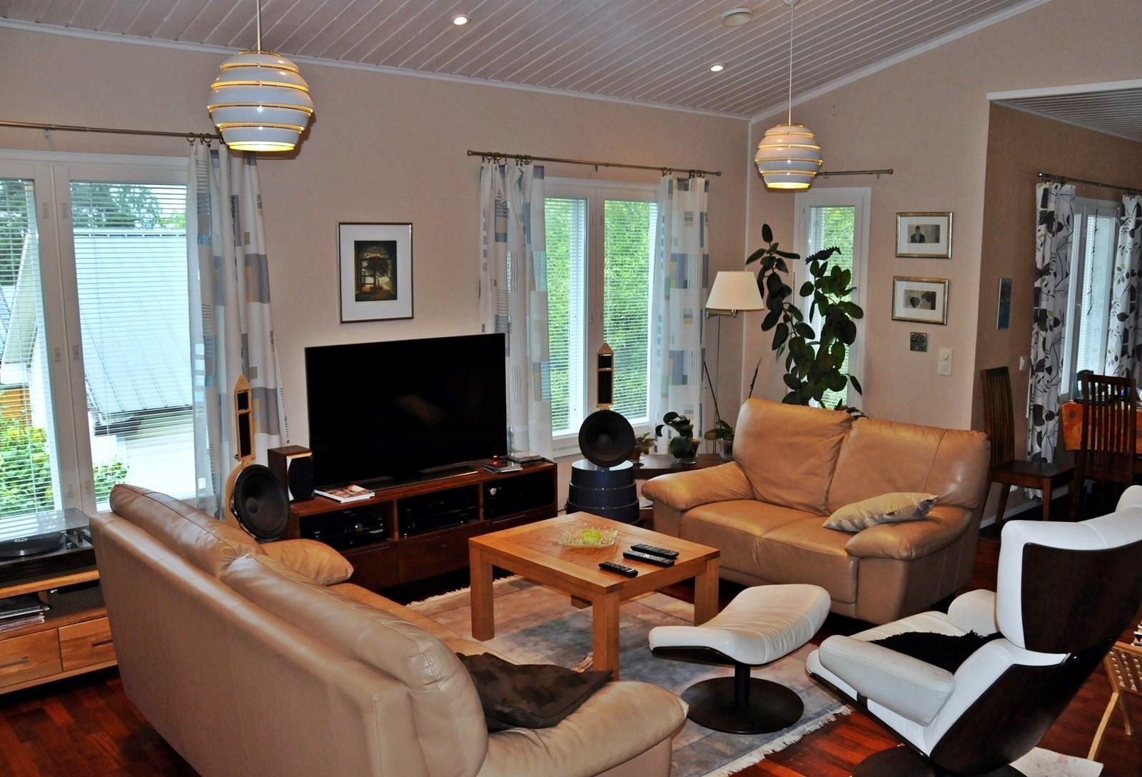

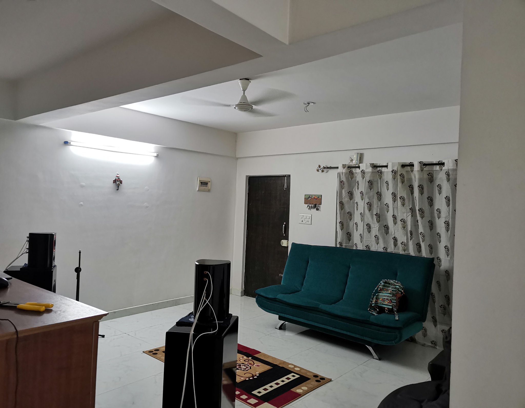

My room is 4.5m (Length) x 4.5m (breadth) x 2.8m (Height). This living room opens into the dining area on one side. Hence the room is not completely closed too.. So 1/3rd of the wall from one side is missing compared to a closed cuboidal box.DSP, Audacity, Dirac etc. with forum discussions showing measurements have made room EQ too technical and people don't trust their ears anymore... And personal preferences are allowed too! We get accustomed to a room's acoustics quite soon, if it is not extreme. A smallish room (smallest dimension less than 4m) has very problematic modes and positioning alternatives are minimal regarding long wavelengths.
It looks like this from the side of that missing piece of the wall
(I can sort of feel from above pic that it is a room mode/refelction nightmare )
Is REW room mode simulatior of any use to identify modes etc in this overall Room EQ process?
Targets to look for when I search for the next accomodation..Classroom size is better for modes but they are typically too reflective (typical situation at audio shows). Open concept living rooms with high tilted ceiling and walls with wooden frames are best. I have three good stereo sets, but only one in a good room.
But where I am living currently, it is very very costly to afford a rented accommodation bigger/having a nicer layout than this current one..

Yes Vineeth, when I proposed the MMM idea I meant to say to compare the 2 different speakers. Not the L vs R of the same speaker.
The dips and peaks you see around 50-60Hz is due to your room. If you measure your woofers in the nearfield eg. 20mm I'm certain there's plenty of output around 50-60Hz.

1) i used REW "psychoacoustic smoothing" which supposedly mimics how hearing system smooths things out. I guess any smoothing would be fine to spot trends in the response. I'm not sure if any dramatic high Q tweaks are benefitical at this stage. You probably got those in the semi-anechoic measurements and are already "fixed" with crossover settings.
2) Since listening spot is near wall there should be no dip on that dimension (room depth), only boost. So I suspect the listening spot is middle of room width and its that, lowest mode of your room width makes a dip. If its true, it migh be gone if you measure both speakers playing simultaneously Perhaps add and locate a subwoofer somewhere center of the room width.
3) There is harman target curve for loudspeakers as well, but as Juhazi and perhaps others said you should do it by ear. Figure out what you like in your room. Any target curve could be of with your particular setup, trust your ears and make it sound good this is what speaker directivity is part of, roughly power response between Schroeder and tweeter beaming, or PIR in VCAD.You might find out one of your speakers sound better than the other on this regard and learn!
https://www.audiosciencereview.com/...e-why-is-it-represented-as-a-thin-line.19886/
4) You can if you want to but I'd go by ear. Due to room modes especially the bass is tricky, weird looking measurement might sound better to ear than better looking one. Take your time and figure out, learn how graphs and sound relate together in you room and speakers. Perhaps try get close to some target curve and tweak from there. Have fun!

You have some very deep dips at about 55Hz in both channels give or a take a few Hz, there are also two separate nulls making it up, this is why the null is skewed to the side. I would guess that you have them 1500mm or so from some boundary or more likely a couple of boundaries that are similar in distance,
I would start with 1dB/octave fall from 20 to 20K, I personally don't like the bass to keep rising all the way down, I prefer it to level off a bit from 100Hz down, but as with all of this you have to find your own preference. You can then go steeper or shallower with the slope and hear the difference. REW can introduce this as a target quite simply.3) Are there standard room correction target responses (other than the Harman target curve)? This is so that I will have some reference to start with
Low frequency EQ is usually better done by hand, REW's auto EQ can be quite helpful but the target settings make a big difference on what it will do, fiddling around with those can generally help to get REW to do the heavy lifting. There is no maximum gain and Q to use or not use and I wouldn't recommend to think like that, sometimes you need to use a combination of filters to get the response you need. REW might use three high q filters to make a wider low Q filter with a specific shape. Having said that if you end up wanting to use high Q's and high boost then you need to consider why and if it will actually make an audible difference. Try it out for yourself to get a feel for what matters.4) Do I allow REW to do the correction as per a target curve or need to apply manually (at least in some frequency bands)? (what Q and max gains am I allowed to use while doing this correction) ?
Learning to read the measurements for yourself is key in understanding what to touch and what to leave alone. The information is not contained within one single graph or measurement, they all have value in making a decision on what to do. The windowing or averaging applied makes a big difference to help get a look at what to change.
Just a quick note: If you do boost a frequency, have the microphone ready to see the result. If a dip is created by something like a wall reflection, you can boost all you want, but that reflection will still be there to subtract the energy. So concentrate on cuts to match the in-room curve you want to create, and if you do end up boosting, see if the frequency response actually improves. Also watch the distortion at those spots.
If you would change the position of the speakers, to be a little less symmetrical, you may be able to avoid having the dips in both channels line up like that.
If youre free to move them wherever you want, you could try setting them up in the corner. A bit like this: https://www.hometheatershack.com/threads/corner-setup-problem.15868/#lg=thread-15868&slide=1. Measure it like that and compare...
