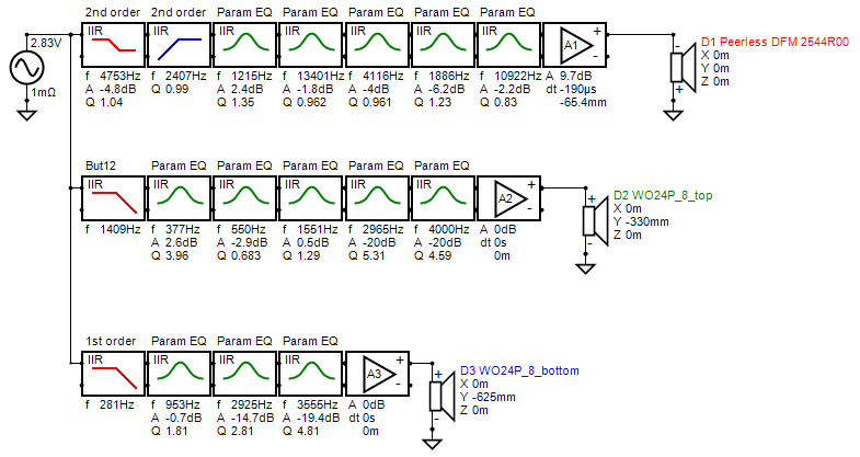

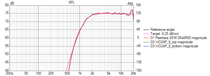

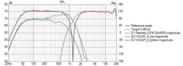

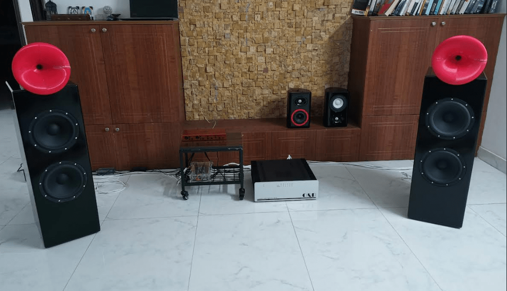

I tried this crossover today:
I think I like this one better than yesterday's crossover due to some subtle differences compared to yesterday's one. 🙂
Still too early to say much. But I think I will keep it for more time and listen and then decide.. 🙂

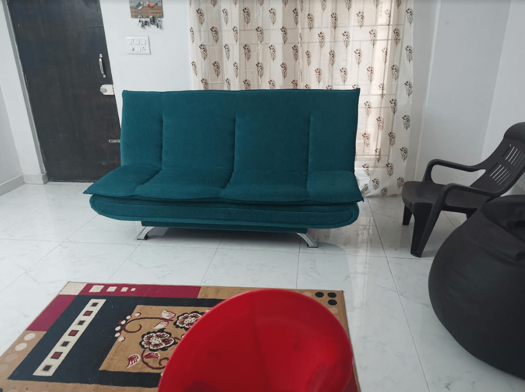

I also noticed two more things
1) Bean bag and sofa seems to affect the amount of bass in the room.. 😀
This is how the speaker sees the area where I am sitting (on that sofa). When I move around the brown colored bean bag on the right side of the pic or the sofa, it seems to affect the low end extension...
2) The single woofer + horn configuration I had listened to at first seems to make the bass in the room linger around for more time (giving an impression of more bass if volume matched) compared to the dual woofer configuration I am playing around with now..

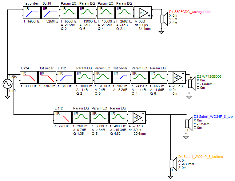

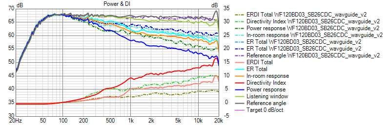

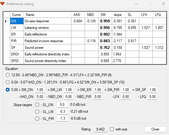

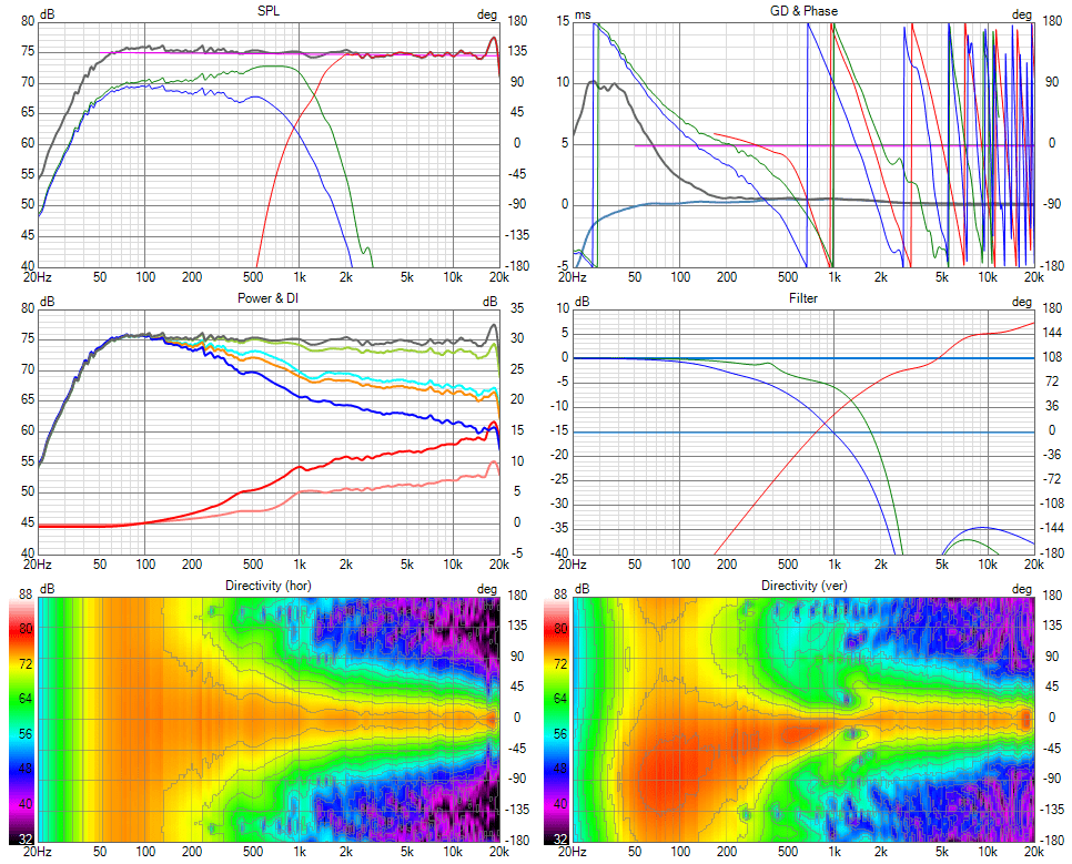

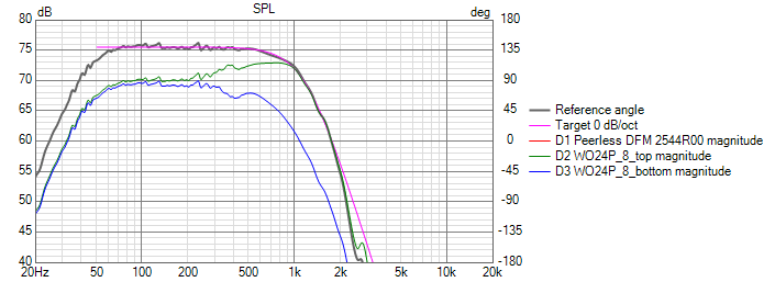

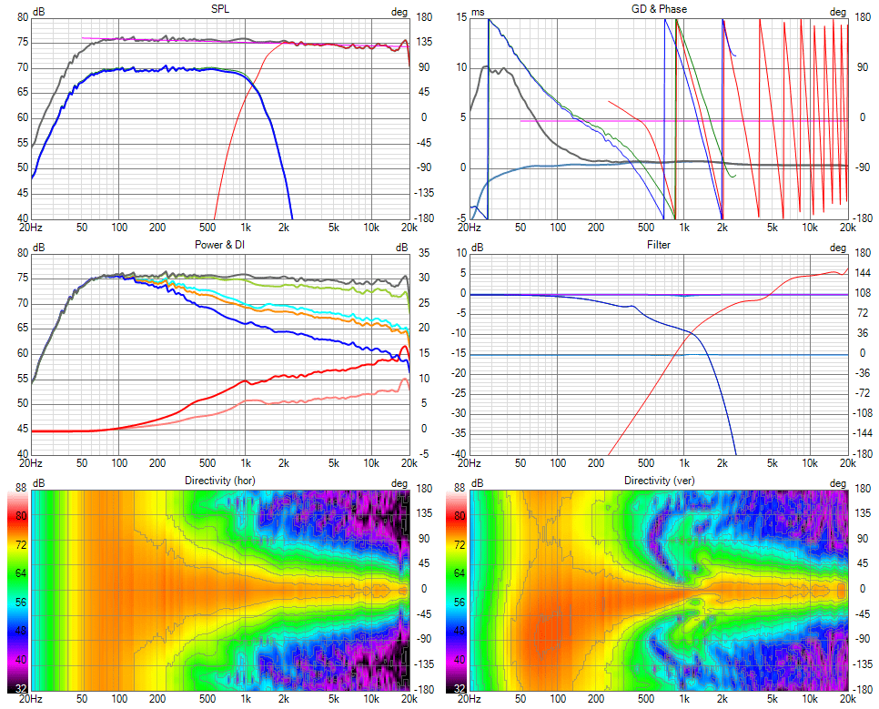

Based on the wavcor mid+SB26CDC tweeter that fluid had designed the crossover for, I cooked up a 3way system including recent measurements for the Satori woofers. Here is how it looks like:
As the next step, I am going to listen and compare between above system and the ST260 horn based 2.5 way system and see which one I like better.. 😀 (in a room where is no treatment)
Here is a comparison of the graphs between the 2 systems (All solid lines are for ST260 based system) 🙂

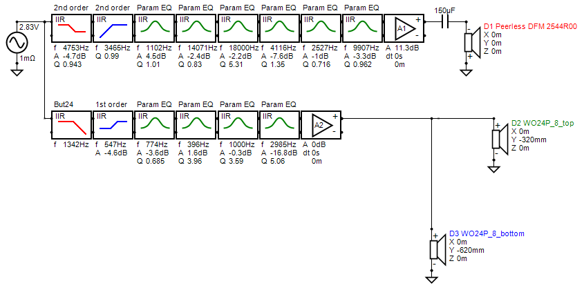

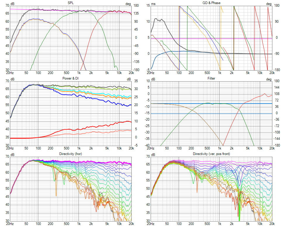

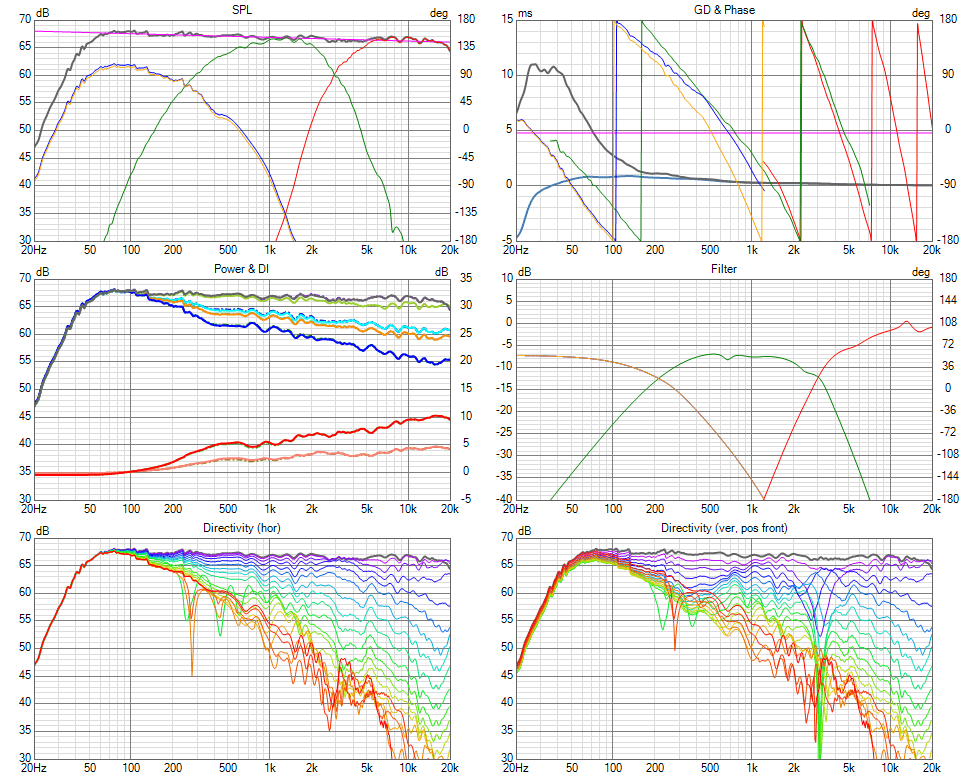

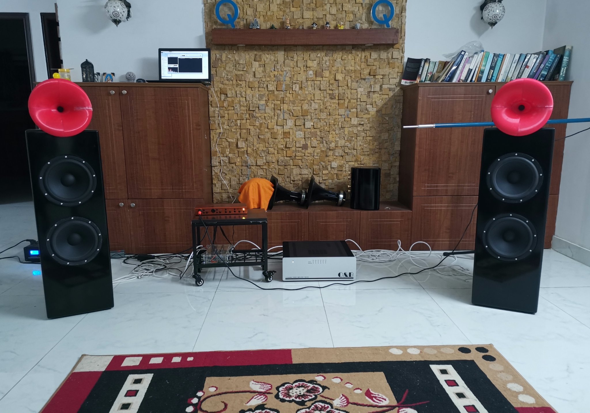

I have been spending some time with this crossover on the horn system (in 2 way config) for now:
To be honest I am really liking this system. My job pressure is restricting the time I get to work on this project but maybe by christmas time I would have determined which one I like more.. The wavecor system or this horn system. 😀

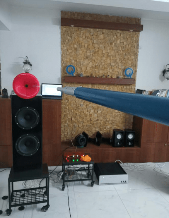

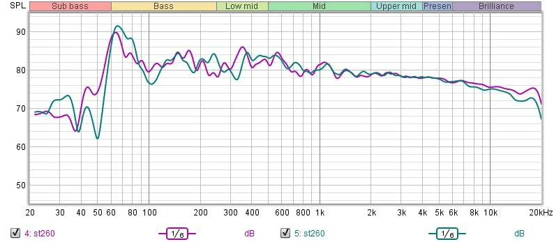

Beloware the in-room responses of both of the speakers taken close to my listening position about 2m away (I think). This is with mic pointing on each horn centre from its location midway between the speakers (speakers are toed in around 30 to 40 degrees) and kept like this sort of left speaker pointing closer to the right ear and right speaker pointing closer to the left ear
The pink curve is the right speaker and green one is the left speaker. Both are 1/6th octave smoothed.

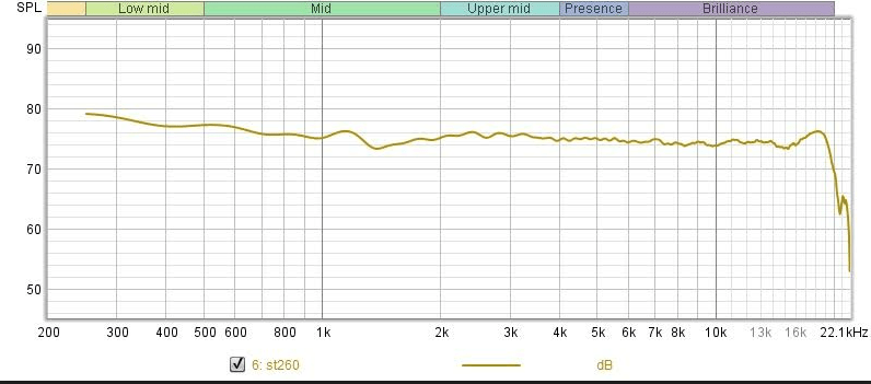

Next is the gated far field measurement of the the left speaker taken about 1.3m away, on horn centre axis 1.4m up from the floor (room height is 2.8m) like this for the left speaker
Here is the 4.5ms gated measurement for the left speaker
I am enjoying the speakers as it is without even any room EQ at the moment 😀
I dont actually know what EQ to dial in or which modes to cut in the above room responses... Please guide me about those aspects.
