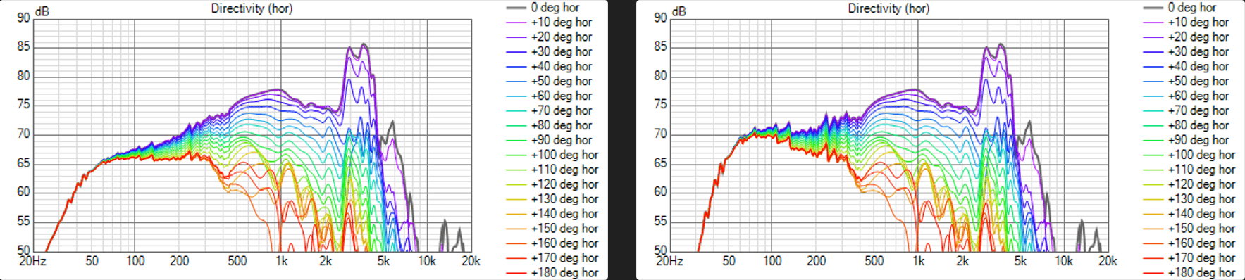

Here is a comparison between above WO24P responses and the one I just created:
On the left is the above responses of WO24P.
On the right is the one I just created with proper diffraction model applied to nearfield response.
What prompted me to think about this is the sort of unnatural drop of about 10dB between 100 Hz and 1kHz. In the right plot, with things taken care properly, I see a 6ish dB drop in the right hand side plot, which also makes better sense, I guess.. 😀

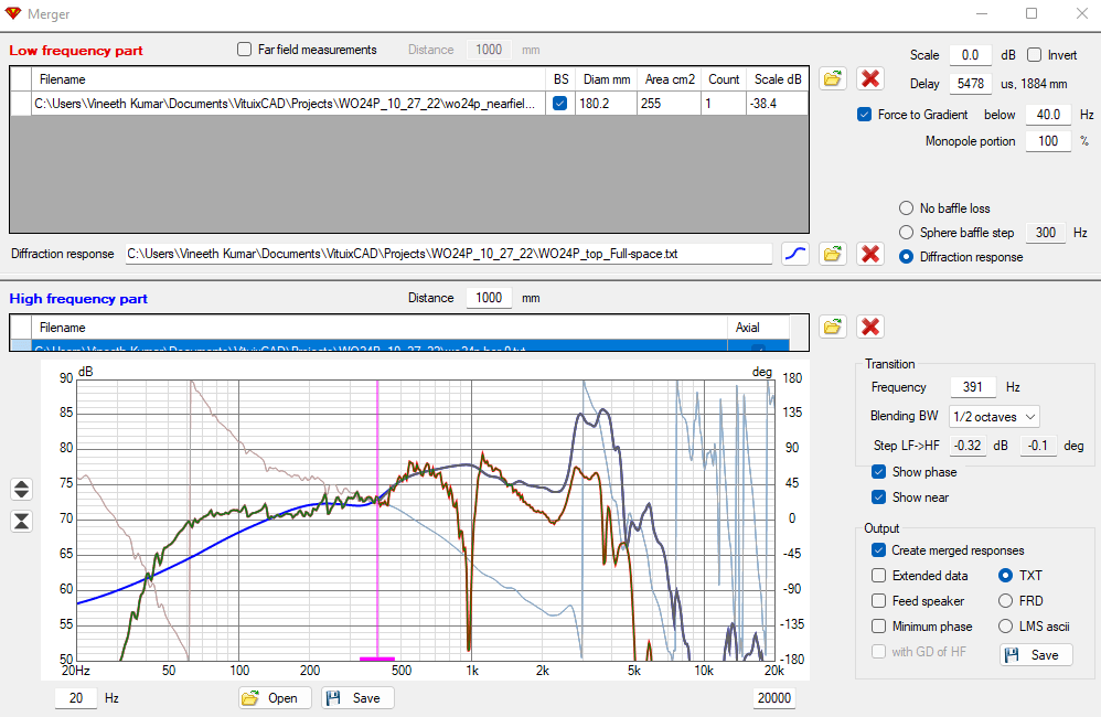

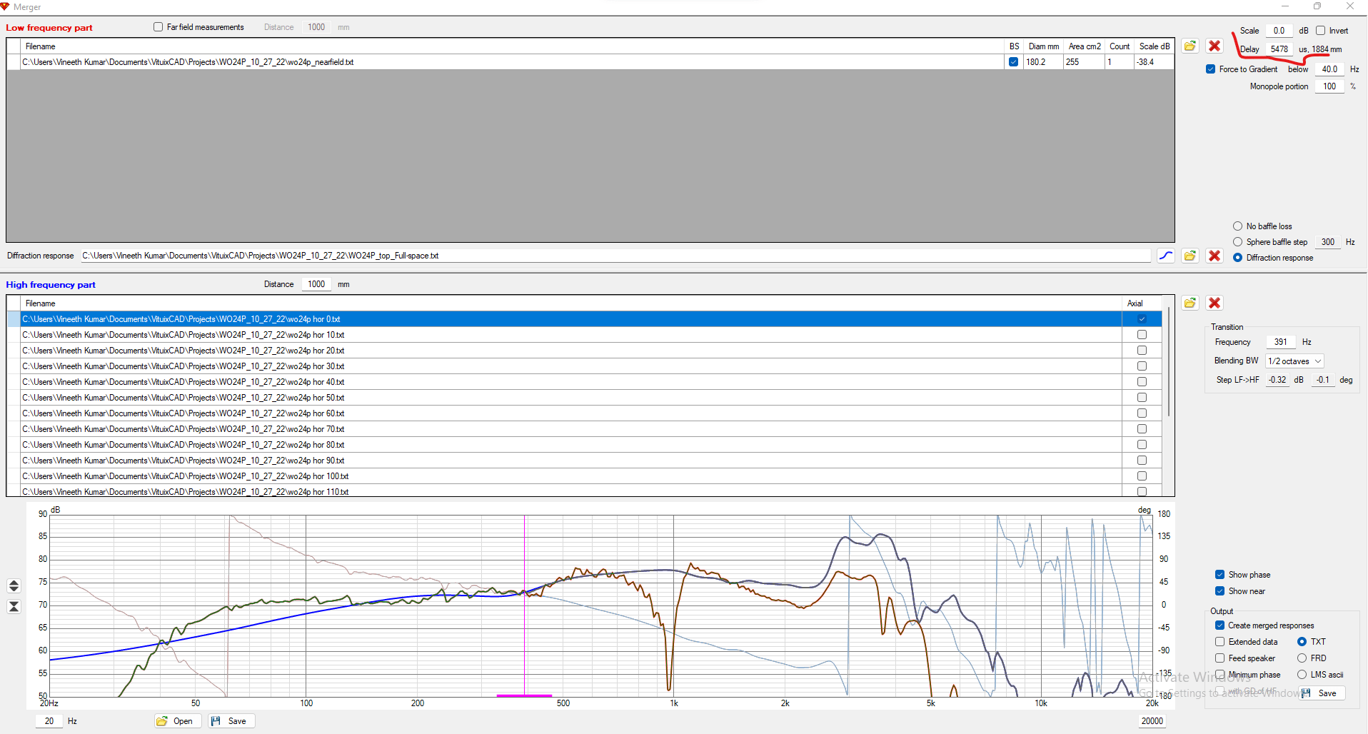

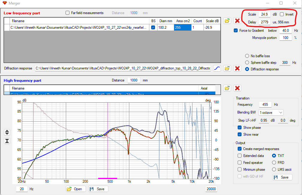

The manual saysAnother doubt regarding merger tool. Here is a snapshot of what I am seeing while doing the merging:
Why is that delay 5478 micro seconds? What is it doing there?
"Delay of low frequency part is calculated automatically on transition frequency change but can be adjusted manually"
I take it to be the calculated delay between the two measurements that are being merged, does that correspond to the difference in distance between far field and near field that you used?

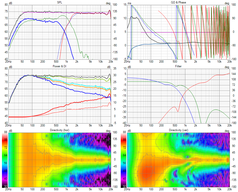

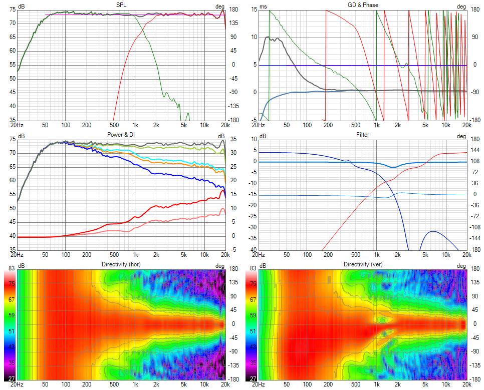

So this is my best effort 2 way with this combination of drivers so far 😀
But now things seem to make better sense than before in terms of the driver responses
I am going to listen to this one next.. 😀
@fluid : Thanks. As always, your suggestion regarding the delay in merger tool seems to make the most sense in the context of this set up.. 🙂
That delay corresponding to 95.6cm as shown below seems to be pretty close to the difference between the distances at which farfield response was taken (mic about 1m away from baffle surface) minus the distance at which the nearfield response was taken (mic about 0.6cm away from woofer dustcap).
I have redone the woofer responses again and the most updated version of this project is uploaded here.. 🙂

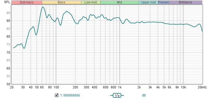

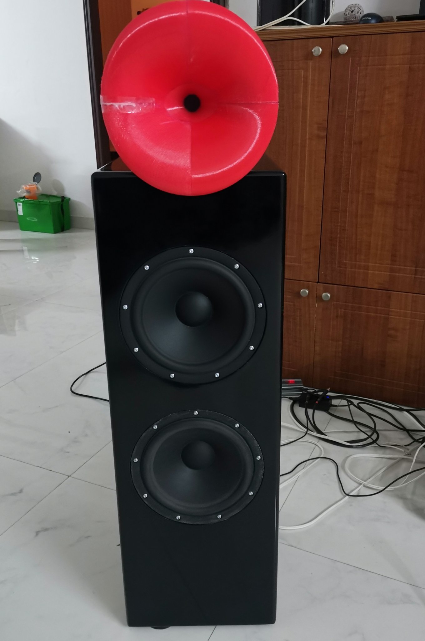

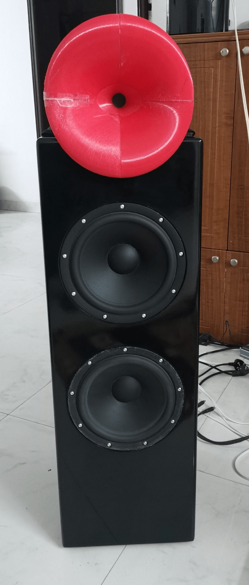

I just heard this configuration of crossover implemented in the system (with a single woofer for now)
This is what I got at my listening position 2+m away (1/6 octave smoothed):
Pic of the speaker as I was hearing it
I can definitely say that this is awesomely good to hear.. Even in mono, this is the best I have heard so far.
I guess there is something about CD+horn that I like. If I am asked to say one or two words about the sound, it is natural and effortless and dynamic.. 😀
I am definitely going to make this system... atleast as an add on system along with anything else I make.. 😀

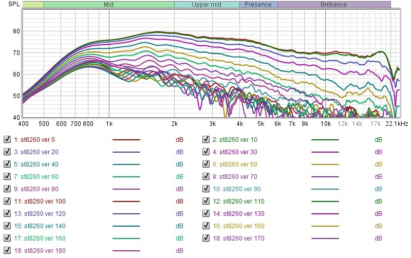

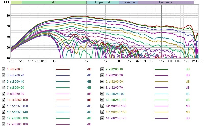

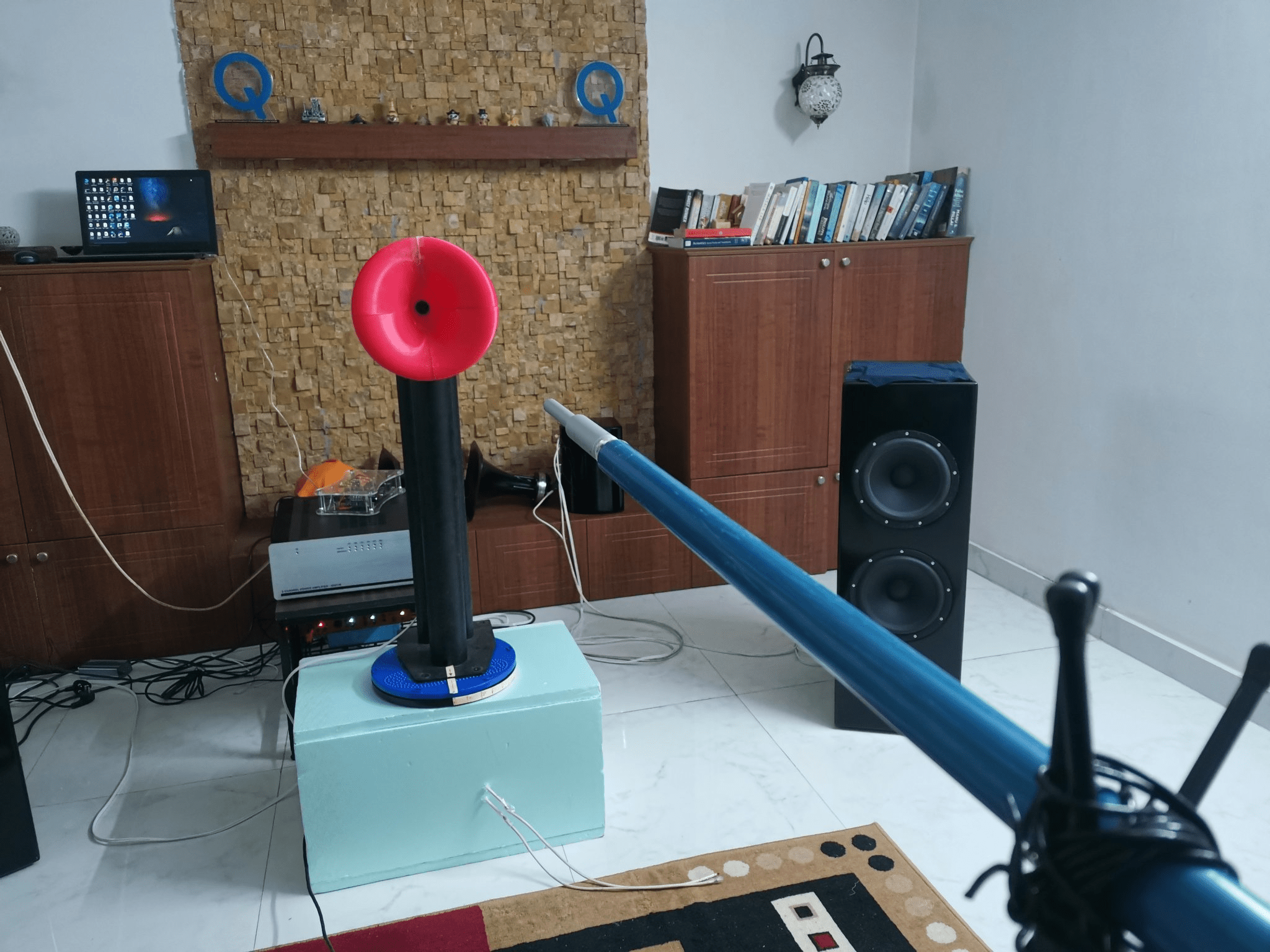

In other news, there is something I had left halfway some time back. It was to take the measurements of the ST260 KVAR horn. The accidents due to measurements set up and 3D printed horn getting damaged prevented me from continuing that experiment at the time. Well now I have printed in once more and did the measurements. 🙂
(The following content is a bit of repetition of the post I made in the ATH thread but still posting it here for the sake of continuity if this thread)
These are raw horizontal and vertical polar (4ms gated, mic 1m away from horn outer surface) measurements of the ST260 KVAR on Peerless DFM 2544R00 compression driver.
Pic of the measurement set up (This is what I thought is the vertical polar measuring configuration of the horn)
Horizontal polars
Vertical polars
Temporary system set up
I will create a VituixCAD project with all this data loaded soon and post it here.. 🙂

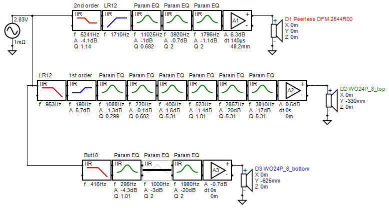

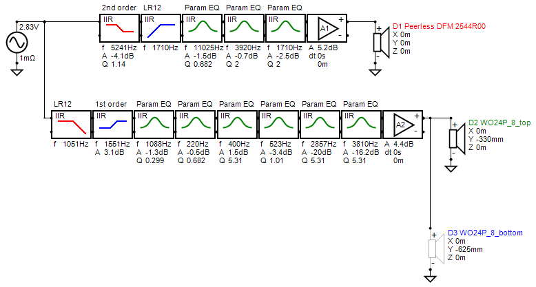

I like your enthusiasm, Vineeth. Your merging process in post 768 looks correct, the merge frequency of 455 Hz seems a good compromise. The woofer responses look very reasonable.

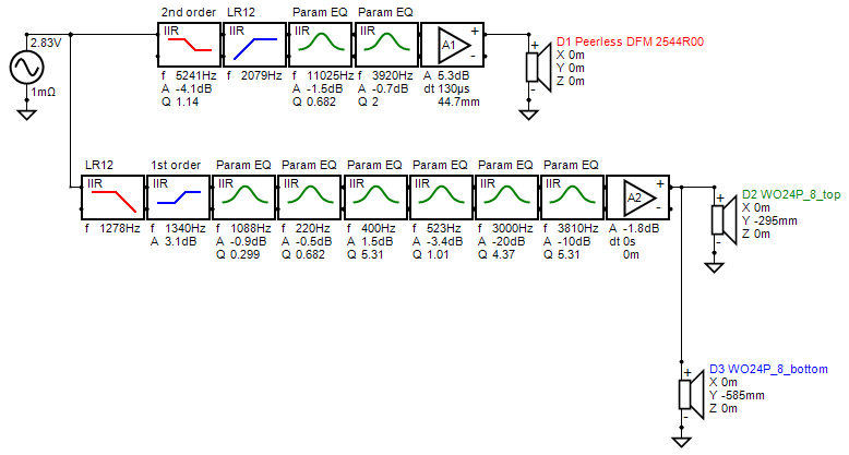

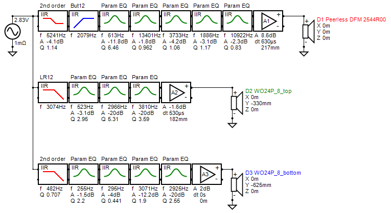

So here is my 2.5 way.. yet to try but only in a day or two.. I want to enjoy the current system for the moment.. 😀 😎
Thanks a lot @hifijim. 🙂 🙂I like your enthusiasm, Vineeth. Your merging process in post 768 looks correct, the merge frequency of 455 Hz seems a good compromise. The woofer responses look very reasonable.
If you and @fluid had not prompted me again and again to check the woofer response, I would have missed all this fun...
That looks like really good response. 🙂
Have you tried a traditional 2.5 filter topology? This is where the filtering (and level) on the two woofers is identical except that the lower woofer has a first order rolloff starting somewhere in the upper bass. Both woofers play equal in the bass range, and the lower woofer first order rolloff compensates for the baffle step. This topology tends to get the most bass performance out of a pair of drivers.
I don't know if it would improve your system or not, but the conventional/traditional is always worth trying.
One nice aspect of your filter is that the upper woofer has ~ 2 dB less output in the deep bass, which means its IM distortion performance will be slightly improved in the midrange. The lower woofer caries more of the deep bass task, and it contributes less in the midrange.

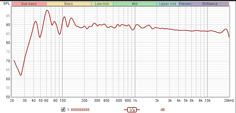

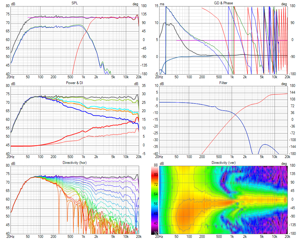

I just heard the system with above crossover.. It is amazing.. 😀
Here is the in room response after I applied a tiny bit of room EQ at the location where the mic captured the following attached recordings.. ;D
Attaching one more recording after a lot of compressing the file.. 🙂
Oh and all these are some 128 and 256kbps mp3s playing.. 😀
And another thing I found is for any room EQ, I don't have to touch anything above about 1kHz probably due to the waveguide 😀
