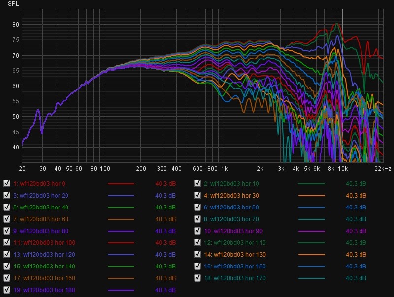

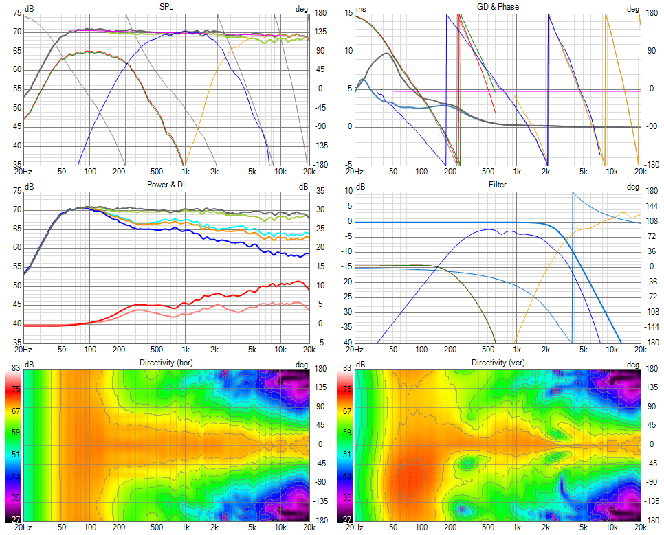

Next round of measurements. This time with Wavecor WF120BD03. Please dont ask me why the driver adaptor is red.. (I ran out of other filaments)
I noticed that 3-4 kHz bunching. It is probably due to baffle size and shape I think.
This is what VituixCAD diffraction tool shows for the baffle simultion for this driver:

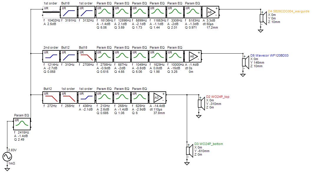

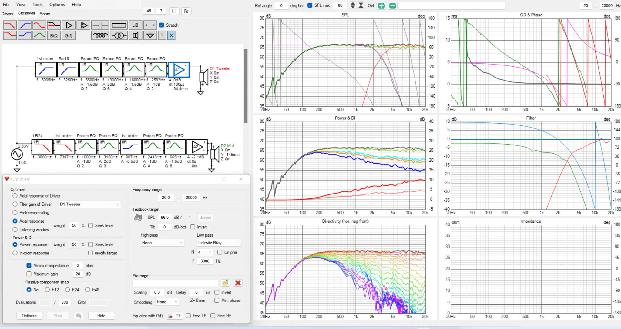

I designed a preliminary crossover with above data:
This one looks slightly better than my SB15CAC graph I think..

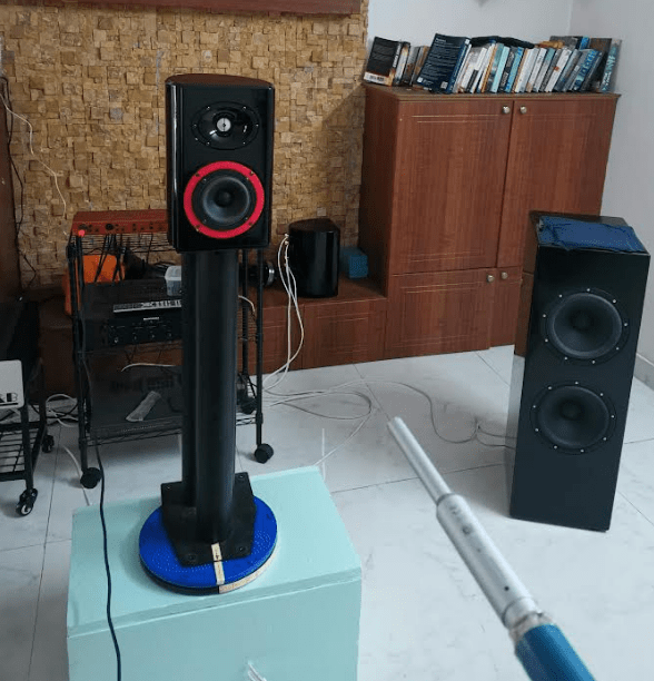

Still struggling with taking vertical polar measurements due to the curved cabinet.. I will try to do something about it.
Please find the VituixCAD project attached with this post

The first thing I would try is to make a soft cushiony shelf using towels and bits of foam. This will conform to the curved shape of the speaker.Still struggling with taking vertical polar measurements due to the curved cabinet.. I will try to do something about it.
The little wavecor driver has nice performance, and your preliminary crossover has a lot of potential.
Sounds like a job for some 3D printed wedgesStill struggling with taking vertical polar measurements due to the curved cabinet.. I will try to do something about it.
I have had a play around with the project data. There is something going on with the woofer to mid transition that is making a good phase blend hard without a lot of delay. It doesn't really make sense to me, it's like there is an unintentional phase inversion somewhere, so I gave up on that and stuck to the top two drivers. The waveguide having the listening window drop down from the on axis was somewhat unexpected, I wonder if this has something to do with the missing vertical as the waveguide is not round.
This is aiming to keep the listening window flat with a slight down slope. There is an intentional phase mismatch through delay to smooth the directivity. A fully time aligned LR4 has a power dip. I have played around a bit trying to balance the on vs off axis around the 3K region where the baffle diffraction is still a little bit problematic. The EQ started out simpler but all of them do something to benefit all curves so it seems silly not to use it in an active system.
Thanks a lot @fluid and @hifijim for the ideas regarding ideas for taking vertical measurements..
I will try those out.. I also have to measure the woofer box once to confirm whether the measurements are ok.

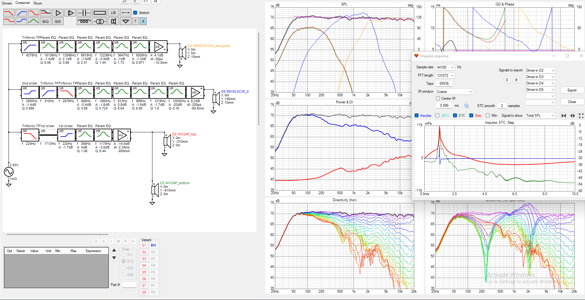

I had seen something about Trifonov transient perfect crossovers being mentioned by Kimmosto a while back. I tried to see what it is and tried to use it in the all SB 3 way setup (with mid on top and tweeter down).
This is what I got:
The vertical responses and phase plot look like a mess But I saw interesting shapes in the impulse ans step response.I added genereous amounts of delay seeing the speaker pics here:
https://trifonovaudio.wordpress.com/three-way-2/
and Kimmosto's own speaker responses like below:
Are these kind of crossovers any good? (Probably not my implementation of it, but in general)

Thanks, your little waveguide does quite well with the smaller driver.Fluid's iteration is looking pretty damn good!
As to the the transient perfect type stuff, unless latency is a problem a simple fully complementary FIR crossover will do that much better.

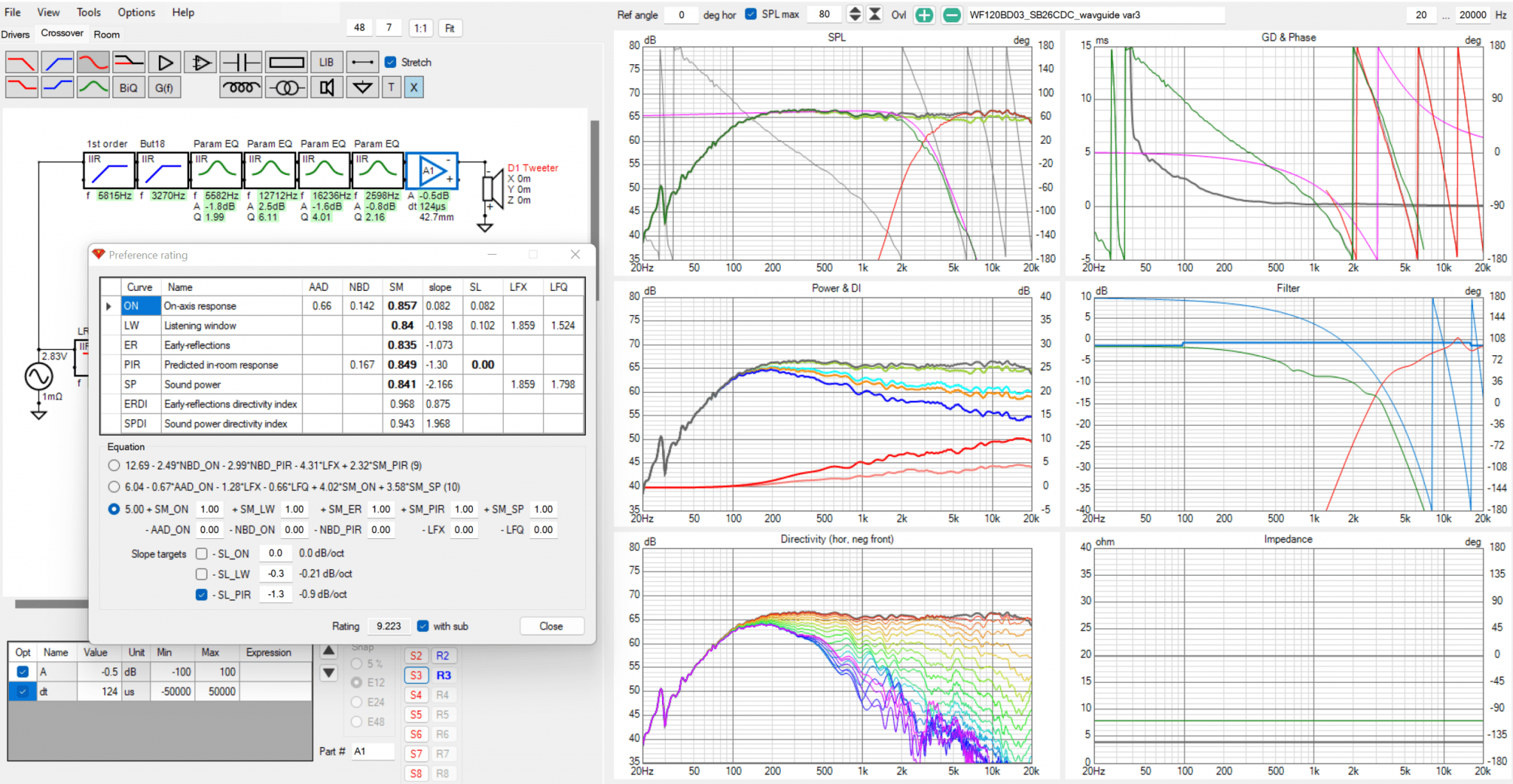

The version I did by hand had an Olive score of 8.44 according to equation 9. I've since let Vituix optimize by score, first for equation 9 which gave a score of 8.7.
Another version was optimized with the custom equation targeting a PIR of -1.3 and this one cane out at 9.22.
It would be interesting to listen to them to see if there is any appreciable difference in how they sound. Given the ripple in the measurements and the cabinet diffraction at 3K, those scores seem as high as is realistic.
It is interesting to see what changed to make the score higher. Just to show that the score can quite fallible, optimizing for equation 10 created a really weird rising response but the score was over 10, I think 11 might the maximum for that one. Vituix preset attached variations under R2 and R3.

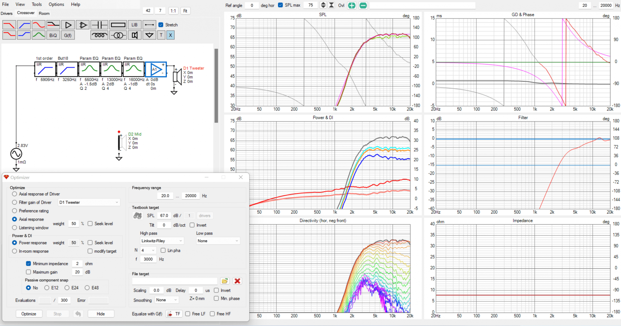

Using the optimizer is new to me so I'm having fun, although shooting in the dark to some extent. Running the optimizer on an already optimized response sometimes drives the result away from optimum - to a result with the response rolled off at former XO. I haven't figure that out yet; when this happens, I got back to unoptimized responses for new runs. (If it hurts, don't do it, (unless working out).)
I got a pref rating of 9.5 optimizing to the LW. This produced a flat LW curve while the axial rose about 1.5 db from 900 hz to18 khz. I noticed the optimizer cares not a whit about the height of the vertical response near XO. Manually tweaking the delay on the mid, I was able to optimize it with little change in the pref rating. Changing from 22 usec to 2 usec was all it took.
Listening would be the next step. Likely the sound is quite good. If not, you might consider doing something about the diffraction as dealing with it is driving the XO design.
Yeah, VituixCAD is very powerful and the xo can be optimized to anything quite easily. Basically crossovers can be considered trivial.

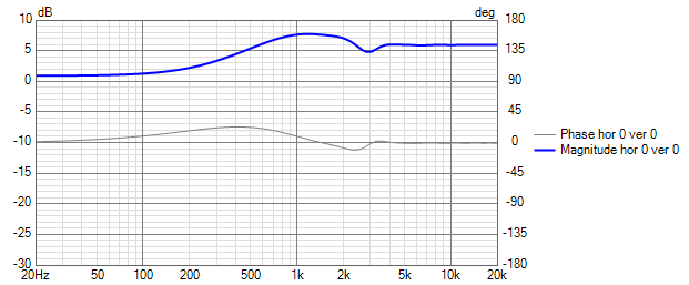

If you are still using the Vituix transfer function inversion process that creates a very smooth response in some of the important curves. The algorithm responds very well to this and the difference in the score can be almost a full point over something with a small amount of ripple in it. There is a good example at ASR. I think that is where the algorithm falls down and is not representative of an improvement in sound.I got a pref rating of 9.5 optimizing to the LW. This produced a flat LW curve while the axial rose about 1.5 db from 900 hz to18 khz. I noticed the optimizer cares not a whit about the height of the vertical response near XO. Manually tweaking the delay on the mid, I was able to optimize it with little change in the pref rating. Changing from 22 usec to 2 usec was all it took.
https://www.audiosciencereview.com/...361a-review-powered-monitor.28039/post-973429
Difference of 8.8 to 9.6 with what seems less than 0.5dB of ripple, I can't see how this would sound any different.
It also depends on what algorithm is used, the original equation 9, seems harder to get higher scores out of. That's why I think listening to the different options would be good to work out what it likes and what I agree with.
Step/impulse response "optimization" seems to make vertical responses rollercoaster. Choose your poison? Harsch type xo can give ok on-axis, but perhaps FIR tweaked symmetrical would be better? I have never even tried learn FIR...

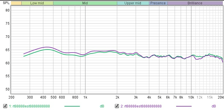

Before listening, I took on-axis measurements at 1m away from each speaker.
Here is how the left and right speakers looked like (3.8ms gated responses with no additional smoothing):
Green plot is left speaker. Purple is right speaker (please ignore legends. That is a keyboard issue with my laptop)
I find that they are really close. Even this level of difference I think could be because of mic orientation while measuring/slight changes in distance etc.

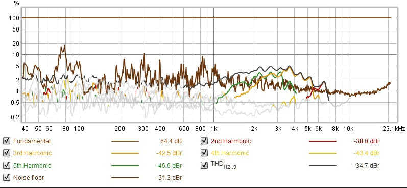

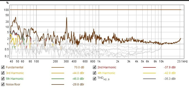

However, here is the issue. From the same measurements, I looked at the distortion tab in REW.
This is how they looked like:
Left speaker
Right speaker
The right speaker looks relatively clean. However, for the left speaker distortion rises up as much a 5% in the 1 to 5k region. And that too with odd harmonics.
I went and put my ears against the drivers while music was being played..
I can hear the distortion clearly.
It is like small amounts of clipping, kind of sparking sort of sound along with the material being played. This is not at all audible in the right speaker
Now I am sort of lost about how to debug it.
Is it driver related?Is it amplifier? Is it my audio interface or my computer itself?
I could hear that the distorted sound is predominantly coming from the SB15CAC on the left speaker.
How do I go in a systematic manner about identify the root cause of this issue?
Left speaker
Right speaker
Vineeth
Yes swapping left to right would let you quickly determine if it is a speaker problem or something further up the chain such as amp or other electronics.Now I am sort of lost about how to debug it.
Assuming you find it is a speaker problem, you should perform harmonic distortion measurements on each driver individually.
@fluid - In your crossover, you use a +2.5 dB PEQ boost at 13k with a Q = 6. I was under the impression that a PEQ boost should have a Q of 3 or less. If the PEQ is a cut (negative dB), the Q may be as sharp as is needed, but a boost should be low Q to avoid sonic degradation or side effects.
I honestly do not remember who/where I came across this guidance.
Have you found that a high Q boost can be implemented without audible side effects?
j.
j.
Those distortion peaks can come from furniture etc. resonating, or loose coonectin of driver or it's wires. Play sine at that freq and listen closely to the speaker etc. if you can hear disto. Then put your hand on the suspected source to kill mechanical reso etc...
