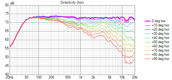

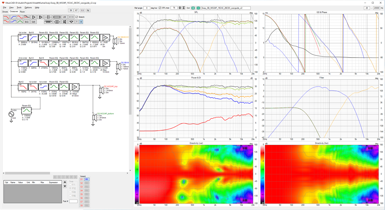

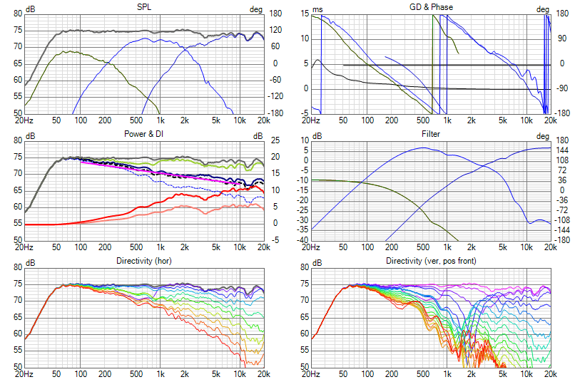

A 3 way design study
I have modified the driver responses to avoid the directivity issues during merging now by using the process that hifijim outlined above.
Please find the attached updated measurements with vituixcad project.
This configuration really looks like a hard one to design crossover for me.. 😀
Anyway I try to tweak, one of the graphs gets into a chewed up shape. either direcitivty, or the power response or the on-axis.
Latest iteration. This time the mid woofer on top of tweeter configuration..
I will try to study hifijim's crossover design next.

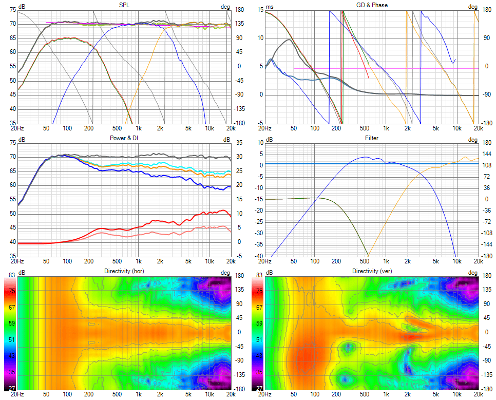

As Juhazi suggested, it appears to me that the vertical response is the thing driving the 3-4khz hump. Your ER Total in this area exactly matches the ER Vertical hump. You can verify this by plotting all three ER traces and see which is driving ER Total behavior. Since your CTC is already set, you can manipulate the behavior with asymmetric slopes and crossover frequency. Aiming for standard slopes will not work here.
Also, I would start taking vertical measurements, instead of relying on VC's assumptions about vert vs hor. Sure it will be close, but when you move vertically, very small changes make a big impact on phase summation in the crossover region, so if VC's vertical calculation is off just a tiny bit from reality, I suspect it might have outsized impact on your modeled responses.
Thanks augerpro.. 🙂
I am planning to take vertical measurements. Probably over next weekend.
I tried to take it this time but the curved cabinet was making things difficult and had stability issues with measurement setup.. So I got frustrated and gave up.
I will try taking it next week somehow

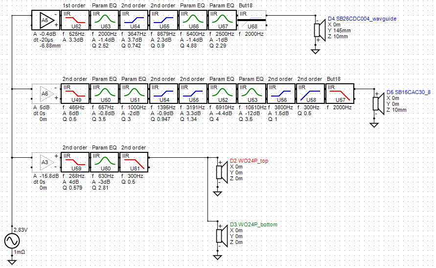

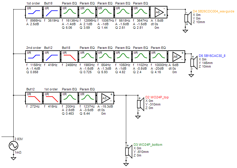

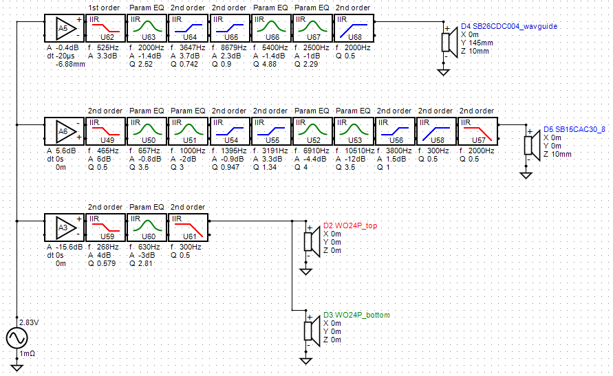

My first thought was to play with phase near 2 khz. I had best results by adding DSP delay in the amp symbols. I just used delay to make the main beam horizontal rather than tilted. Then I did a round of manual EQ to further flatten the response while keeping PIR and PwrResp relatively smooth. I used predicted preference rating to judge tradeoffs. My polar maps are normalized to separate color changes due to axial response from those due to directivity. The IR and step responses are not pretty.

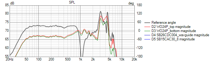

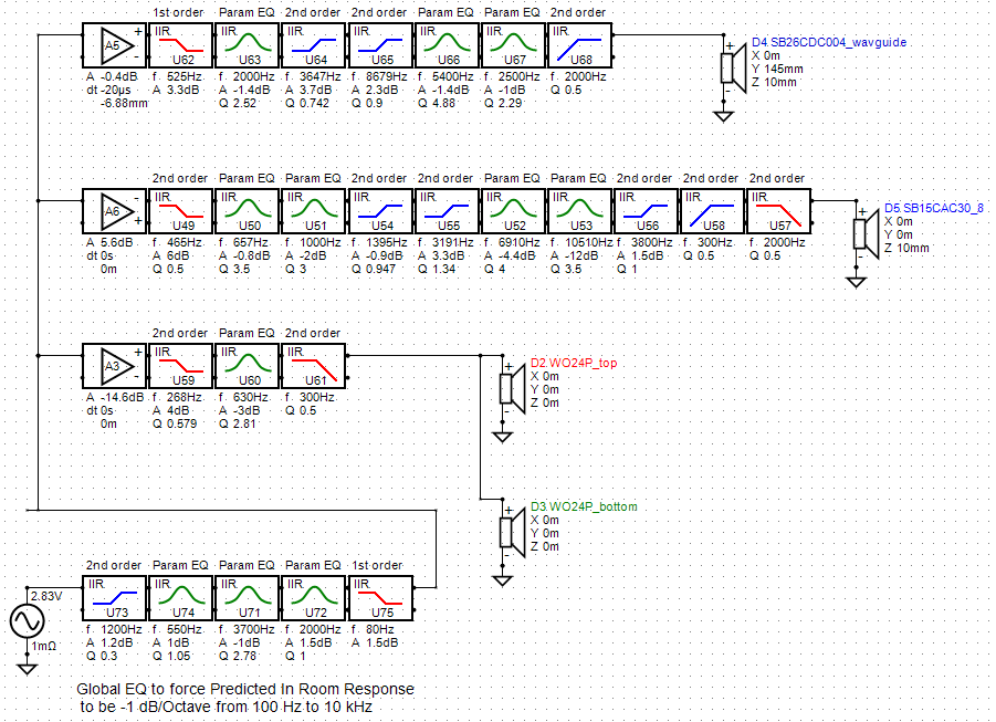

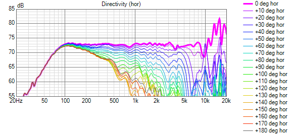

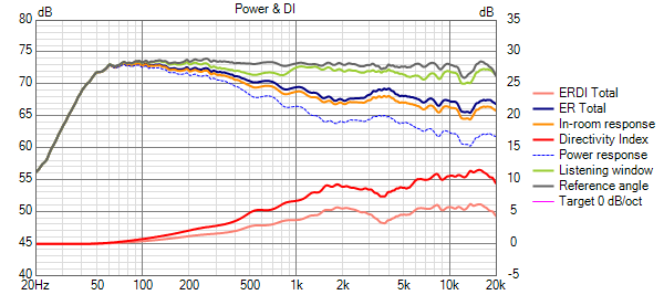

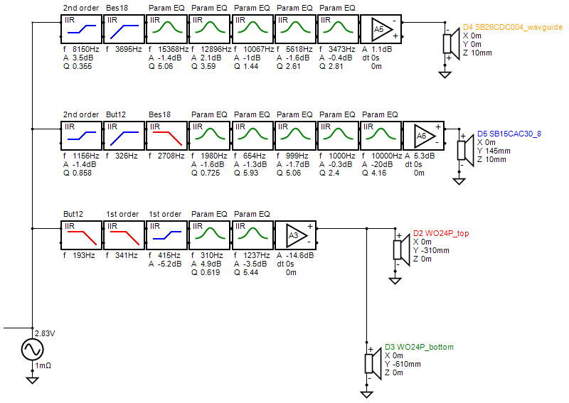

For me, the first step in setting up an active filter is to EQ the drivers to a reasonably flat smooth response. This then becomes the starting point for developing a crossover.
First the woofer raw response
And now with EQ, but no crossover
Nothing above 1000 Hz matters, so this driver looks reasonable... BSC is incorporated, and some modest EQ has flattened it to a reasonable degree.

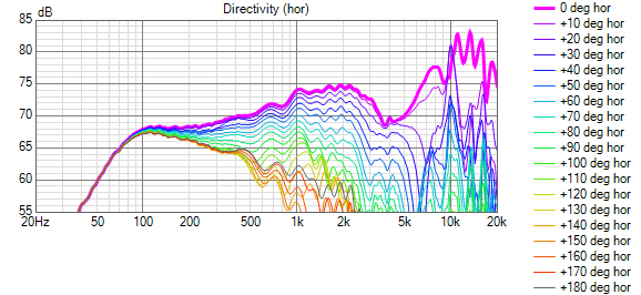

Next is the mid driver, SB15CAC
Raw response
Now with EQ, but no crossover
Given the pass band of this driver, the region from 100 Hz to 4kHz is the most important to focus on.
When doing a complicated EQ such as this mid driver requires, I find shelf filters very helpful, rather than a long series of PEQ's.

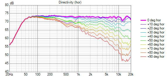

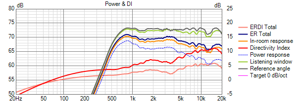

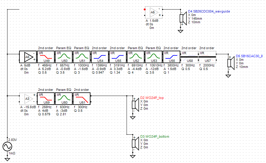

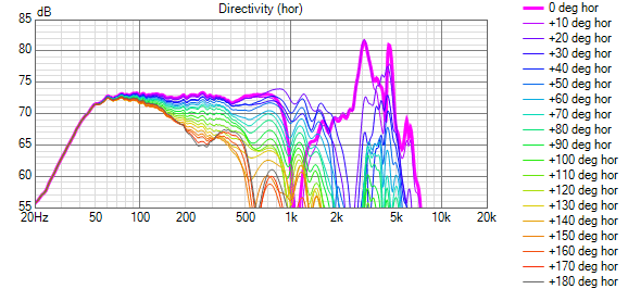

If we just slap on a LR2 at 300 Hz and a BW3 at 2k, the results are not too bad. Actually it has some promise.
What I like about this filter is the predicted in room (PIR) response is quite good. The power response has a +1 dB bump from 3k - 4k, which leads to a -2 dB dip in DI. Overall this is very likely to be insiginificant.
What I do not like about this filter is the horizontal polar response. Starting at 30 degrees and going all the way through 90 degrees, there is a peak at 3.2k. It is most prominent at 40 to 60 degrees off axis.

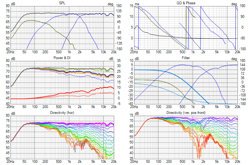

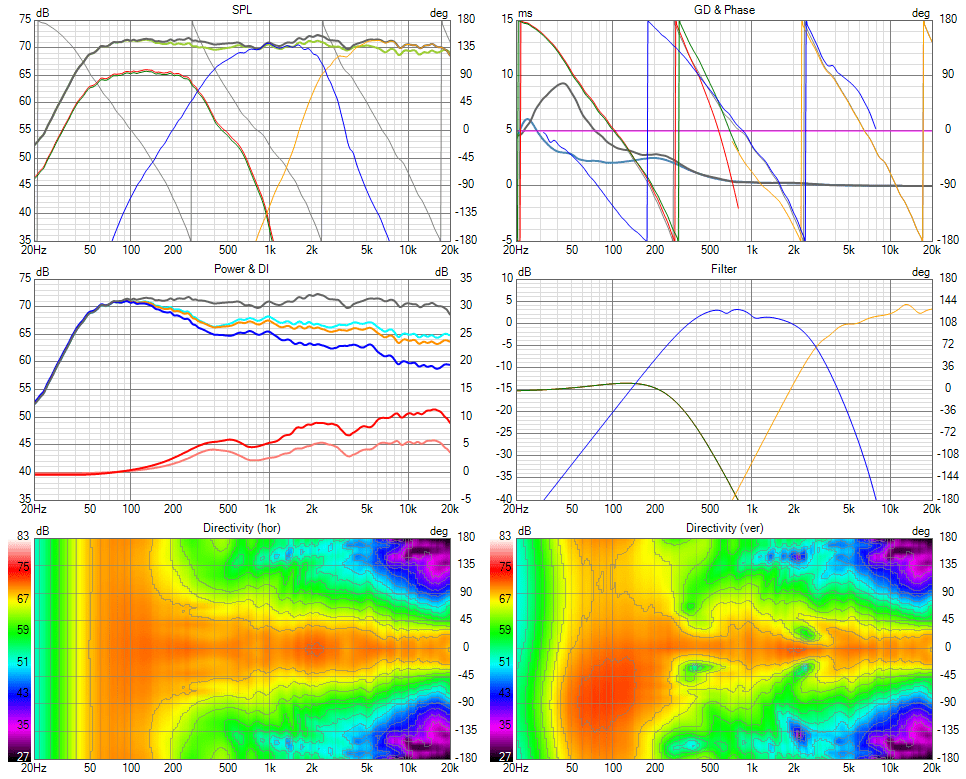

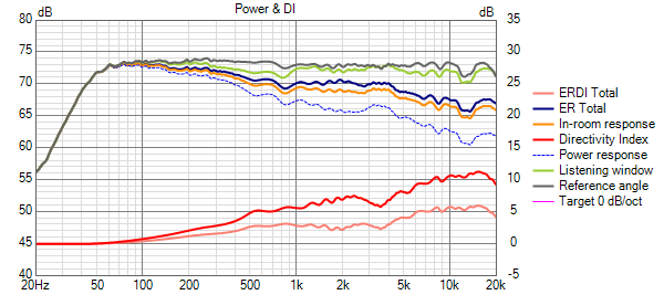

If we try 2nd order at 2k, the horizontal polars improve.
Horizontal polars are much improved. But other parameters have degraded. The vertical polar response now has much deeper nulls. The power response and DI are a bit less even. The PIR is slightly less optimal, and the ER has a rising response from 2k to 3k that Fluid warns us against.
Also please note that the 10-degree horizontal curve has some kind of measurement error in it, note the dramatic dip from 200 to 1k. This shows up in all the sims.
So, some continuing refinement is needed.
I’m in agreement Jim,
Its hard to know exactly which will be preferable. I feel It depends on the room and listening position(s).
In terms of horizontal responses, Between a flat 2-4 KHz in the on-axis and a peak in 2-4 KHz off axis, VS a dip in the on-axis, but resultant smooth and flat power response and predicted in room response (see attached as an example); I think I’ll prefer take the latter.
But latter is perhaps more Advantageous in smaller rooms or when the speaker is on the narrower width of the room; where side reflections at 45-90 degrees will be significant.
The former may be advantageous when listening in large rooms or in the close distances to the speaker eg. 1m, where direct sound dominates the reflected sound.
Again, I don’t have good evidence for this.

Actually, I am hoping that Vineeth can make vertical polar responses of mid and tweeter before he starts implementing anything. Fine tuning a sim to the level we are striving for requires the best available data. I found that if I used only horizontal measurements, my power and DI sims were +/- 2 dB acurate, and if that is all we can expect from the sim, then basically we are done with simulation. If we want better than that, vertical measurements are needed.
I also recommend an outdoor ground plane measurement of the woofer box, on-axis is all that is needed. I think we really need to confirm the shape of the woofer response up to about 800 Hz. I could be wrong, but the woofer response still looks odd to me.
I also hope that someone else jumps in with a fresh perspective on the DSP filter. Vineeth has asked for ideas, and I am very interested in how other folks design a DSP filter.

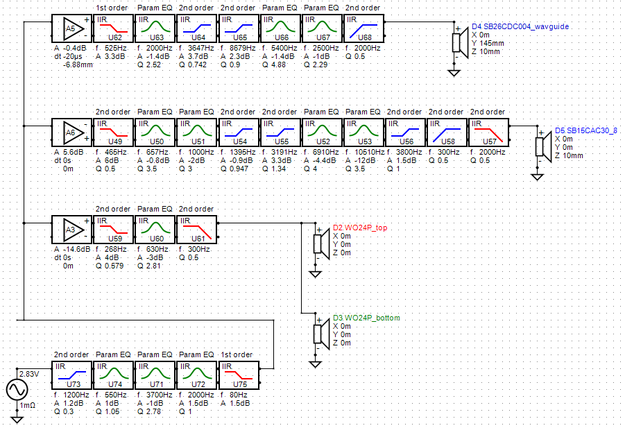

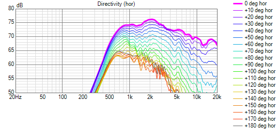

Now the Tweeter... Raw response first
Now with EQ but no crossover
The bulk of the 3K problem seems to be in the tweeter, the EQ looks to have made it slightly worse and the SB15 bounces back around those same frequencies so it's off axis contribution is also higher than desirable there. I don't know if it is an optical illusion but Vineeth's waveguide looks slightly smaller than mainframe's.
I have never EQ'd a waveguide tweeter before. It seems to me that shelf filters are particularly useful here.
Usually a small value Capacitor or a high pass filter with an Fc near 18 to 20K works to undo the mass and inductive rolloff.

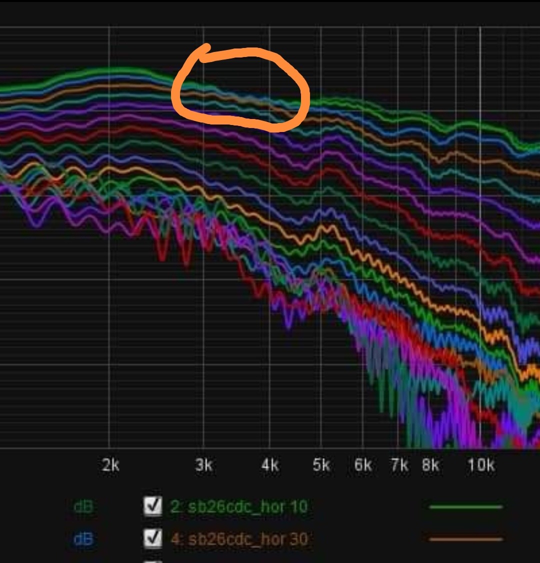

Yeah the horizontal of the tweeter has a 3-4khz bump off axis also. So that plus the vertical ER are unfortunately pushing up response there. Must be baffle diffraction intruding, I don't see it with the waveguide measured on my test baffle. The 6" version I used with the speaker sent to Erin doesn't do that at 3-4khz, although it does a bit at 2khz where it is already rolling off so not an issue. Vineeth is this the 4"? What does the diffraction model look like?

I don't know if this is diffraction (caused by me not terminating the waveguide properly with rounding/chamfer not immediately starting right at the edge of the waveguide), But there is something that causes a bunching of curves from 0 to 30 degrees off axis around 3-4 kHz. Maybe this is causing some issue?

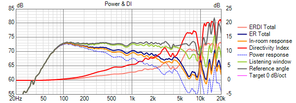

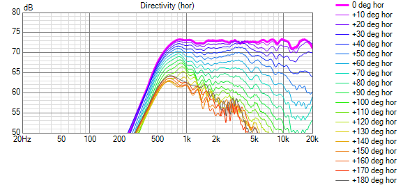

Of course it is possible to globally EQ the response such that any one curve is nearly ideal. If we highly value one particular curve, such as PIR, we can force it to be flat. To me it seems counter-intuitive, so I have never had the nerve to try it.
If we did, we might end up with something like this
Would this work? I suppose it would. I would love to hear from someone with first-hand experience in optimizing PIR at the expense of on-axis and listening window response.

In this case a DI bump below the crossover from the matched directivity of the horizontal sizes is probably the better trade.
I suspect the extra little bit of extra flat baffle combined with the overall width is probably where that off axis rise is coming from.
I think the graph above of the on axis and listening window shows why forcing any curve to a specific target doesn't work in all cases. If the speaker is very smooth and consistent in directivity then it might work better. One of the ASR posters who has a speaker database runs an EQ algorithm that targets the SM PIR as it generally increases the Olive score. I haven't seen many where I think the after EQ is anything other than different. I have spent a long time changing the tonal balance from in room measurements of my line arrays. The best result has never been a straight line. Not far off it visually, but the difference in sound was much more than the graph would suggest.

I don't know how high the SB15 can run, might need a passive notch on the breakup to run it up high, but it might be worth raising the crossover to near 3khz and see if that improves things.
