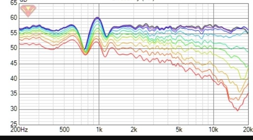

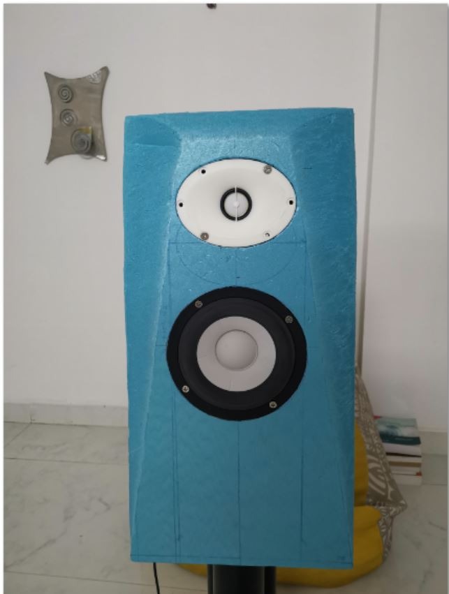

Interestingly, the 3-4 kHz bunching was there even on this foam baffle which I had made long back for studying taking measurements etc..

It's not anywhere near as problematic there, the facets blend it betterInterestingly, the 3-4 kHz bunching was there even on this foam baffle which I had made long back for studying taking measurements etc..

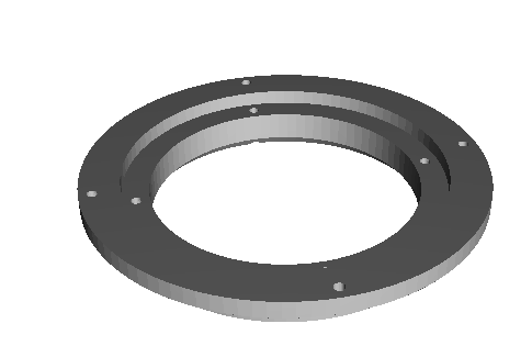

A 3D printed adapter ring would allow you to at least examine the differenceThanks fluid..
I have a pair of the wavecor wf120bd03 in hand too..
But size wise they wont fit inside this box.
Awesome idea.. This I will have to try out..A 3D printed adapter ring would allow you to at least examine the difference

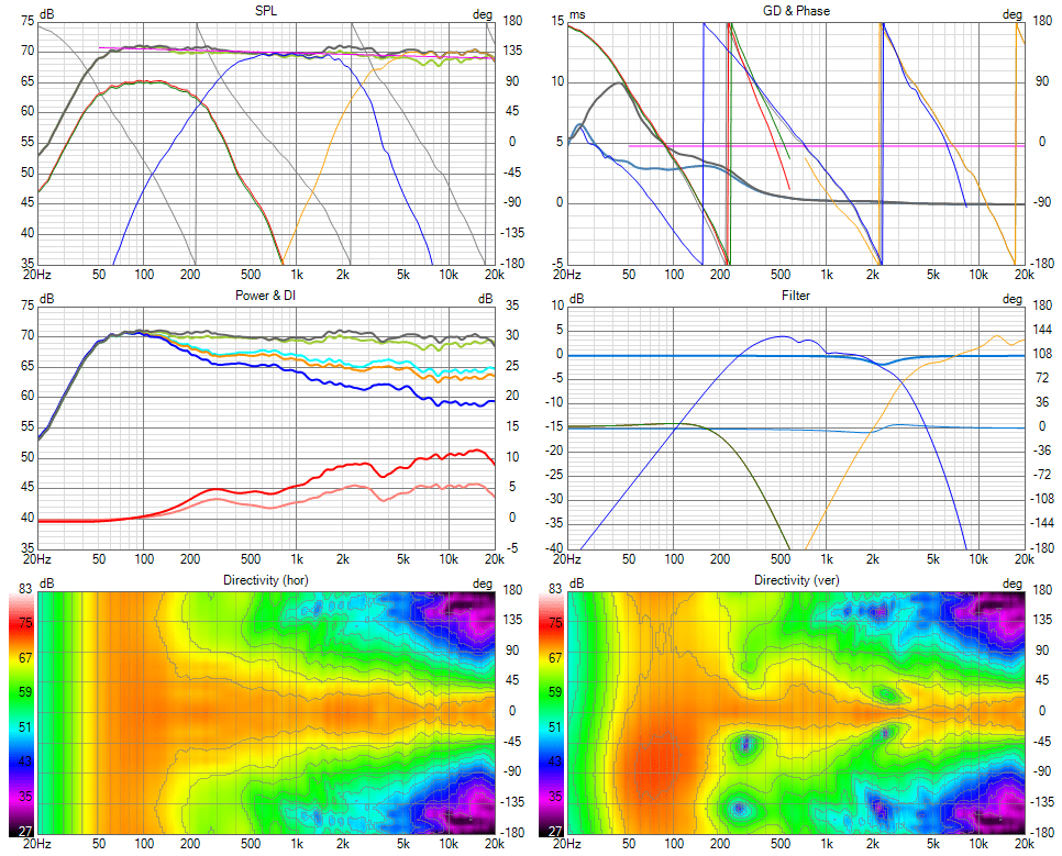

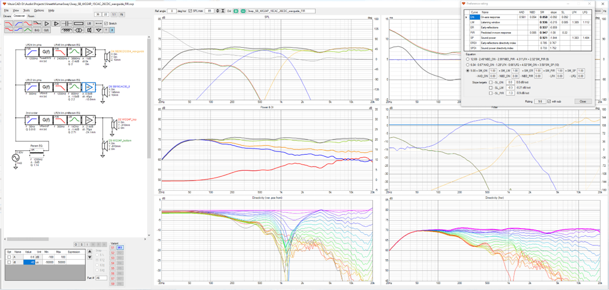

my first contribution was just a tweak on VK's design. My usual practice is to use FIR to flatten driver response and then textbook highpass and low pass filters to form a crossover, the add PEQs to tradeoff between axial and PIR or power response. So purely out of curiosity I tried it, before seeing all your responses since my last post.
In this case, I had to do some flattening of the axial also, likely since it was a 3-way. In simulation I use Vituix mirror to emulate the FIR. I then have freedom to move the XO very easily. In this case there is a CTC issue so the lower you make it the wider the vertical window at XO. This is a nice freedom to have during listening tests to see if the XO can be set as low as I have it.
I think I did get a better result although I'm not sure how audible the difference would be. If I were going beyond simulation, I would try to reproduce this with IIR, at least using IIR for the woofers as my MiniDSP Flex doesn't have enough taps to be accurate down low.

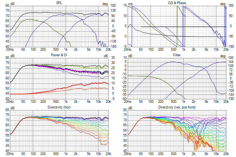

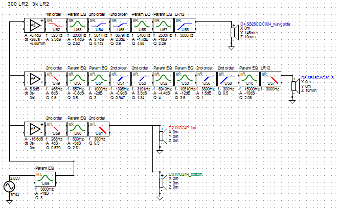

The mid-tweeter CTC distance is 145 mm, and at 2k that is 0.85 wavelength. This is not ideal. However, if the crossover was 3k then that CTC distance would be about 1.27 wavelength. This might improve the DI in the troublesome region.
So, a 3k crossover may have merit for several reasons.

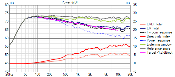

3k upper crossover. Now this looks like something with some real potential. I started with 3rd order, but the performance was lower than the 2k 3rd order. When I switched to 2nd order Q=.5 (i.e. LR2), things improved quite a bit. I added a bit of global EQ at 3.8k to smooth out the PIR, ER, and sound power curves. I also did some additional suppression of the SB15CAC cone resonances above 10k, since a 3k 2nd order filter does not, by itself, provide enough suppression.
The PIR line is almost flat, with a slope of -1.2 dB/octave.

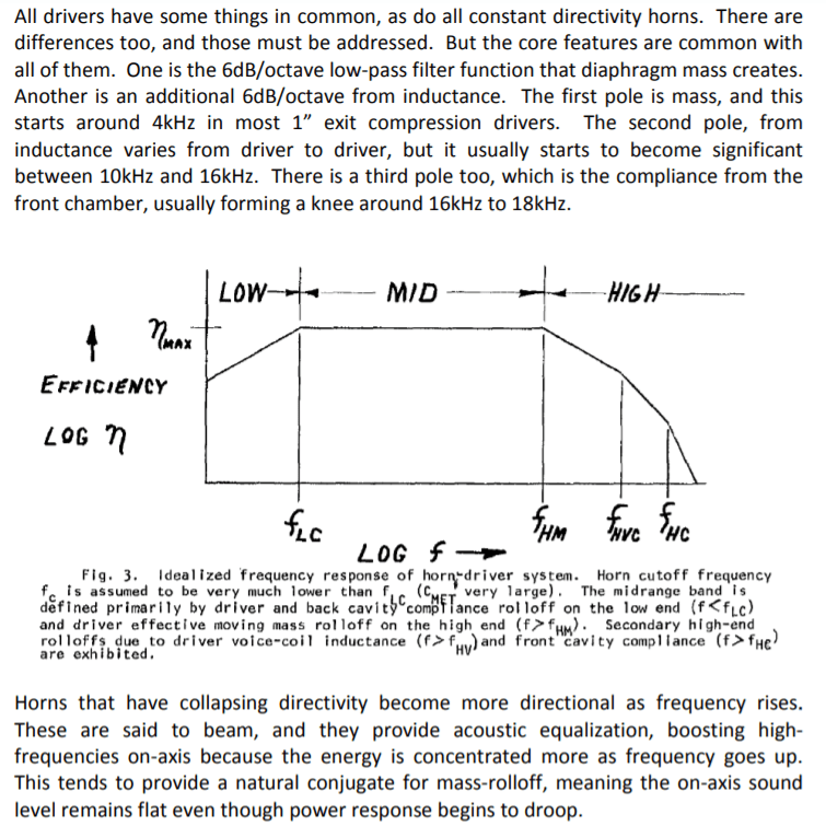

Usually a small value Capacitor or a high pass filter with an Fc near 18 to 20K works to undo the mass and inductive rolloff.
Fluid - going back and rereading things, I realize I rolled past this without processing it... and now that I read it, I don't comprehend your point. Are you referring to the unevenness in the 10k to 20k region ?
No, a driver in a waveguide is rolled off compared to one on a flat baffle, this can be undone with first order filters, applying that logic in mainframe's build is here https://www.audiosciencereview.com/.../revel-m105-copy-diy-build.29465/post-1030684Fluid - going back and rereading things, I realize I rolled past this without processing it... and now that I read it, I don't comprehend your point. Are you referring to the unevenness in the 10k to 20k region ?

It can be a handy thing to try because if the capacitor is sized correctly it can be good protection for the tweeter and serve a useful part of the filtering at the same time.Oh yes, I see what you mean. I did try a 1st order high pass filter on the tweeter, but it seemed like a series of shelves did a better job... I admit I did not try very hard with the 1st order.... Thanks !
