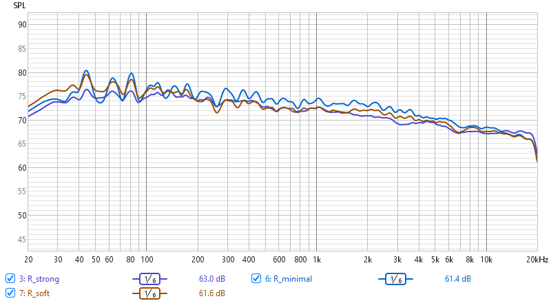

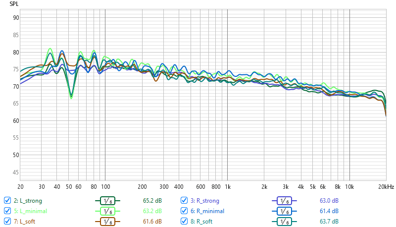

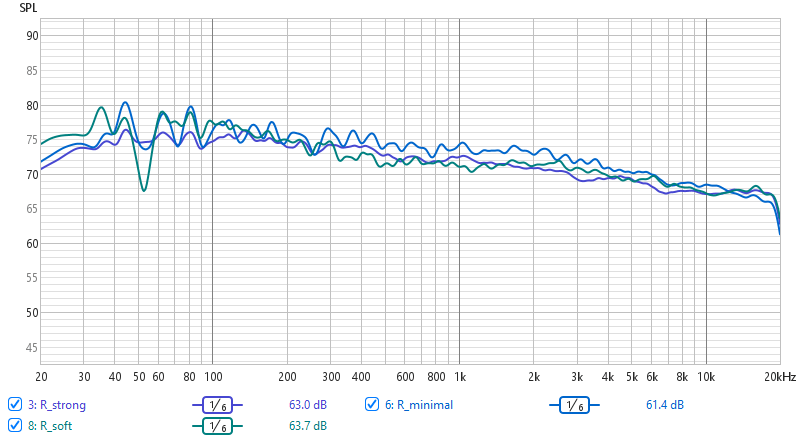

Here are the EQ profiles I have tested so far. To reduce the clutter, I am showing only the responses of the right speaker under different EQ profiles in DRC designer software. The profiles that I have tried (using DRC designer) so far are the following (also each time a slightly different target curve)
1) Strong
2) Minimal
3) Soft
Snapshots from DRC designer options window:
Corresponding responses I got from main listening position for the right speaker

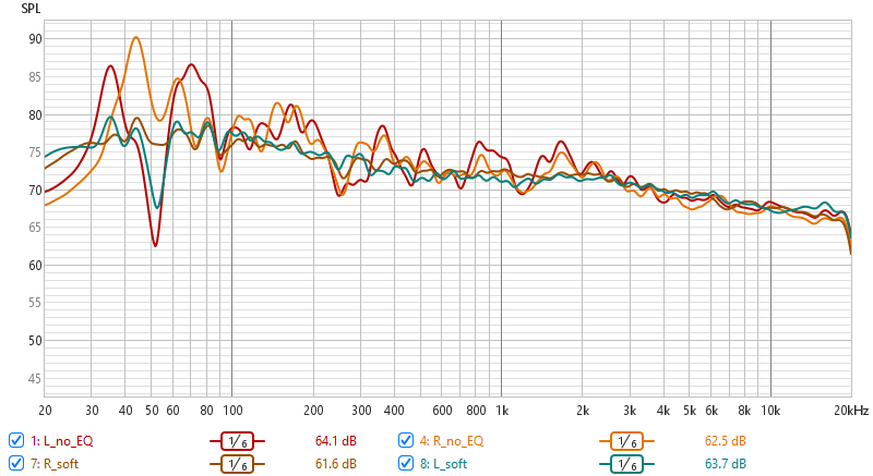

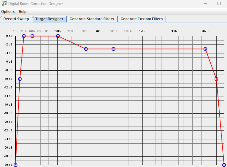

Among what I have tried so far, I liked the 'soft' option with the following target curve the best.. 😀
Here are the responses I got for that setting for left and right speakers (also plotted are the unEQd responses for comparison) 🙂
Since these are got using single point correction (from mic at the mainlistening position (MLP)), I was curious as to what happens a bit away in horizontal plane with this EQ 😀

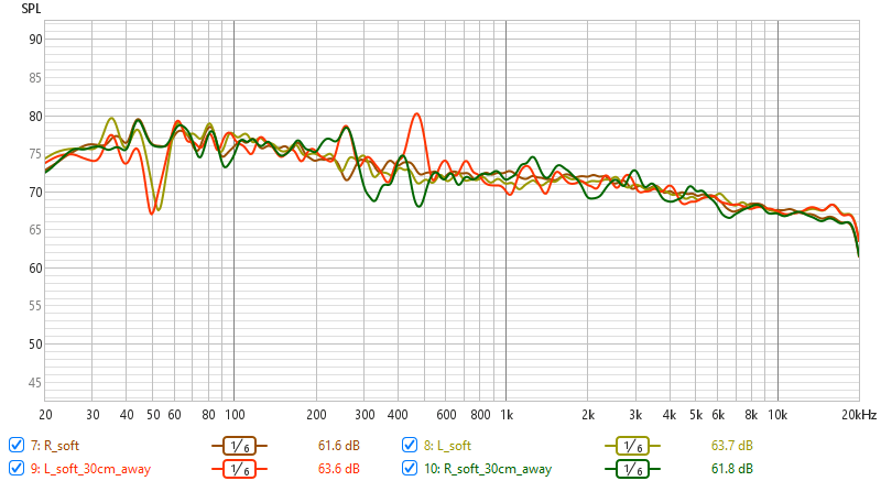

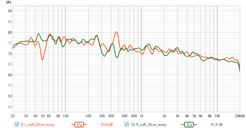

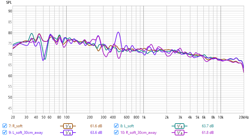

So I measured the responses one foot away to the left of the MLP at the same height for both speakers. Here are the comparison plots
Trying to reduce clutter and show the response at one foot away from MLP alone (I feel it is still really good except for some added bumpiness from 300 - 500 Hz)

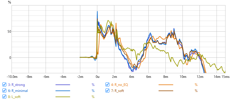

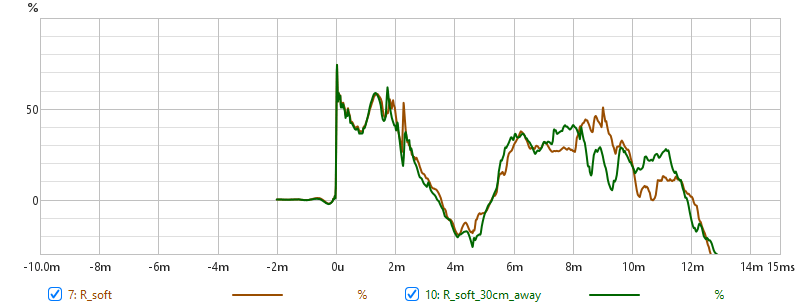

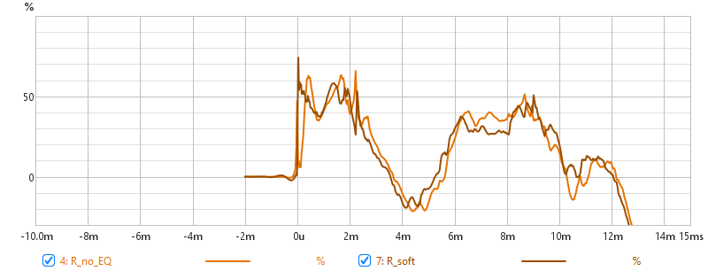

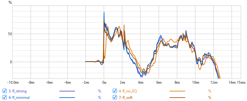

In all cases, the step responses look nice with varying (but still very very small and inaudible to me) amounts of pre-ringin. Comparison of step responsesfor different profiles (no EQ, strong, minimal, soft)
No EQ vs soft EQ
Now step responses from MLP vs 1 foot away from MLP

As I said above, I liked the soft EQ option the best so far. I think part of it is due to the bass balance w.r.t overall levels across bandwidth.. 🙂
I listened to 2-3 more songs. The system seems to take EQ like breeze. Seems like it is putting no extra effort. 😀 But the results are extemely nice. Solid imaging. Well controlled bass. I dont hear any loss in overall dynamics (except the reduction of a bit of boom in the bass). I really like it all... Now I am a beleiver in Room EQ too 😀

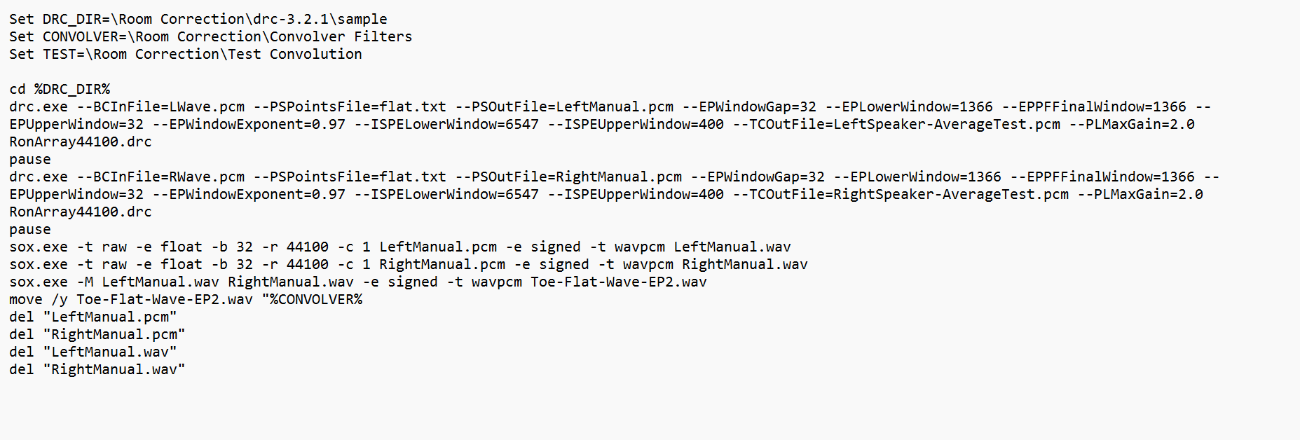

The text guide is only to get started and use an existing script. There is much more information in the thread to explain what things you might want to change. The DRC FIR documents explain all the commands or options that can be specified and if they have interaction with others. It is important to read it as certain window sizes require others to be related in a certain way otherwise drc will throw an error.
Attached is a screenshot of a script. Anything with -- in front of it is a command that is being called and varied from the one in the drc file. You could edit the drc file directly with the change but I find it easier to change in a separate script. The script contains sox options to turn the filter files into wav files that can be used directly with a convolution program. drc outputs raw pcm by itself. There is also a test convolution that can be opened to inspect what will happen, no need to measure again to see if it did what you wanted or not.
If you look in the sample folder inside the drc folder there should be some files that end in .drc like strong.drc etc. Open one of these in a text editor and you will see the options being used with that correction. You can compare it to the minimal or other examples.
The items that start with MP define the minimum phase frequency dependent windowing stage.
PSInterpolationType = will set that way the target response refers to the target points file. Read the manual to see the options, R works quite well from memory in matching how the text file of points looks in REW.
You will see in mine that the points file is flat. I don't use drc to set the final shape. I do that with shelving PEQ, I 've described it a few times if you haven't seen it I can explain again. DRC returns a flat response and I shape it myself afterwards. I found this to work better in adjusting the drc parameters independently of the tonal balance I wanted to keep and small changes in PEQ were easier to dial in in real time while listening.

So from what you described above, I should target a flat response with DRC (instead of the current tilted response I am using) and then shape the spectral balance using PEQ in the convolved. I will try this out.
I find it easier to set the two things independently of each other, it becomes time consuming and annoying constantly tweaking the target.
It looks like this the dots are the centre frequencies of the shelving filters, most spaced an octave apart from each other. You can set the rate of fall by the amplitude and tweak the slope up or down at different points with the Q.

So more tests and listening impressions from little time I got so far in the morning.. 😀
1) Strong
2) Minimal
3) Soft

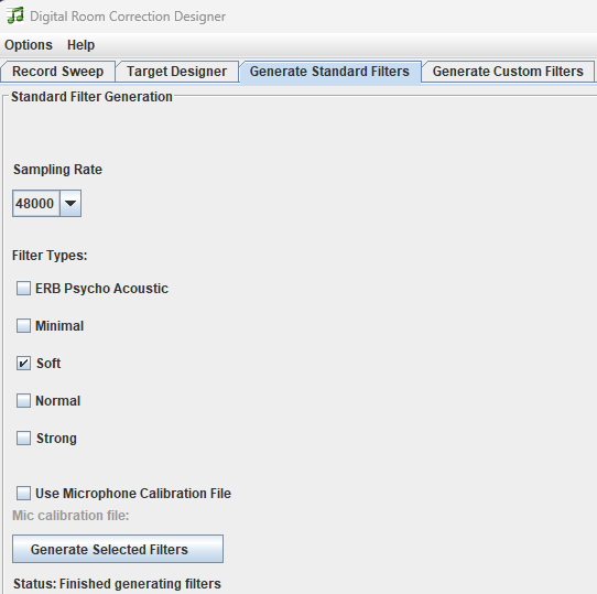

No EQ vs soft EQ

Do you measure in one place to get that curve? What happens if you move the mic 20-30cm and measure again - after corrections?
What I'm digging at, is whether the corrections in the software can differentiate between corrections correlated to the speaker and the room - respectively. Or is it a setting which you compromise between average or maybe 20% speaker and 80% room - something like that?
@digitalthor: To get the above curves, I measured only from the main listening position.
I have also shown a set of plots with the correction on and measurements taken (for left and right speaker) 30cm to the left of the main listening position. Here is that plot
Apart from the little bit of bumpiness arpund 300 to 500 Hz region, i think it looks close to that at MLP

Thank you. It was exactly the position of the mic, that I was in doubt about, since you did write that you measured a foot to the left and right(shows in the picture you posted - REW details) at the same height. But I often find bigger differences in the bass, like you, when measuring half a meter to both left, right, forth and back of the MLP - also slightly different heights. Maybe your room is more symmetrical than mine...
My current speakers are measuring a lot like yours in my MLP -with no DRC and just a natural beaming because of the design of the drives and speakers. But I applaud your work, and I myself love what modern software, computers and algorithms can bring us.
The experience I have with DRC, is that mostly the upper frequencies - above ~500Hz - will remain unaffected, when the speaker has a smooth and even power response to begin with. But if the speaker has issues in its basic design, then DRC can only smooth them out, never really fix them. Which results in smoother - sometimes - averaged curves - our ears like that though - but I also experienced that details get lost in that process, from measuring in the MLP to measuring the speaker in total (or close) independence of the room.
My experience over the years, is that all the speakers I like the most(all price ranges and sizes), are the ones with an even power response - where the downward tilt - as frequency rises - is a result of a good match between midrange and tweeter, both in size and dispersion, so that a constantly increasing beaming occurs, as frequency goes up. Because then you will measure a sum of direct sound and reflected sound in the MLP, giving you that natural tilt. This is where I often experience the best stereo imaging.
I played around with direct radiating tweeters vs WG tweeters, and their dispersion is key to stereo imaging. My claim is, that you might be able to make a downward tilt and let DRC create a filter/EQ that gives you a nice curve in the MLP. But DRC can never change the dispersion of a driver or specific speaker design. This is exactly what I tried with a Seas DXT and T34B - the DXT had a nice pinpoint image right between the speakers - whereas the Bliessma just illuminated the room with sound - smearing any chance of pinpointing anything. No type of EQ can ever fix basic physical features of drivers and speaker cabinets.

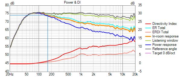

The predicted in-room response slopes down at a rate of about 1 dB to 1.4 dB from about 500 Hz onwards. Power response looks sloping down and relatively smooth but I don't know what tilt of that is the best choice. This what I currently have sounds nice though... 🙂
