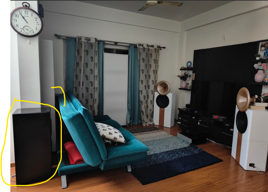

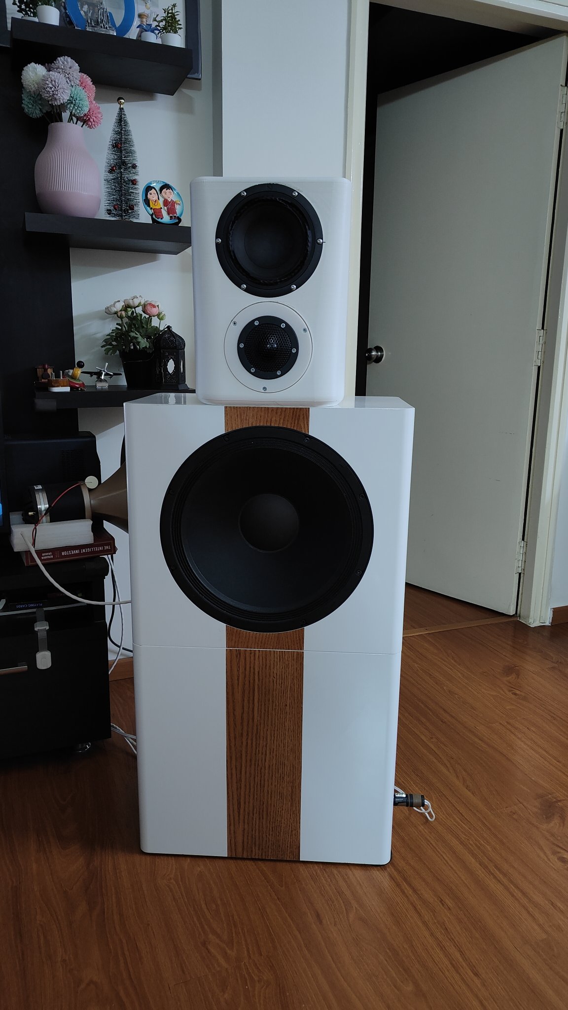

I have just tried the stereo sub approach so far. I have "subwoofers" set up like shown in this picture. Each black cab has two Satori WO24Ps. Both drivers are connected in parallel per side and are low passed at 60Hz. I have a big L-shaped room and what you see below is the shorter part of the "L" where the speakers are set up.
The next two subwoofers are the 15inch ones at the bottom of the mains facing the backside.
I haven't tried DBA yet mainly because I haven't been able to determine the positioning of these subs for that.

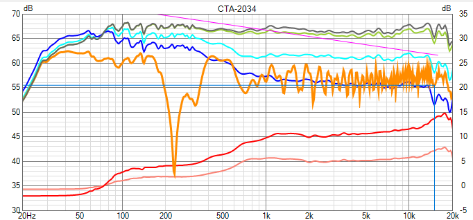

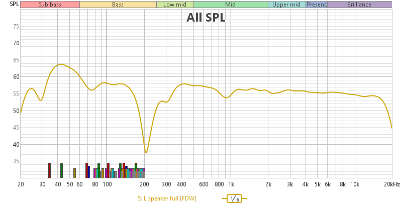

I have been puzzled by that 200Hz hole. Whatever I do elsewhere in the room other than the ceiling, it is there. For that and the 900Hz hole, I have seen that their location and depth are affected to some extent by the ceiling reflections (based on experiments I did with some amount of absorption near the ceiling area). I do see from (a very incomplete/inaccurate) modeling of the room in REW that there is potentially a combination room modes in the 200 to 220Hz region in my room as well. This along with the ceiling reflections maybe causing that hole in the 200ish Hz region

^multiple reflections piling up perhaps, because there is rarely big dip just from one reflection because there is always multiple reflections and the other ones fill in, unless they happen to align and make one big dip. Ceiling reflection could be the main dip there, which some other reflections enhance.

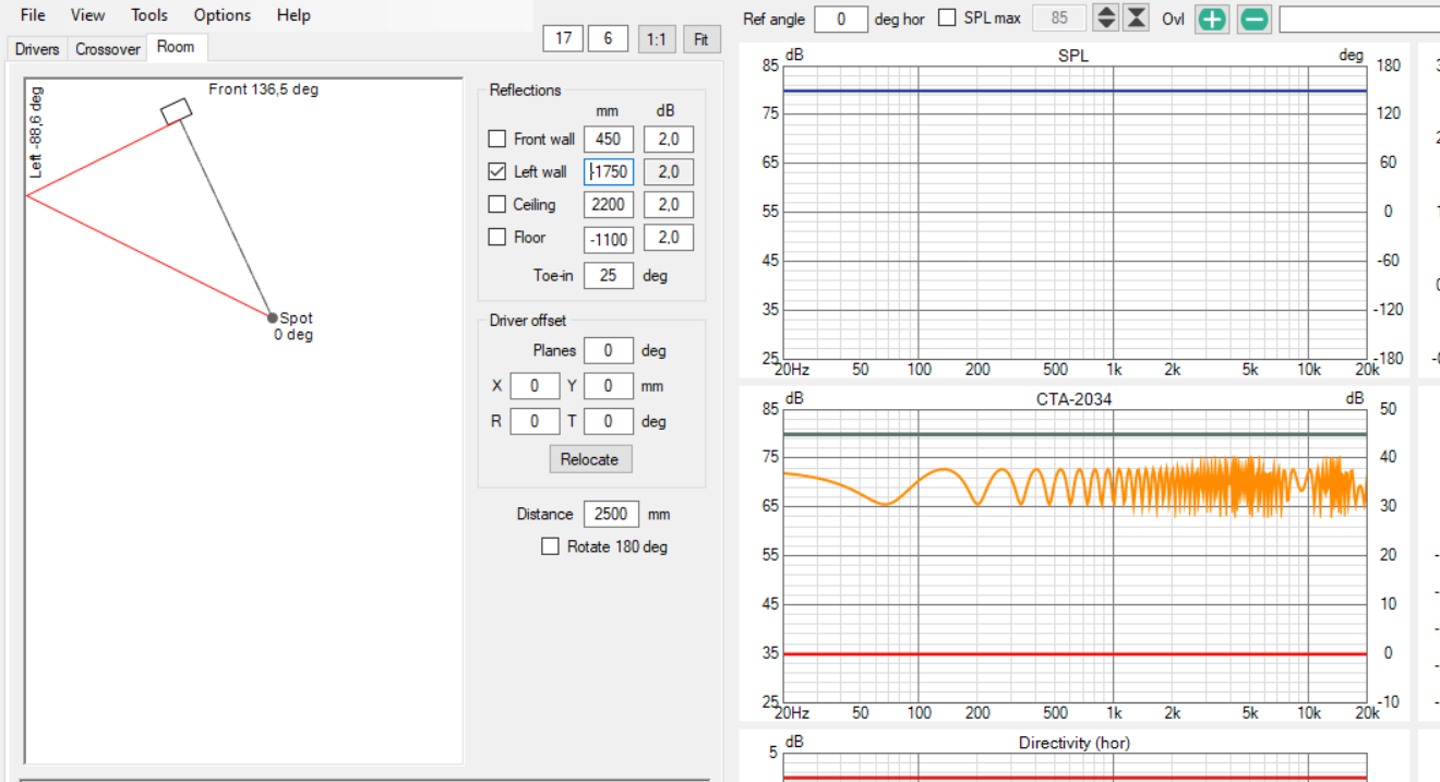

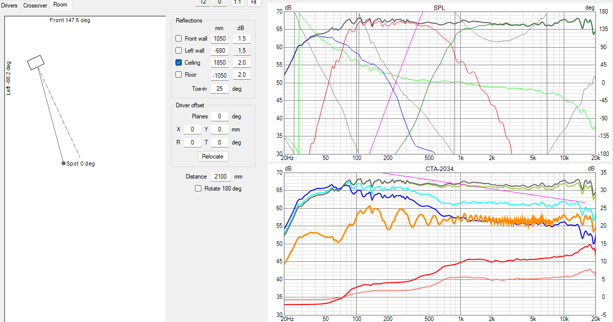

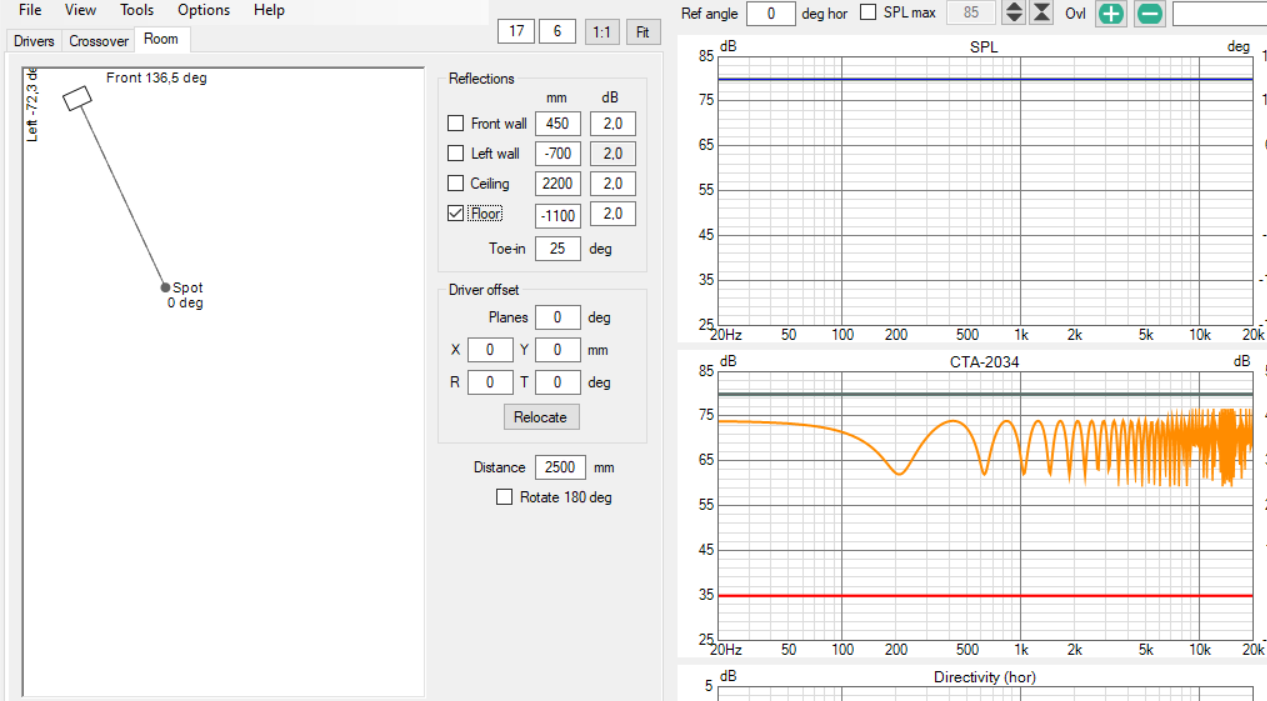

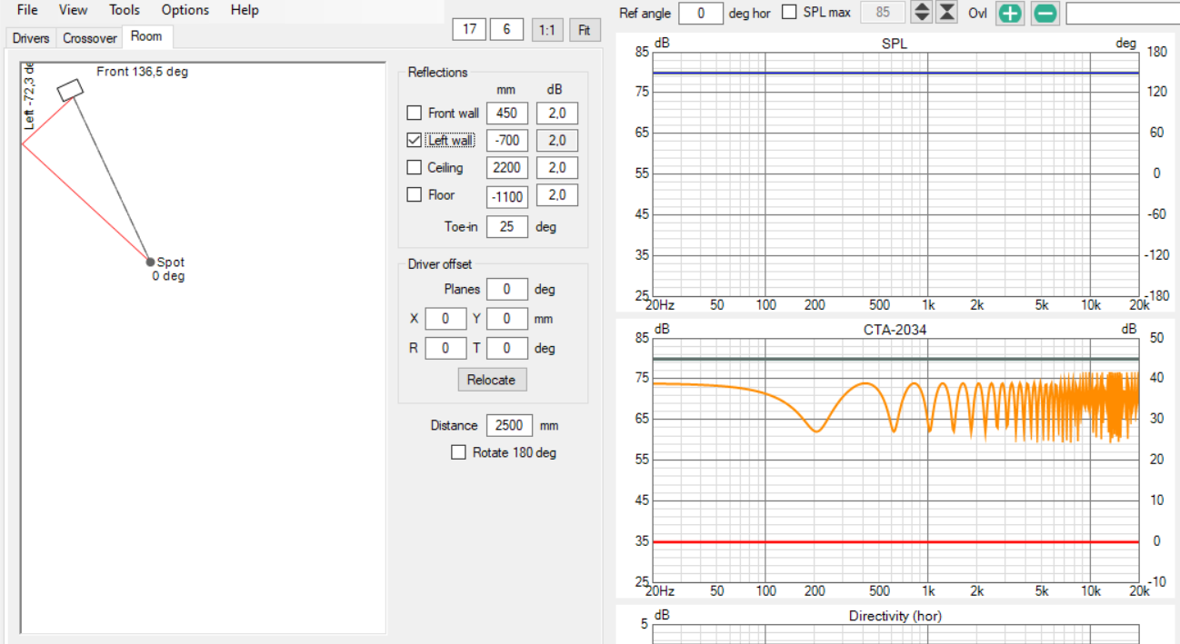

You could try to figure out which one it is by playing with sims as you've already been doing. Ceiling is usually so far a way, in a small room, that it makes the longest early reflection and thus the first interference dip lowest in frequency of all early reflections. Since you positioning is lopsided to the room your right side reflection or something behind listening spot might be quite long as well. Front and back wall reflections have surprisingly long path length as well due to roundtrip.

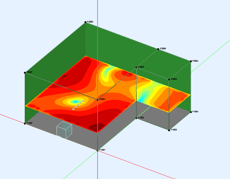

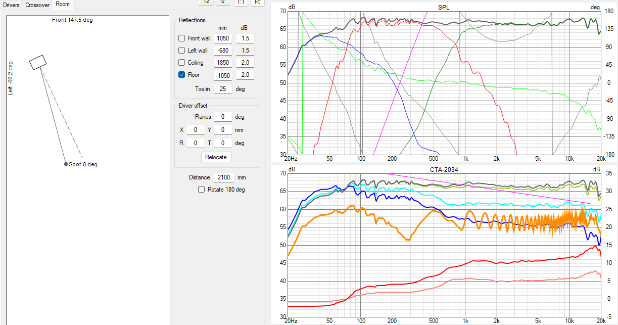

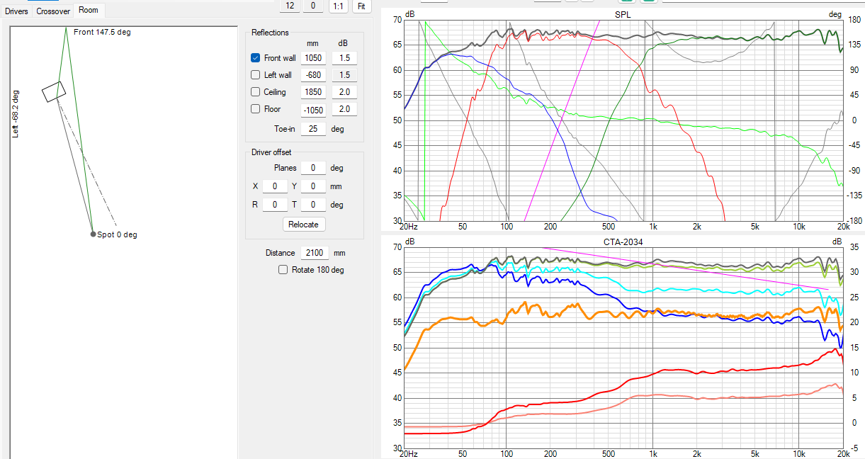

Quick try on vituixcad room tab with single ideal driver let's you checkout path lengths and resulting interference pattern fast. I see your room height is relatively tall so first interference dip, that's the widest one, get's way below 200Hz. Guestimated listening distance and driver height second interference dip could hit about at 200Hz. You could use any of the boundaries available to scout all of your first reflection points to figure out which ones have a dip around 200Hz. Move listening triangle or try to treat either or both of those somehow.

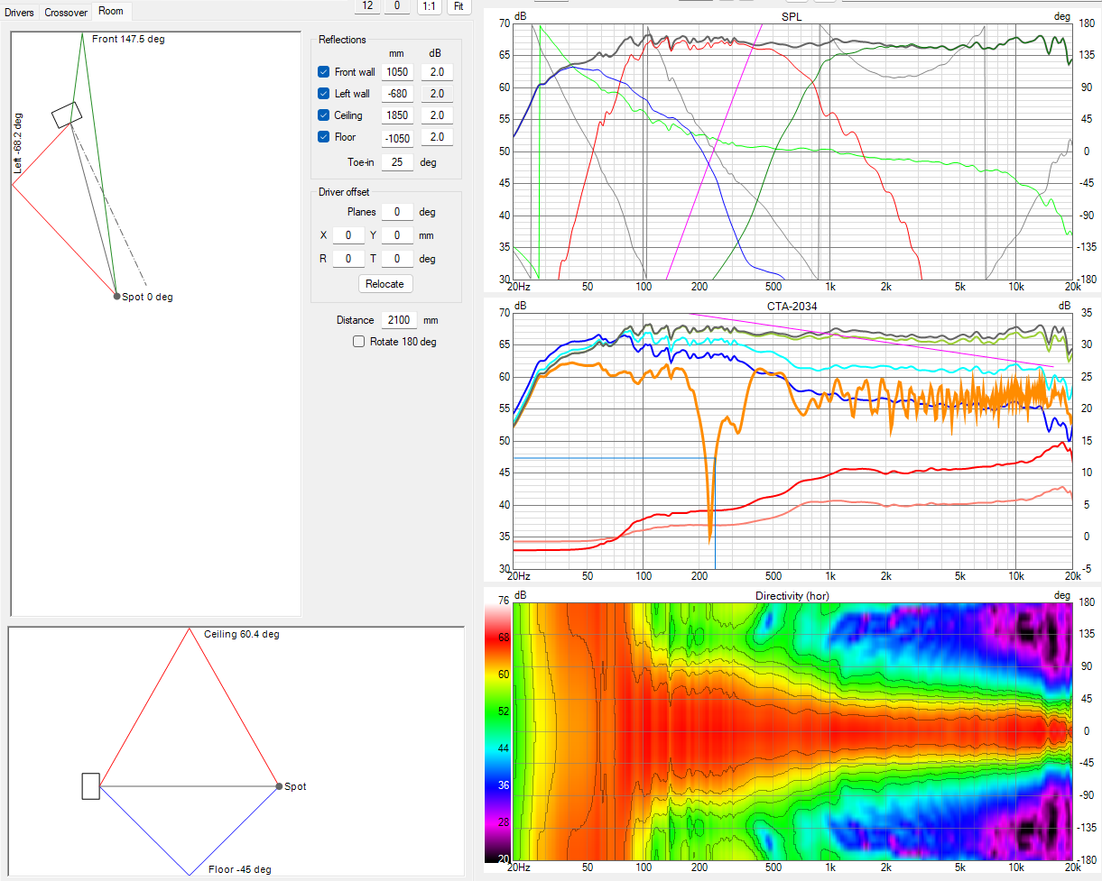

Tuning all other boundaries for 200Hz dip as well gives something like this, some of which might apply in your situation but doing this stuff yourself gives better idea what's true.

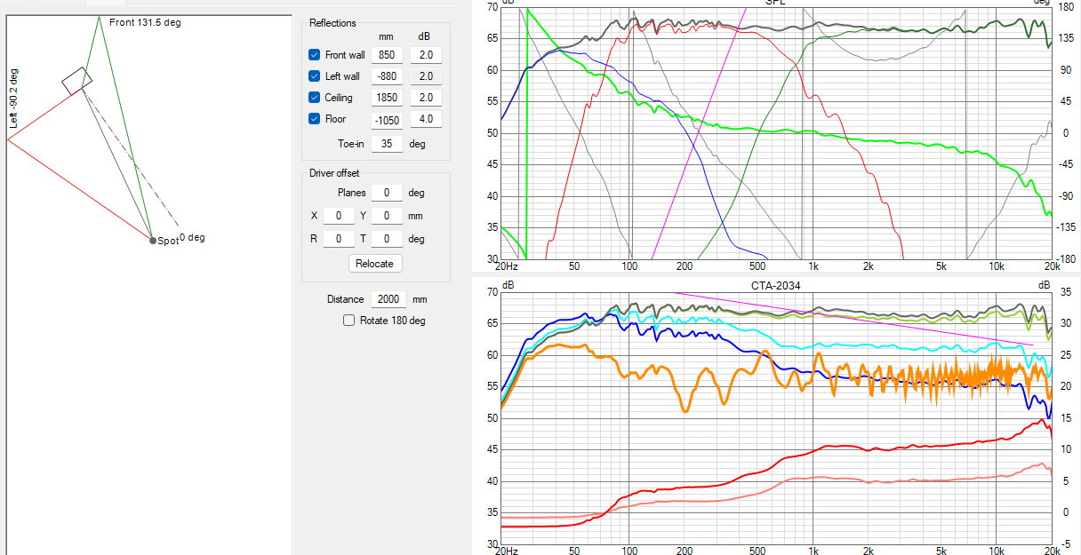

Thanks a lot @tmuikku 🙂

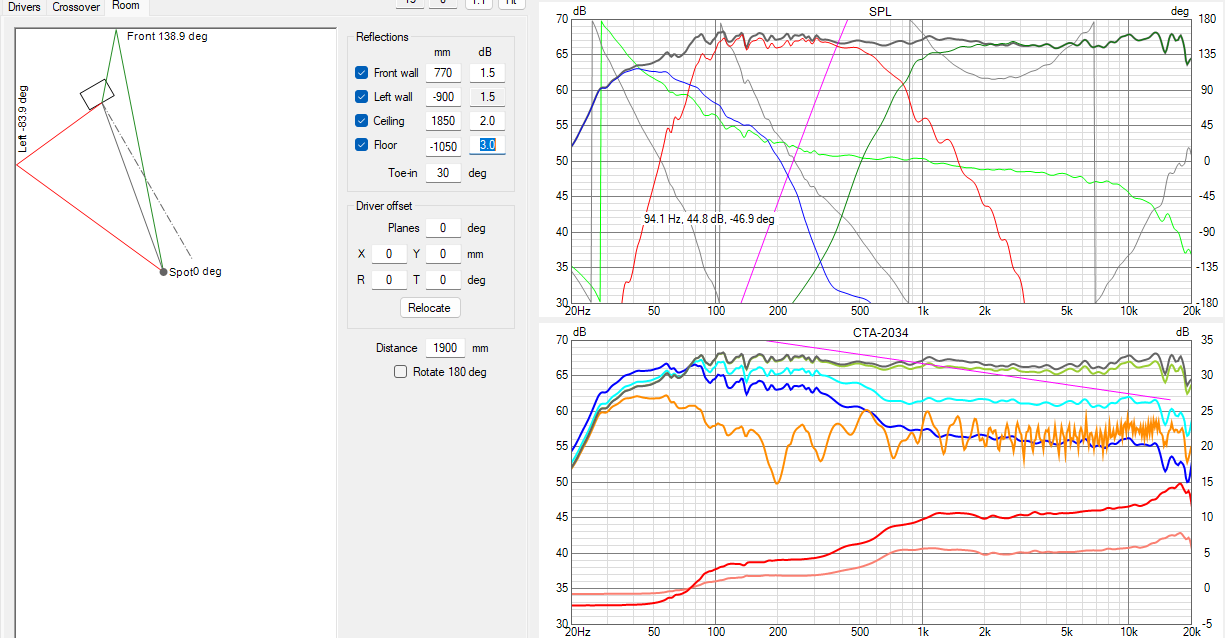

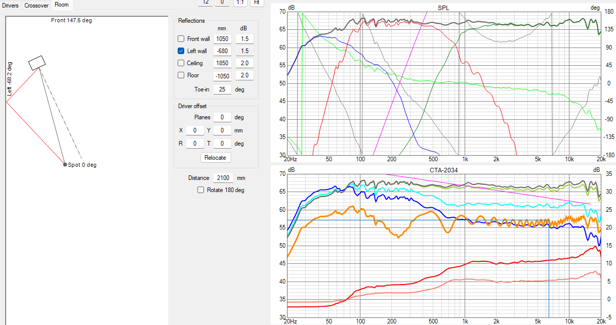

I just did a quick sim (again) & tried based on measured distances to each boundary.
The combined big dip is a combination of reflections from different boundaries.
Here is the combined plot

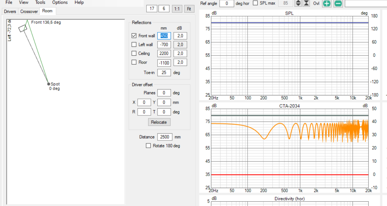

Effect of front wall (surprisingly less)
Effect of left wall (Now that big broad dip is coming up)

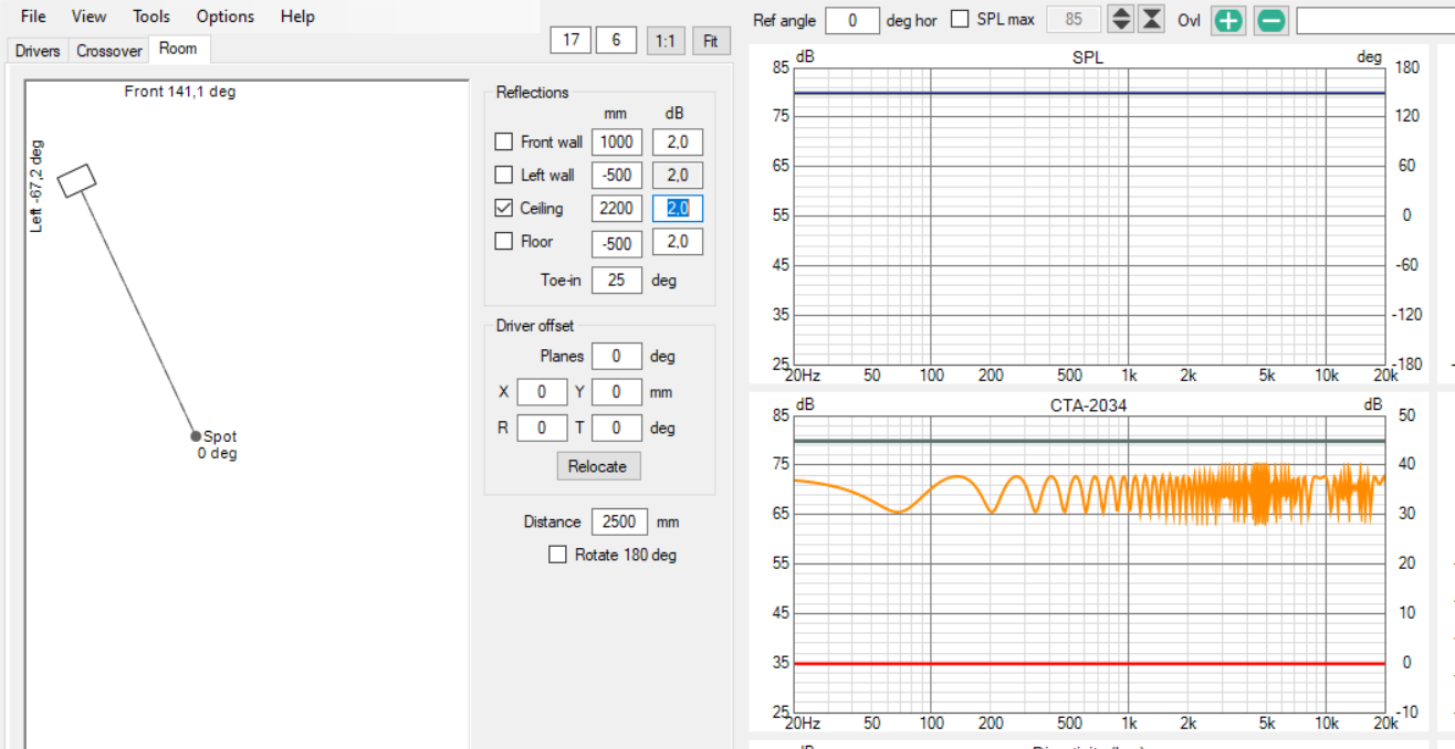

Effect of ceiling (again the second dip coming in the 200Hz region)
Effect of floor (again a big broad dip in the 200 to 300 Hz region)
All reflections combined causes this in simulation

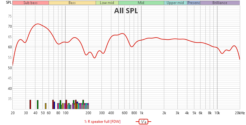

This is what is happening in the real world based on the left speaker measurement

If I adjust the left wall & front wall distance along with more toe in, I can potentially get something like this

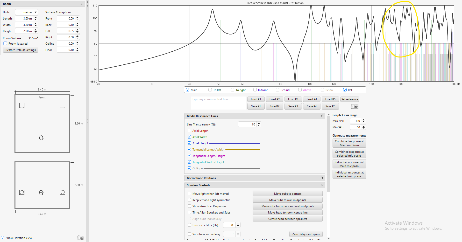

Vineeth, in room sim check how modes change when you move head vertically!!

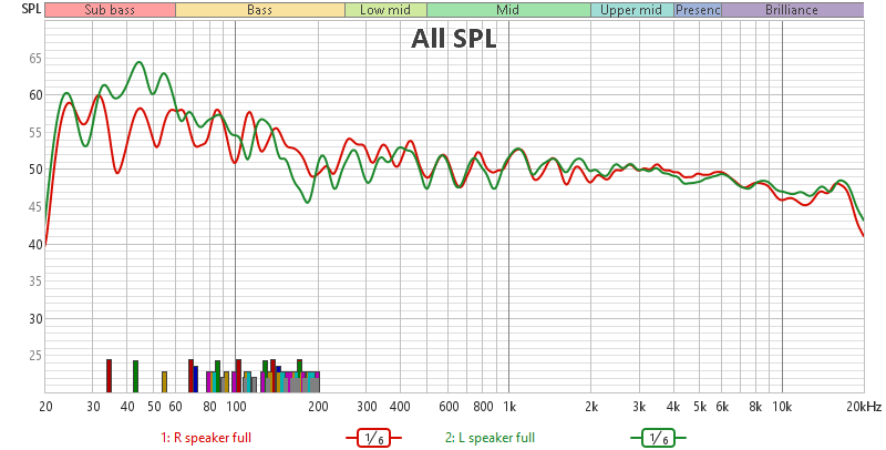

I shifted the speakers in the room and tried this placement option
Actual measurement without & with windowing
Overall there seems to be a good correlation between what simulator predicts & what I measure.
But I have run out of options with practical placement options..
With the same crossover as earlier, it definitely sounds a bit different to my ears now but I don't know yet whether it is good or bad..
Maybe I should experiment with some EQ to pull down that broad peak centered around 500Hz by a couple of dBs and also apply some straightening based on a downward-sloping line above 1kHz.. 🙂

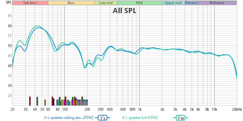

You're ~ 200hz issue certainly seem to be non-resonant SBIR effects (a couple, spaced closely), i.e. non-resonant (v resonant room modes). I am by no means an expert, but looking at your impulse and CSD/waterfall response can help determine what they are as you investigate.

Today I spent some time trying to narrow down the cause of that 200 Hz dip and I think I found it. It is the ceiling.
I placed 4ft x 2ft 20cm thick in all kinds of places I could keep them (front, back, sides, floor) in addition to two big 8ft x 2ft 20cm deep movable gobo panels. The dip seemed to remain very similar except when I placed the single 4ft x 2ft 20cm thick panel on the ceiling.. 😀
Then things started to change slightly for the better in the 200Hz region as shown below in the blue curve.
So If I am to get rid of this "problem", I need to treat the ceiling, which is a very hard thing to do due to practical issues at the moment..
So I leave that attempt here (and live with the green curve in above plot) and will move on to other things for now.. 🙂
The below is the response of the L & R speakers from MLP without FDW. if anything, I will try to slightly pull down that bump around 50hz for now

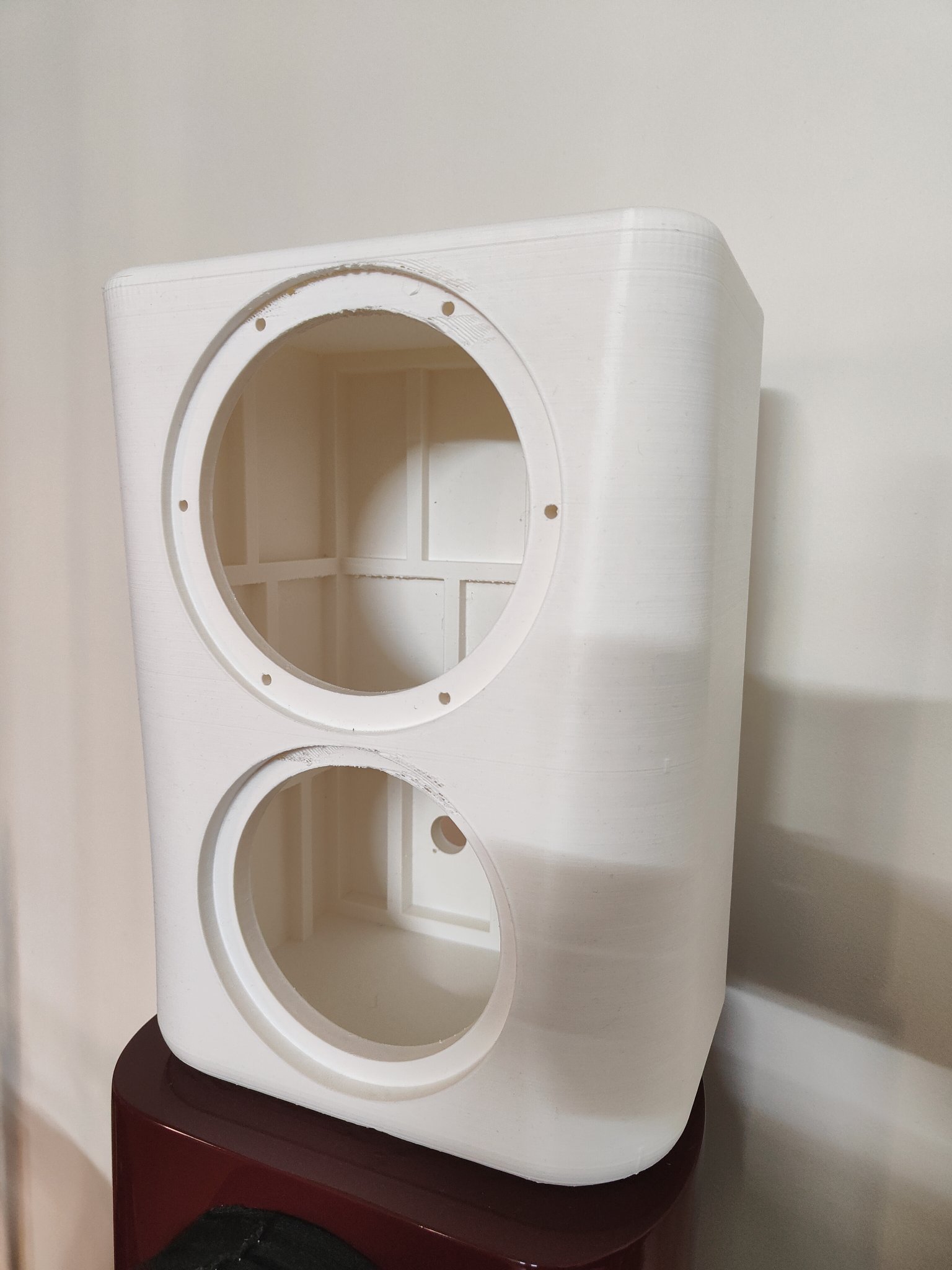

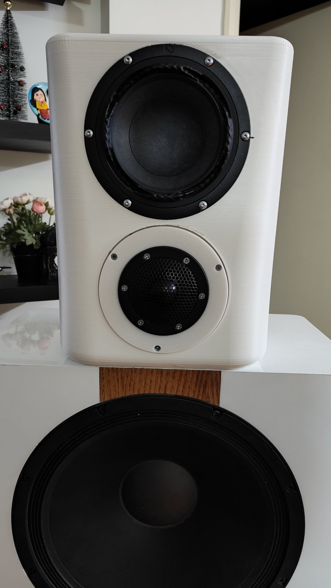

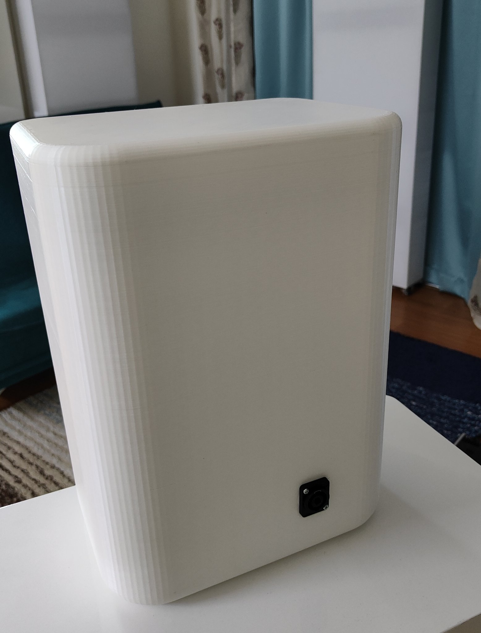

Slowly got that prototype cabinet printed for the purifi 2way, for the "PureBliss" system 😉 😀
First set of measurements are intended to be taken without any waveguide on the T34A. Then hopefully I will listen to it for a while with crossover implemented and then will move on to the waveguided version.
The tweeter holder turned out to be a few mm too thick such that it projects 3-4mm out of the baffle. Hopefully this wont cause a lot of diffraction and directivity problems in the frequencies where directivity matters..
I forgot to get the speakon connector, hence the delay in taking the measurements.. 😀
Here's how the whole thing can look in the worst case scenario.. 🙂
In fact, the 3D printed prototype cabinet looks and feels so solid that I dont know if I even need to make a final wooden build.. Or to just paint this one properly and use it..
