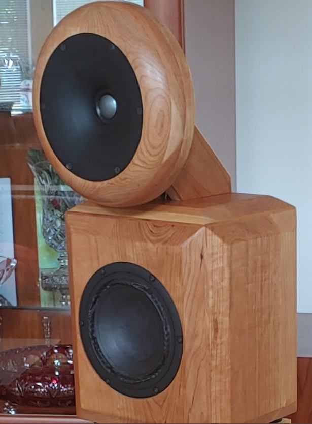

I would love to know also. I have T34Bs and had this idea in mind (with a round waveguide, though- Mabat's versus the many others around).I wonder how something like this would sound like.. 😀
Then something beneath it, same shape enclosure, driver that matches its directivity at XO- ?Bliesma M142A, ? PTT10, other?

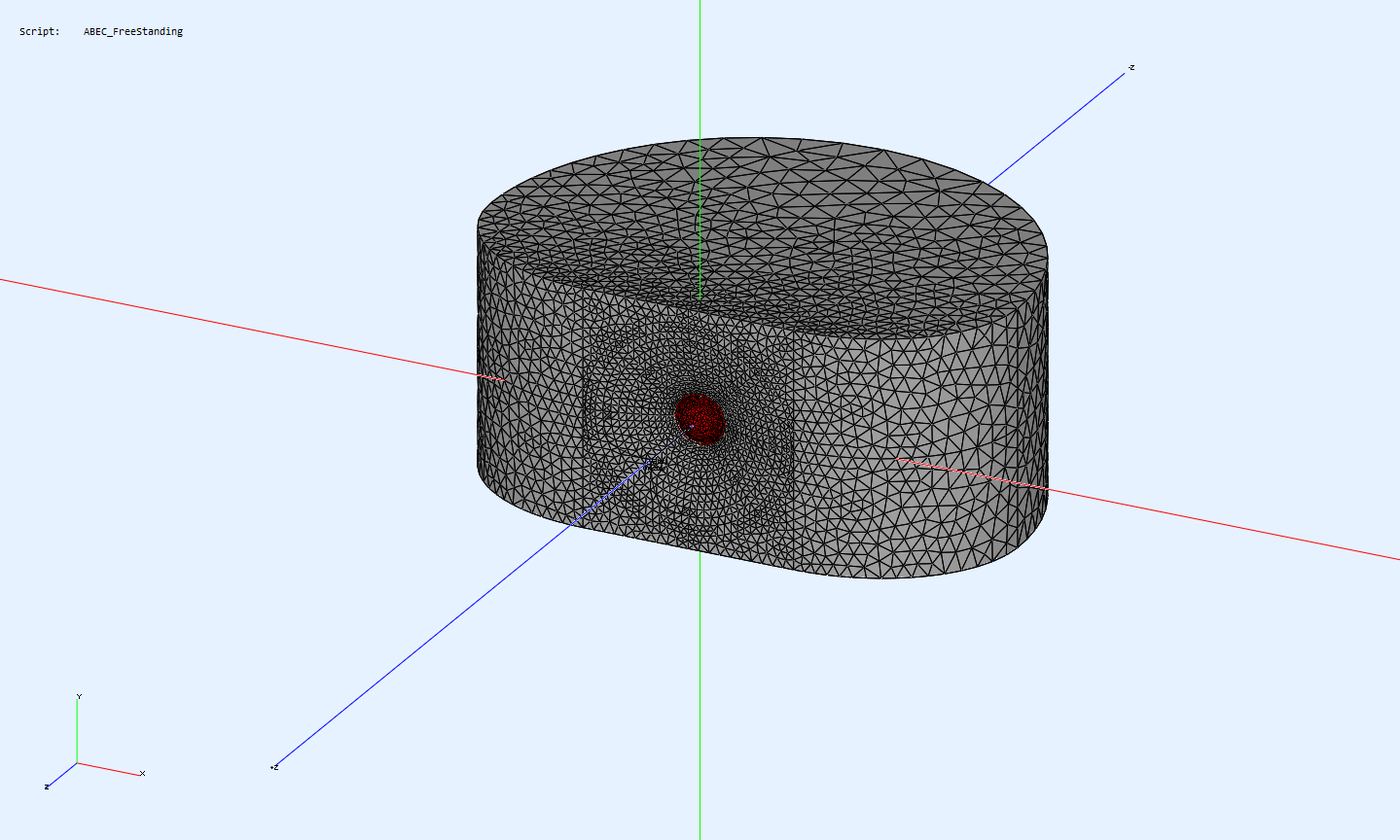

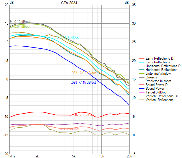

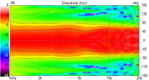

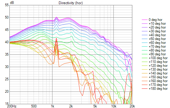

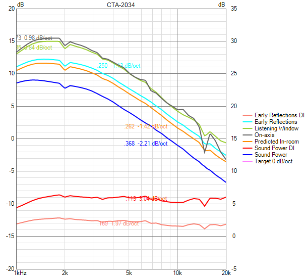

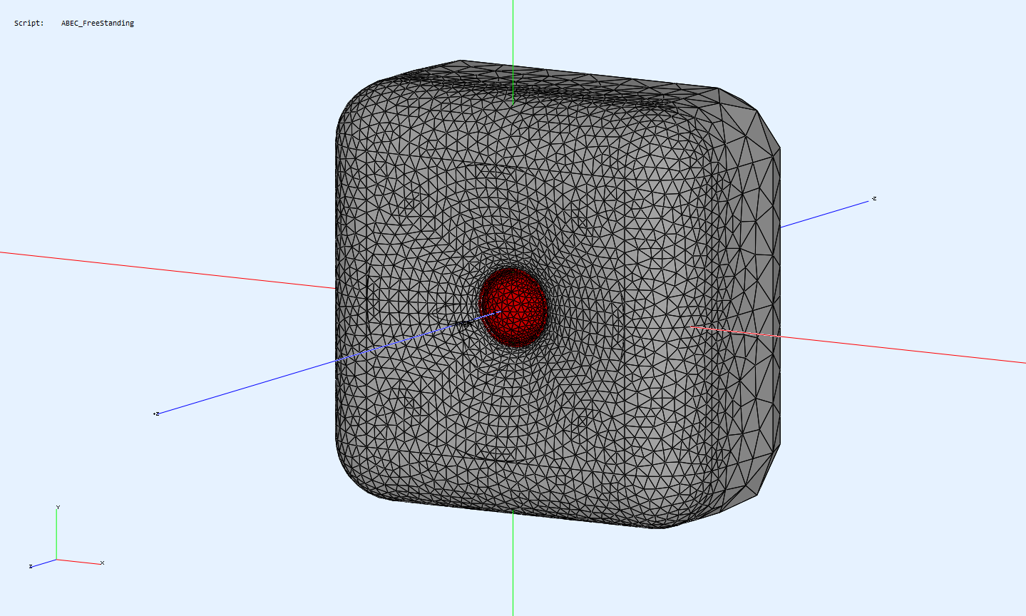

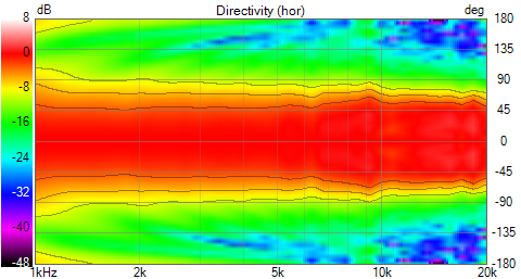

I am reducing the size of the waveguide to as little as it can be without a lot of compromises in an intended crossover region, somewhere from 1.5 kHz to 2.5 kHz. Will post progress here.. 🙂

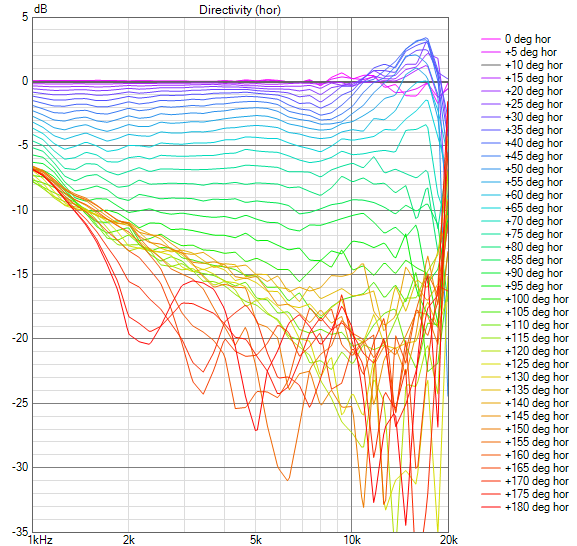

Here is a 150mm x 93mm elliptical waveguide.
6dB beamwidth is 73 ish degrees from 1.5kHz.
There is some amount of narrowing of the 3dB width around 8kHz..
Need to see what can be done about that.. 🤔
Make it round 🙂Need to see what can be done about that.. 🤔

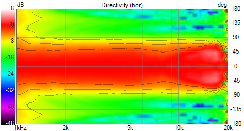

I made it round.. 😀
150mm in diameter, 18mm in depth

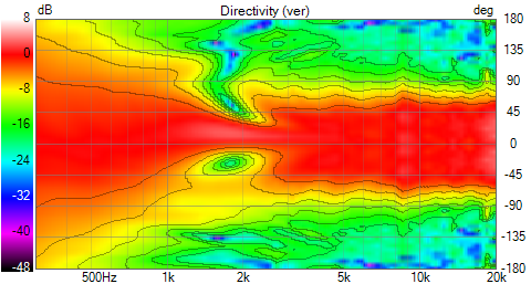

It's almost nice now.. still there is something bothering around the 5.5k to 6k region... 🙂
The 2kHz narrowing in the verticals is most probably due to no rounding/chamfer on the edges at top and bottom.. so that can be taken care of partly and then crossover will rip that apart

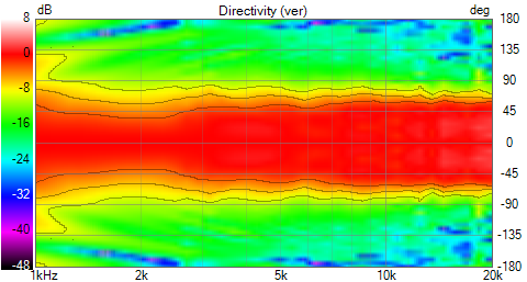

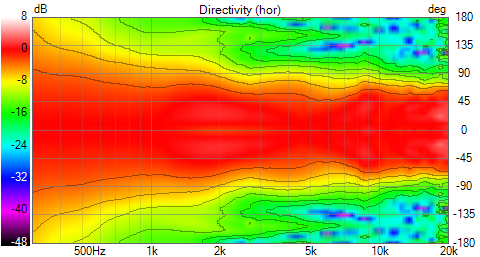

I reduced the depth to 16mm and put the waveguide in a normal rounded box with 30mm rounding
This is what I get..
6dB beamwidth of 70 degrees 😀

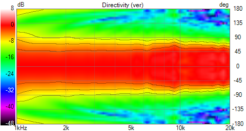

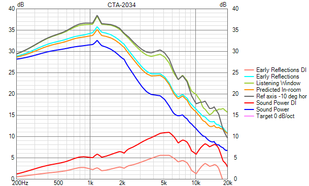

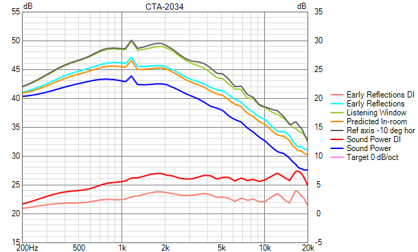

Increasing the roundings to 50mm gets rid of the lower frequency narrow better..
Comparison of SP DI of earlier iterations with 25mm and 30mm rounding vs current 50mm rounding below
Now I better understand why @hifijim did this on his waveguide 🙂

I copied the idea from many others who came before me. I was inspired by the experimental work of @Patrick Bateman and a simulation of @mabat. Later on, @tmuikku and I had a long thread where we bounced ideas back and forth, and we came to the conclusion that, if the goal is to reduce the size of the diffraction hump, then the rounded edge should start as close as practical to the edge of the tweeter.
@fluid has reminded me (more than once) that a bit of flat baffle area around a waveguide can provide some directivity at lower frequencies, and this may be useful in some design situations.
@vineethkumar01 , a suggestion to simulate, an elliptical curve starting with radius 50mm and end with a smaller radius of say 25mm, effectieve making the width and height of the enclosure a bit smaller.
From my sims i got the impression that the initial radius is dominant. Would be interested in your finding.

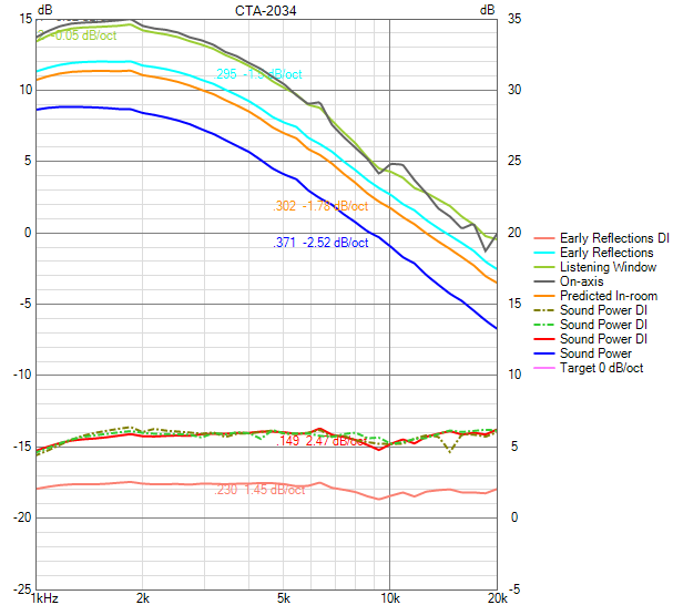

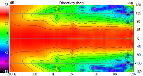

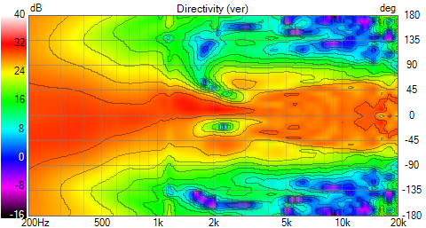

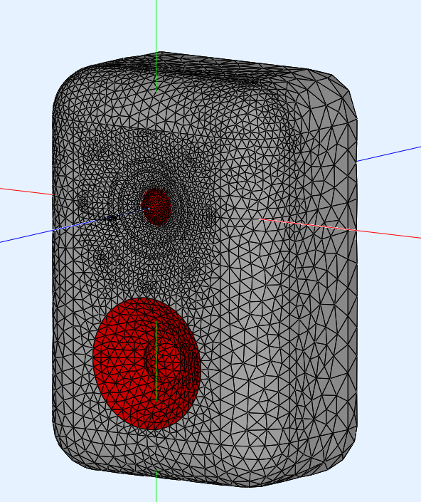

So this is what is possible with both the Purifi 6.5inch and the Bliesma T34 in a shallow waveguide (150mm diameter, 16mm deep).
Waveguide dimensions: 150mm diameter x 16mm deep
Cabinet dimensions: Width x Depth x height = 270mm x 200mm x 394mm
The height dimension can be reduced to 344mm by reducing the rounding at top and bottom to 30mm each instead of 50mm in the current pic. It will definitely have some (probably minor) impact on the vertical directivity.
At least the width dimension & 50mm rounding are needed for proper edge termination of the waveguide & avoiding midrange narrowing with the waveguide I think, although the crossover will probably take care of some of that narrowing part.

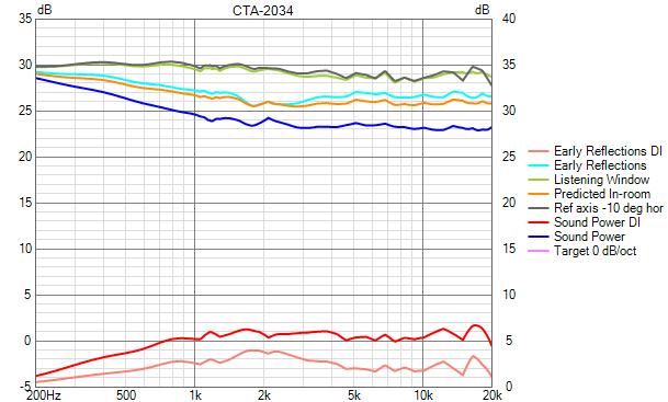

Tweeter in waveguide raw response curves (ignore the peaks around 1164Hz. It would be a simulation issue):
Woofer in waveguide raw response curves (ignore the peaks around 1164Hz. It would be a simulation issue):

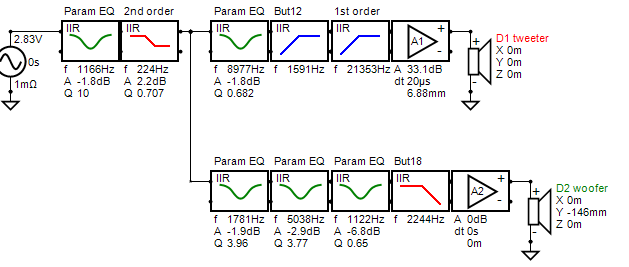

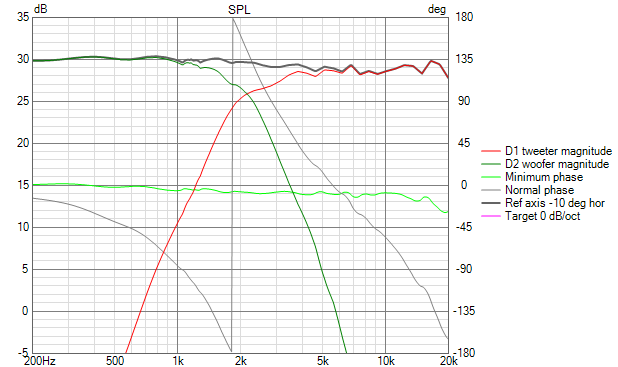

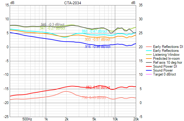

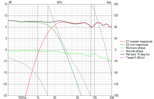

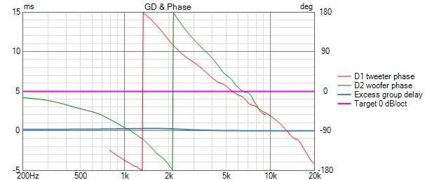

The full speaker response with a prototype crossover
I think the CTA 2034 curves & horizontal directivity are looking fine and I couldn't probably have asked for more..
What is missing in the modeling is the purifi driver mid break up region and the EQ required to tame it..
But it very manageable with this driver.
Also, because of the weird phase curves for each driver I got from the simulation, I forced the phase to minimum phase option in vituixCAD due to which I don't get any phase matching at crossover for the above curves.
With real driver measurements, I guess it will be more manageable.. 🤔
Ideally, the next logical step for me will be to create a 3D-printed prototype cabinet and take some measurements.. 😀

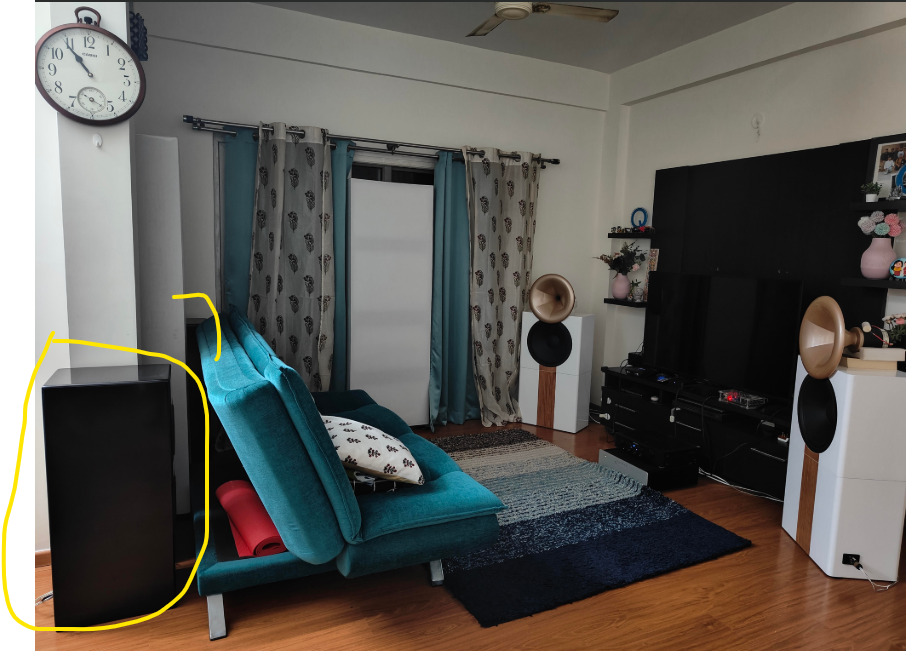

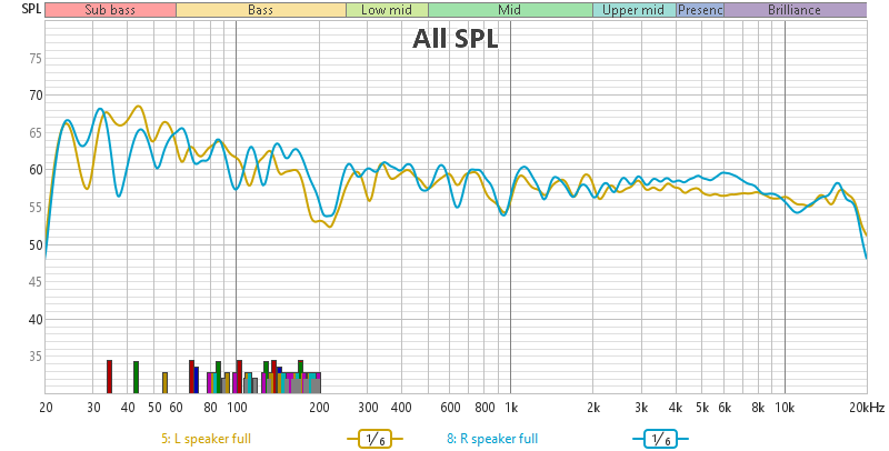

While thinking about refinements to the design of the purifi-bliesma two way top, I slowly pushed those Satori woofer modules into the living room and tried to put them in not-so-easily-seen places in the room.. 🙂
Then I tried to integrate and create a stereo sub configuration with two subwoofers at the back of the sofa and the 15-inch subs at the bottom of the main speakers. The inspiration is from earlier discussion in this thread and from here:
The bass is pretty awesome now compared to earlier.. 😀
Now I don't have to apply a lot of EQ in cutting down the peaks in the low-end and wondering about what to do with huge dips frequency response in the low end.
That 200Hz dip is still a bothersome thing, at least to the eyes 😉
Need to try to do something about it along the way..
Also need to treat the room more to get rid of some of that flutter echo.
I think technically, it can still be improved a bit more.. And I am still contemplating the practicality and implementation details of the double bass array.
But I am very happy with the bass that I am hearing now..
As an added bonus, I even get free back massages from the sofa due to the 4 x 10inch woofers firing from behind it..
It is a very "moving" experience.. 😀

After a few days/couple of weeks with the "multi-sub" set-up, I feel that this is one of the most noticeable/effective audio tweaks I have made so far.
The bass is so much more satisfying and more even across the listening space.. 🙂
There is a sense of effortlessness in the bass and I can "feel" the bass more in addition to hearing some subtle nuances.

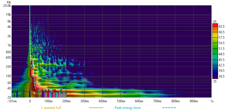

You tried multisub and DBA? Can you get good cancelation of modes with DBA?
I see that you have big hole at 200 Hz, but longer decay at the same frequency, interesting...can you see some geometrical connection to the room dimensions?
My next project is four active subs...made as a small cubical coffins, to be able to hide them in the room as a furniture...
