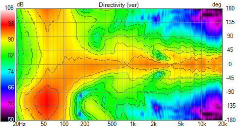

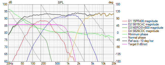

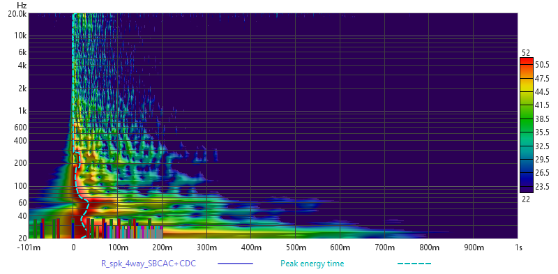

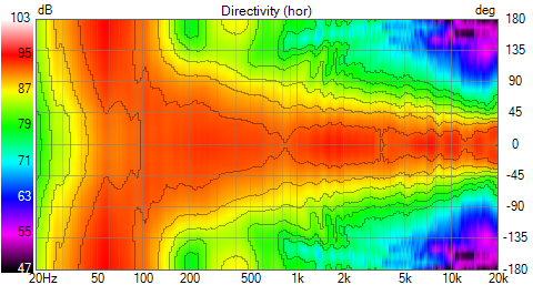

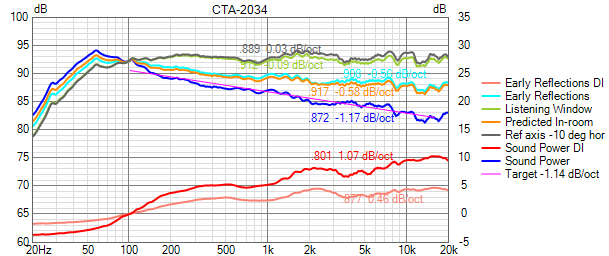

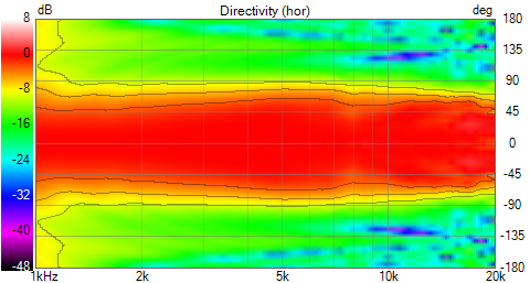

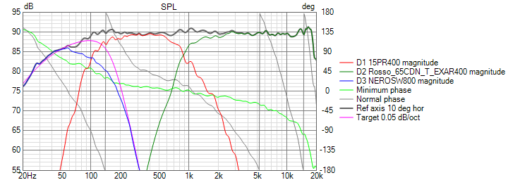

I cooked up a 4-way system using dual 15inch Cardioid bass-lower mid module + SB15CAC +SB26 CDC to check and compare how a relatively wide system might sound like in comparison with the horn-based system

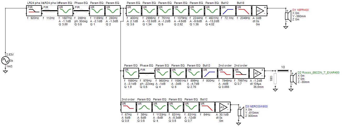

Here is the 4 way system config details

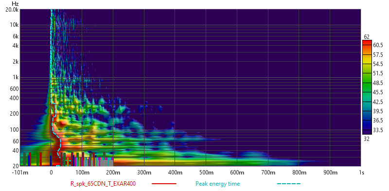

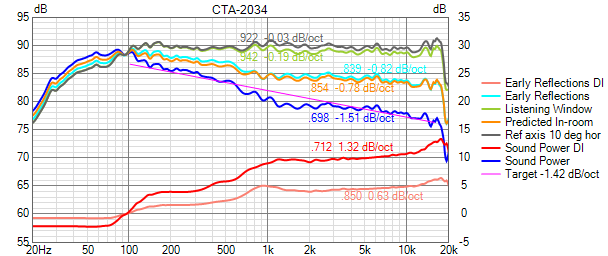

For comparison, here is the 3way horn-based system config vs 4way system config
4-way system
3-way system with EXAR 400

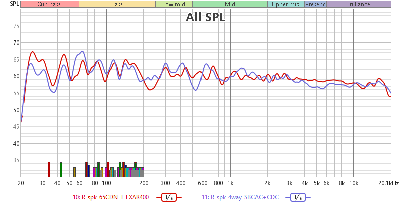

In-room response from MLP for both systems (for the right speaker)
3-way system decay
4-way system decay
And the recording of the speakers playing the same song in the same setting
My impressions of the 2 speakers playing in stereo
1) On the 4-way system, the imaging is a tiny bit hazy, but the sound is overall more "soft" than the 3-way horn system. I can listen to this easily for more time and my wife likes this one better 😉
On the horn system, it feels like the sound is more "etched/more defined overall (maybe because of more direct sound). It captures attention better
2) On the 4-way system, the feeling of spaciousness is a little bit more compared to the 3way system
3) The 3-way system sounds very hazy from the kitchen on the other side of a wall. The horn system still sounds attenuated by tonally very similar I think..
4) Sometimes, when I am listening in person, I think I am hearing more details in the treble on the 4-way system than the horn system. But when I record it and listen, both sound very similar. My hypothesis is that the horn system captures all of one's attention to the vocal range and doesn't allow one to focus on the upper treble details. Whereas the 4 way system with its "softer" sound allows one to focus the attention over a broader range of frequencies more easily..
Overall, I don't think I have found anything new w.r.t listening impressions and it may all be along expected lines.. But ultimately I think it is a matter of preference, which kind of sound one likes better.
I think I want the imaging of the horn system + the tiny bit softer sound of the other system 😀 (I tried out adjusting the listening distance for altering direct-to-reflected sound ratio with the 4way system but it still falls short of the horn system's capability w.r.t imaging )
4-way system
3-way system decay
4-way system decay

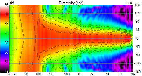

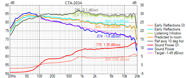

Reflecting about this more, I think this attention getting focused to specific frequency ranges (like in the horn system) based on directivity is expected..
When we get more direct sound (compared to reflected sound) in the range of frequencies where directivity plays an important role (700Hz to 7kHz?), our brain might tend to get locked on to that range (where we get more direct sound) and divert our attention away from other frequencies resulting in perceiving "missing details" in sound (actually caused by brain not focussing on it).. This could be why I thought I was able to hear more details in upper treble with the dome tweeter in small waveguide vs horn system. But in recordings, both sounded very close in terms of details..
So the solution/design approach for better results would be to make the variation in directivity as less and as smooth(ly rising) as possible in probably (ideally full range) the range of 700 Hz to 7kHz. Big kinks/steps in directivity might make the brain focus on musical content in the range of frequencies where this happens I guess (depending upon the magnitude of changes).. If it is a smoothly changing directivity over a wide range, maybe our brains have an easier time focusing on full range instead of selected frequency ranges..
I don't know if kinks/steps make yourself change brain focus but it have an effect on reverbered sound for sure. And as we hear a mix of both direct and reverberated it have an effect on rendering. Frequency range in which it happen seems to have different effect on rendering and how we perceive it ime.
This bump in the direct sound around 1 kHz can't sound good, IMO. Even if the "correction" meant a dip in the power response (which depends on the crossover), I'm pretty sure this is much worse subjectively.
I agree with @mabat about the peak and I (and my brother) prefer the 4-way system: the voicing of the 4-way is more balanced than the horn system (has too much sibilants and the voice of the singer seems too thin).
That said, I would not use a song with instruments (voice included) that are electronically manipulated to evaluate a system because you loose all the reference points: opera, classical music, acoustic instruments, etc. are much more suited imo.

I posted the wrong crossover for the horn system.
Actually, the crossover was this
@shadowplay62: If you meant sibilance in the youtube video, please ignore the sibilance part because I found that it is just there in all my recordings.. I think it has something to do with all the late reflections captured by the mic. So while listening in person, the sibilance in all my videos have been much less..

I would still shift the WG branch ~1 dB lower 🙂Thanks @mabat for pointing this out..

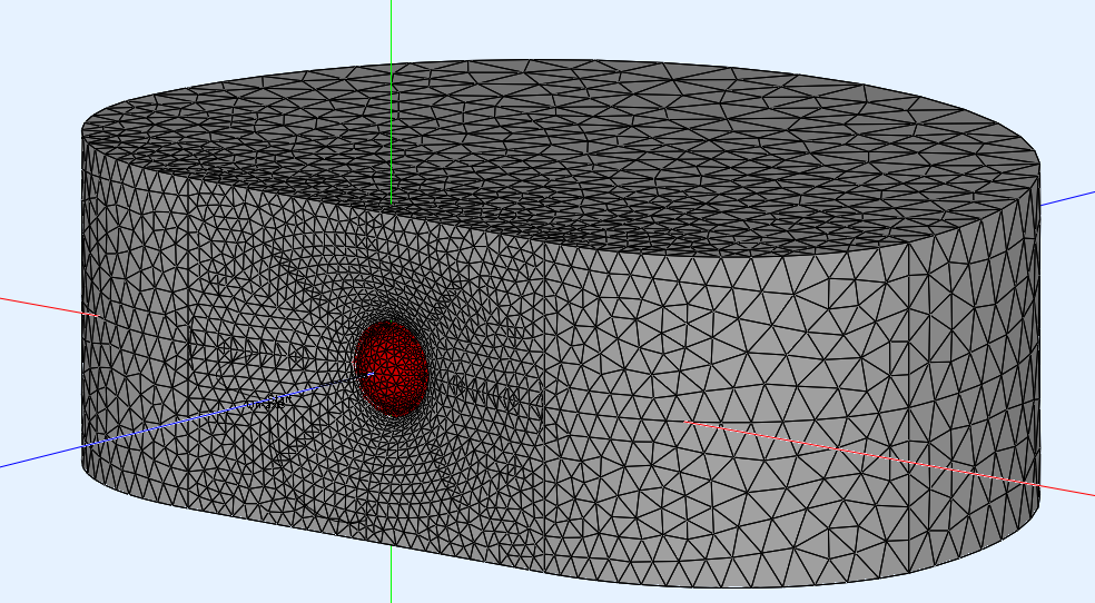

I wonder how something like this would sound like.. 😀
Shallow waveguide on Bliesma T34A
