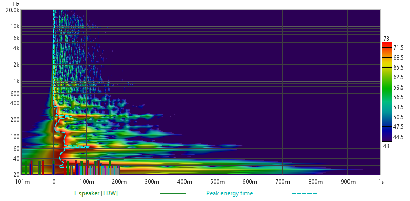

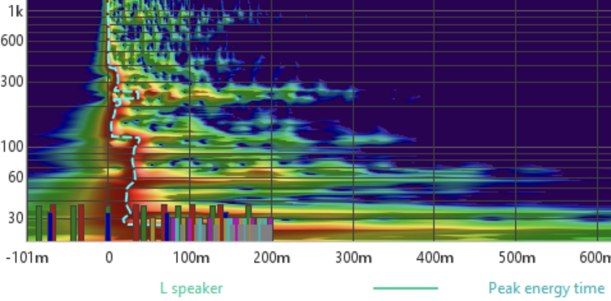

We must differentiate reflections and room modes. Remember also psychoacoustics

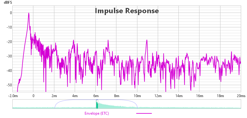

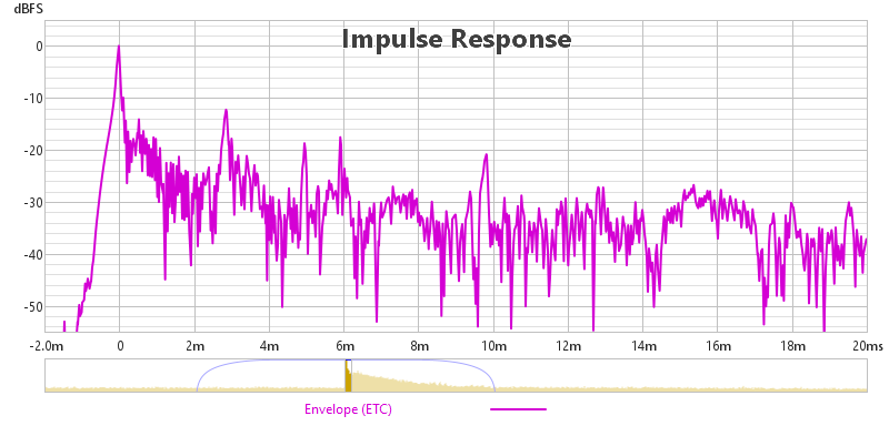

  • your first reflections arrive mostly at 2,8 and 5,6ms (peaks in impulse envelope)
  • below 3-400Hz we sense total sound power within at least 300ms of a sweep (much longer than 5 cycles as you used)
  • room modes dominate perception below 3-400Hz , there first reflections have minor effect (except perhaps transients?)
In your Left speaker wavelet Peak energy of bass below 100Hz is roughly 30ms late and 250Hz is pulsating after that, up to 150ms. Fortunately important octave 120-240Hz is pretty clean! Absorber panels did reduce pulsation of 250Hz quite well yes.
So, absorbing panels just at first reflection points won't help much for bass, only upper midrange and treble (which has very short decay because of high directiviy horn anyway)
Different positioning of speakers or seat will just change/distribute reflections and mode effects (peak energy) differently. Only wide area thick absorbers on two walls and ceiling would really help for bass.

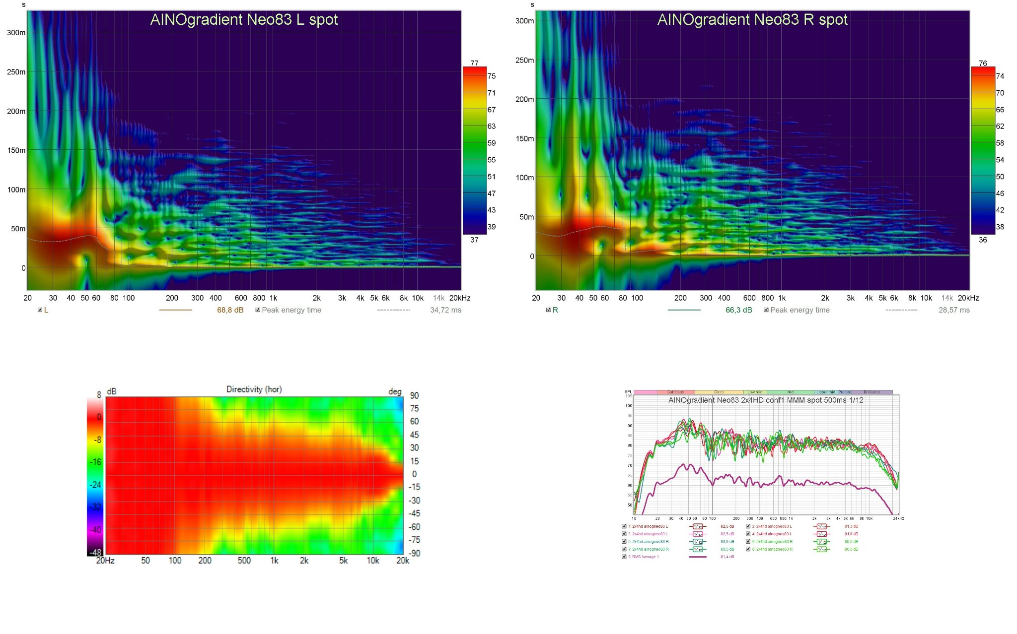

Wavelet without absorbers, close-up
For comparison, my room with dipoles has much shorter RT above 200Hz, but still L and R have very different decays/modes in bass which is monopole below 150Hz

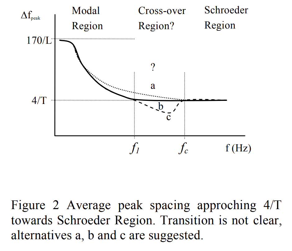

Schroeder region is based on 4 times T60 (-60dB attenuation) and room volume, but transition is not sharp. Typically 200-300Hz
https://www.akutek.info/Papers/MS_Schroeder_Revisited.pdf
"A major problem is the fact that the Schroeder Frequency fc=2000·(T/V)*0.5 can not be detected directly by measurements."

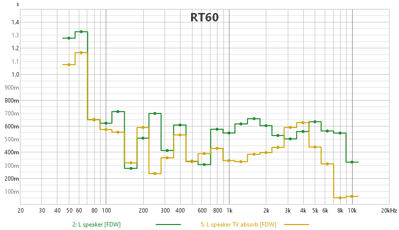

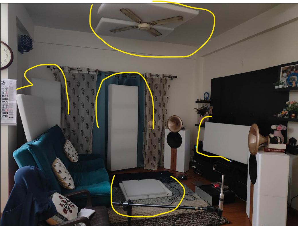

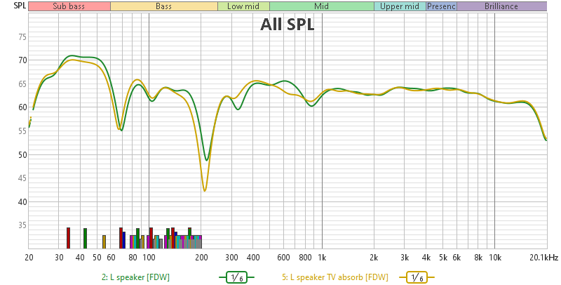

I tried using 50mm thick absorption panels (https://www.auralexchange.com/product/nankarrow-geofill-premium-fireproof-acoustic-infill-boards/) at various places in the room, made some measurements, recorded a video clip and got rid of all that from the room before my wife caught me doing this kind of torture to the living room.. 🤣 🤣
Anyway, these absorption material are not targeted towards the low frequencies and are mostly for upper mids and highs from their specifications. I just used it because I had them lying around.. 🙂

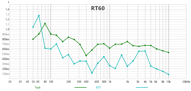

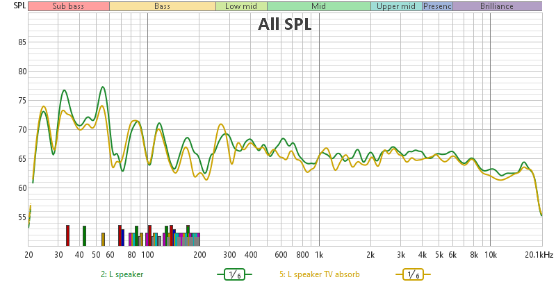

Here are some results before and after using the absorption material
That ceiling reflection related area around 900Hz improved ever so slightly I guess.
I found that the close to 3ms secondary peak in above plot comes from the reflection from the sofa to that reaches the mic.
When I pulled out the mic towards the speakers by about 20cm out, it went away as shown in below pic

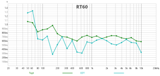

Spectrogram before "acoustic treatment"
Spectrogram after "acoustic treatment"

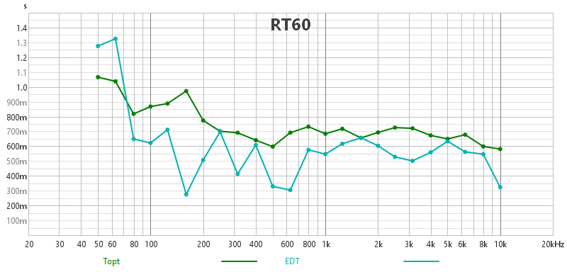

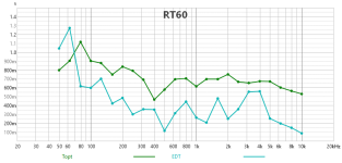

EDT & Topt before & after "acoustic treatment"

Subjectively, listening to the same song before and after, I feel that the vocals have relaxed a bit.. It is slightly more easier to notice fine details in the songs.. I feel like this is an improvement in the overall listening experience.. So I feel motivated to do something more about this.. 🙂
I think I need atleast 100mm thick panels a bit more "health-friendly" but more with more absorption capabilities at the back of the sofa put inside some nice acosutically transparent fabric with some pattern/picture like @wesayso has in his room, some behind the TV screen some in the corners, some attached to the ceiling with some double sided tape (hopefully) etc..
Now, how to do all this without making the living room a cave is the next question.. 😀
