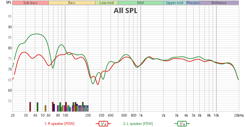

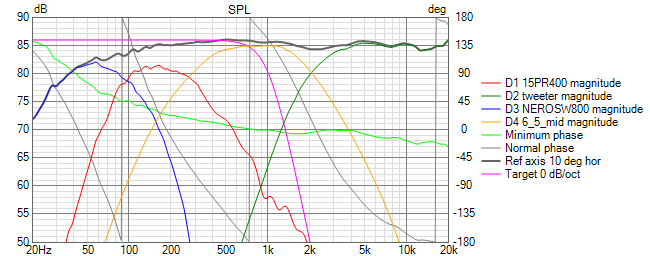

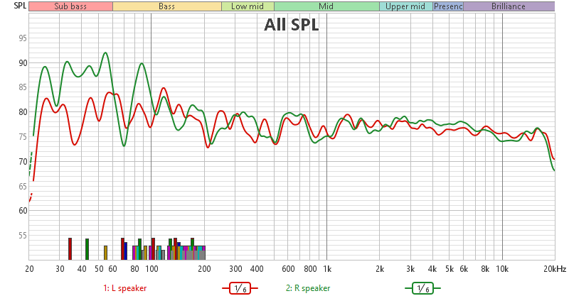

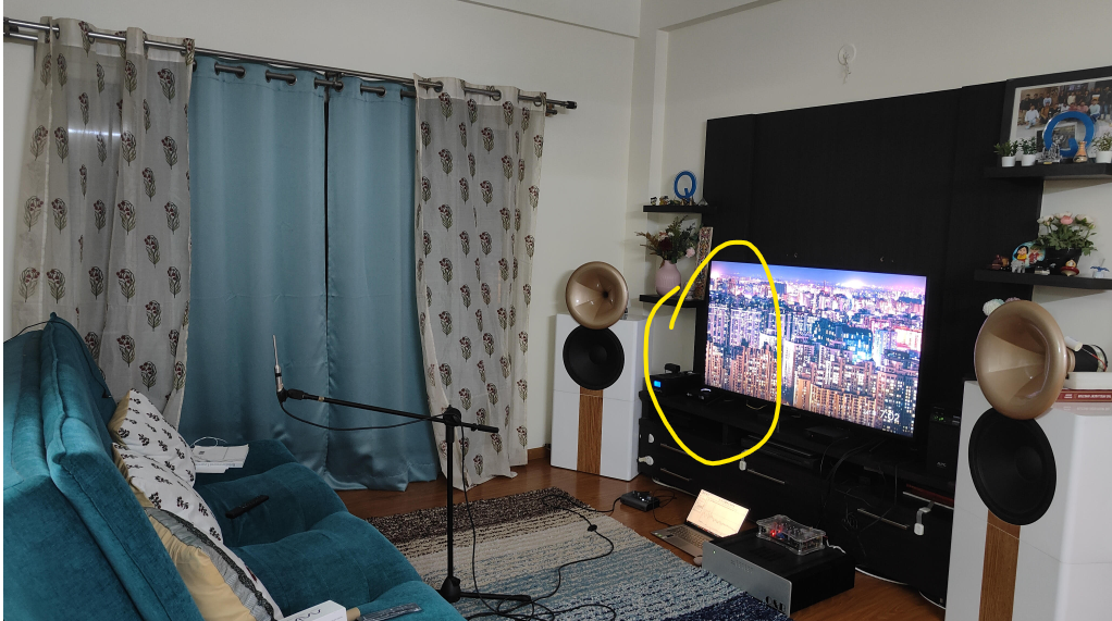

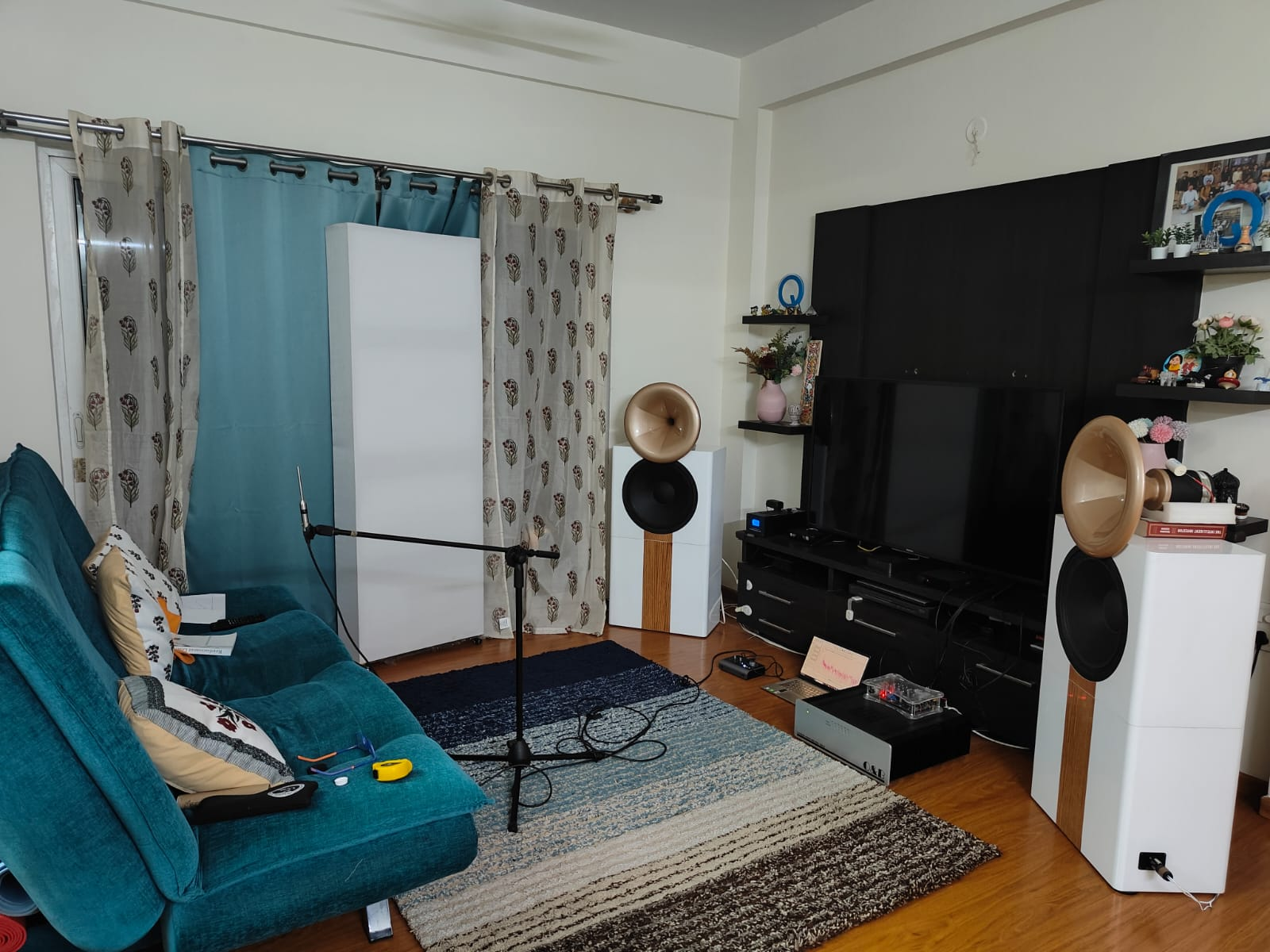

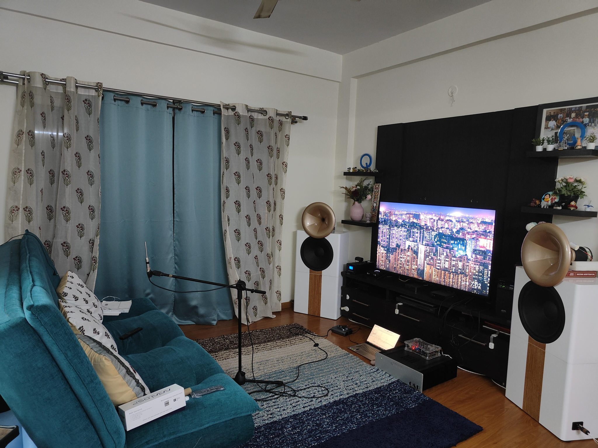

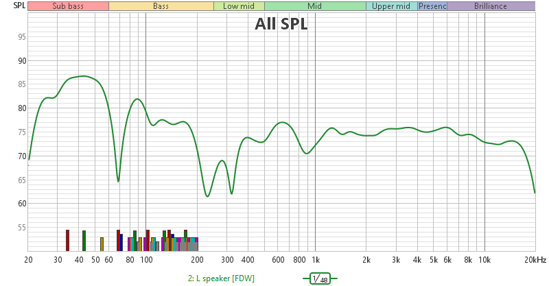

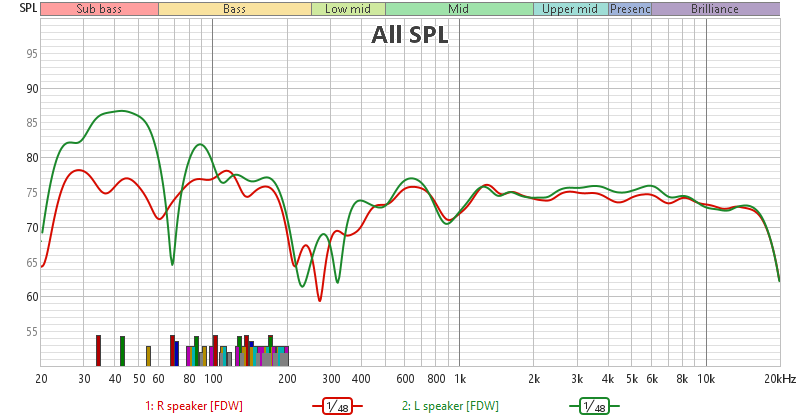

I took measurements of each speaker from MLP using my Isemcon EMX-7150 mic with 90-degree cal file at the position where my head/ears would be during usual listening. The room height is 2.9m. My location is about 2.2m away from each speaker.
L speaker is the one on the left side of the pic
R speaker is the one on the right side of the pic
Quasi anechoic measurement based graphs
Frequency response curves at MLP for both speakers (with no additional EQ other than crossover)
The same graph with 5 cycle FDW (frequency-dependent windowing)

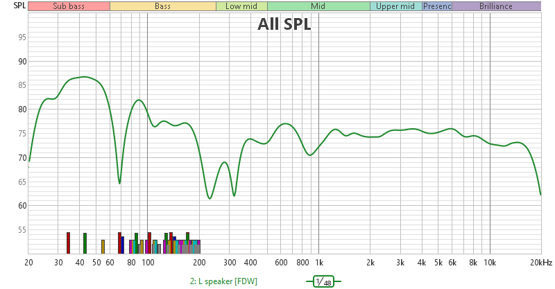

The L speaker gets more boundary reinforcement at low bass than the R speaker due to its corner placement.
That 88Hz peak is a usual problematic room mode which used to EQ down (but not yet done on this one since I haven't heard the problem caused by it yet)
The region in between 200 to 300 Hz seems to be the most affected by reflections followed by the 900Hz region which sees a 4dB ish dip (right in the crossover region).

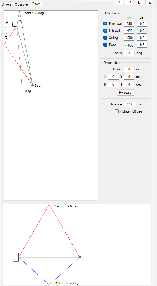

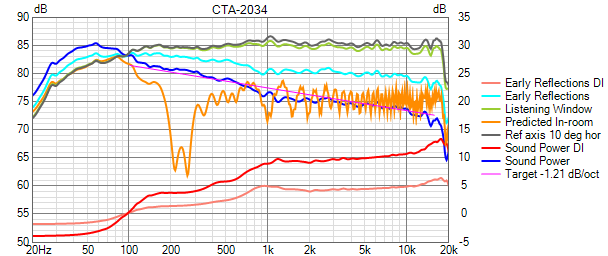

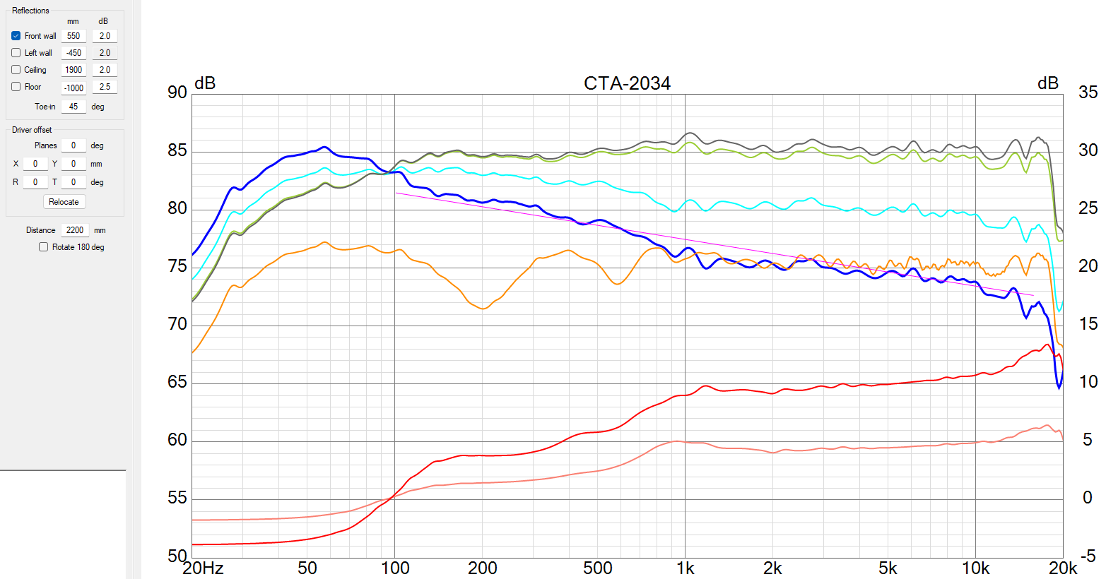

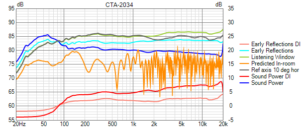

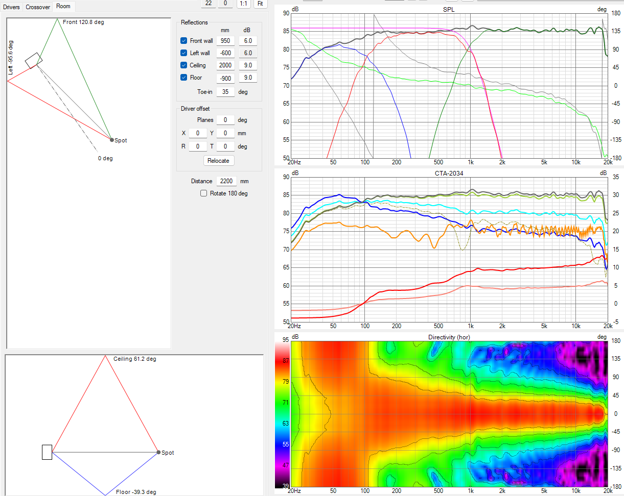

Let me take the L speaker and model the proximity to boundaries based on actual tape measurements to each boundary
Predicted in room response based on this (orange curve) and comparing with actual FDW edmeasurement from MLP
Wow.. So all the reflections combined is wrecking havoc in the 200 to 300 Hz region and the 900Hz region 😀

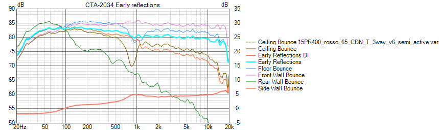

Now Let's look at the approx contribution of each reflection
1. Front wall alone
It looks mild
2. Front wall + Left wall
The 200Hz reflection problem is worth taking care of now.. 😀
3. Front wall + Left wall +Ceiling
4.
All major reflections combined
So it looks like the floor needs thicker carpet and front wall and left wall needs some heavy attenuation (aiming at the 200Hz to 300 Hz region) and/or some more directivity in the 200 to 300Hz region (which I don't know how practical it will be)

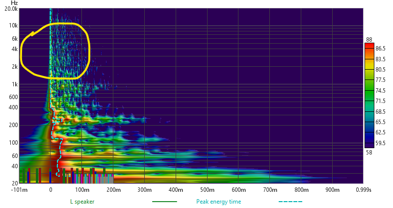

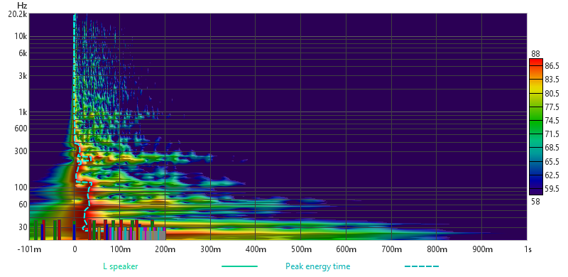

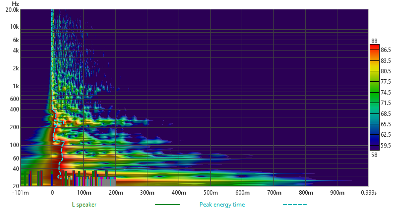

But what will that do to the overall decay spectrum?
Spectrogram
For comparison, here is a spectrogram of the 3way using the Satori woofers + SB15CAC +SB26CDC in our earlier house (with the same carpet and extra 2 8inch thick 8 ft x 2ft broadband absorption panels nearby at first reflection points) 😀

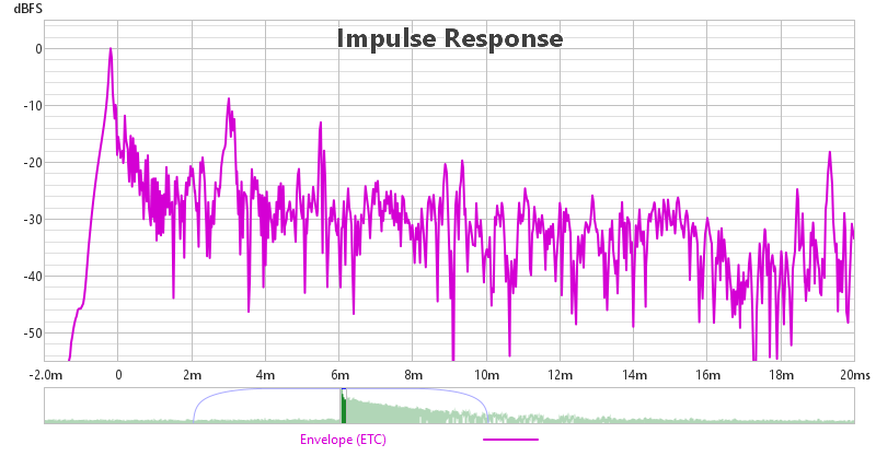

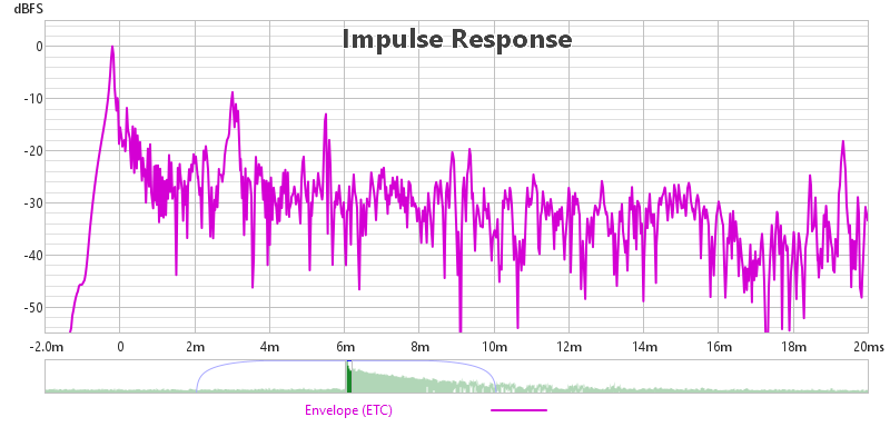

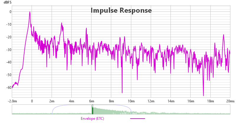

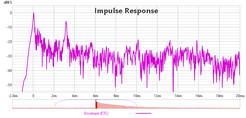

ETC showing the arrival of the major reflections at 3ms & 5.5ms

It might damp the high frequencies too much if i use more absorption in this room
In this situation it looks like the best solution is to have wider directivity speakers/top module than what I have and then treat the room how much ever can be done.. 🙂
Sort of reinforces Kimmosto's general recommendation about wider radiating controlled directivity speakers and appropriate room treatment being a better solution for good sound.. 🙂

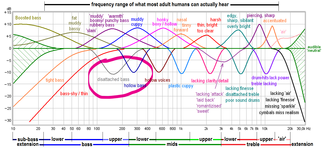

I think I might have got a clue regarding the blurred bass lines that I was commenting about earlier.. 😀
Comparing with the below pic (don't know if this is exactly right but seems to correlate somewhat with perception)
That 200-300 Hz region 10ish dB wide dip & delayed energy filling that gap might be contributing to that perception.. 🙂
Maybe the below is the reason for the feeling of a tiny bit less treble with the speakers

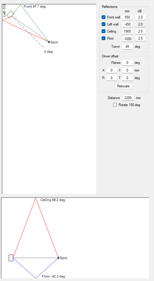

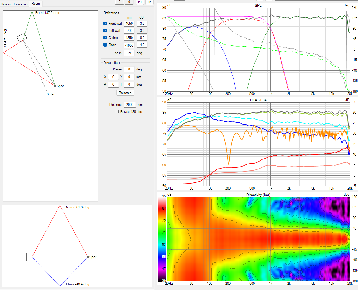

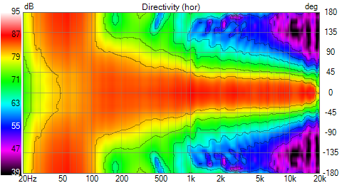

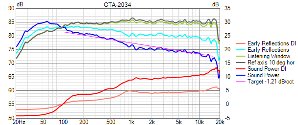

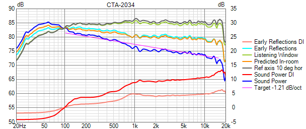

So I thought about what to do to design a speaker for this room based on the reflection attenuation.
I need bit more treble energy & need to reduce some of the strength of first reflections.

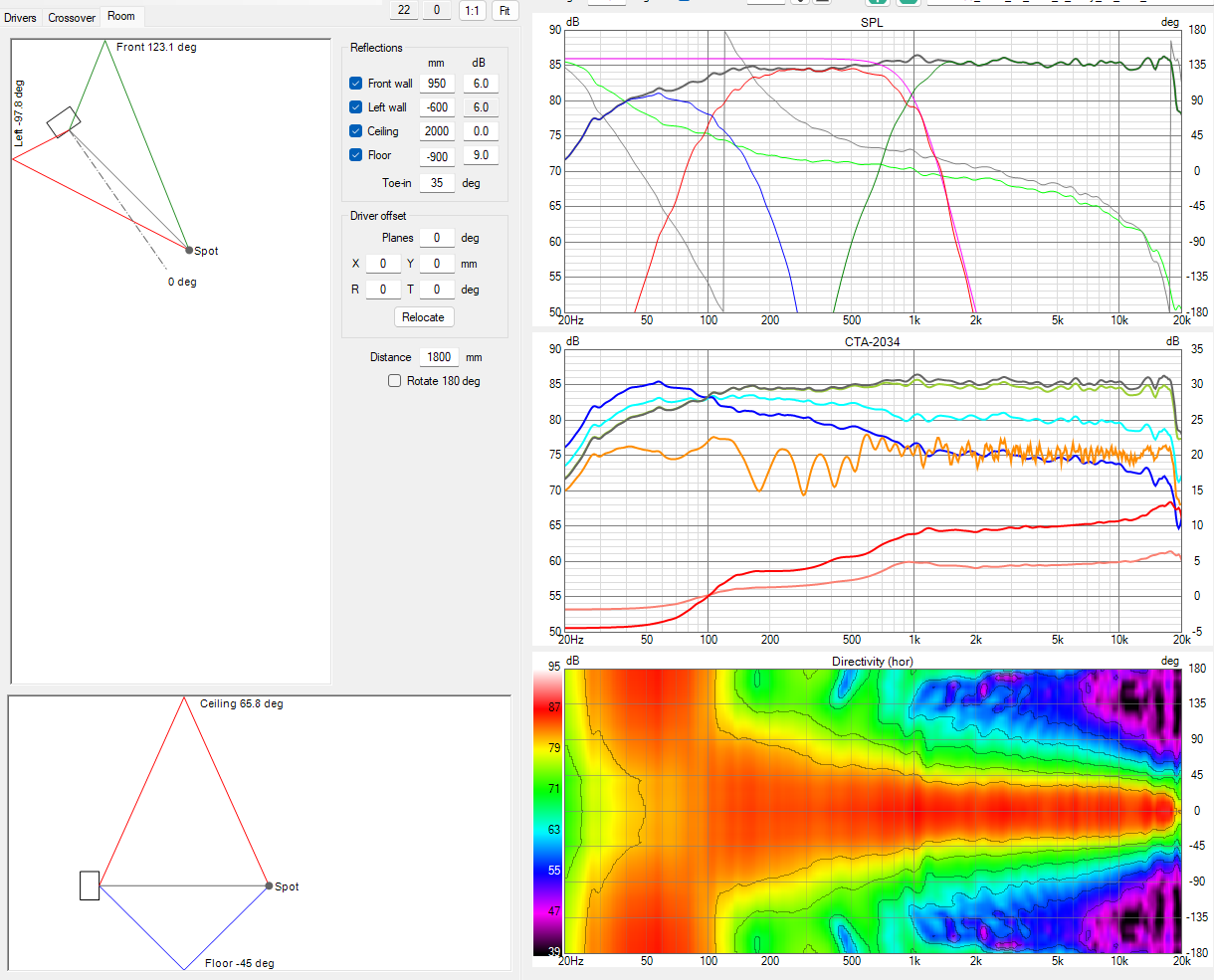

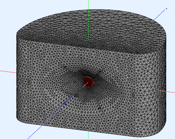

So I again went back to the Purifi + SB26CDC tweeter on waveguide+dual 15inch bass module configuration & added some absorption on the floor and walls
tweeter in waveguide + purifi mid on top of it in a 35cm wide cabinet. BEM sim + Baffle diffraction sim of mis based curves are used to get the below speaker's overall responses
Below 100Hz is anyway going to be controlled by room. But the 200Hz to 1kHz region might be better compared to the current situation shown below
Ceiling absorption might help much more like shown below but that is not viable
But now I might be able to afford that strategically placed little extra bit of absorption in the room because of the more energy sprayed into room by the wide radiating tweeter.. 🙂

It is often forgotten that cardioid style radiation patterns do nothing to reduce sound towards the side walls and SBIR dips from them are just as bad as any other speaker.
The left speaker being tucked in the corner is always going to be tricky. You are also getting a low bass boost on this one side. Taking this down will also help to rebalance the sound. Too much bass or not enough treble sounds very similar.
An axisymmetric waveguide can always benefit from ceiling absorption. Ceiling reflections are quite damaging to perception. Making the waveguide asymmetric is a double edged sword if trying to reduce ceiling reflections, is there enough directivity at the ceiling bounce frequency range to have a useful effect?
I don't know if you have any placement flexibility but on the left some dips are exaggerated by having the same distance from side wall to rear wall. You can experiment virtually with Vituix to see if there is a practical placement that gives less interference. This is all about distances so for this sort of thing the basic function in Vituix works quite well.
Kimmo is advising for the fix to be in the room and acoustics, not in the speaker through high directivity. If you go with low directivity but still don't fix the placement or the room, it will not get better.

I will try to pull out the speaker more into the room. This tends to reduce the bass boost for that speaker.
I will also check out what happens to the treble with this change.

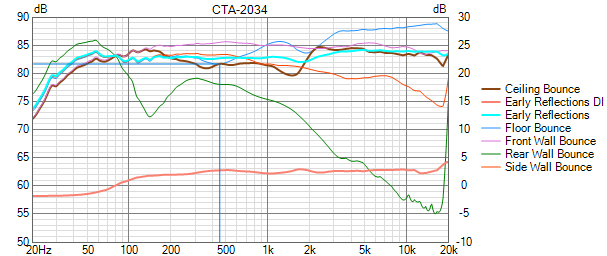

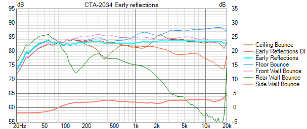

With my current speaker, the spinorama ceiling bounce seem to be affecting the most around the 800 to 900 Hz region
This also correlates with the 4-5 dB dip I have in the same region
For the smaller purifi mid-waveguide speaker top module (in future plans) with elliptical waveguide, the ceiling bounce-related effects seem to be milder and more spread out from 400 to 1.8kHz region with shallow slopes on the 15PR400 & the purifi as shown by the brown curve below.
Separating the midrange from the woofer with the woofer closer to the floor & the mid relatively higher up seems to make the effects of the ceiling bounce mild without any treatment

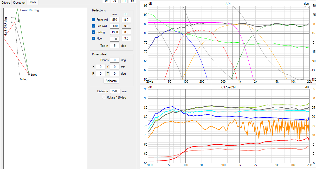

I tried that and this is the best I could do with practical placement options for the current speaker in the room.
Bascially pulling out the speaker into the room will alter the distances to the front & left walls and distance to MLP.
Slightly altering the toe along with that and adding some carefully placed absorption gives the below.
This above one looks relatively milder but more spread out compared to current situation shown below
WIth some ceiling treatment, it can be like this even 🙂
This can be easily treated with basotect on ceilling.
10cm with some centimeters gap should kill the reflection applied RFZ way ( the way it's done in a Reflection Free Zone, area treated abit wider than the first reflection area).

I am not able to do anything on the ceiling because of the rented accommodation and not having permission to drill anywhere in that room.
Regarding the left wall, I have these 8ft x 2ft x 8inch thick Absorption panels, which I was thinking about using on the left wall (actually a big glass window covered by curtains and opens into a balcony). I also have 10cm thick 4ft x 2ft basotect panels lying around.
Since these panels are movable, maybe I will be able to convince people at home that I need it at first reflection point, at least while I am listening to music.. 😀
The front wall is more of a bigger problem because of the big TV screen there, otherwise, I could have put some kind of absorption material there.

This is all w.r.t left side speaker (floor reflection at 3ms & another major reflection, probably combined effect of walls at 5.5ms).
The right-side speaker is more problem-free because the nearest wall is 3+ m away and I just have to increase the absorption on the floor. In the first 20ms, the major first reflection comes around 3ms from the floor. everything else is at or below -20dB compared to the main peak.

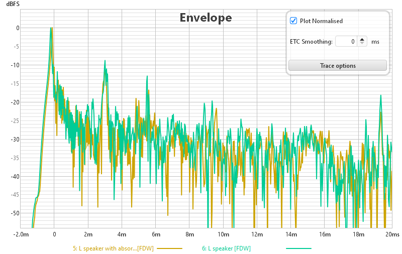

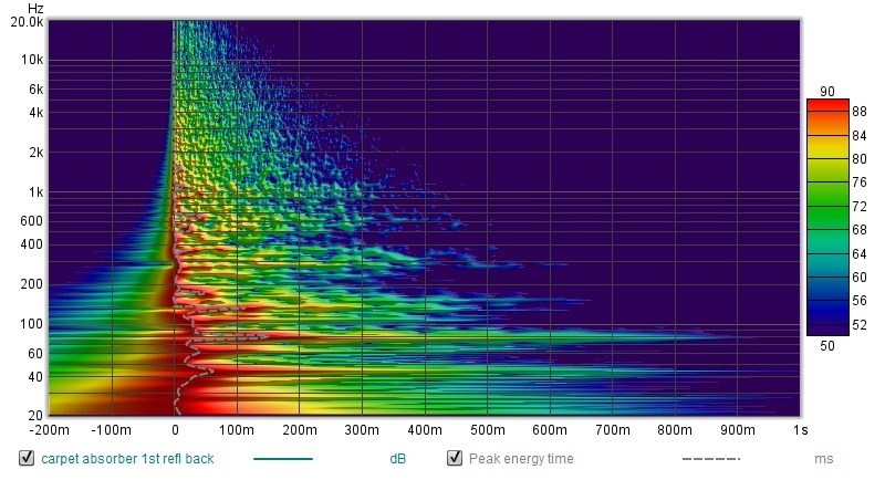

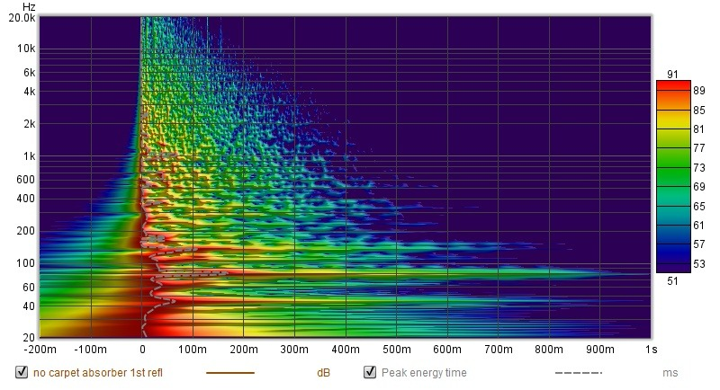

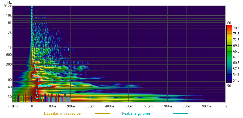

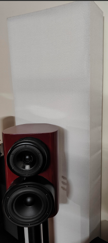

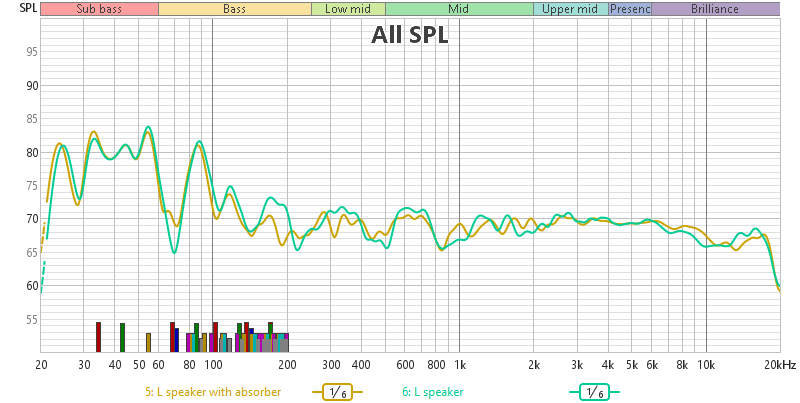

As an experiment, I pulled out the speakers as mentioned in previous posts and put that broadband absorption panel near the first reflection point of the L speaker
Here is how the response looks like with and without absorber
Effect of absorption on left wall & speaker placement changes
VituixCAD prediction
Now it has become a single higher Q dip compared to the dual lower Q dips without absorption
Impact on ETC
Spectrogram with & without absorber & placement change
With absorber, above 8kHz, there is loss of energy, below that there is ever so slightly more energy down to 600ish Hz.
The delayed energy pattern in the 200 to 600Hz region also seems to have changed..
