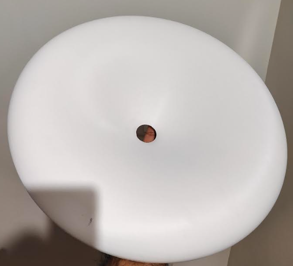

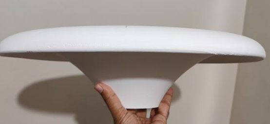

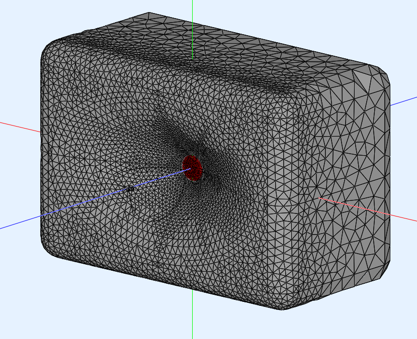

One is the ATH A460D wide radiating waveguide printed in a single piece (except the base)
Then came home a pair of these guys 😉 (the Purifi 6.5inch midranges)
https://tinyurl.com/3juw856f

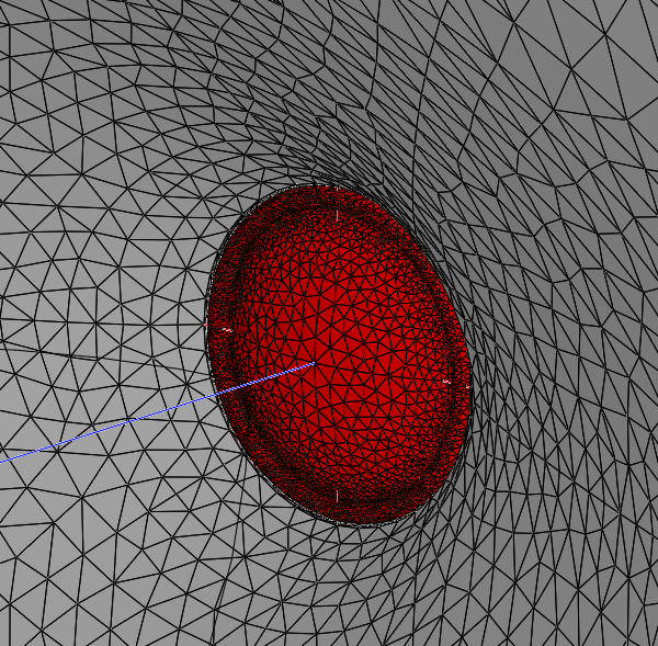

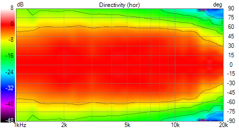

Then I cooked up a waveguide for the SB26CDC tweeter
A few more iterations are needed to see if they can be made anybetter, but this is how the hor polars look now

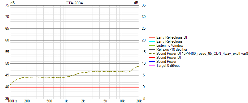

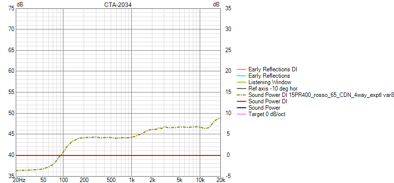

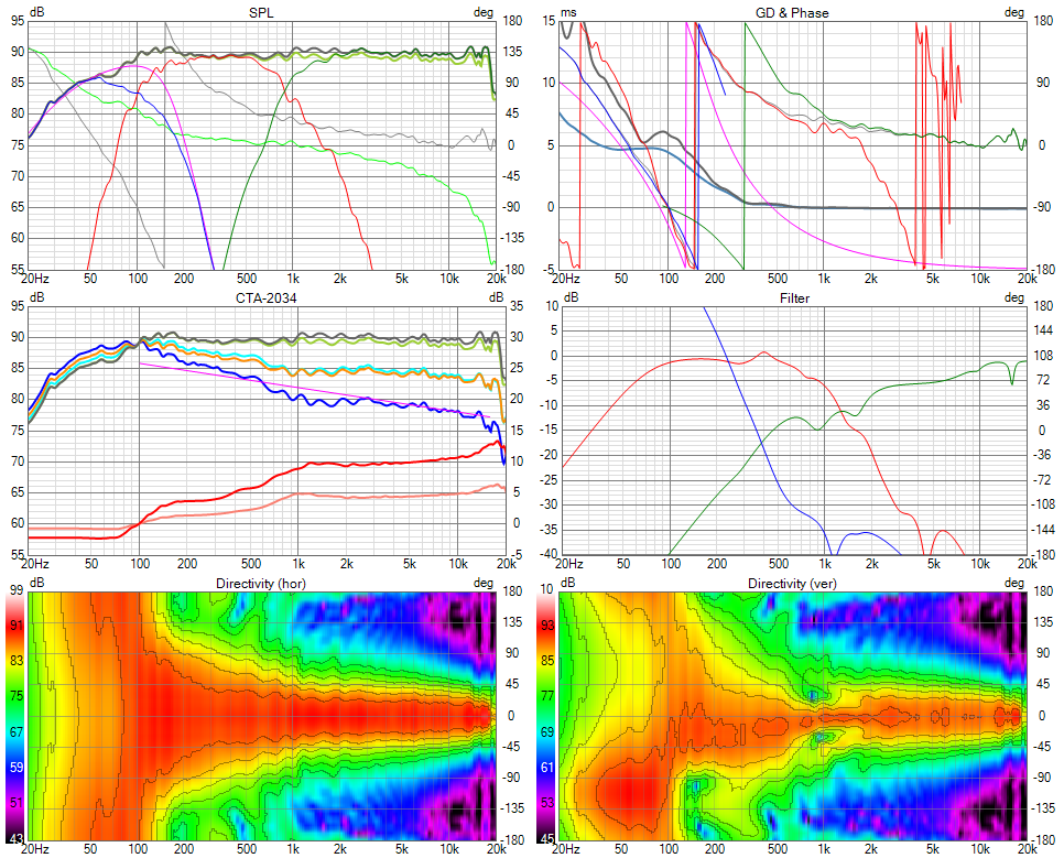

The overall 4 way system goal with the cardio dual 15inch cab + purifi mid + the above kind of tweeter in waveguide is a system roughly like this
and overall SPDI similar to or "better" than the dotted like in the below pic 🙂

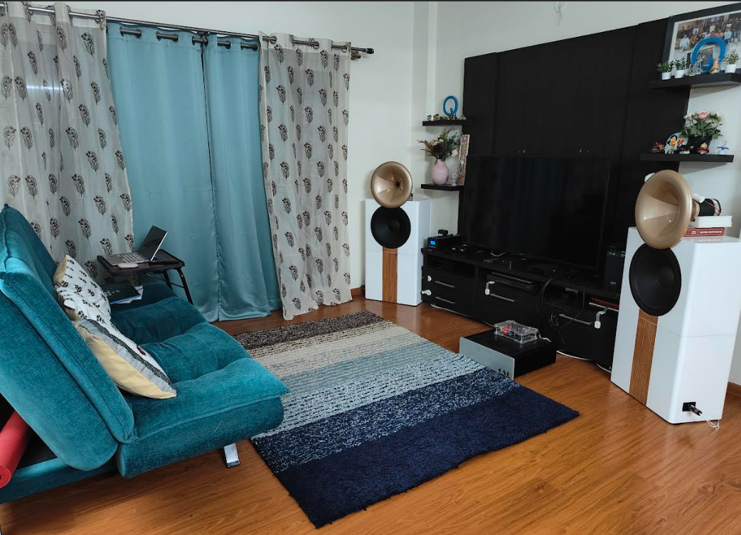

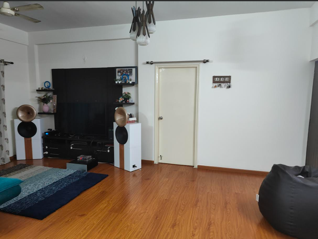

Some subjective impressions and plans going forward.. 🙂
I think it is already a little late in this thread to note down/summarize the subjective impressions I/my friends/family have had with few of the speakers and what my goals are going forward.
A few notes about my latest cardioid dual 15inch woofers + Exar 400 system first and then future plans. This one sounds really nice (to me).
1. It has a lot of same sound character that I associate with my desktop cardioid speakers (which was the main goal of this system, but then everything at larger scale and more dynamics handling capabilities). Clear vocals is what comes to mind first. Also a tiny bit less of the very high frequencies? Excess group delay + room impact might really matter at low frequencies. I have heard a few songs (like hotel California remastered version) where certain minute changes in bassline and drum notes are "blurred" on my system compared to my headphones. Other than that I like everything else about the bass and mids on this system. There is a punch and the subwoofer sometimes really growls when such a thing is there is the song (not the bottoming out kind and bass reflex port getting overloadrd kind of sound). It is really fun to listen to that.. 🙂
2. As with all horn-based systems I have built, there is a bit of "sit up and take notice" kind of sound. This is one the main impressions I have had with bigger horn based systems so far. Probably the direct sound is so clear and unadulterated that the brain really becomes alert and notices everything that is going on with music. It is a bit intense listening to music. To be honest, I kind of like it but not everyone does.
I had my wife and 2 friends listen and forced them to say their comments. My wife doesn't like horn based systems much. But she likes my cardioid desktop speakers with Sical coax+8inch sub. She says it sounds more relaxed and the horn based systems sound more hyper. Again that sit up and take notice sound. She says it makes her so alert she cant focus on other things in parallel. Like casual music listening while doing other things is not easy. Maybe it is an evolutionary aspect of our brain. When a bit too much direct sound is available, we really seem to focus in that. Maybe this is why studio monitor applications are really good with relatively high controlled directivity.
A friend of mine really liked the system. He went gaga about the overall clarity. Another friend commented that it is nice and all but a bit too intense that "it is getting in his ears" (he is more used to sound bars and bluetooth speakers). So, all in all, I think that horn based systems (that I have had) may be having a bit too much directivity contributing to these impressions. It definitely lets one peer into the soul of the recording but maybe that is not everyone wants/likes. This is one of main motivations in exploring controlled but wider directivity systems in future. The goal of testing the wider radiating A460D horn and the eventual goal of designing the purifi mid + shallow(er) waveguide is to see if it is really the directivity differences, the driver differences, or something else. Hence the reason of getting the purifi mid. To get the best drivers out there so that "bad driver" based impressions can be eliminated.
I am also very motivated by Kimmosto's comments about lower directivity and relaxed sound over at ASR forum. I really think he has nailed down this aspect. It is laughable to see some other people commenting on that thread with no experience building speakers, tuning them, listening to them and then correlating the objective with the subjective asking him to send some of his speakers to Amir to test..
3. I probably wont explore more in the MEH direction. With all my experiences so far, I feel like it will give me more of the same kind of sound that I may like but not others in the family/friends (except may be with some benefits of the point source?).
4. After listening to this system and comparing with the dual Satori WO24P woofers based bass mid module (crossed over around 1kHz), I have only one thing to say to the Satori system.. "Calm down"... 😀
I feel that It really tries grab one by th collar and tries to scream into the ears.. It definitely goes deep in the bass but the mids are not so relaxed. I dont know why yet (even though I had killed the breakup and flattened the response). Maybe something to do with the driver membrane composition and the associated effects in decay of sound from it or something.. This is only obvious on comparing this bass-mid module with my current bass mid module.. With the dual 15inch module, I like a little bit more "life" in the sound but quite a bit less than the Satoris.. This is the main reason I spent a fortune importing the Purifis. To get the best driver out there and cross it over between (approx 200Hz and 2.5kHz) in relatively low but controlled directivity mode.
I feel like the past 3 years at this has really been a 3 way design "study" than a 3 way speaker making fun attempt.. I have learnt so much about my preferences and others, a little bit about how to make good speakers and most importantly a little bit about how to correlate some objective aspects with mine and my family/friends preferences.

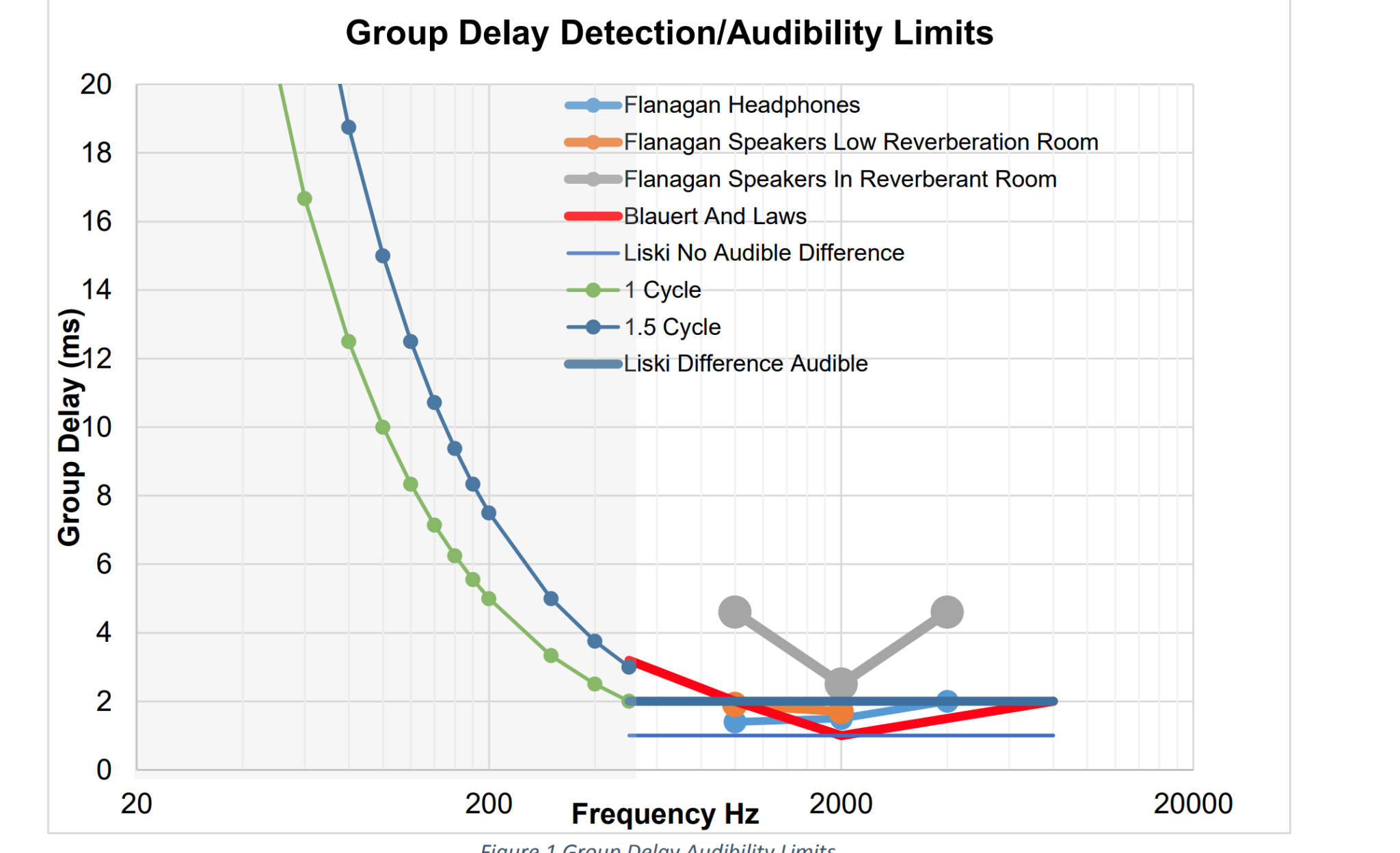

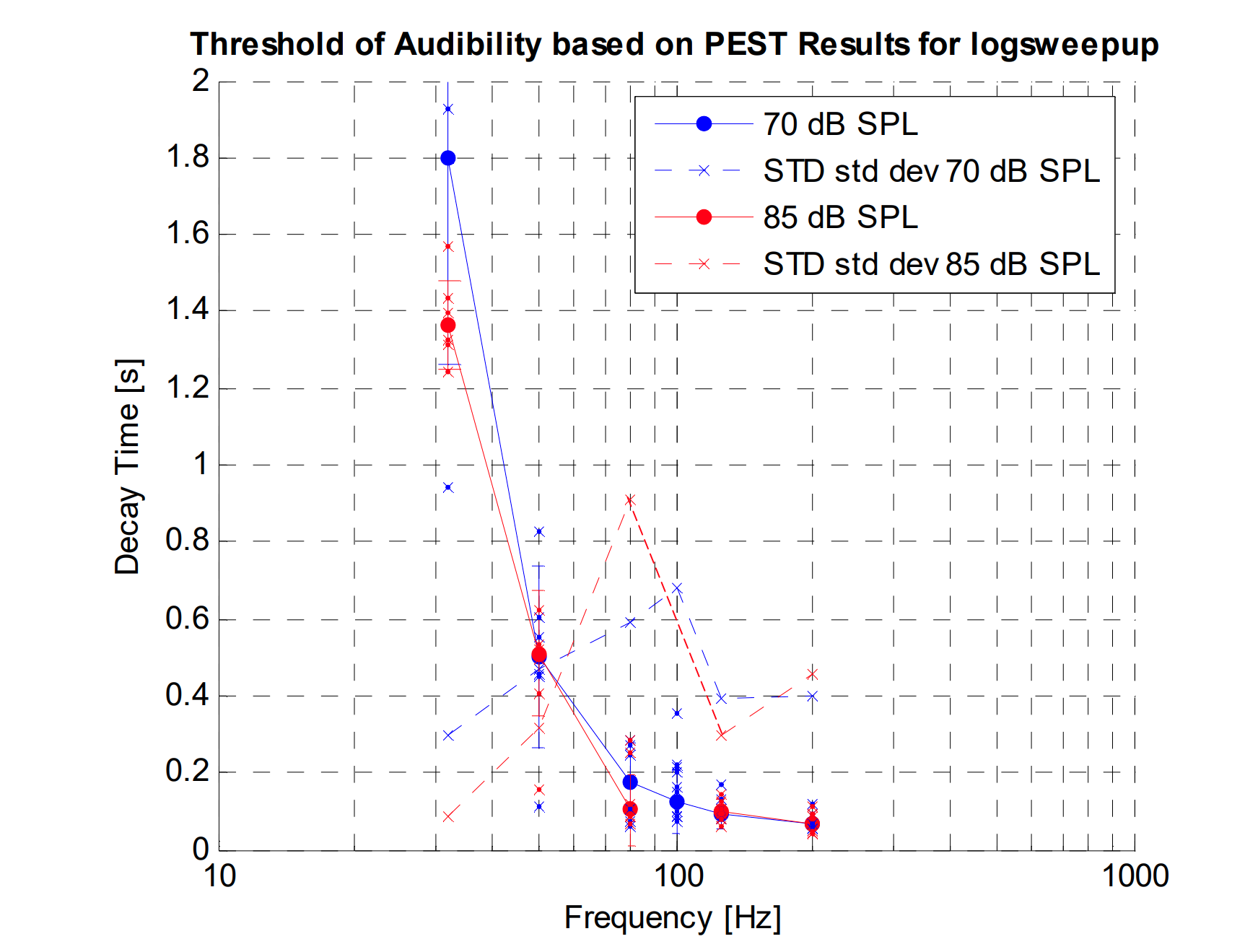

There is group delay and then there is decay time. Group delay seems to be pretty forgiving. It seems like if the decay is off even 1/4 of a cycle of time your ear will hear it.Excess group delay + room impact might really matter at low frequencies

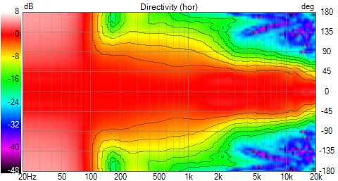

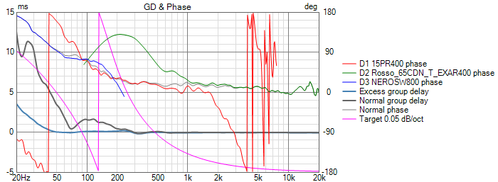

So far I have just been focusing on the excess group delay (not the normal group delay) and impulse response/ETC as timing related parameters. Again motivated by Kimmosto's comments about the same. I honestly dont know what exactly caused what I heard in the bass but there really is a small, clearly hearable difference. I will try to find out..
This is how the excess group delay looks like on my current system. The blue line in the GD&Phase graph is above 4.4ms at 100Hz
With some FIR filtering that affects only the phase, I can get it down to like below
I will implement this filter, listen and then get back with clearer impressions about whether it is indeed the excess group delay that causes what I can hear.. 🙂

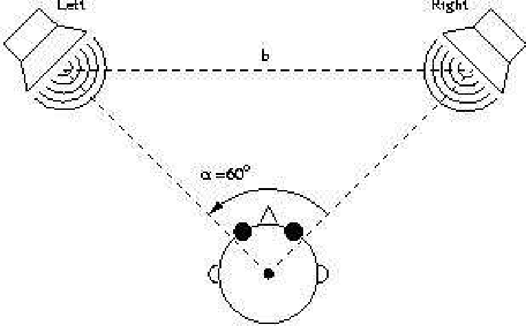

https://www.researchgate.net/figure...loudspeakers-form-an-equilateral_fig5_2878420
Listening stereo triangle concept is practical, but with addition of room effect. Mastering studios are heavily damped to help mixing and many hifists aim to virtually sit there like the enineer/producer. Very high DI speakers make that possible in a more reverberant "normal" room. This is however a very restricted approach, because then off-spot sound will dramatically suffer from various interferences, causing spl and phase deviations, strange imaging and tonal colorations.
If we accept to loose a bit of stereo spatial image accuracy, we can use low and smooth directivity speakers and enjoy pleasant tonal balance in wider area of the room. And if we simply just pull the spot chair closer to speakers, stereo imaging gets more sharp because direct sound domination increases.
I have noticed that among my hifi friends I am in the other league, not so interested in precise imaging that direct sound domination gives. When friends visit me they "must" pull the chair 1 meter closer to speakers! My favourite spot has longer distance to a speaker than is between them, but (dipole) speakers are along the longest wall so sidewall reflections are attenuated and have long latency, imaging is still very good for my ears.

The room looks like below. The middle of that sofa is usually where I sit.
Behind the sofa is one of the walls that separates the kitchen from this room.
For a bit more context. This is how the room looks from a bit away
That nearest side wall to the right is about 3m away. On the left side is a glass sliding door covered with 2 layers of curtains.
Still, I don't have many problems with image shifting significantly to one side (which I had with my Satori woofers + SB15CAC mid + tweeter system in another house)

I nice and easy way to evaluate stereo imaging is to play mono music or speech (mono signal from both speakers)! The image should hold together and a little shift of listener position should not destruct it, just make a small shift. Common problems are s's coming from either side and low notes or low male speech filling the room diffusely.
