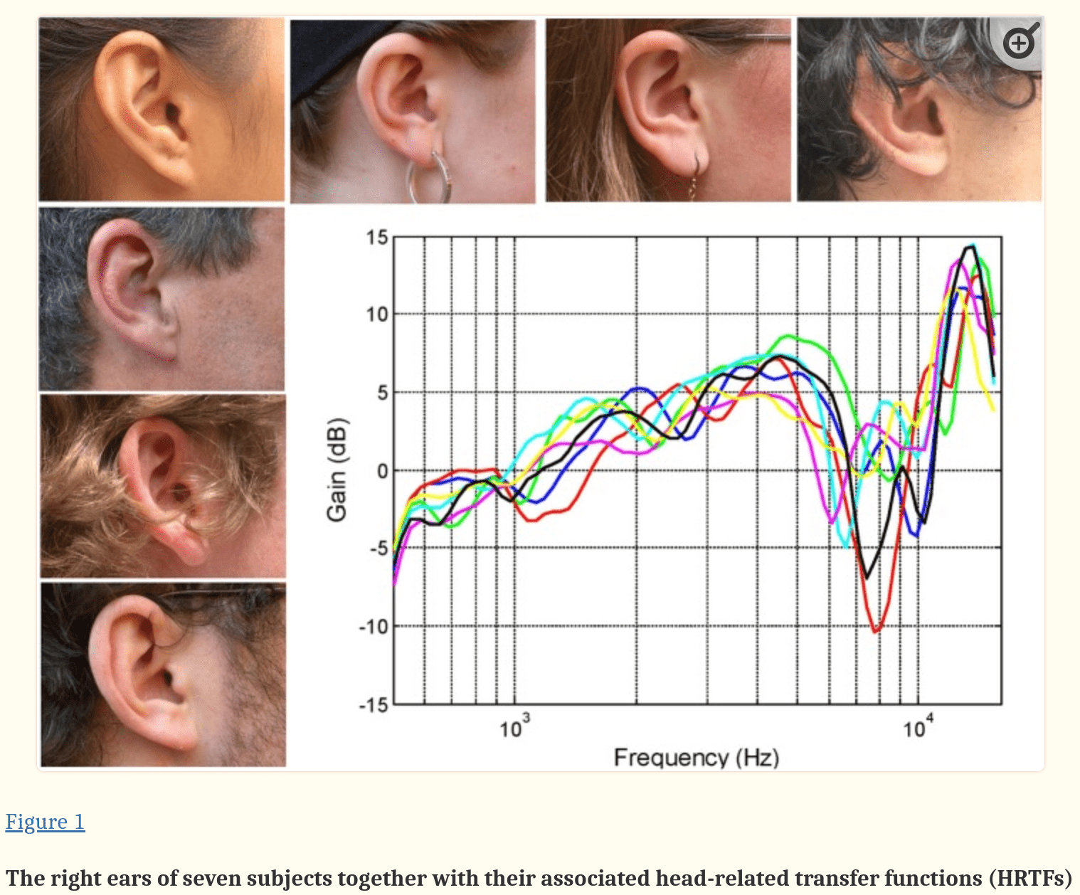

I am not saying it is not important but 500hz-5khz is where I understand the mind keeps time? The head shadow is part of 1-2khz. JBL tends to put XO's here. (I use a head shadow image as my avatar). Forward perception will be very different here person to person.
The inner ear is what boosts 3-4khz.
https://www.ncbi.nlm.nih.gov/pmc/articles/PMC4123622/
Just the ear shape shows a 8db difference between people.
https://www.researchgate.net/publication/352265058_Audibility_of_Group-Delay_Equalization

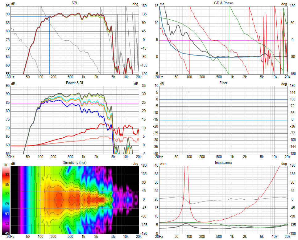

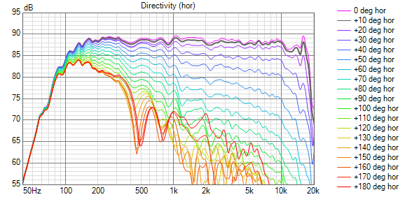

Boxes are getting ready for the first system configuration.
I put together a box for the 15PR400 and installed a driver in it (box has 50mm thick damping material inside at the back of the driver).

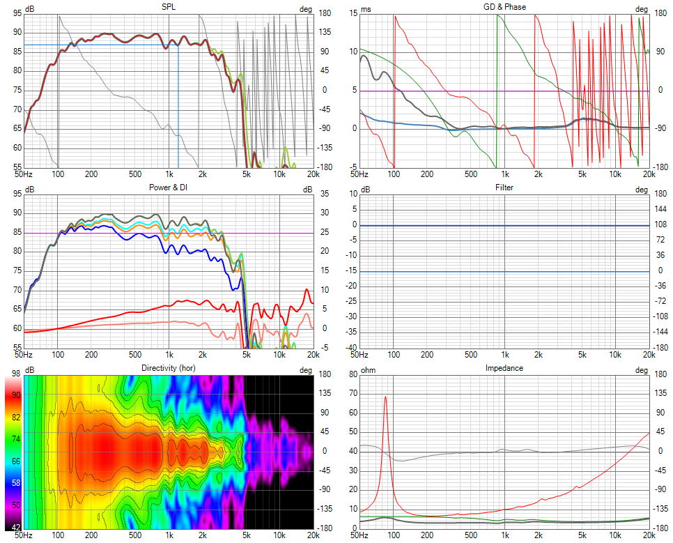

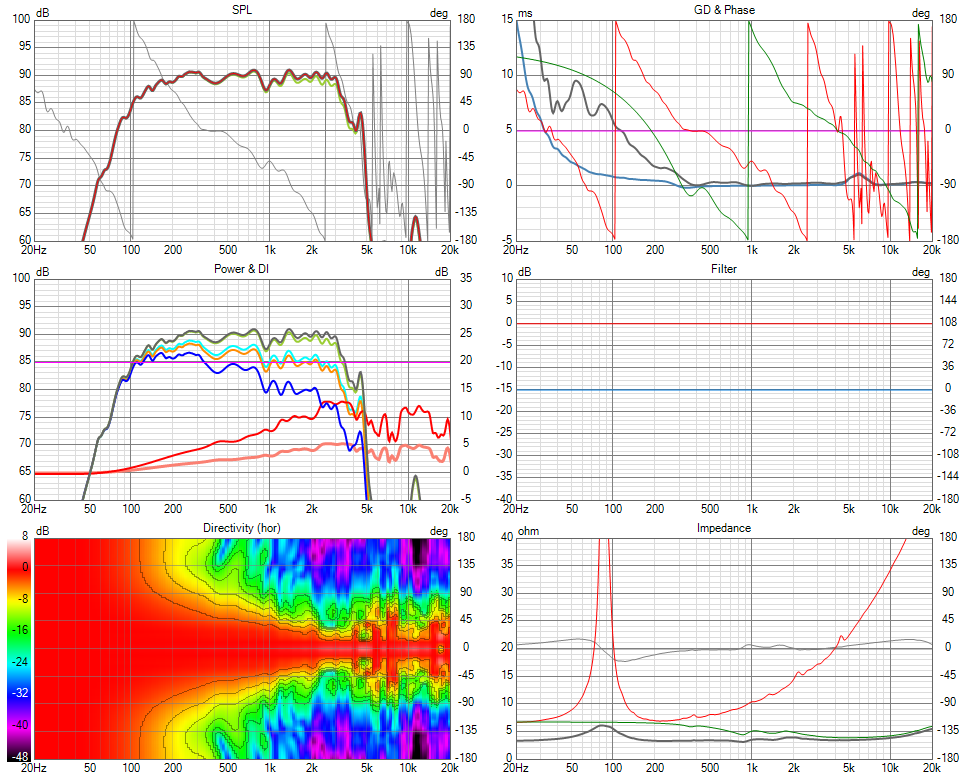

I also took some measurements of the Rosso65CDN-T and the 15PR400 in box
Measurements of 15PR400 in box
Measurements of SB audience Rosso65CDN-T on EXAR 400

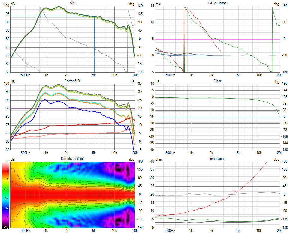

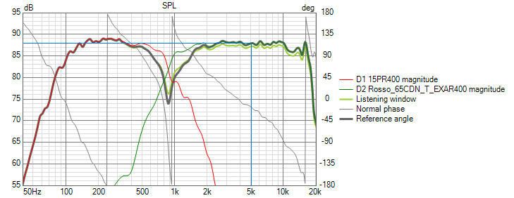

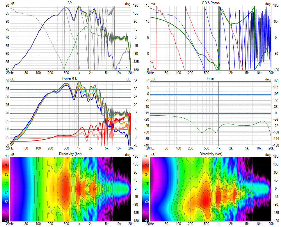

Prototype crossover and responses
Crossover around 850Hz

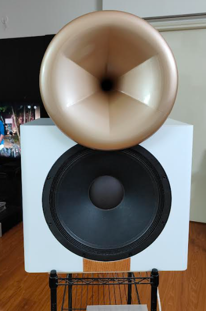

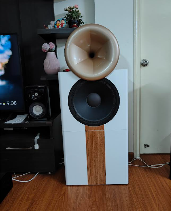

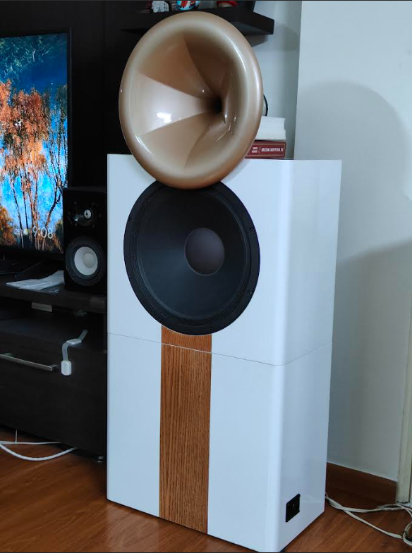

@CoolJazz: I haven't done any study yet about the horn placement on top of the cabinet. I just put the horn on top of the woofer cabinet and the C-C distance was about 35cm in above set up. The estimated crossover was around 900Hz. So I thought it (c-c spacing) will be close to 1x wavelength at crossover. This 1 to 1.4x wavelength at crossover can turn out to be a good compromise (with certain crossover topologies) and as long as I am not able to bring the c-c less than 0.3-0.5x wavelength at crossover..
However, in this case, my crossover design iteration has just started and i have to explore and check if better responses can be obtained
Reactions: CoolJazz and Juhazi

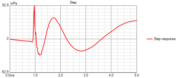

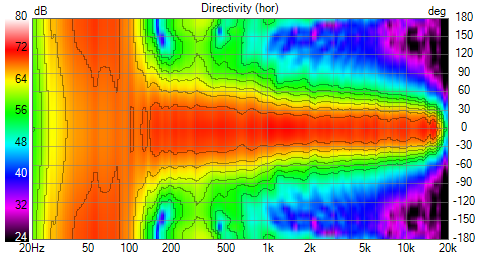

I guess that the wide-mouth horn's "acoustic center" is vaque and practically impossible to simulate with the woofer. Both verticall and depth dimension.... 900Hz is rather forgiving xo too, eexperiments with measurements will tell more. I was surprised to see such good vertical dispersion in post #2033.

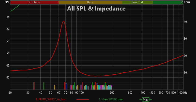

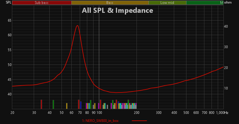

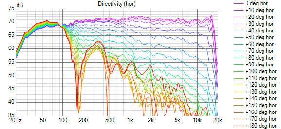

Measurements of the subwoofer system 🙂

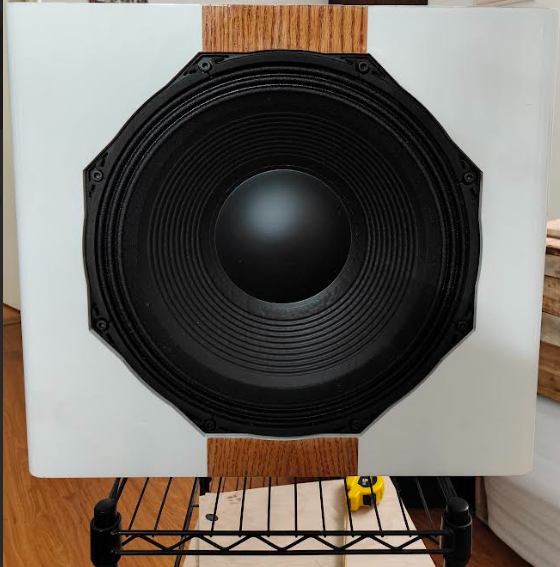

This was hard.. really really hard.. The subwoofer in box is about 40kgs in weight.. So moving it around is a nightmare.. 😲
But I did that somehow..

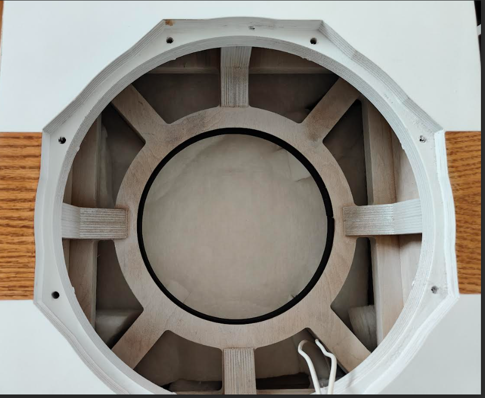

Subwoofer system assembly
The innards
Inside the box is again that 50mm thick damping material behind the driver. I didn't use much since at the frequencies of concern, this material does next to nothing.. The hope was that there will be some effect like increase in apparent volume
I used this material inside: https://www.auralexchange.com/produ...b9b3CEg4gC2uoGUX6IHsSZNDYFkwvxxxw4GdhZFbWKFXJ
Damping material effectiveness
The black thing lining the ring above is foam gasket material.. It holds the NERO SW800 driver magnet and keeps it there snugly.. 🙂
The assembled box looks like this (kept on top of the rotating stand for measurements. Dont ask me how I did that🤐)
And the measurements..

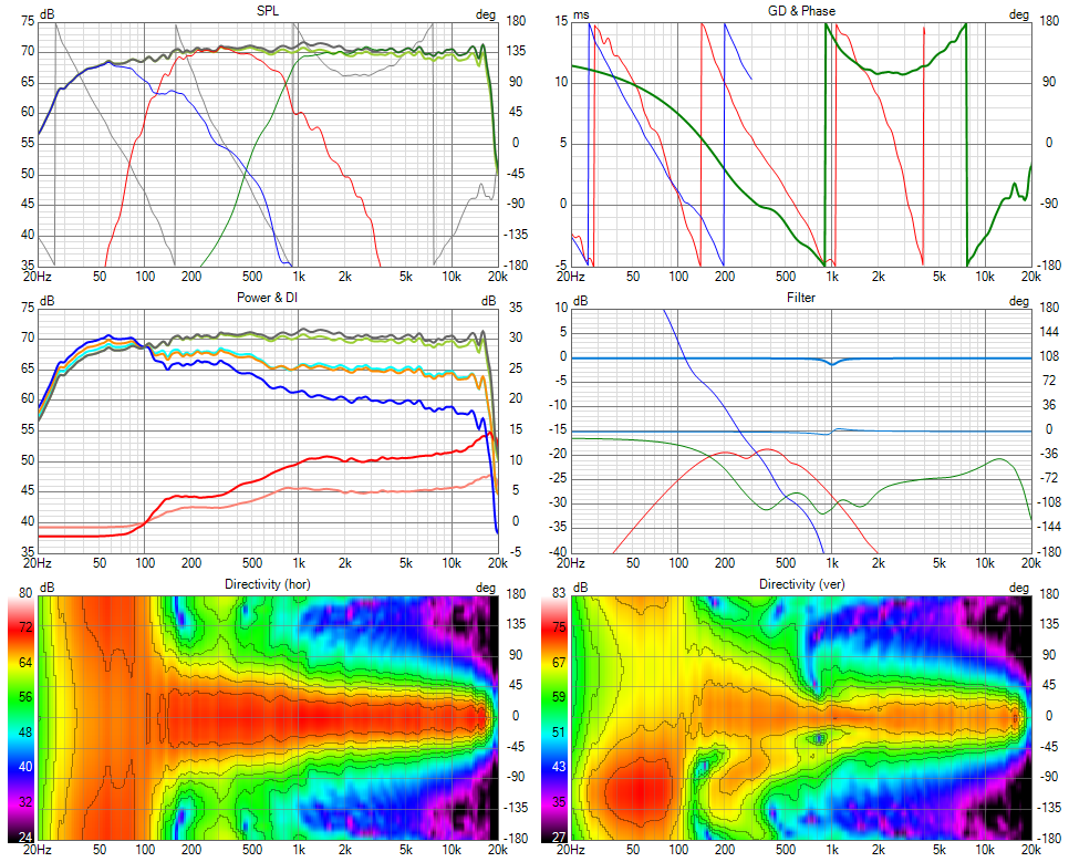

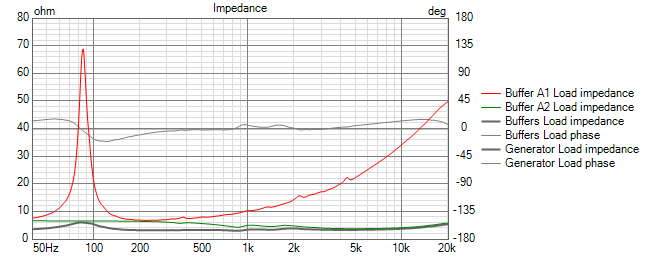

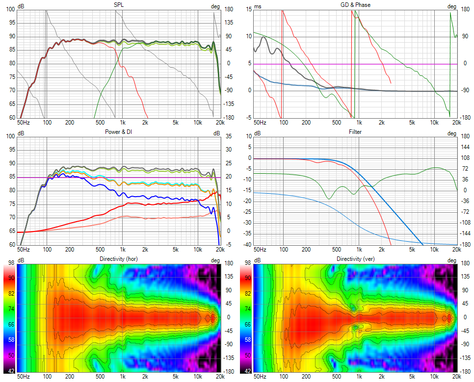

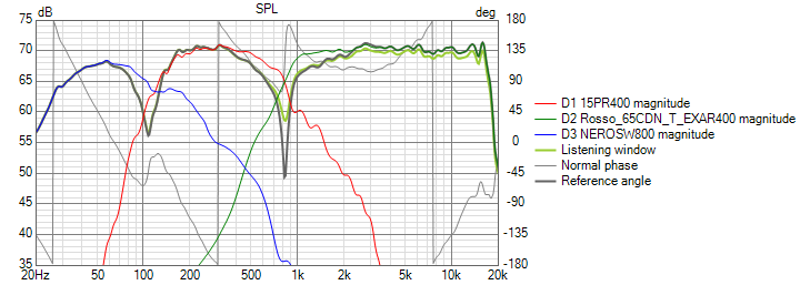

System integration and crossover (ignore the gain settings on each driver branch for now..)
CD-horn has a 15uF capacitor in series with it (all measurements of the horn include this also)
Crossover points (108Hz & 820 Hz)

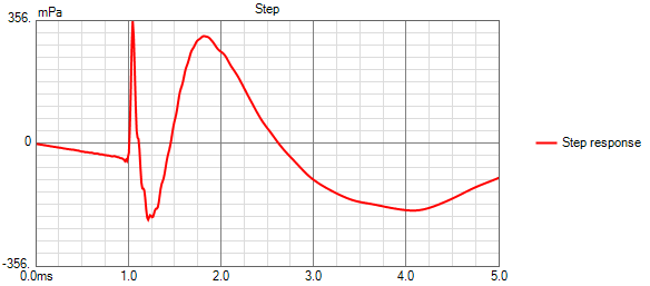

All these for now.. more work needs to be done including potential FIR filter based phase linearization above 200Hz or so and inroom response based subwoofer EQ.. 🙂
But the highlight is this (for now):
