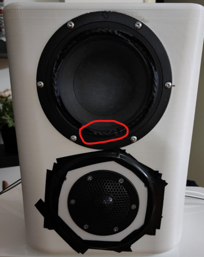

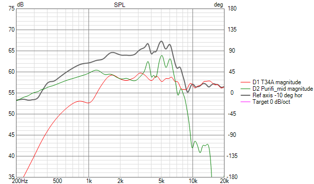

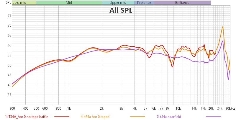

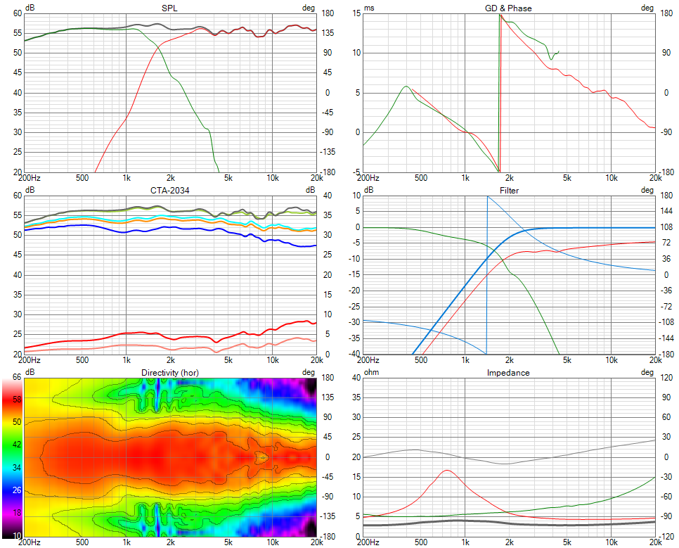

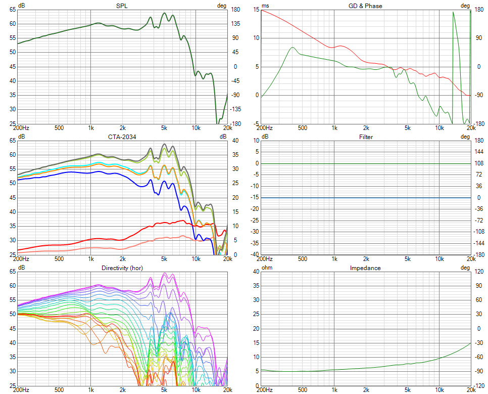

The Bliesma T34A seems to be a rowdy tweeter. Its wants to affect everything near it with its wide radiation. 😱
The 3-4mm non-flush mounted adaptor caused the on axis response to be really bad looking to the eyes.
I had to cover the whole region with some tape to lessen its effect.
Here is a comparison of the raw measurements nearfield of the T34, and with and without tape treatment on the baffle
The whole speaker now looks like it had been to the hospital after a fight.. 😀

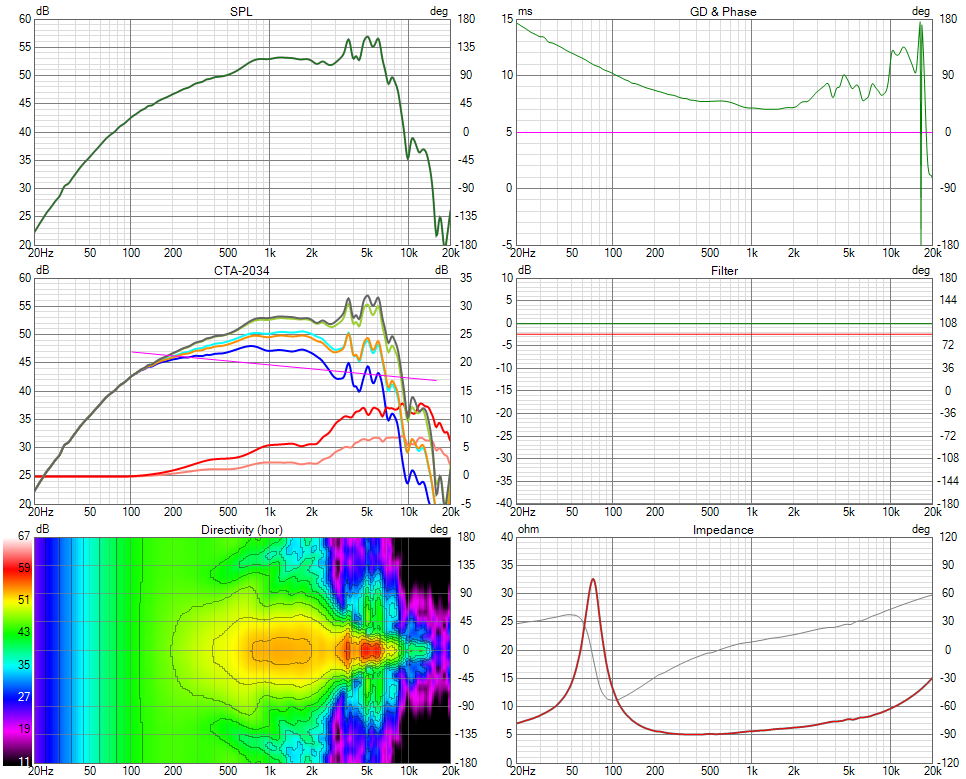

Purifi mid driver responses

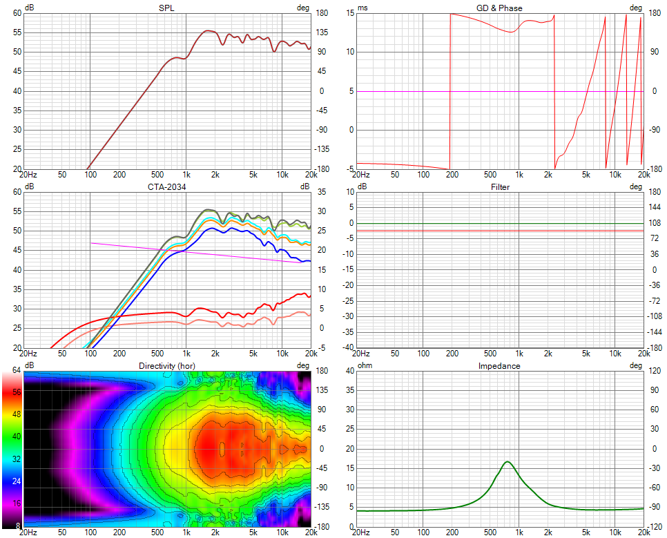

T34A responses
Prototype crossover based on 10 degrees off axis as reference
I will print another adaptor and redo measurements again..
This time I also forgot to take mid driver measurements on the drivers axis. Instead I took all measurements on tweeter axis..

I have noticed a measurable effect from geometric disturbances near the tweeter down to about about 1/10 wavelength. 3.5 mm is a wavelength of 98k, so 1/10 wavelength is 9.8k. I very much doubt it will be noticeable or even measurable.
The reason why the step is quite damaging (at least to the eyes) even though it is only a small dimension vertically is due to its distance from the source and the fact that it exists at the same distance in any direction. If the step was the other way around, the baffle was higher than the insert it would have been worse again.
I think if I get rid of the reflections from those protruding edges around the tweeter, this would make a nice speaker (above 200Hz).. 🙂
Don't know what will be the effect of that raised surround ridge of the Purifi right just above the tweeter edge..
Maybe its effects might show up once I get rid of the other issue..

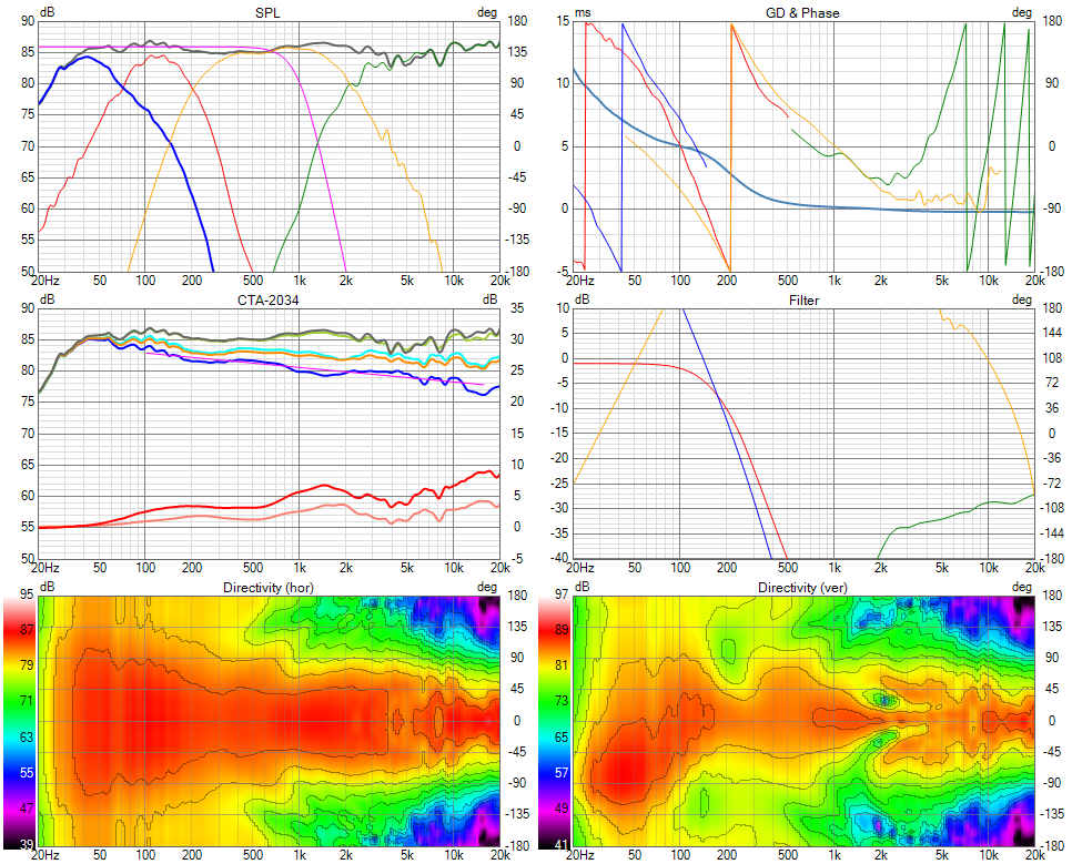

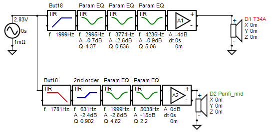

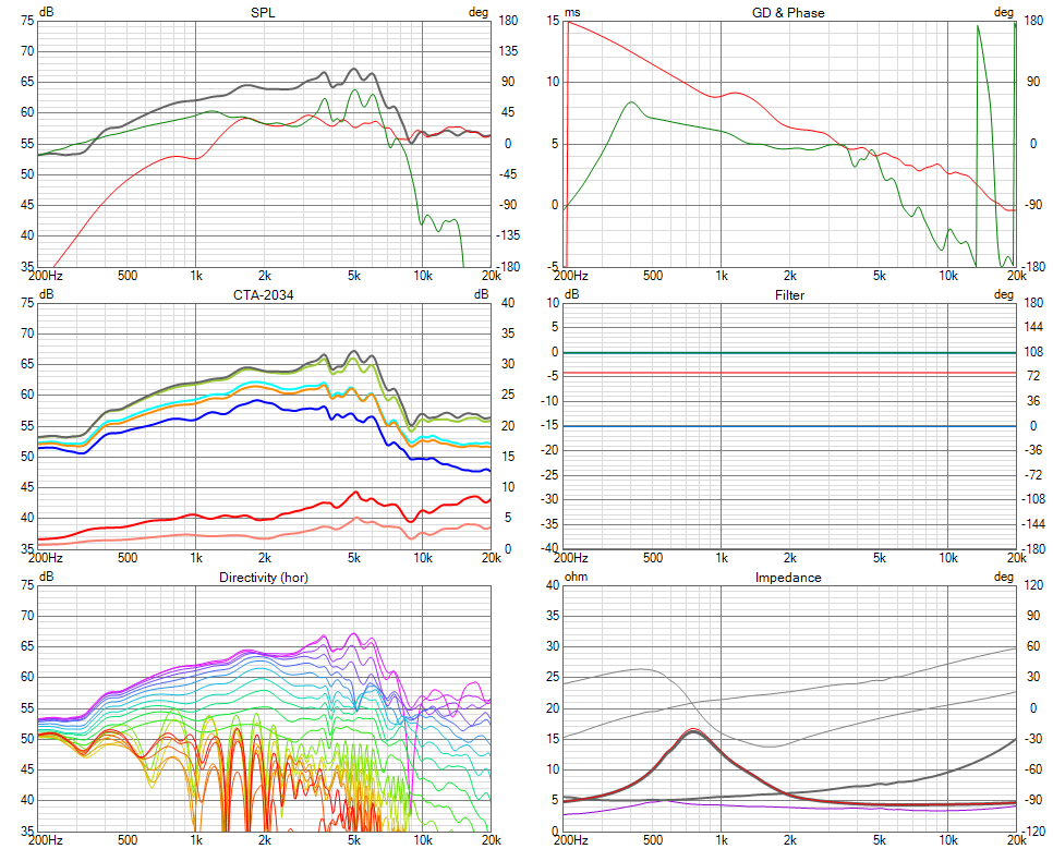

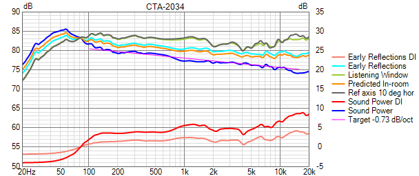

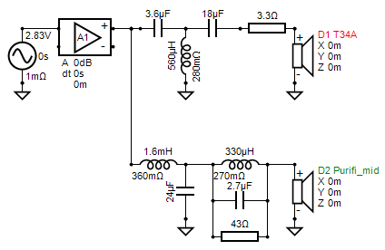

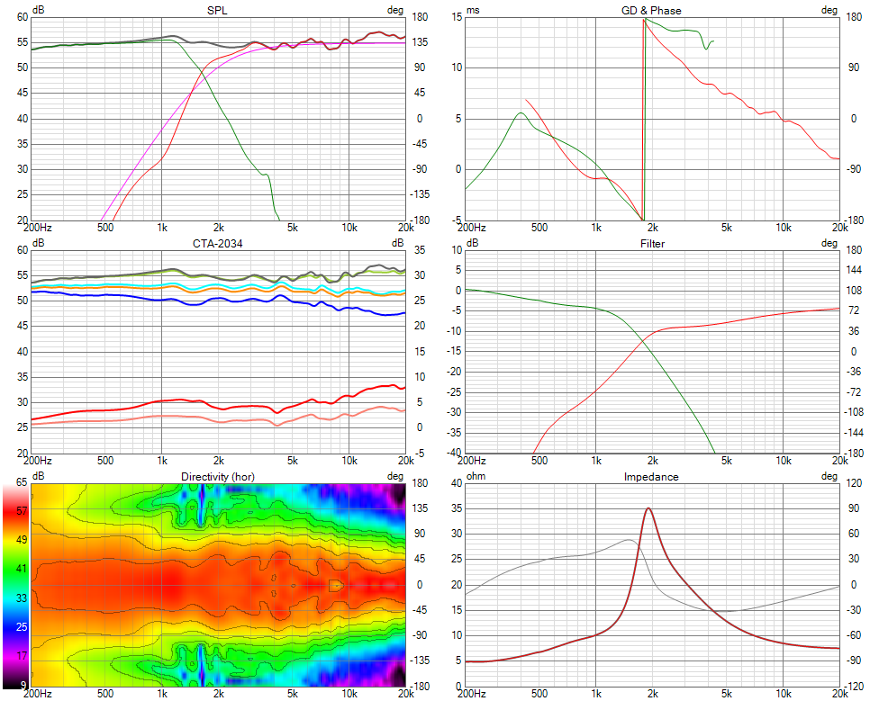

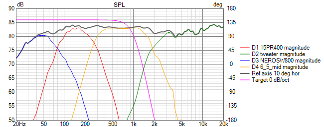

Here is a simple passive crossover
Full range response
Reactions: ciobi69

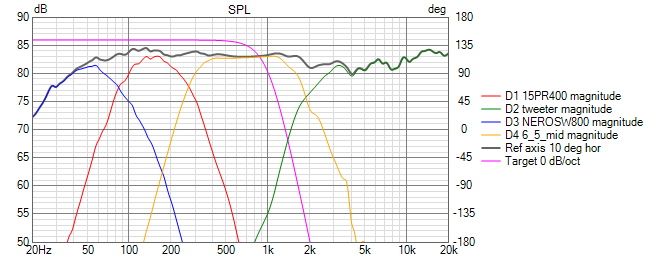

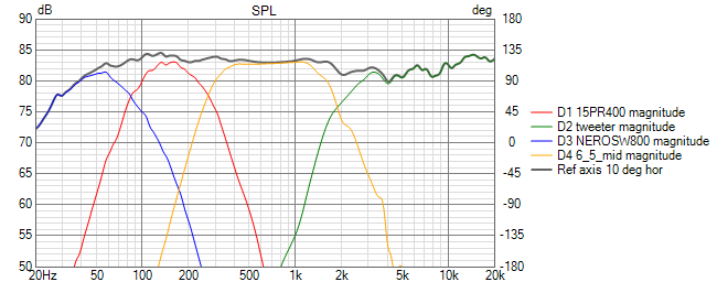

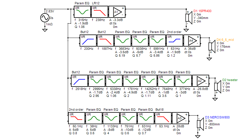

The full 4-way system
I still think this whole system has some potential (even without the waveguide on tweeter) if I can get rid of that chewed-up response in the highs due to non-flush mounting created reflections 🙂

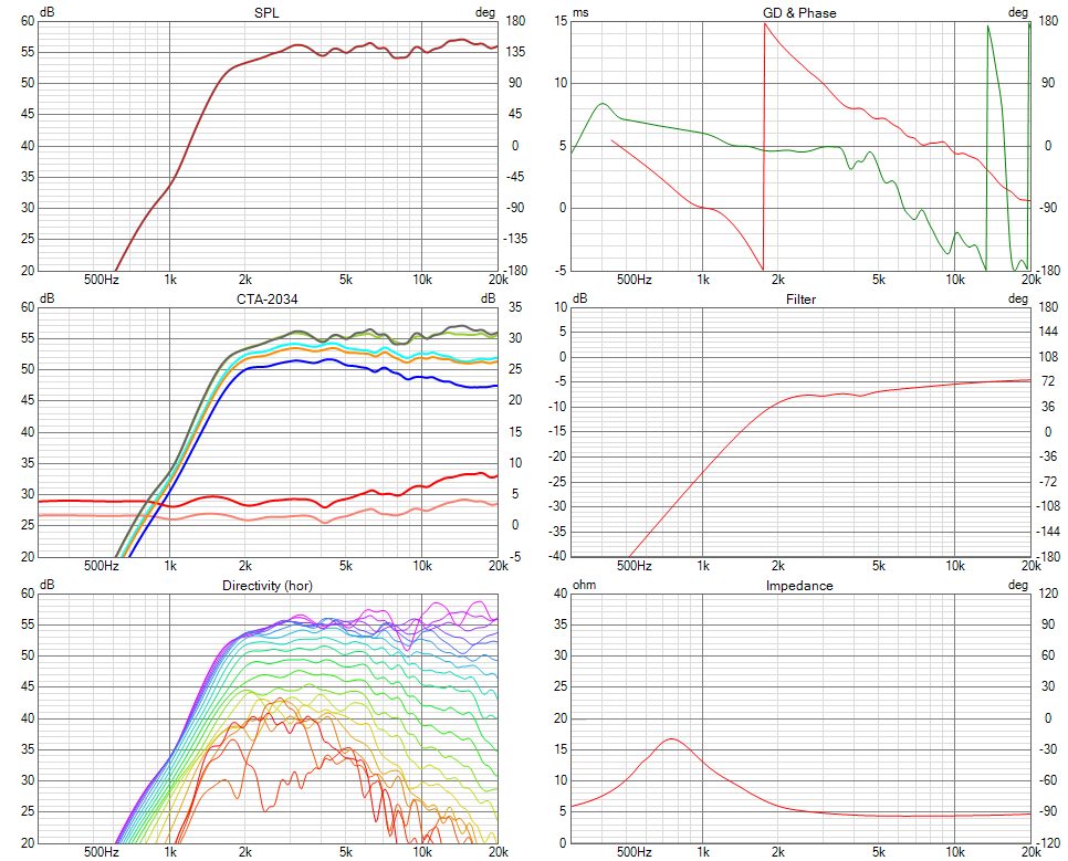

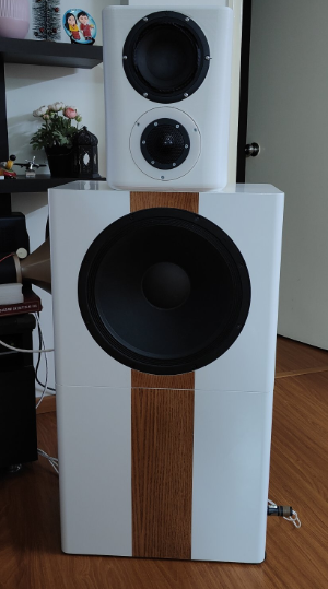

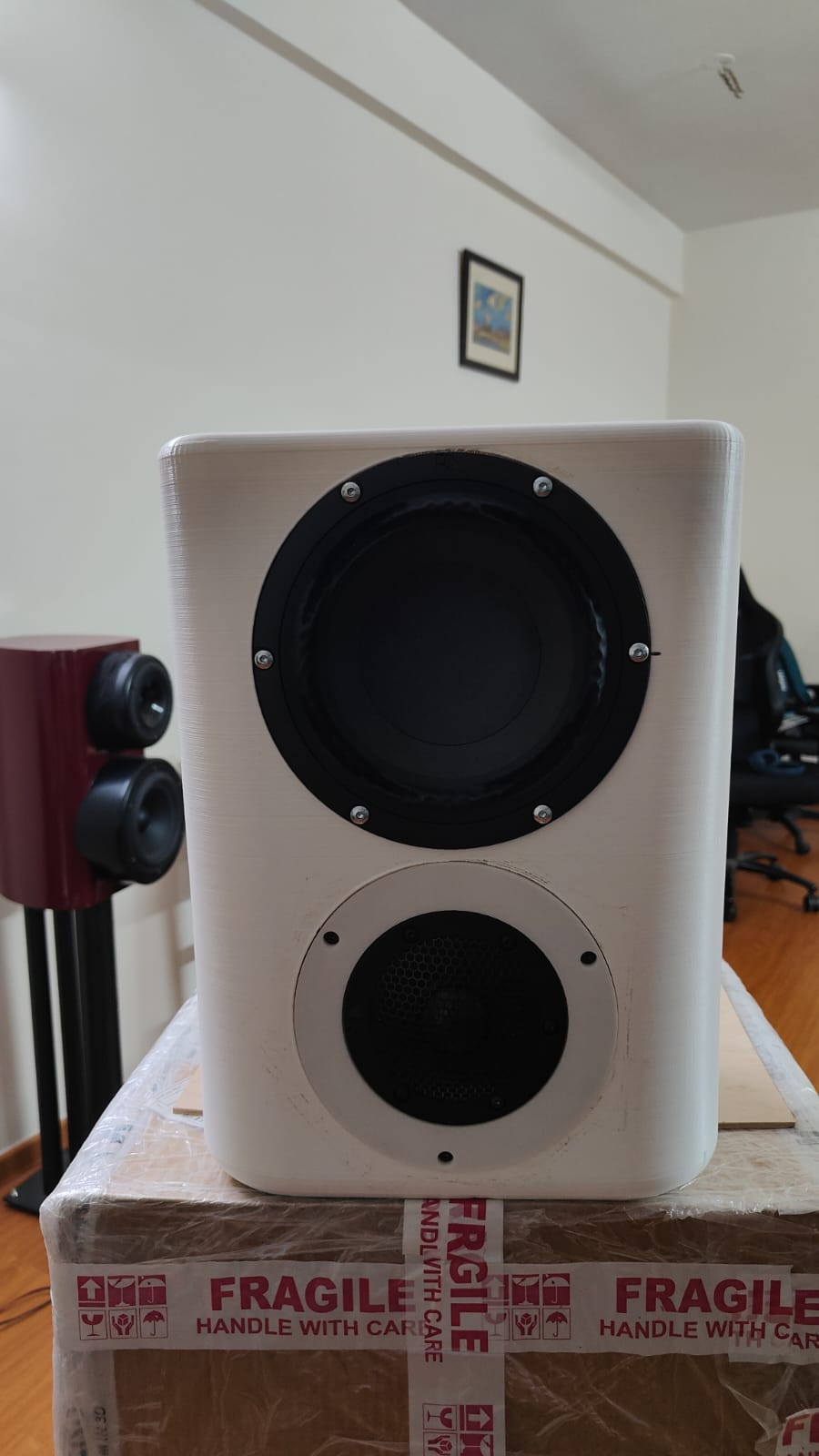

I printed a new adaptor for tweeter such that the tweeter is now flush mounted and remeasured everything.. 🙂
New tweeter+mid cab

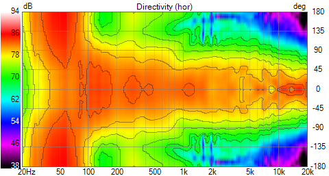

Tweeter polars
Purifi Mid polars

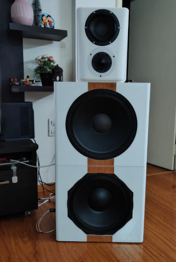

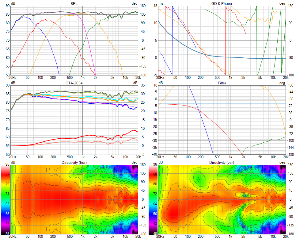

And then integrated everything to make a 4way speaker.. 🙂
Like this

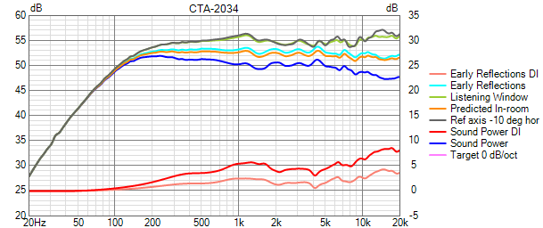

Crossover and overall speaker polars

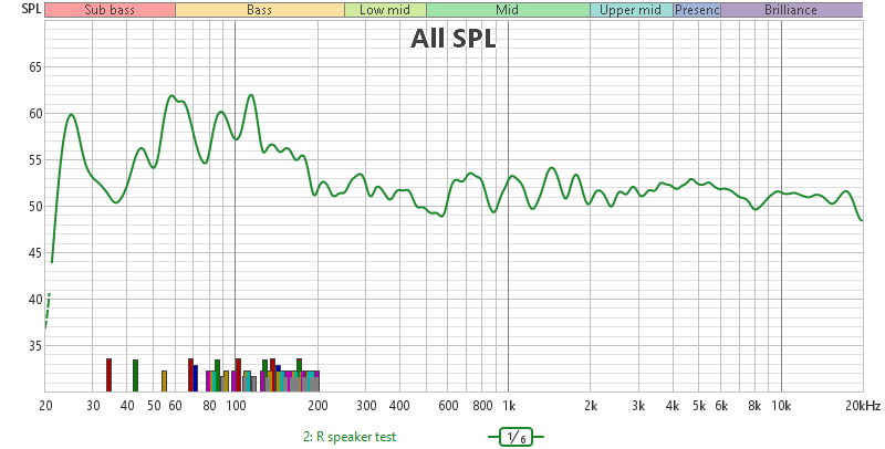

MLP measurements
Phase matching between tweeter and woofer is not as good as I would like.. but I will refine it later
Right now I am just listening to the mono speaker before I print the 2nd cab..
So far all I can say is that it sounds nice.. 🙂

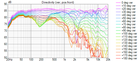

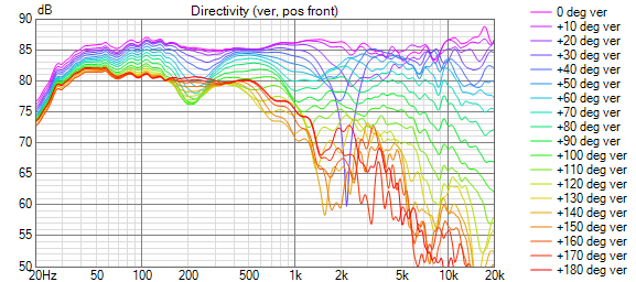

I've been focused on single point solutions for a long time. When I see vertical polar maps like in post#2211, the first one you see scrolling backwards, I feel that the compromises involved in single point solutions are well justified. But that is just based on looks at graphs. Your speaker is likely perfectly OK listening on vertical axis but what is it like when you go off axis vertically? Can you show a vertical line chart?

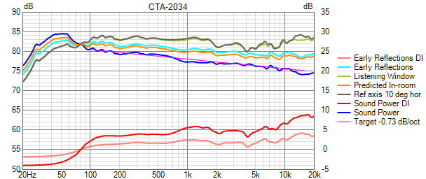

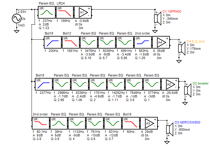

The crossover shown in the above post had a major issue when I sat down and listened to a few songs. 🙂
The tonality was nice overall but I could sometimes hear part of the vocals shifting from the 15PR400 to the Purifi driver from 2.5m away at MLP.
Once I heard it, I just couldn't stand it.. It was so distracting for me.. I was trying all I could to keep the excess group delay as much down as possible earlier
So I increased the crossover order from second order to 4th order 4th order on the 15PR400 and let the Purifi play lower down.. 🙂
Current crossover
Anyway, now the whole mono speaker sounds phenomenal 🙂
Vocals come from the right height. I seem to hear much more things/minute details in songs that I might not have earlier heard/paid attention to..
I am not concerned about the excess group delay rise yet since I have not heard anything suggesting an issue in a variety of tracks till now..
My complaints from the previous speaker about attention-capturing behaviour at certain ranges are gone now.. 🙂
It is all relaxed sounding and I am able to focus on music as a whole..
I tried standing and listening, walking away, walkaing towards, lying down etc from 2.5m away as reference point.. There is no significant tonality shift I could notice even while actively trying to hear that.. 🙂
I am happy now.. I can see myself staying with this speaker for a while... 😀
