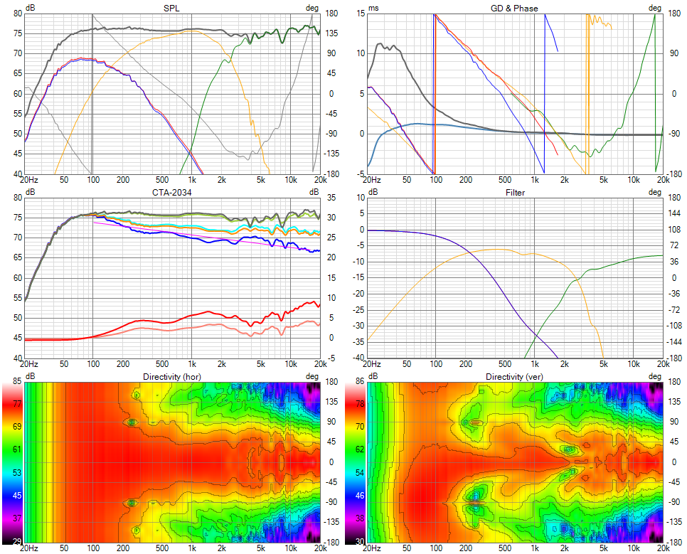

The level variations, the broad dip 200-500 and 2 - 6 khz seem to match the blauerts bander. At minimum reducing the broad bump in between should already give a audible difference.
And regarding gd, our hearing appear to be sensitive to gd variations in lower frequencies. So a flat gd will sound better. It is also one of my other observation with my linear system.

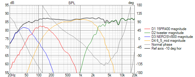

I actually had 2 different presets for that crossover. One with a global PEQ applied to reduce that 600Hz to 2kHz bump to a flat-ish response on the axis, and the other preset without this EQ applied. I tried comparing both presets on the same set of few songs.. But I couldn't clearly hear any differences between them in the selected set of tracks I played.. That is why I didn't bother notching that broad 1dB bump later...

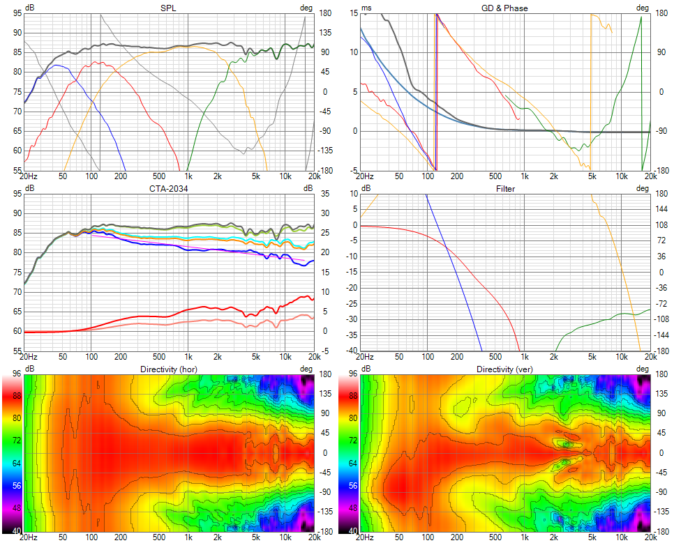

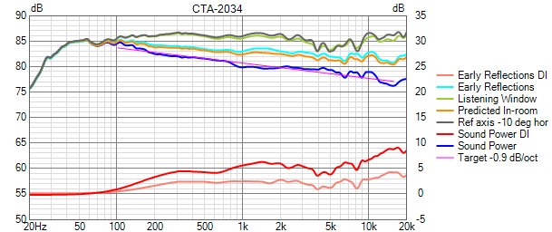

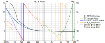

Anyway, the latest crossover that I am testing now is this one:

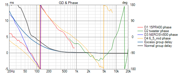

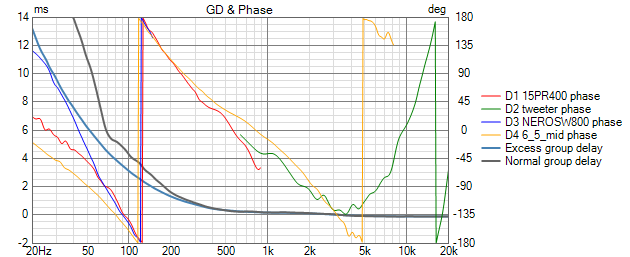

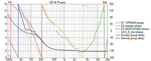

Excess group delay has reduced slightly now like shown below:
Earlier
Now
The bass impact is now noticeably/audibly better than earlier. I like it overall..
From an hour or so that I spent listening over a couple of days, I couldn't detect my earlier problem with LR2 (yet).
That is the "feeling of sound coming from different drivers". Now I also don't know if I had made some mistake earlier like inverting the polarity of the 15PR400 driver in the earlier set up which caused that impression.. Anyway, things are better now.. 🙂

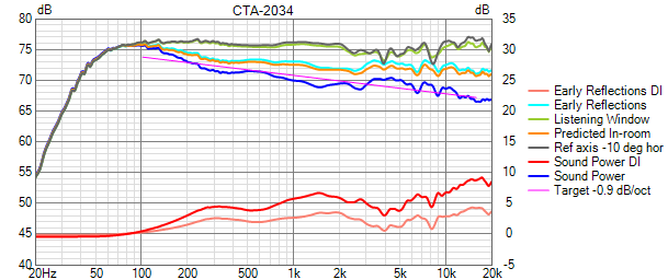

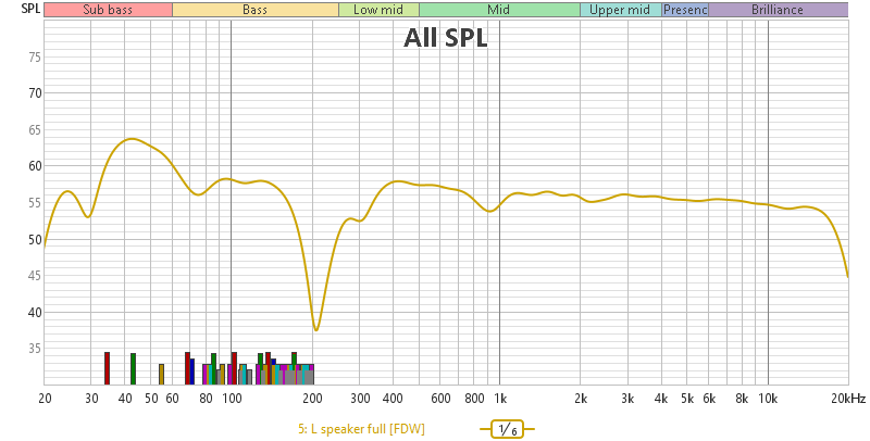

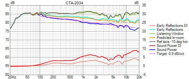

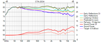

Also, here is the response of the system now from MLP with 4 cycle FDW
Compared to my earlier EXAR 400 based system, whose response is shown below, I like this one better "in a sense" as well 🙂

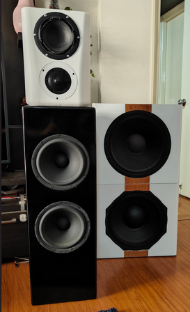

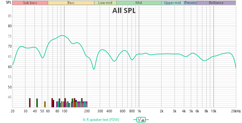

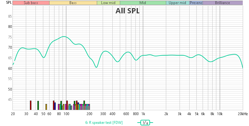

One more 3way speaker configuration with the PureBliss top and dual Satori WO24Ps connected in parallel 🙂

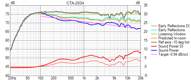

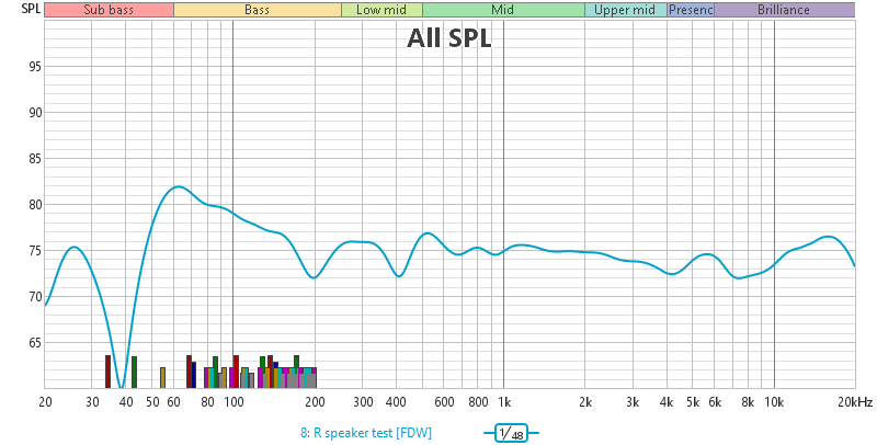

In-room response from close to MLP with 4cycle FDW
Listening impressions-wise, it sounds pretty much very close to the 4-way system with PureBliss top and dual 15inchers, which is very nice.. 🙂
The subjective bass quality might be ever so slightly "tighter" than the latest iteration of 4way top and everything being a tiny bit clearer (possibly due to minor adjustments in the 2way top crossover resulting in that power response bump about 2k as well).. But at this point, I may also be imagining things.. 😀
One thing I could do is to get a better amp on the woofers. Even though the amplifier connected to the woofers is a 150W x 4ohm class AB amp, I have not heard anything better than the tiny Zoudio board-based two-way in terms of bass impact. This would also help me understand whether it is the excess group delay of 3way/4way or the amp that has been making me go around in circles searching for that impact of the bass on the body as I had before.
I keep making videos to remind me of how the sound changes between the speakers..
This comparison helps me a lot to understand my own preferences and how each system sounded in the room in certain frequency ranges.. 🙂
Here is a comparison of the same song recorded from same position for the 2 speakers (It is not volume matched, i leave it to the listener)
Yes.. The tonal character is definitely a bit on the brighter side.
This is because in this speaker crossover I purposefully changed the voicing a little bit by allowing a bit of power response hump compared to the earlier 4way speaker, trying to flatten the on axis response and listening window responses and not doing anything to remove the resulting power response hump. 🙂
Current 3way
compared to earlier 4way shown below
The above changes can be undone, but at the moment, on most of the tracks I listen to, I like this 'brightness' a bit more than the earlier speaker.
Also noticeable is the slight change in bass character; it has changed from slightly 'softer in the 4way to a 'harder-hitting version on the 4way.
I feel that Satori woofers themselves have an overall 'brighter'/livelier sound in general compared to the woofers in the 4way system. Part of this can even be due to the directivity differences I guess. another part due to the sealed alignment differences, cabinet damping differences, woofer cone differences etc?
Depending upon the headphone used for playback, there might be an exaggerated sense of sibilance, which I can assure is not noticeable in real life, while playing the speakers. My Truthear crinnacle zero has this exaggerated sibilance. 🙂
