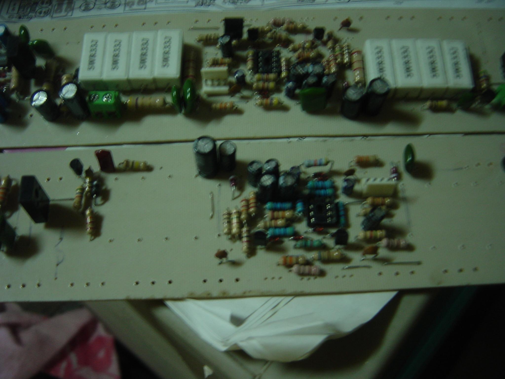

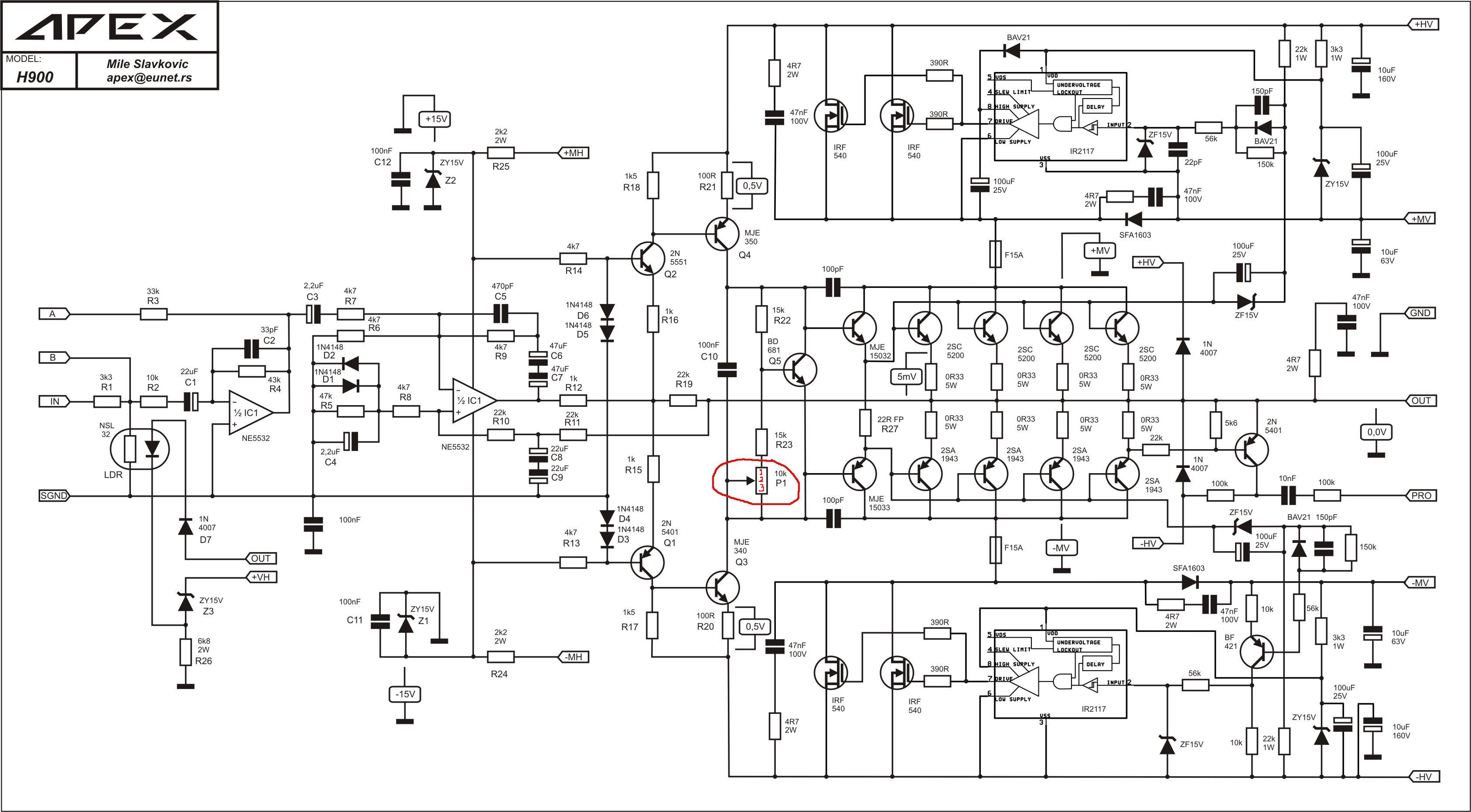

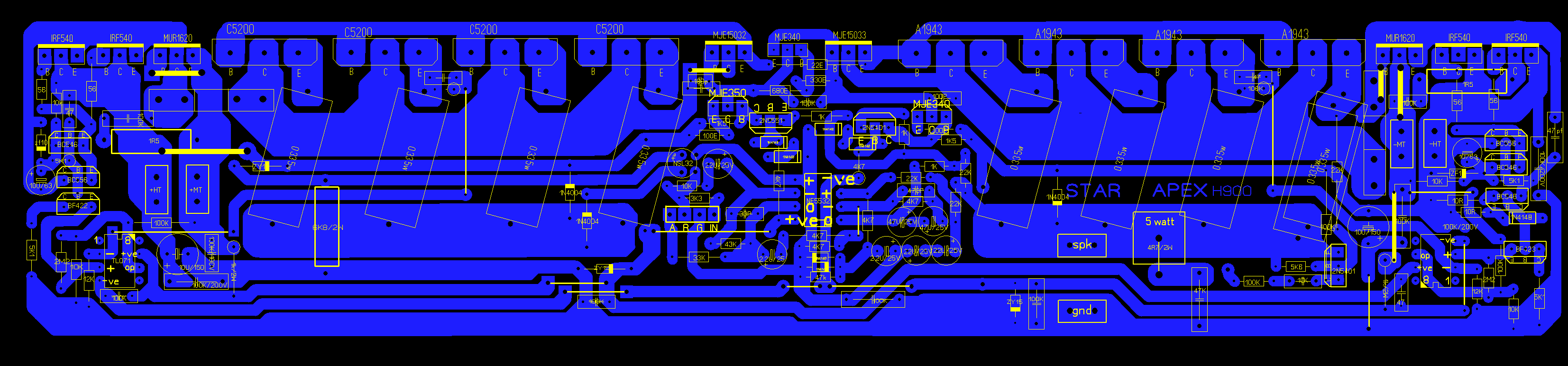

Thank you mr apex.the h 900 sounds incredible. i made a smps for it with +/-90v and +/-50 volt that's way i ask for biasing.my idle current is too low.thank you again.
Can you post pictures, and share smps PSU circuit?
Regards
hy diy-ers

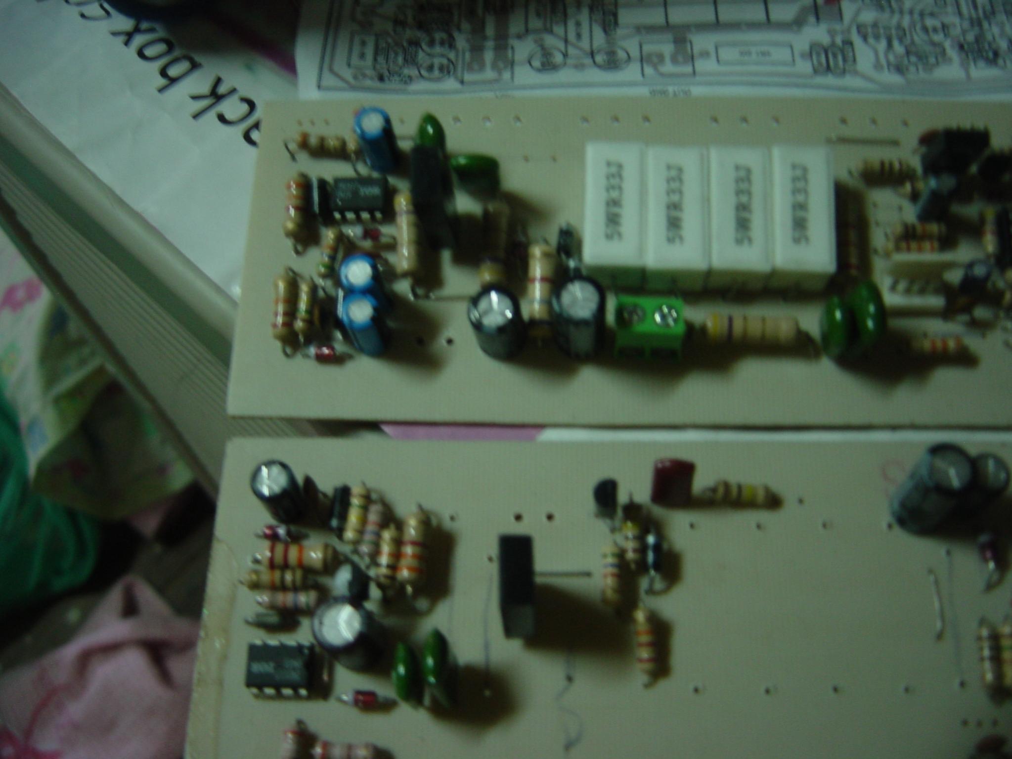

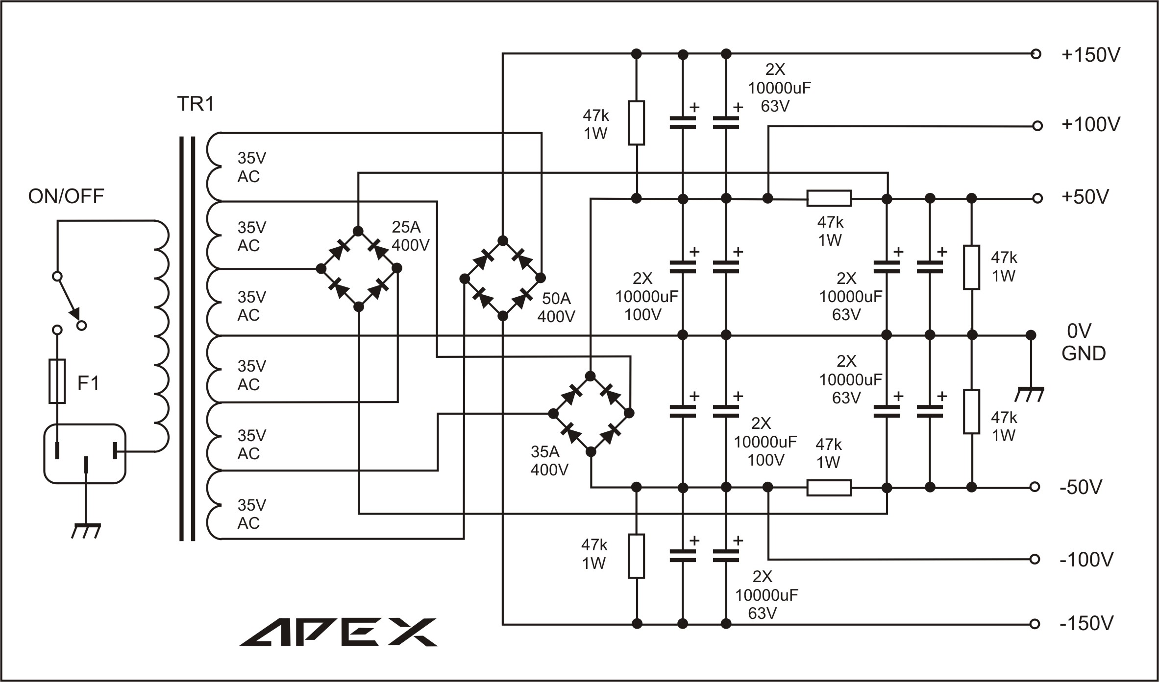

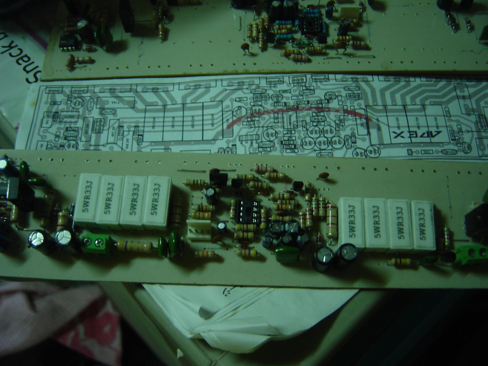

hy guys. the smps is not my design but i adapted for me .the smps it takes +/-50v,+/-90, +/- 24 v for protection board,and +/-12v for other accesories`i put 2x200watt bulb with h 900 and the bulb don't flicker at all .it's verry stabile.i will share the design and some pictures as soon as posible. thank's to mr apex i will build some active line array speaker just for testing but this when i have more time. bye
A suitable power supply for this amplifier, and not only can be found here: Connexelectronic
Apex sorry if this question has been here more than once but how much uF would you sugest for the MV? would 30 000 uF be enough, atleast I think so...
20 000 uF is enough for MV.
