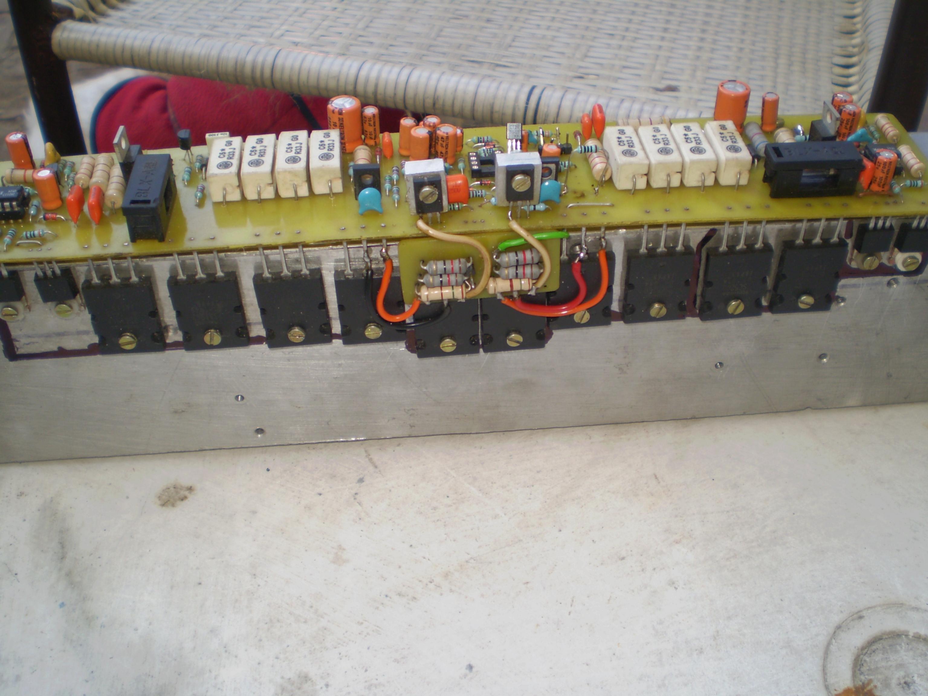

hi apex,
i tried your darlington topology.and guess what everything was ok no abnormal
readings.no sagging of voltages. dc offset of 2mv.same reading on every collector.
then i switched back to normal driver stage with mje15032/33 .switched on
2.1mv dc offset.no voltage sagging everything normal.then i saw i forget to add
22ohm resistor which was connected to both emmiters of mje15032/33.as i
connect then every thing messes up.30 mv dc offset.voltages sags 60 to 38
and-60 to-14.different reading on every collector.what should i do.
thanks

Use darlington topology if work good on your amp.

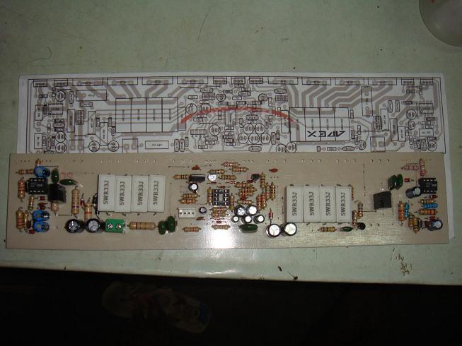

ready for mounting 6th 2 channel H900
Thanx to Miles

hi apex,
cant use tripple darlington as pcb dont allow this.i have to wire them seperaterl
cant i raise the value of resistor say 82/100 ohm or add a 100nf across
the resistor .raising the resistor value 100 ohms makes thing normal.
i want to complete it as soon as possible
thanks in advance
ravs

Nice work, thanks for picture, any coment about sound?

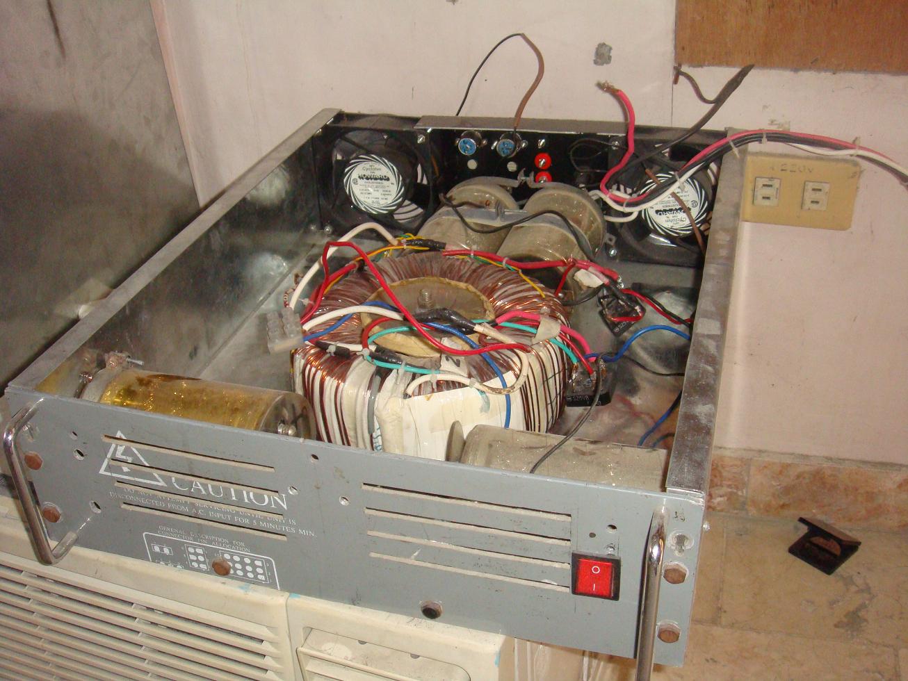

WHICH PSU YOU USE?
WHAT IS YOUR TRANSFORMER DIMENSIONS AND THE PRIMARY WIRE GAUGE, SECONDARY WIRE GAUGE.?
