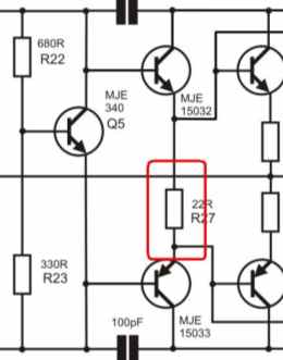

hi apex,
i tried your darlington topology.and guess what everything was ok no abnormal
readings.no sagging of voltages. dc offset of 2mv.same reading on every collector.
then i switched back to normal driver stage with mje15032/33 .switched on
2.1mv dc offset.no voltage sagging everything normal.then i saw i forget to add
22ohm resistor which was connected to both emmiters of mje15032/33.as i
connect then every thing messes up.30 mv dc offset.voltages sags 60 to 38
and-60 to-14.different reading on every collector.what should i do.

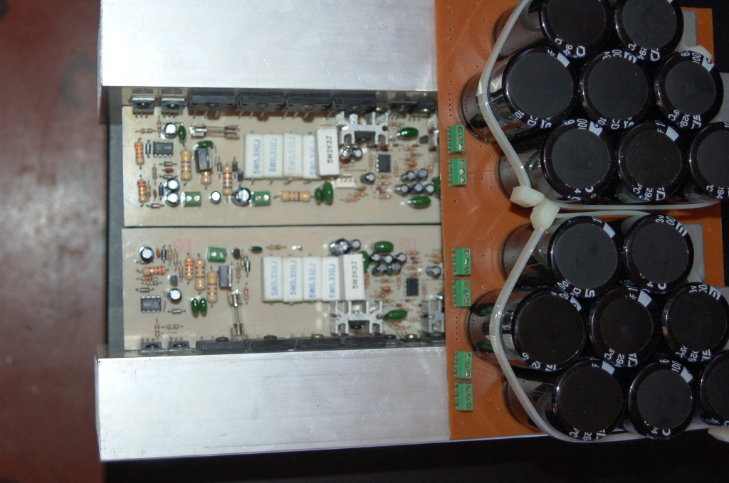

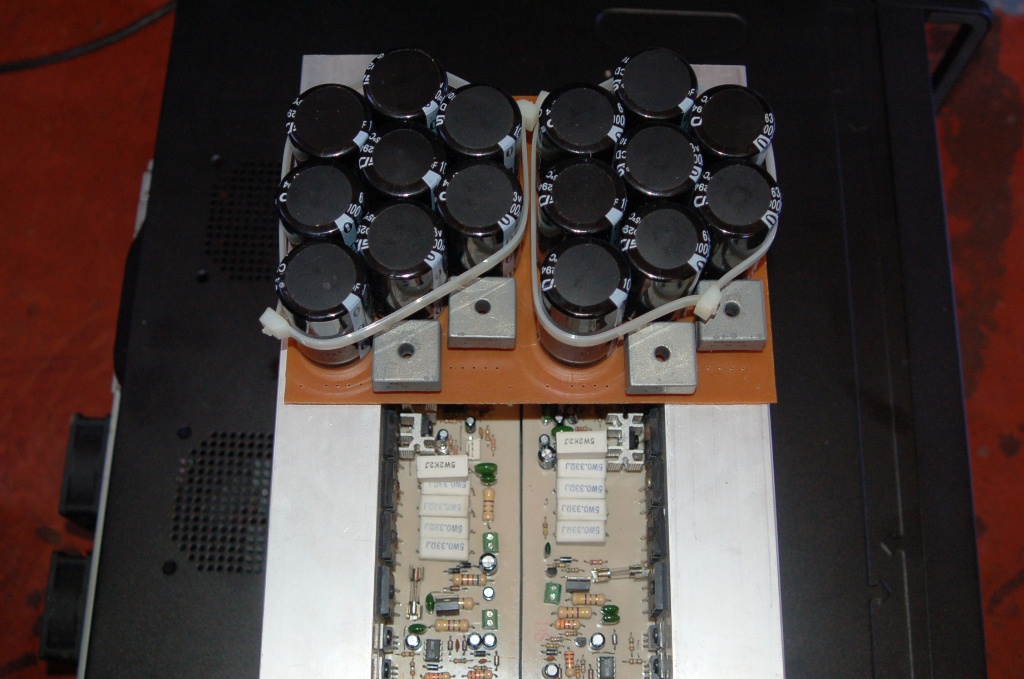

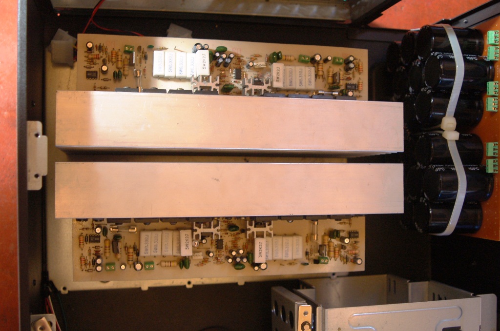

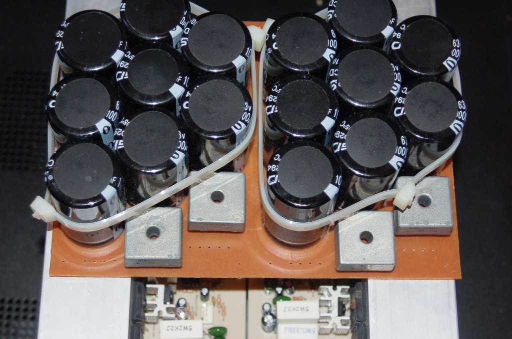

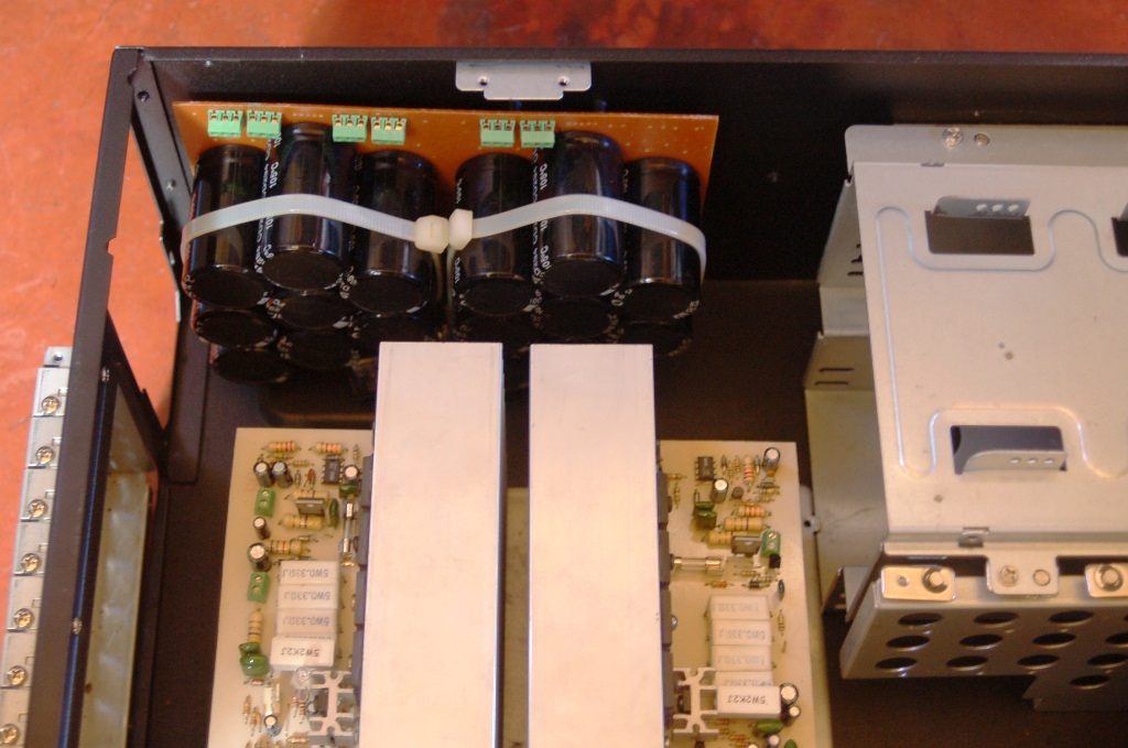

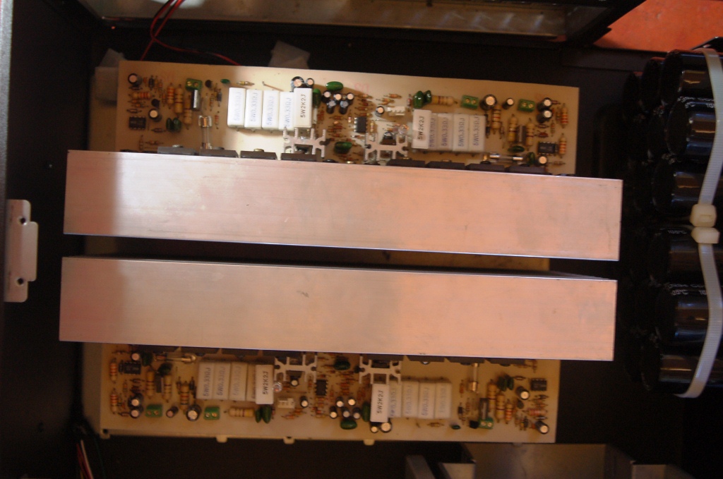

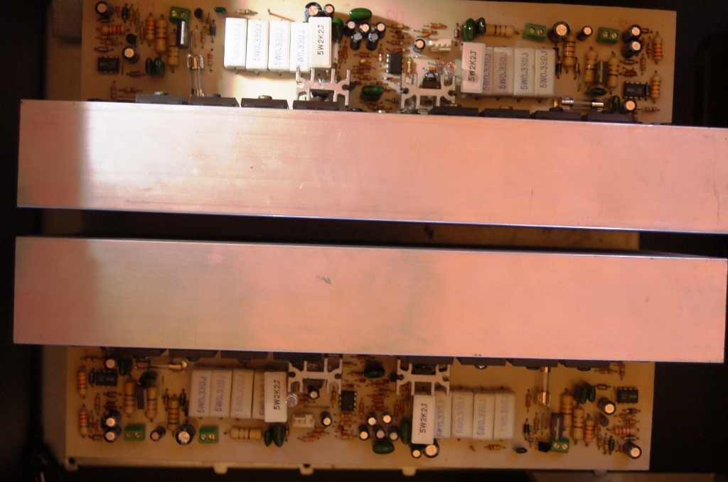

6th H900
ready for mounting 6th 2 channel H900
Thanx to Miles
Thanx to Miles

hello sir
i use triple ef stage vd 4 pairs...is that ok?vd triple ef stage what will happn??
thank u sir....
thank u sir....
Thanx to Miles
Great progres, I hope this will be succesfull build,
Regards
hello sir
thank u sir....
It's OK, bias must be readjust.
