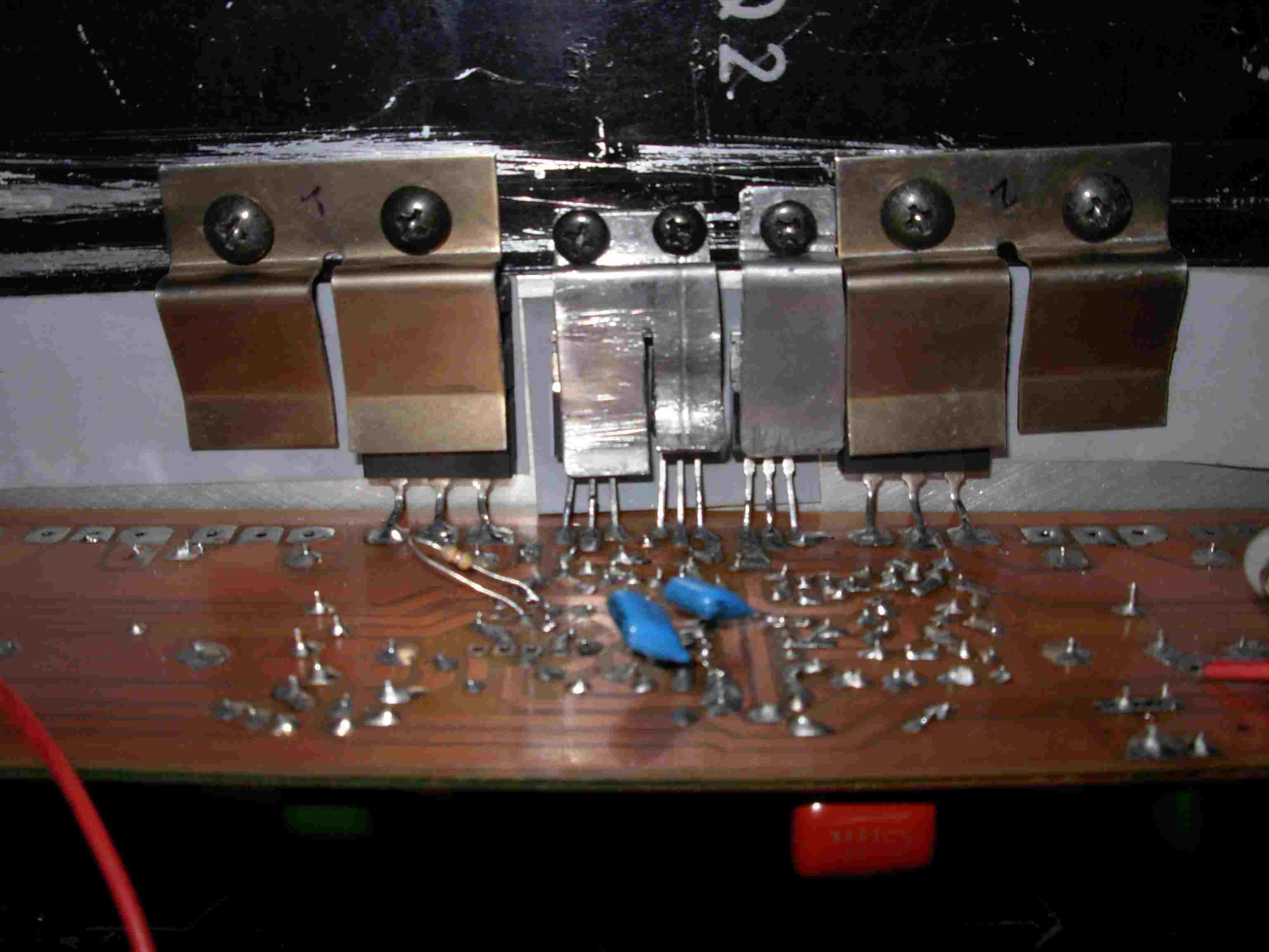

hi apex,
do oscilations makes bulb glow brighter.i increased the length of leads of mje15032/33 and mje340 sleeved.the bulb started to glow continuosly.different voltages on collectors as we move away from the fuse.checked for shorts . removing the transistors and bolting them to sink and connect through wires make things normal.or is there any other problem.is my amp oscilating.ill post pictures tonight.

Is your zobel resistor 4R7/2W hot?
I would expect so.do oscillations makes bulb glow brighter..
If the amp has been set up with near zero output stage bias then the Power consumption is very low.
If oscillation sets in, then Power consumption will increase significantly.
If you test start up with a low wattage light bulb then it should be sensitive to any fault that increases Power consumption.
As you turn up the output stage bias, you will find that the light bulb starts to glow. Stop, back off the bias slightly. Change the bulb to a slightly higher wattage. Increase output bias until the bulb is just not glowing.
In this state the bulb will see any further increase in Power consumption as a smaller proportion of the total consumption. Mild oscillation might not show as extra glow. Bad oscillation should show up easily.

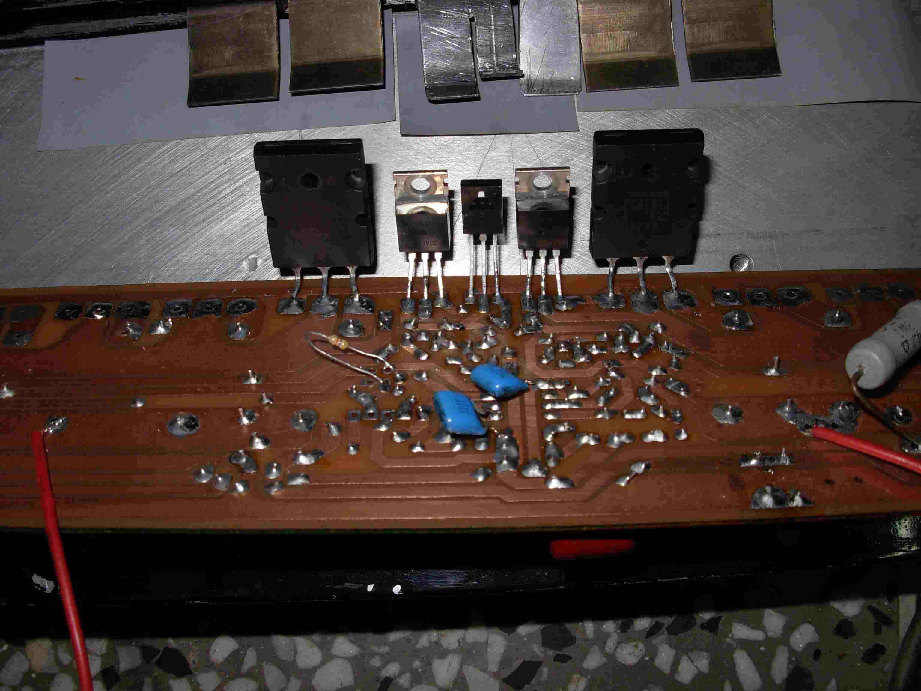

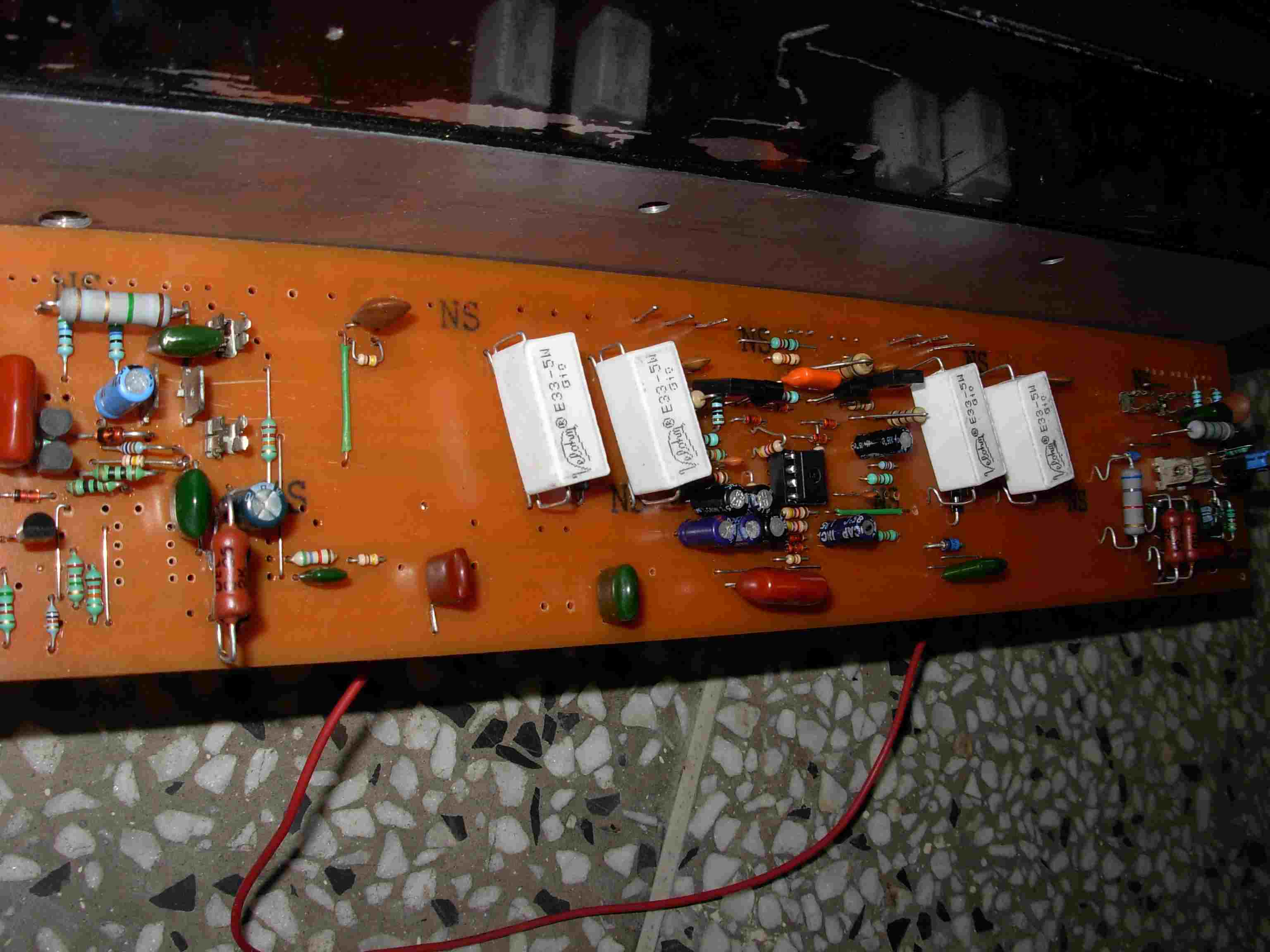

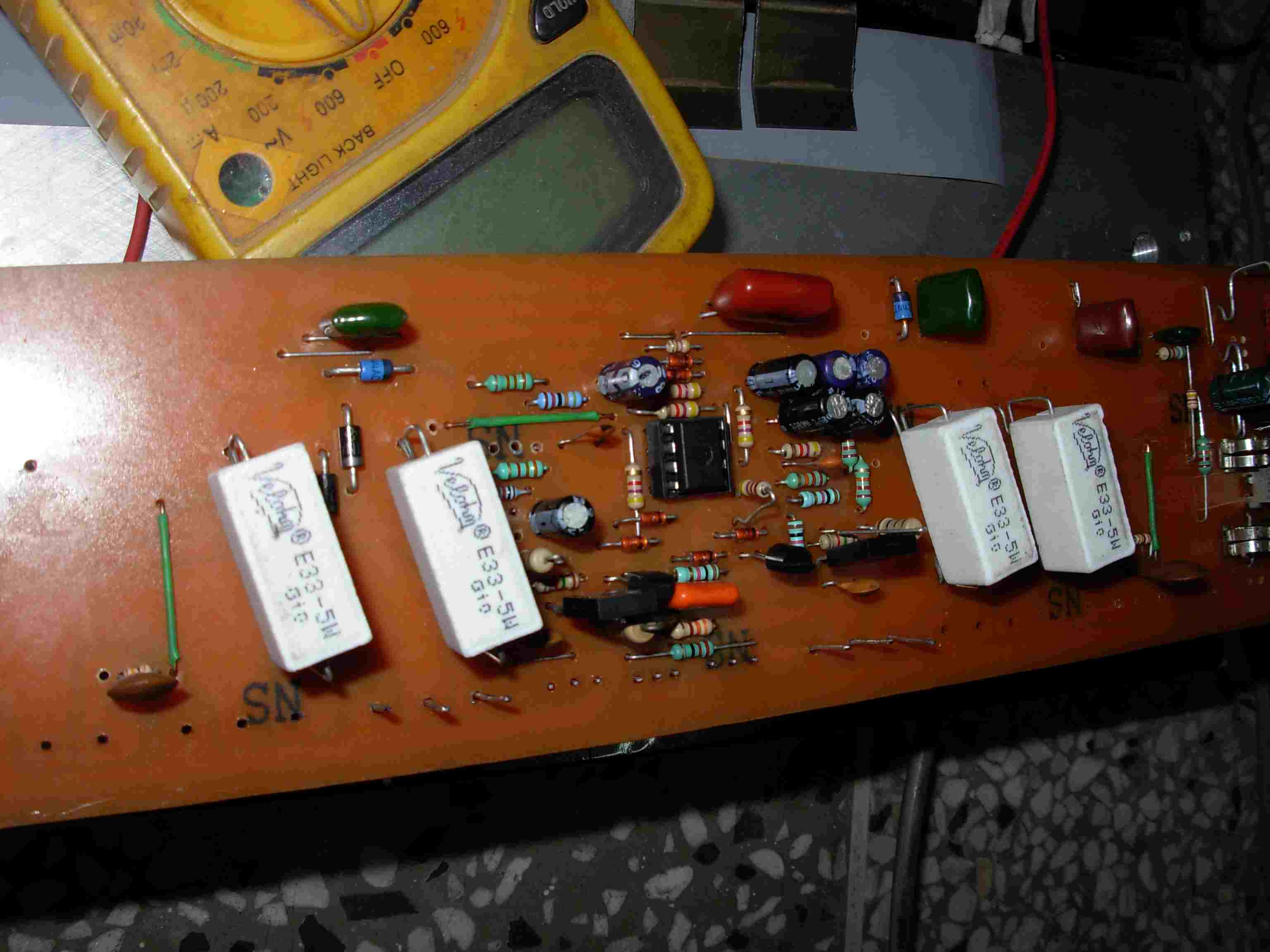

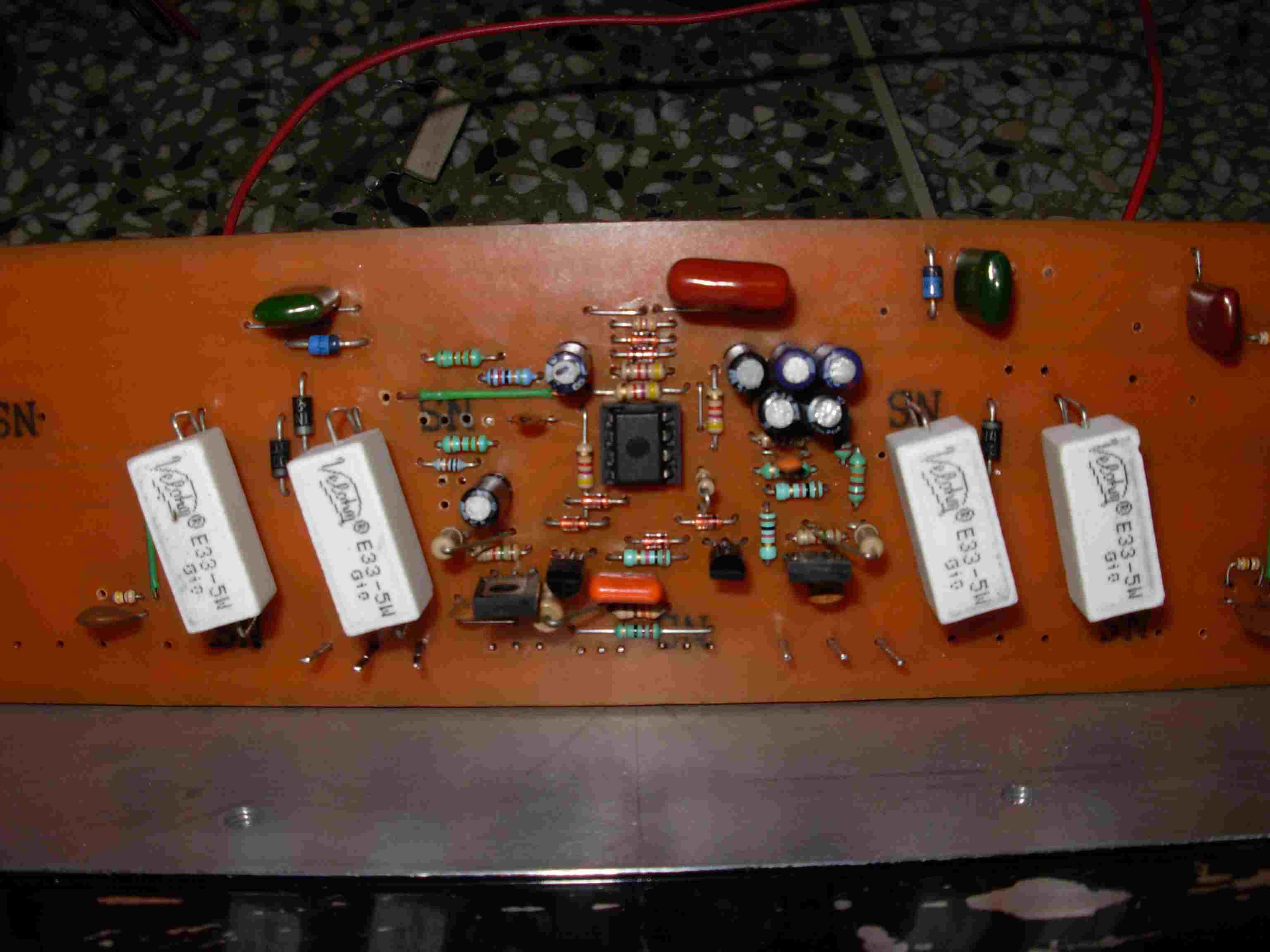

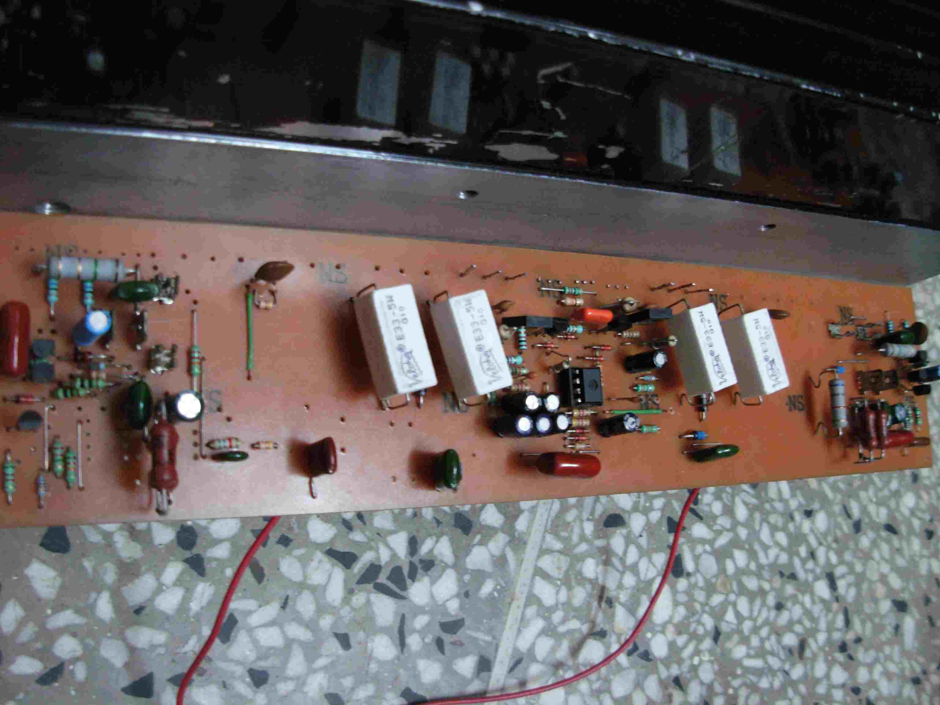

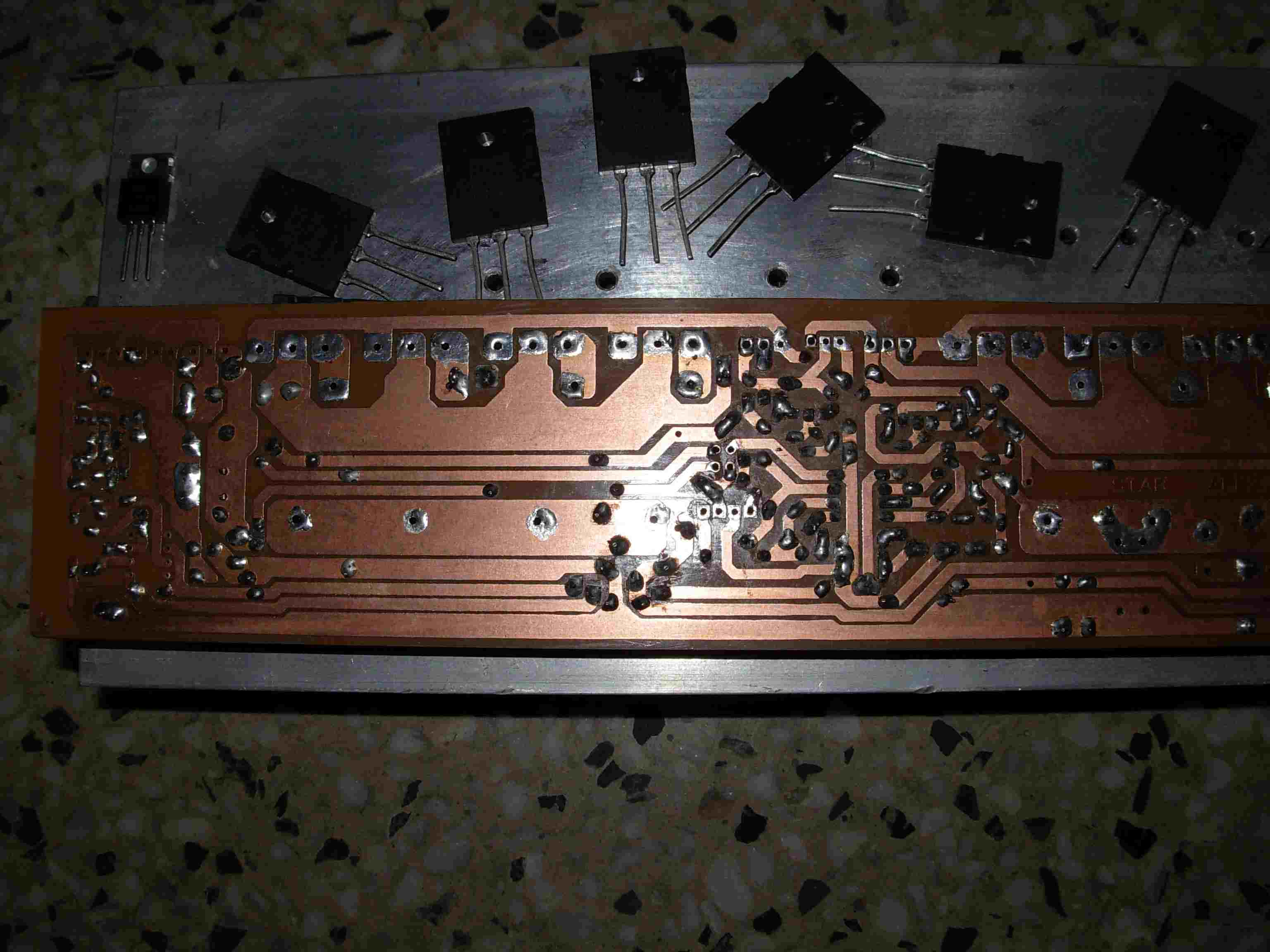

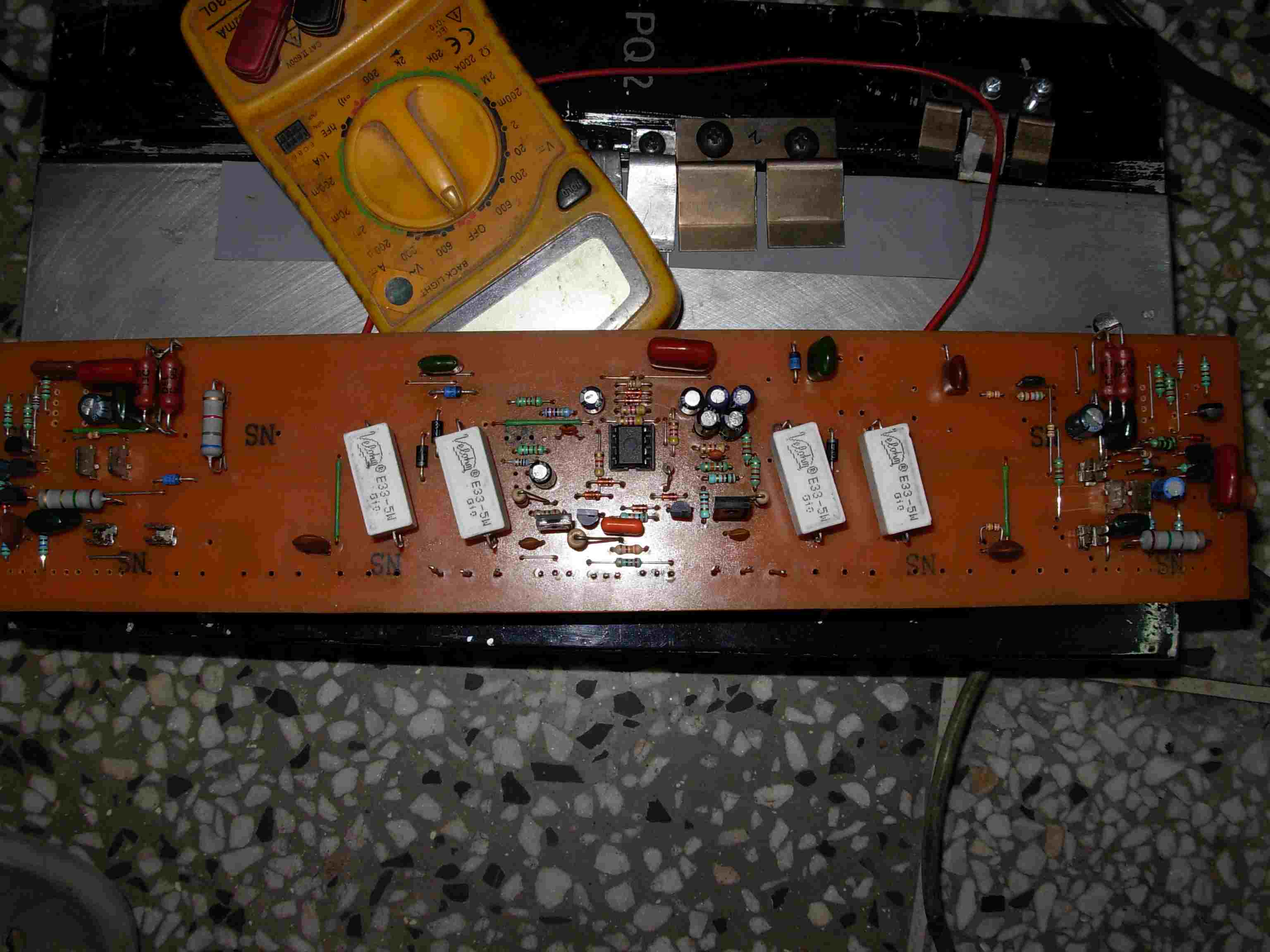

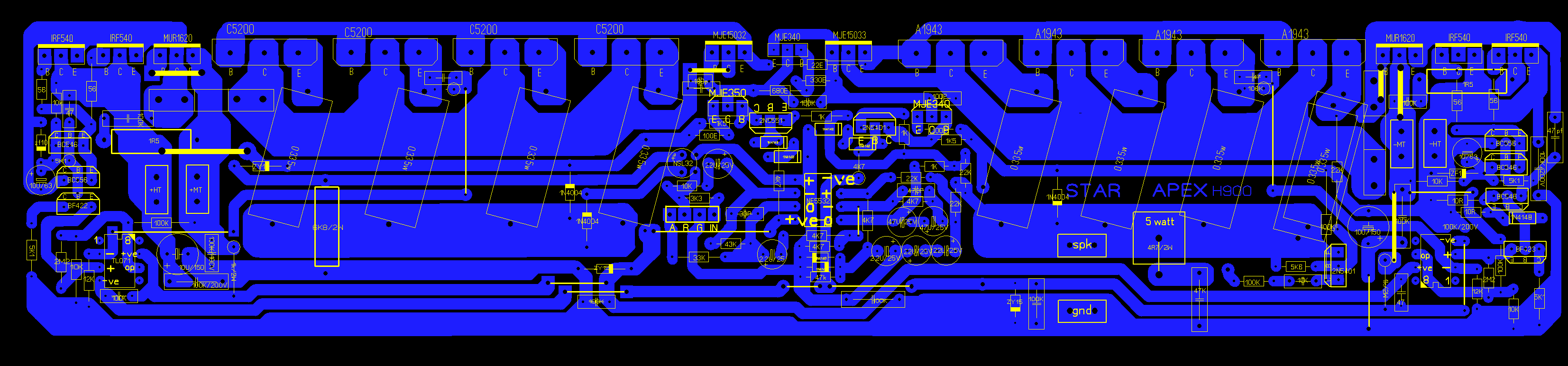

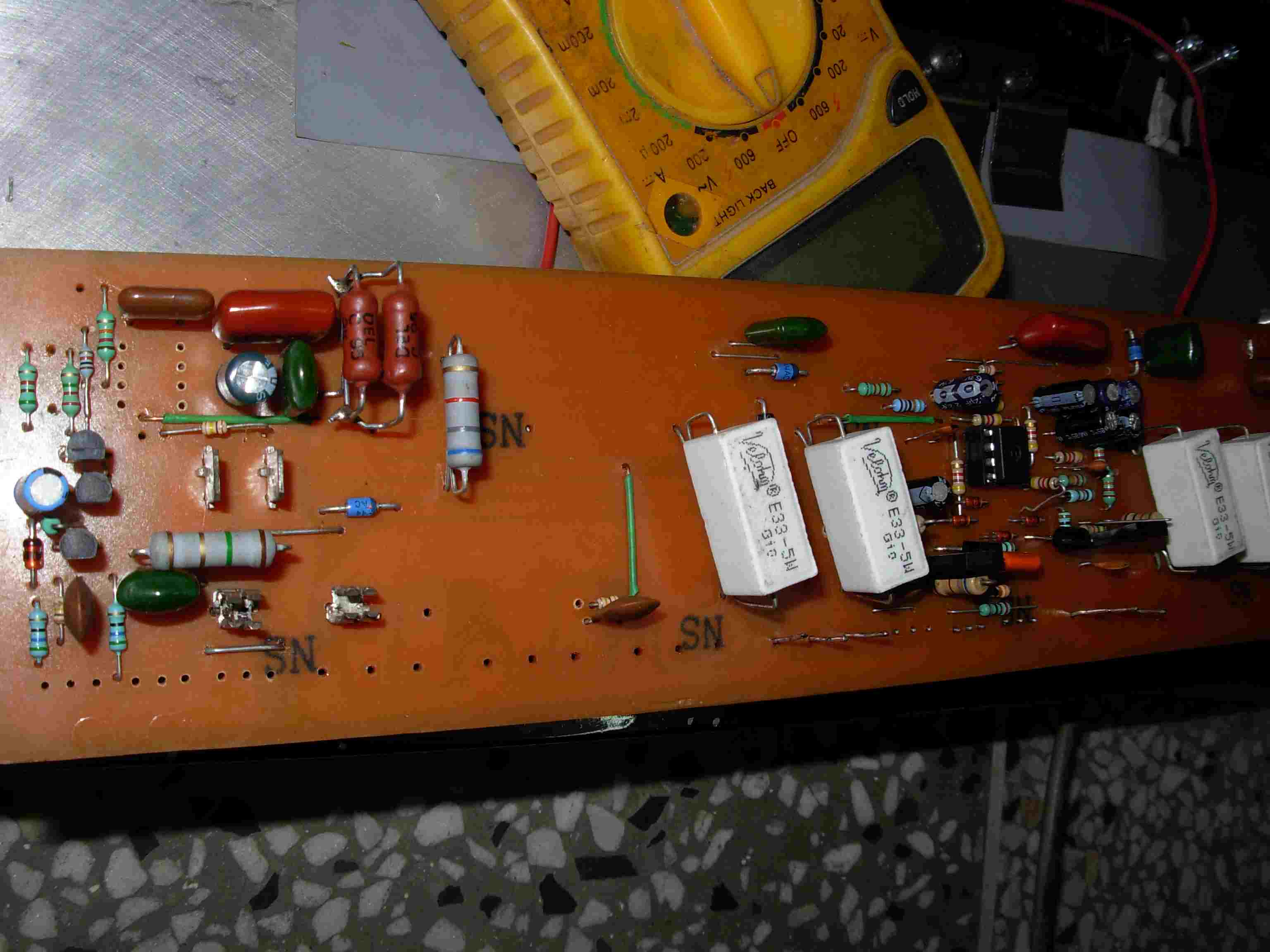

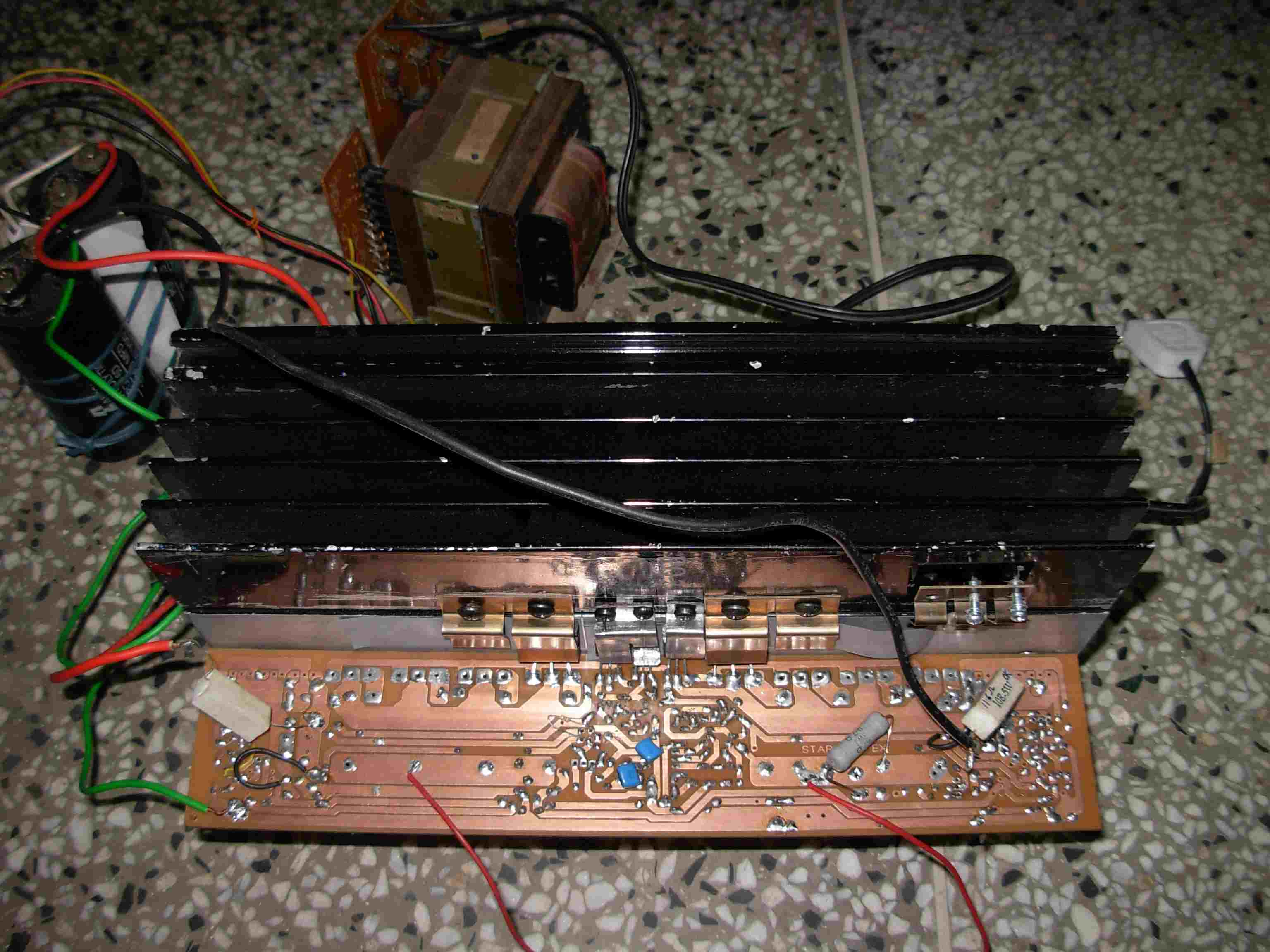

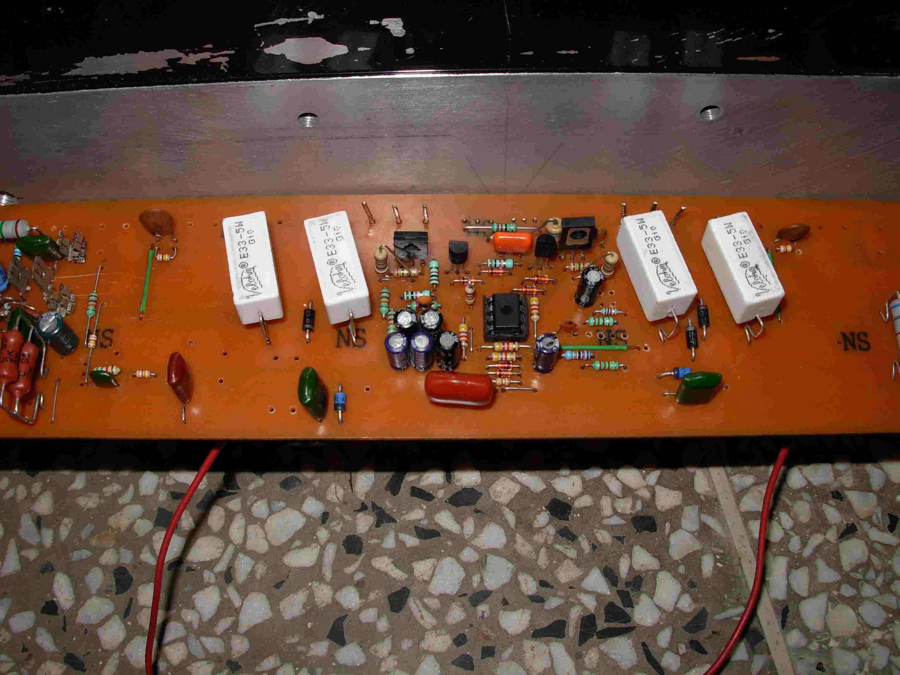

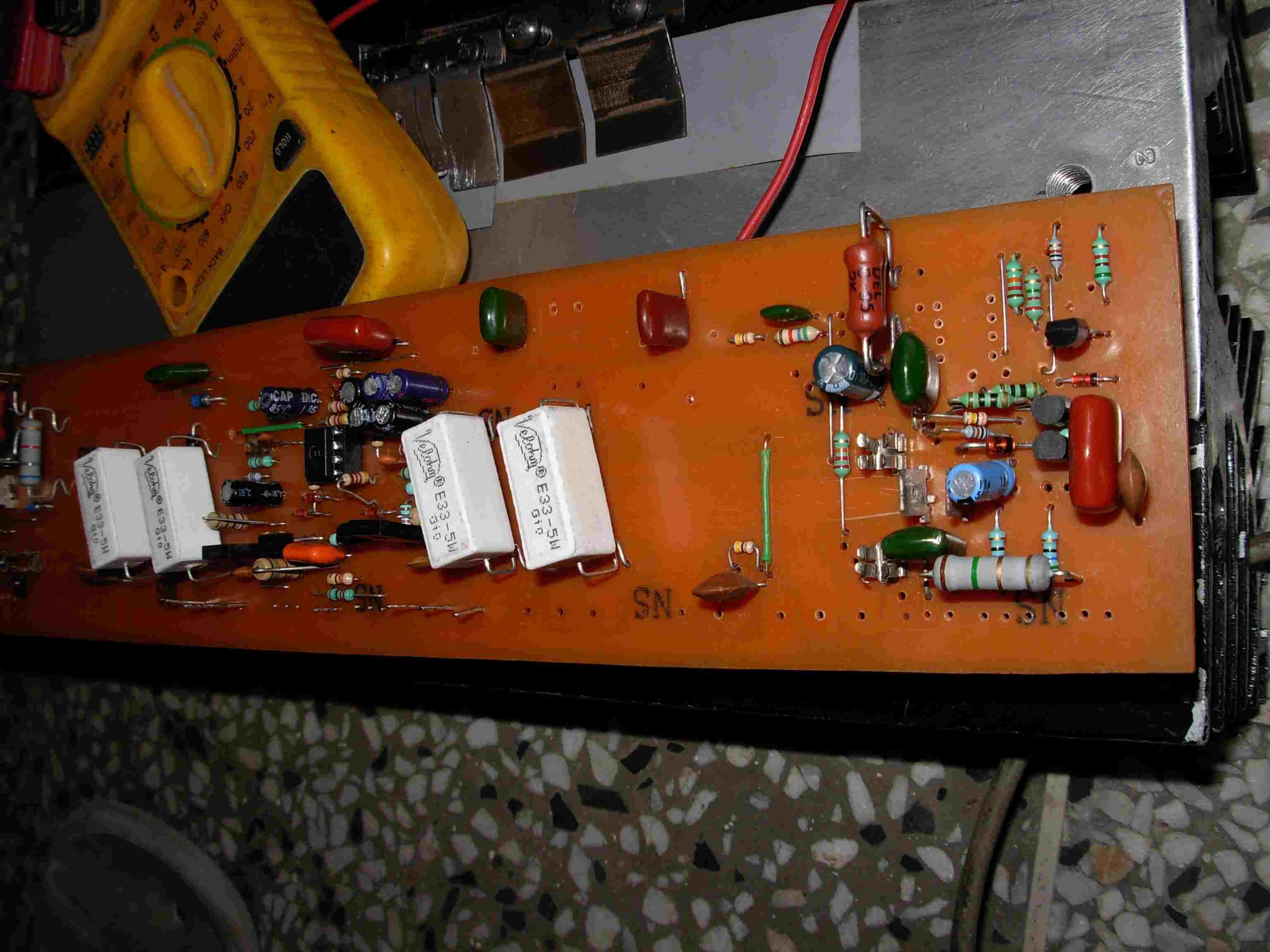

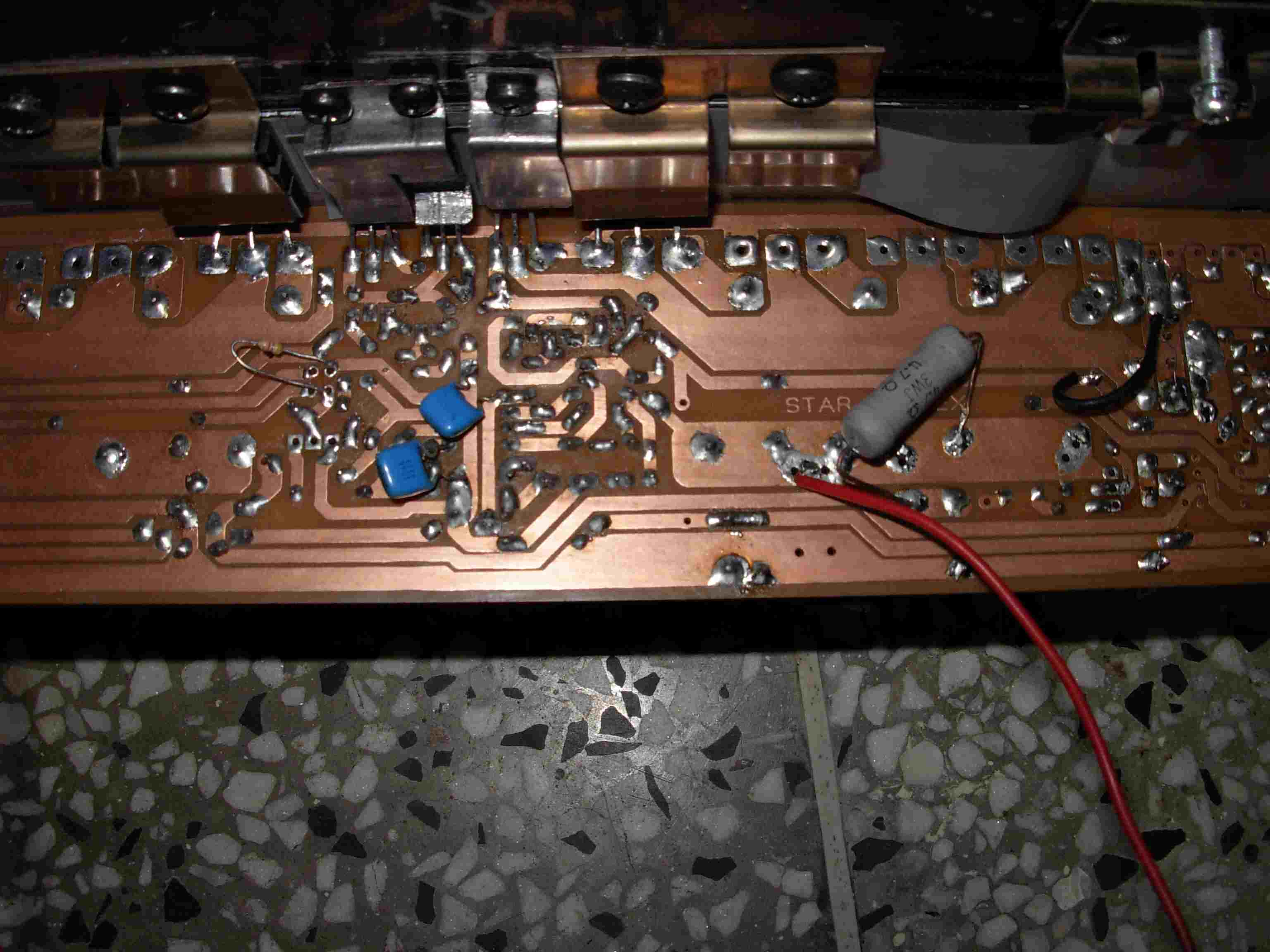

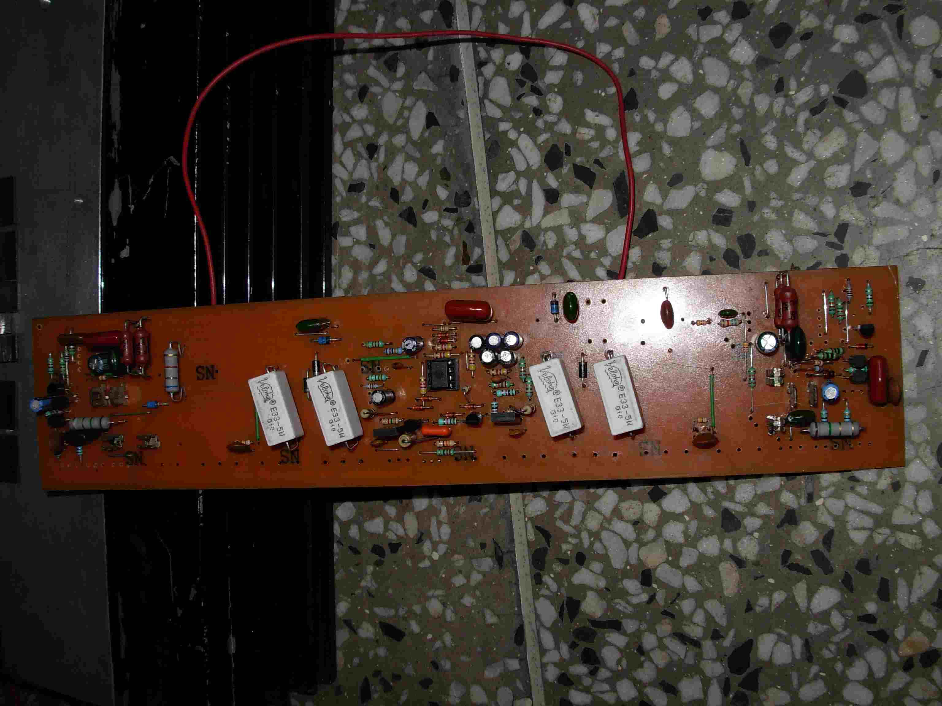

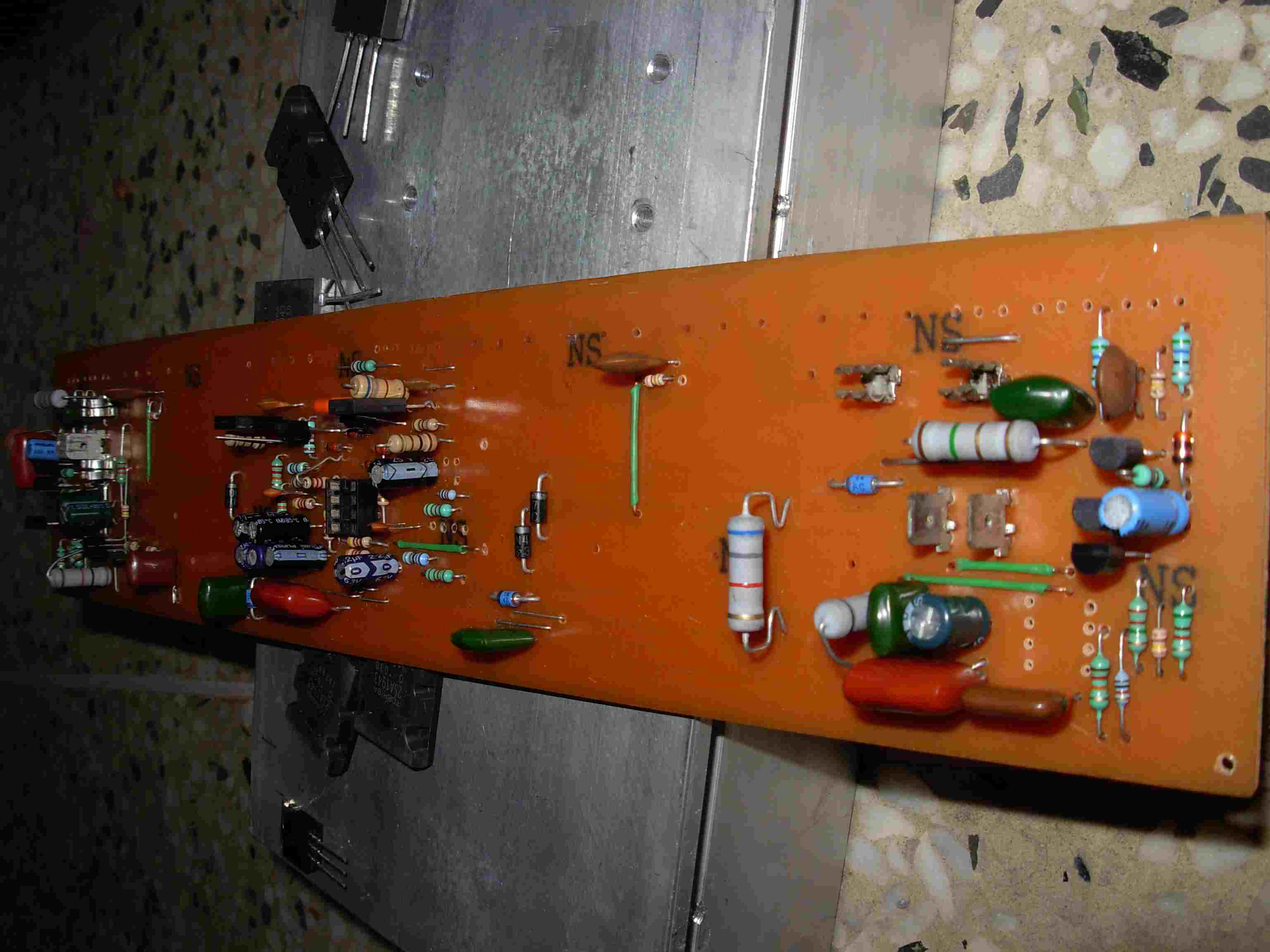

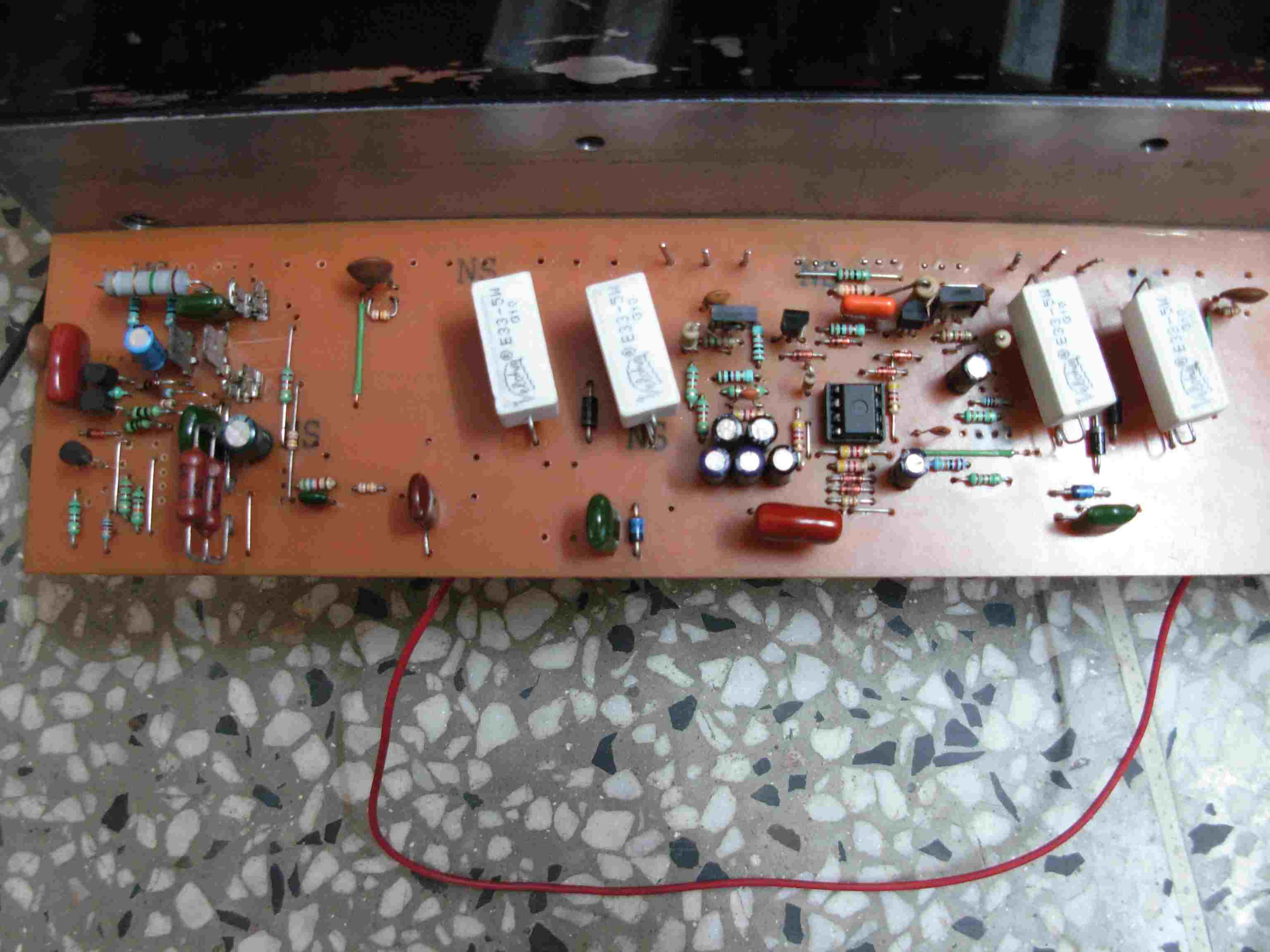

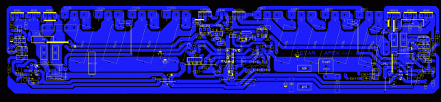

hi apex,
sorry it took a lot time to take photo and make some video.
no my zobel is not getting hot at all.
here are some pics and videos
some videos as well

do you think its gonna work.or is it any other problem
by the way i made the pcb mirrored so all the components those were
on left are on right side and vice versa.this is third time iam doing same mistake

I would expect so.
thanks andrewt

hi apex,

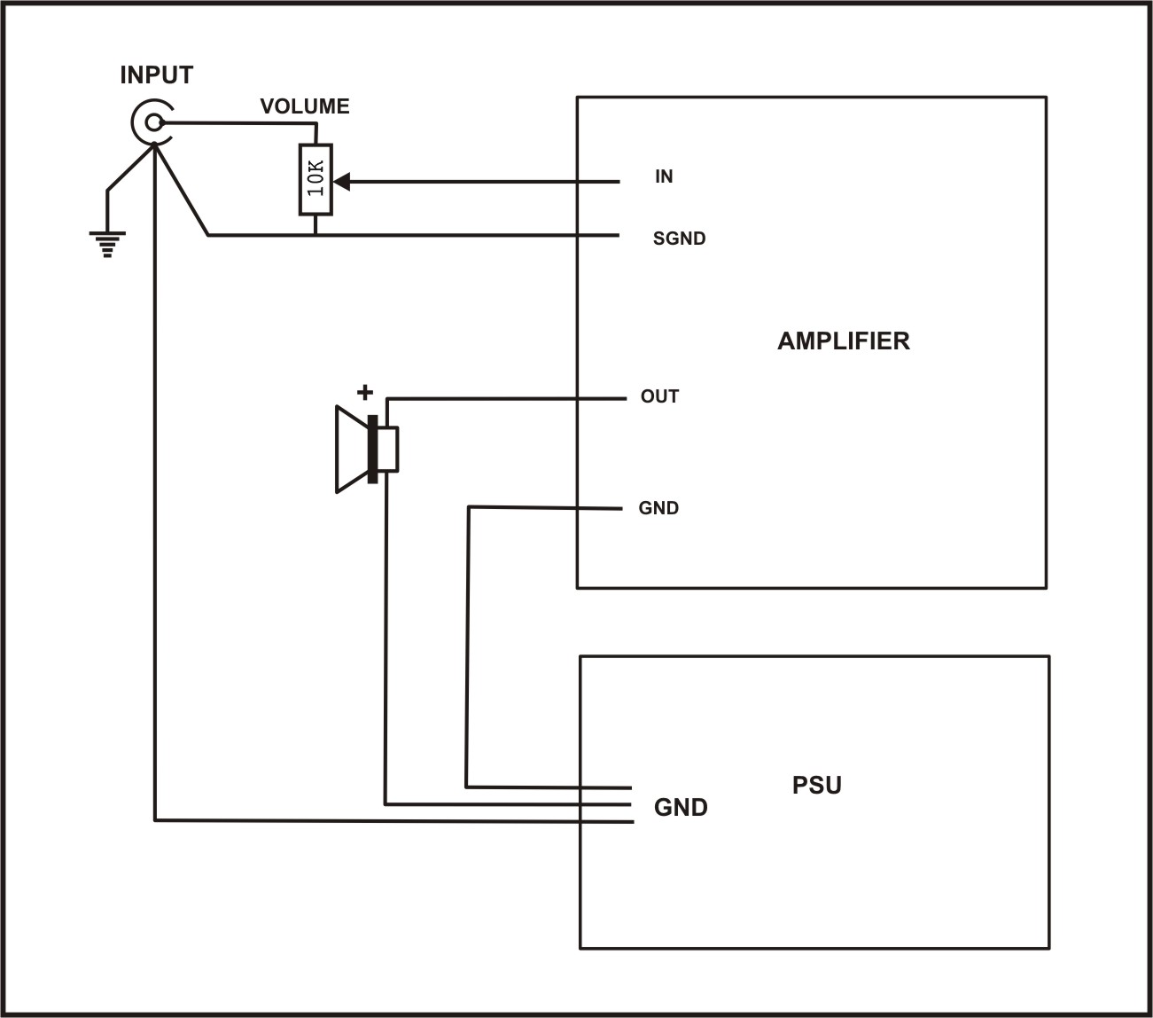

Do you connect input GND to PSU GND? If not there will be high DC offset on amp out.
hi apex
that didnt made any difference offset becomes 20-29mv.
without any series resistor but bulb why my positive voltage 61volts
and negative 14 volts on the fuse.and different values on different collectors.
it happens when i connect c5200/1943.with drivers it is normal.
do you have any idea whats going on.
