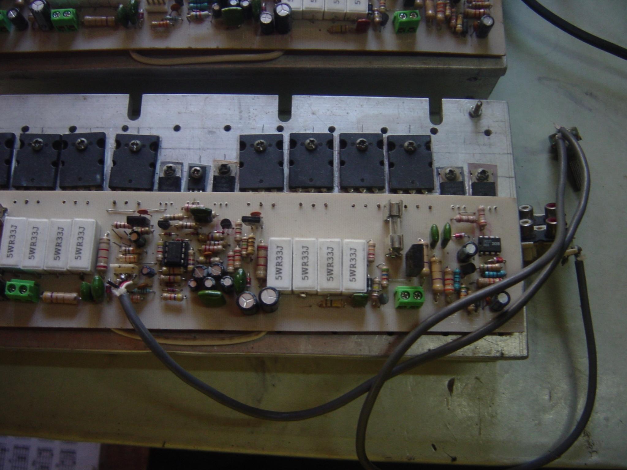

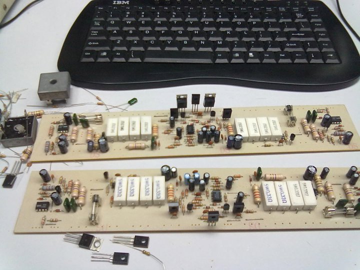

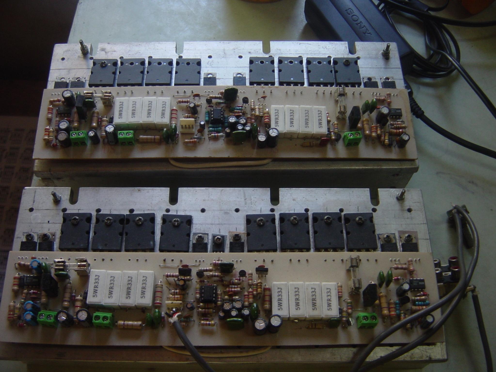

apex,
beautiful h900
one channel working
one channel
waiting mje's
Nice work, is there any case for your amp?
apex,
beautiful h900
one channel working
one channel
waiting mje's
why the transistors lineup incorrectly. no time or don't care.
is that small resistors 1/4watt or-1/2 watt. i think it is half watt.
in my experience first pick correct heatsink . if the heatsink is big measure it and cut it otherwise problem with casing.
apex,
thanks
case already shown post 1213
i want to replace big capacitor the resrvoir
and waiting for mje340
almost complete

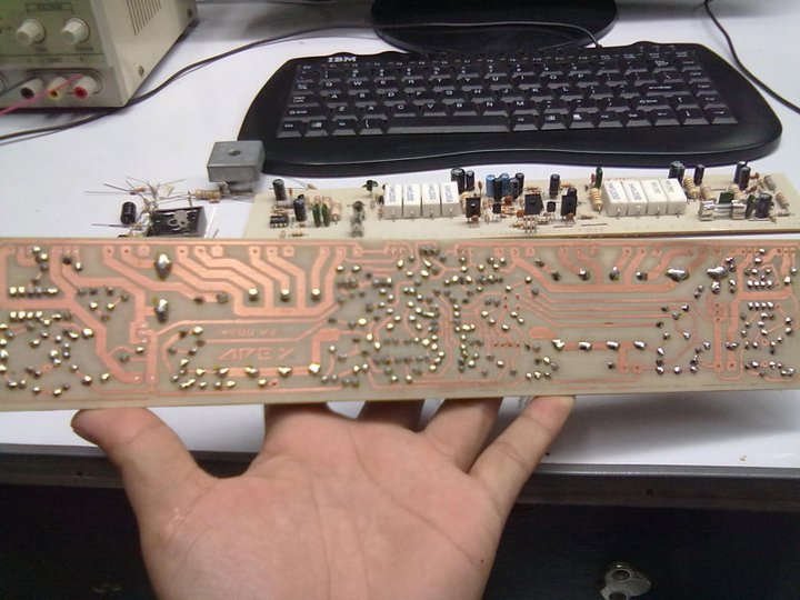

btw. here's may project im still search for some parts like bav21 so hard to find

i feel very sorry for which i said about your amp.
