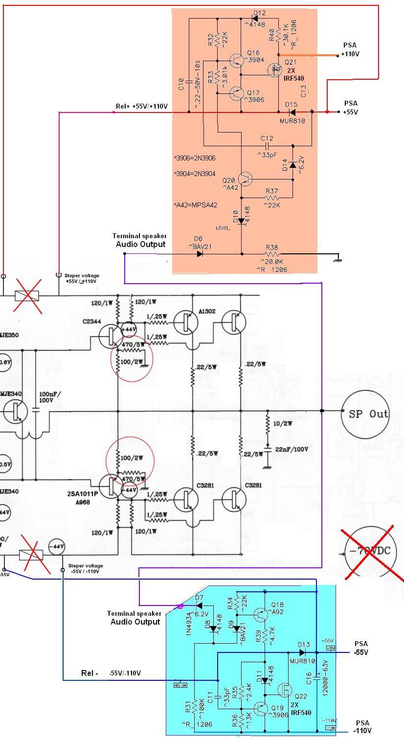

bav21
mur120
uf4004
4006
4007
engel,,
is this 1n4006,,1n4007 ?
BAV20,21 is commonly use on old AOC crt monitors
bav20 can be found on newer version of crt flat or semi flat AOC 17 inch monitors
bav21 can also be found on old version 14 inch AOC crt
those diodes are placed on prong pcb
look for junk monitors and you will find those diodes
http://www.nxp.com/documents/data_sheet/BAV20.pdf

HX900 with speaker protector
HX900
rung tak jajal kang. rung sempet wektune, nggko nek wes tak jajal, tak kabari yo
I have not tried this layout.
I still constrained by time, so I have not had time to test it
later when I have tried, I would upload pictures
hi soerdjanto
greetings have you tested this step driver hows the performance
nice pcb
thanking you
andrew lebon
sound is clearly and powerfull.... thank you Mr.Mile and Mr.Collet for pcb....
