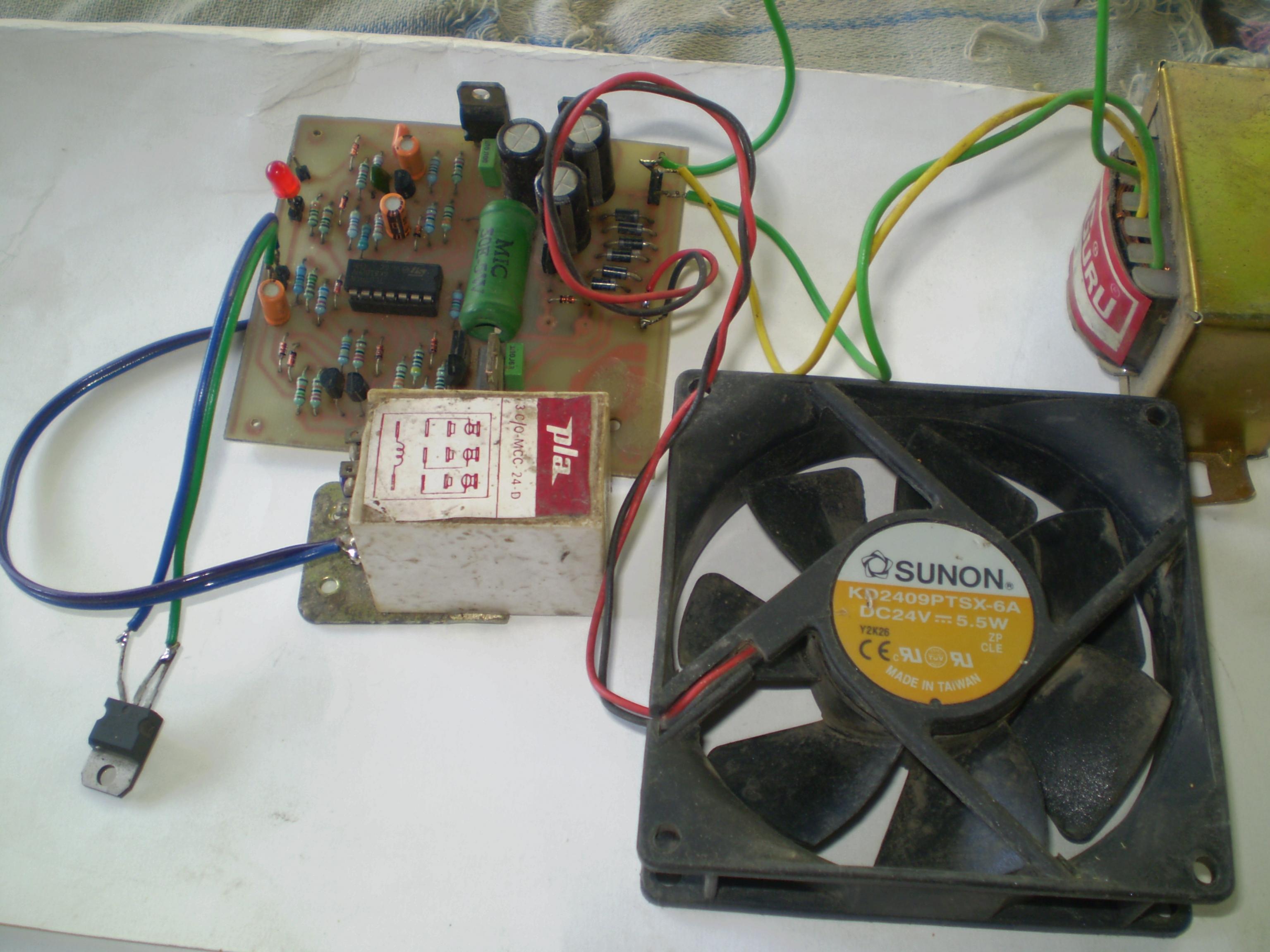

dc protect
dear apexaudio
greetings want to ask if on applying dc voltage to 150 k resistance will relay come on and led come on all other functions of dc protect
working only need to know if dc 15 volt from regulator fed to 150 k resistor will energise relay
thanking you
andrew lebon
dear apexaudio
thanking you
andrew lebon
are you asking if a 150k resistor in series with the 15Vdc supply can activate a relay drive circuit?
If that is the proposal then the 150k can pass a maximum of 100uA. Will the relay drive circuit trigger on a 100uA signal?
If instead your proposal is to feed a relay via the series 150k, then there is no way a relay can pull in with a 100uA supply.
dear apexaudio
thanking you
andrew lebon
Yes 15 volt from regulator fed to 150k will activate DC protection, relay come off and protect led come on.
Regards

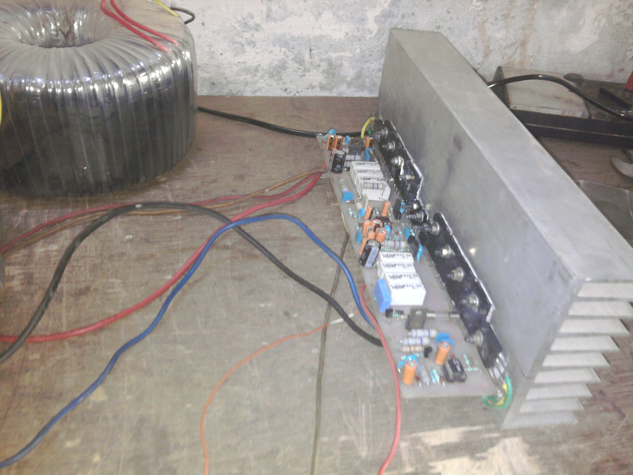

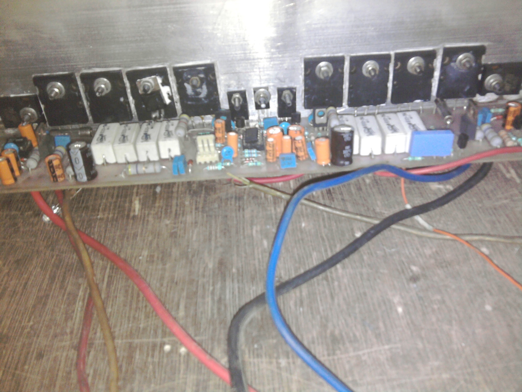

Nice work, I suggest to put BD241C on heatsink, plastic case of outputs have lower temperature than metal. Do you have case for your H900?
Regards
hello sir apex..
i want to run my fan on full speed at 75digres ......pls tell what changes can be made.......
thank u sir
thank u sir
hello sir apex..
thank u sir
I suggest don't change, 55deg is standard.
Regards

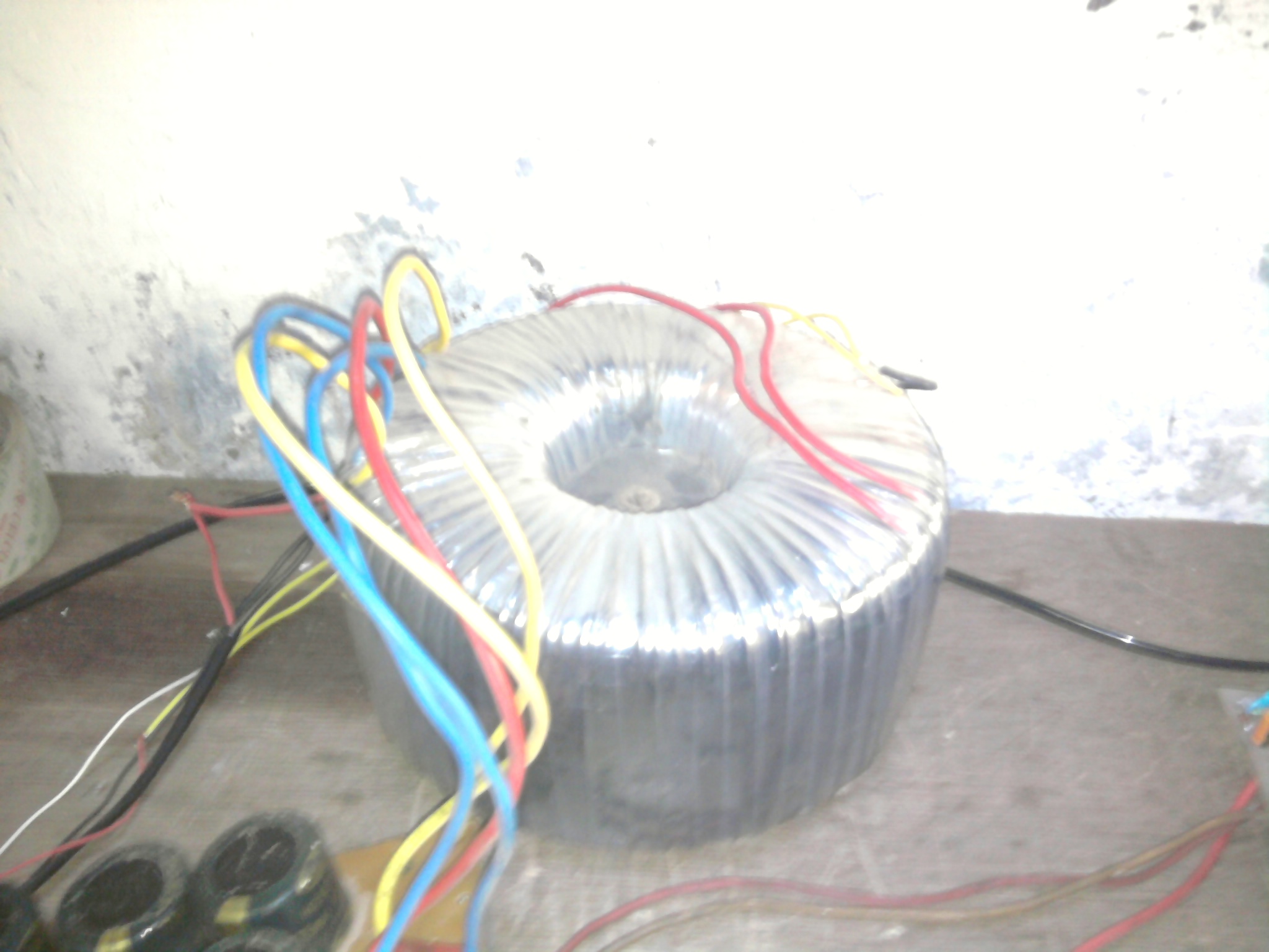

thats real nice work and those heat-sinks & toroids just love them ............... how did u manage them in delhi .......
regards
sekhar
hello bro...
its very hard to find them bt i can tell u....PM u..
nd where r u now in delhi , Bombay or at home ....??
thank u...
thank u...
hello bro...
thank u...
what is the price of toroidal transformer??
hello bro...
thank u...
hi aman khalsa
mail me too iam residing in east delhi
thanks in advance
ravs
