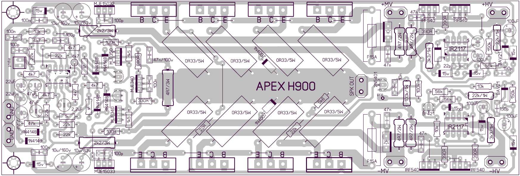

You can use this diodes and test with +/-70V DC in class AB, sound will be same only increase rail voltage and class H will increase power and eficiency.

IR2117PBF and IR2117,,,, are they the same?
Boggart,
It's the same except IR2117PBf is lead free while IR2117 is non lead free.

hi apexaudio
greetings can you tell me wattage of ground lift resistor R104 10
ohms and voltage rating of C43 102 THANKS FOR THE SUPPORT

R104 - 10R/1W
C43 - 1nF/400V

hello sir
can i use this pcb is that ok ?????
thanx......
I don't know, it's not my pcb design, I must build and test before suggest anything to you, but I haven't time, and I not use this schematics in my new products. If you want improvements on B500 and H900 it's on you or other peoples to do this, I can help with my expirience and advice.

hi
hello sir
i want to add some more pairs in h900....
i want a pcb layout .....
can u pls tel me how can i make pcb lay out....
thanx...
Regards
hello sir
thanx...
SFA1603 diode
Hi, Mr.Mile
whether SFA1603 can be replaced with MUR1530?

You don't need add more pairs in H900, it's powerfull enough. Makeing pcb design is not that simple, but if you want add some more pairs, make pcb only for 4 more pairs and paralleling it with H900 pcb, it's simpliest way.

Yes you can use MUR1530 instead SFA1603, but I suggest you to use V2 pcb with 3 pin dual diode.
