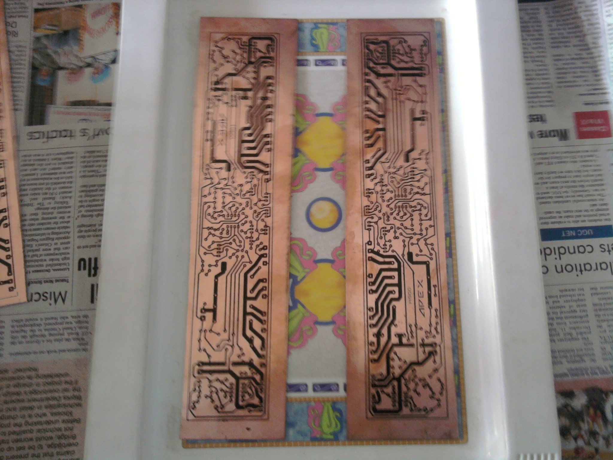

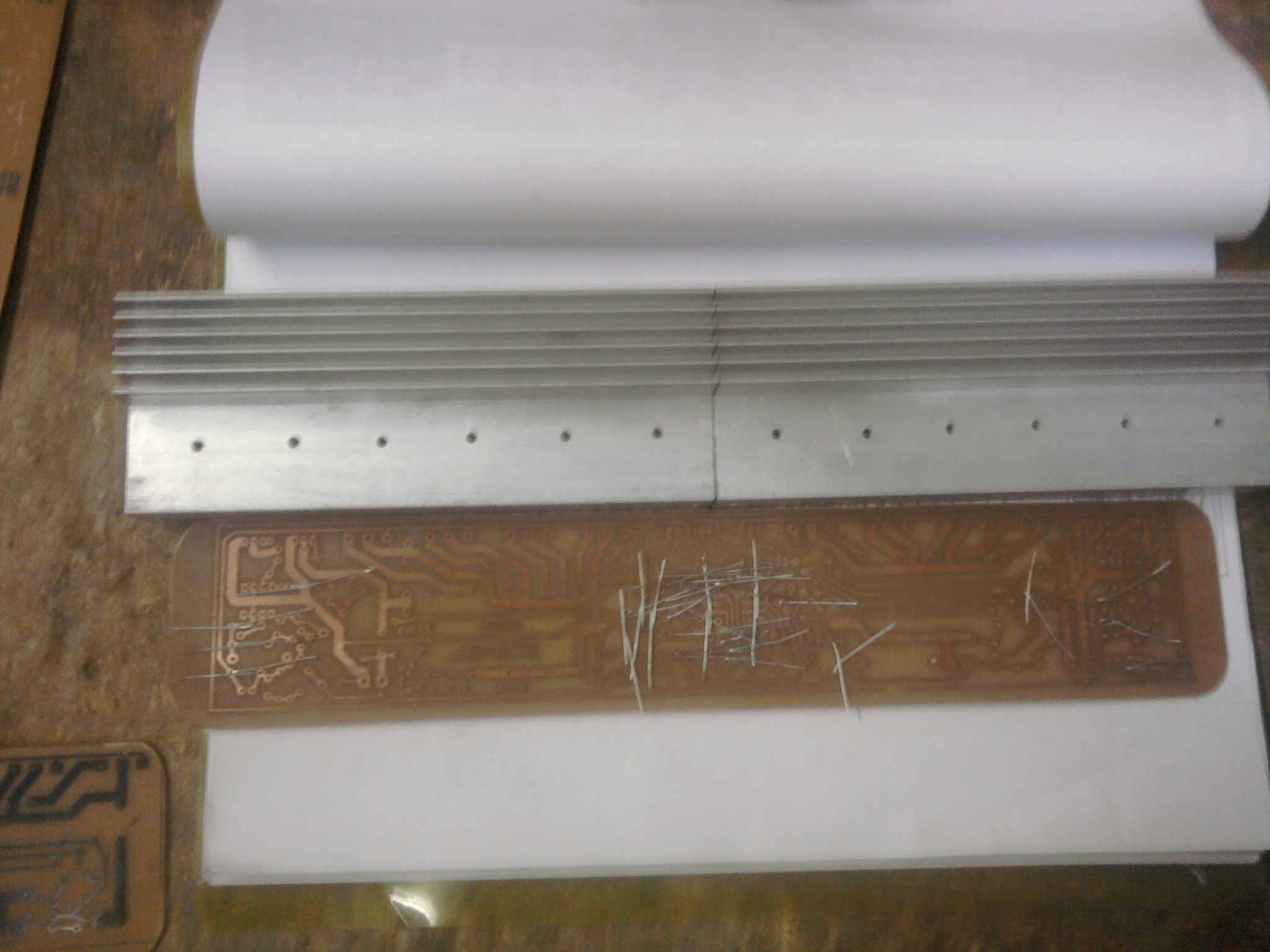

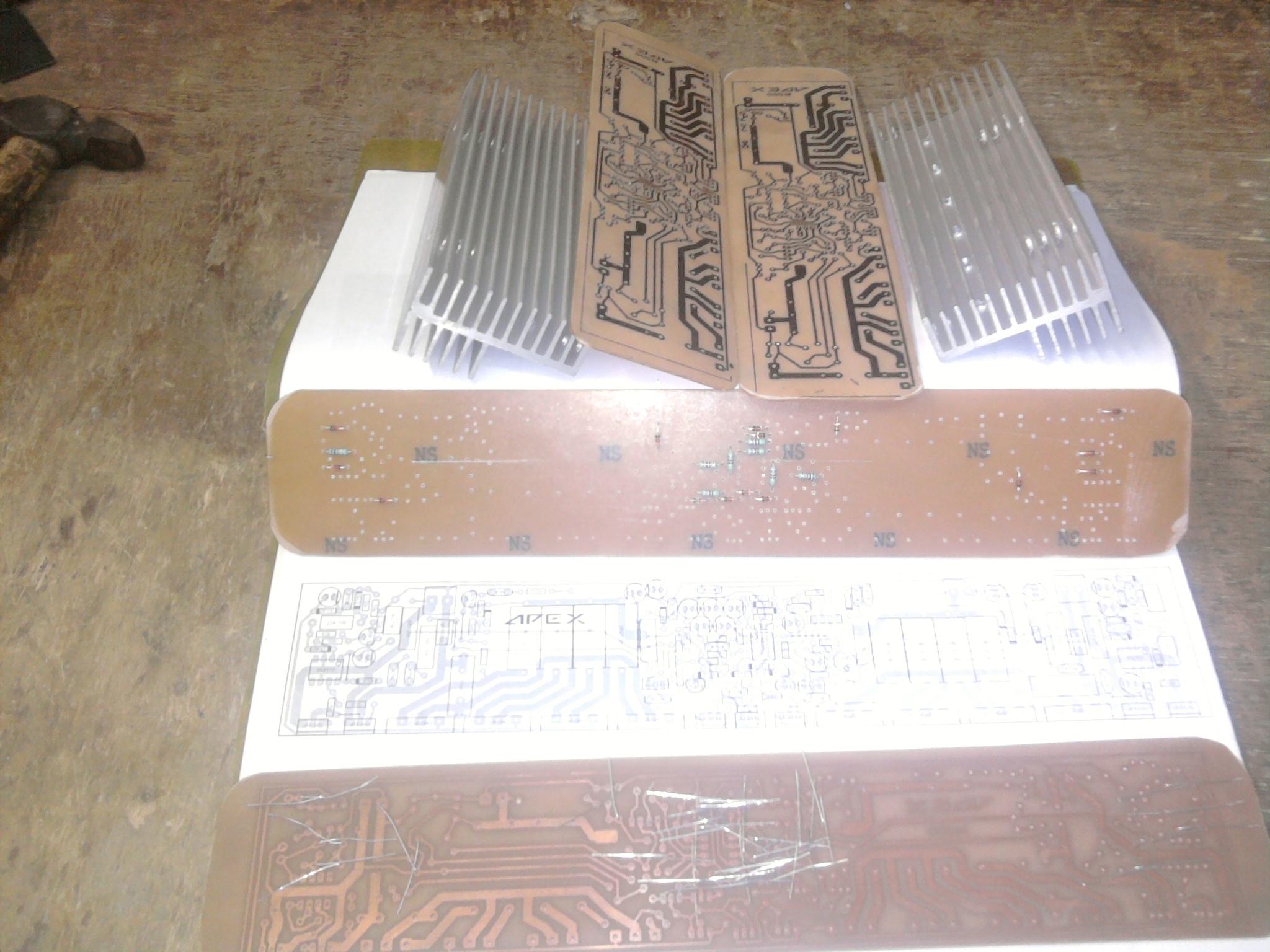

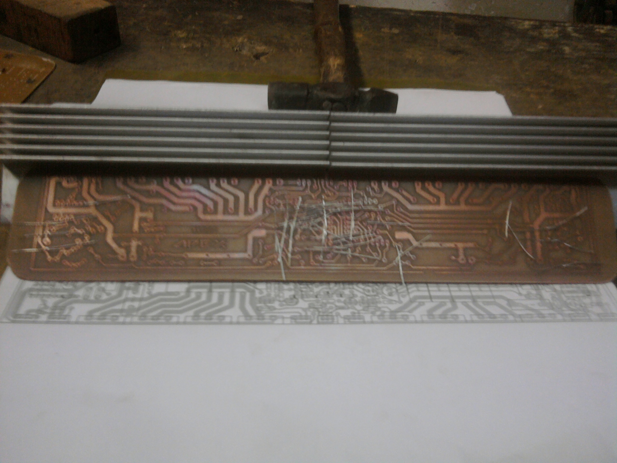

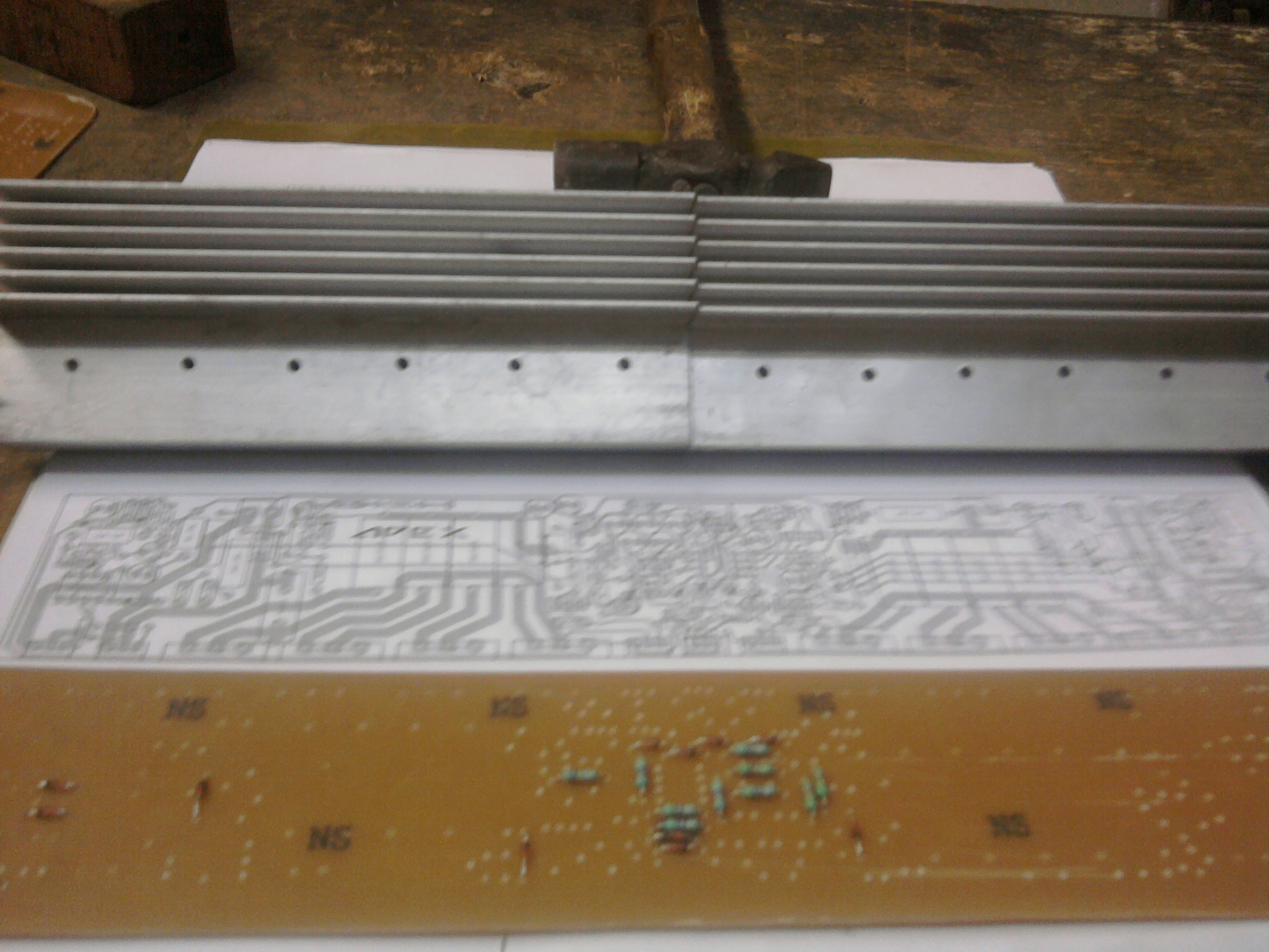

pls chek my h900 PCB,s
pls chek PCB,s ....
nd pls chek heatshink for 2 ohm lord at 55v-110v..????
pls chek PCB,s ....

Use MUR120 instead BAV21. With two fan cooling your heatsink is OK.
