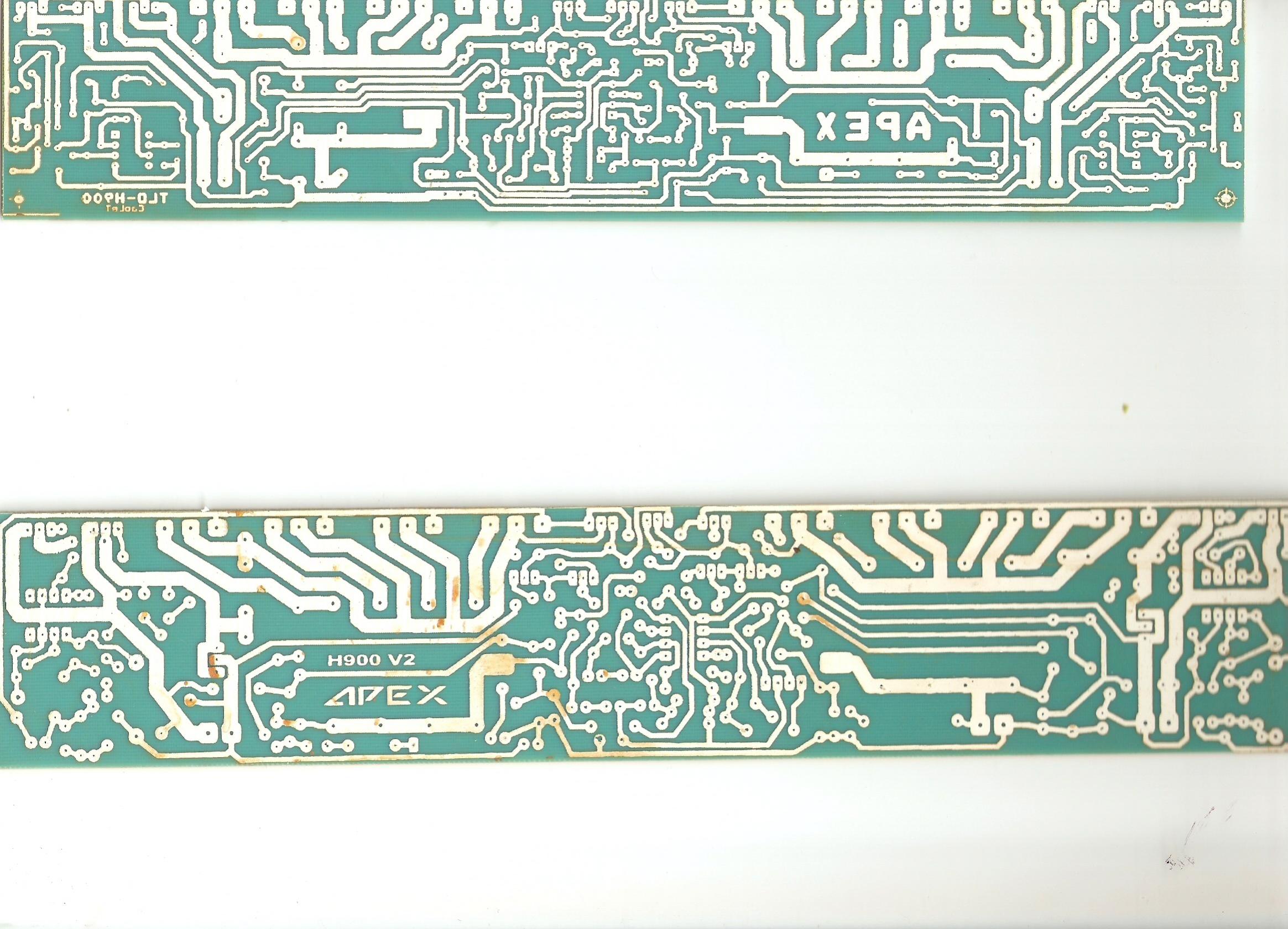

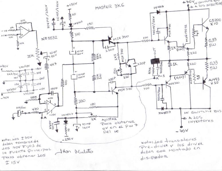

hello sir
sir i found dis schematic .... what u think is dis work????
thanx
There is working 'crest' schematics: Crest Audio
Regards

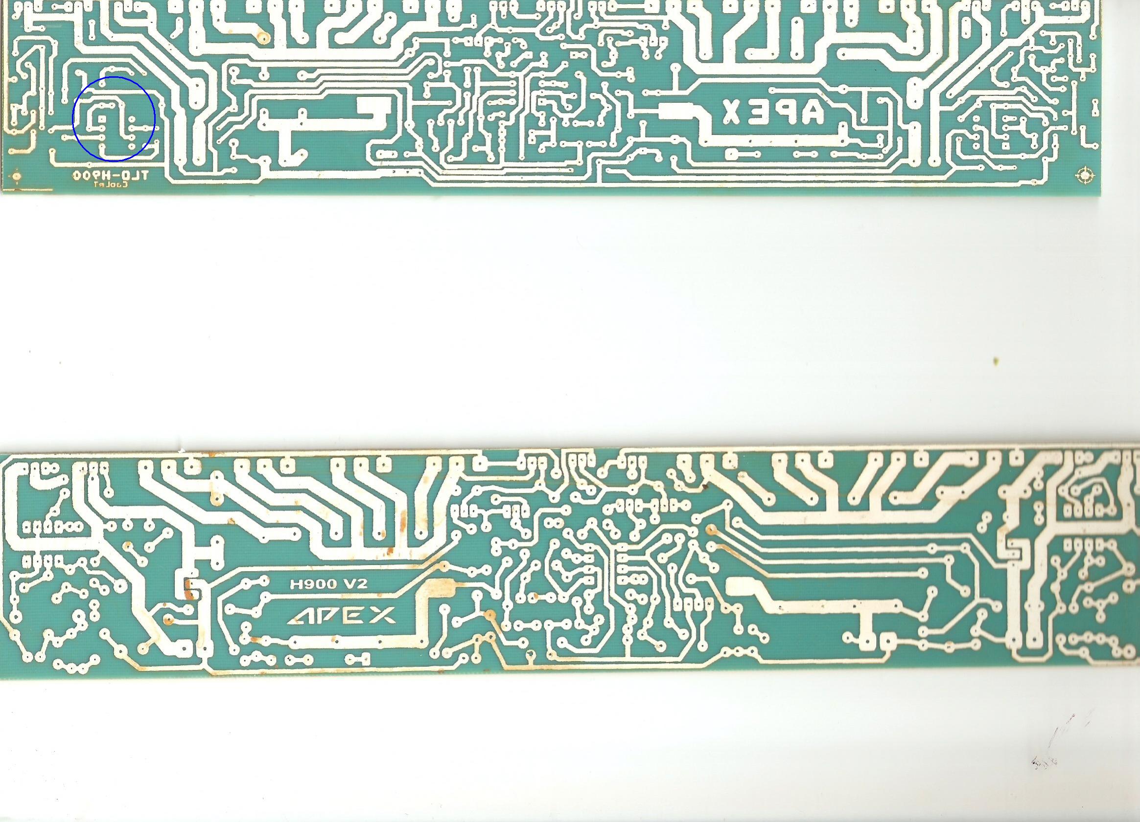

sir apex this is my H900 pcb silkscreen layout ready for chloride bath....
There is coolets H900 version with TL071 step drivers, if you buid it, please share expirience.
Regards

hello sir very nice pcb.pls can u tell how can i make like dis.....???? 🙂🙂
the procedure is just like printing a T shirt with silkscreen i used high quality enamel,,,
there is a modification on this PCB here
http://www.diyaudio.com/forums/solid-state/164208-500w-pa-amplifier-limiter-66.html
post # 659
boggart...there is a modification on this PCB here
post # 659
giusab jud diay bai...
changes were really made...
