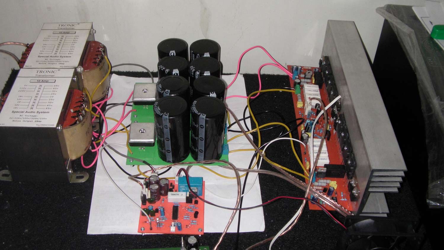

Hi,Mr.Mile
This my H900, in the process of testing, the results were extraordinary.
Thank Mr.Mile!

R86 is 18k/5W, and with +/-70V DC use for R6 and R7 4k7/2W instead 10k/2W, can you post pictures?
