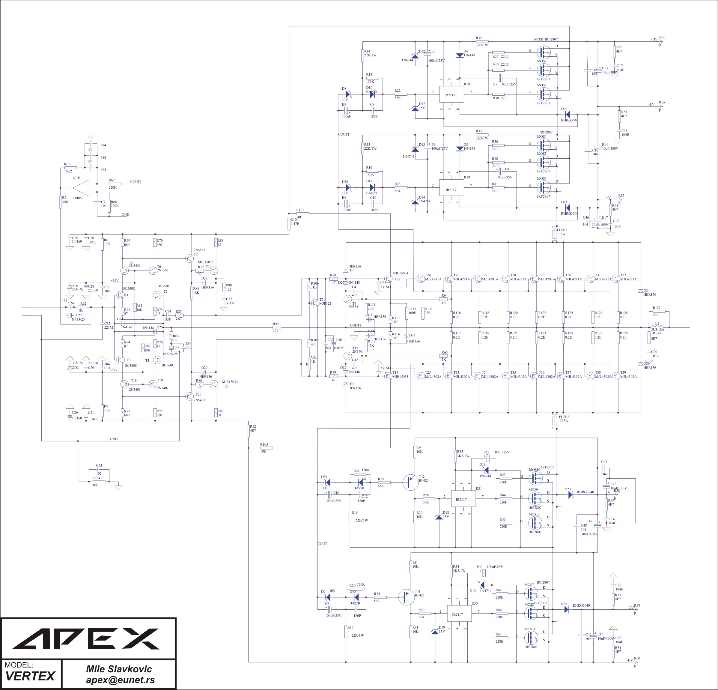

Its strange to see that apex didn't mentioned about the testing procedure of this amp, this is not a simple class-AB in which you feed a signal and music comes at output and kids start enjoying the show, its class-H and you need to make sure the STEP is working.
I want to see what Apex has to say about this, I will input my 2 cents later on.
If you can get higer voltage on amp out than MV, step driver work ;)
Exactly,
But tell the procedure to the guys who don't even have an oscilloscope, all they have is a multimeter.
A simple solution:
Feed a 50-100hz sine at input and measure the voltage at output with your DMM and see its more than Low rail voltage and touching the high rail voltage or near to it. Its just an approximation of its working.
Exactly,
A simple solution:
If clip LED light on, output voltage is higer than low rail voltage.
can u pls tel us in details....?
If you use LED instead NSL32, and run amp with 0,+/-55v,+/-110v rail voltage, LED will light on if you have 95v peak voltage on amp out with high level audio input. With low rail voltage of +/-55v, amp will clip at about 50v output voltage, and LED can't light on if step driver not work and not increase rail to +/-110v at peaks.
vertex
vertex

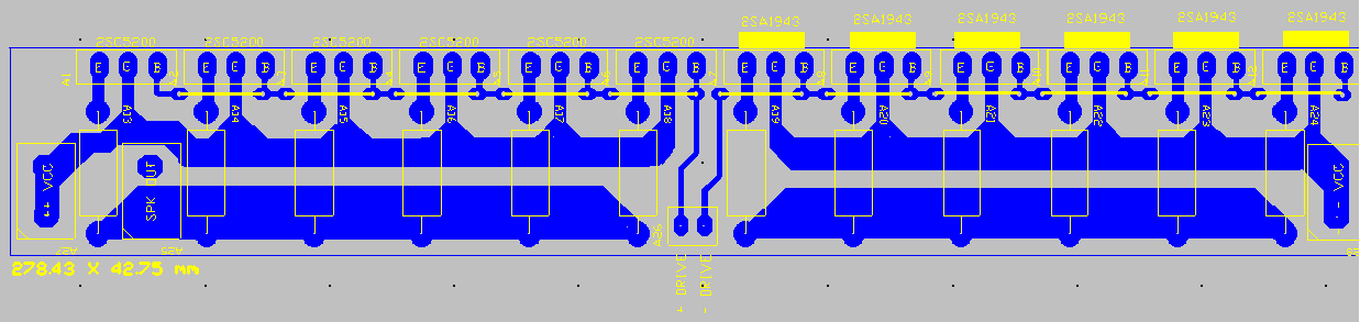

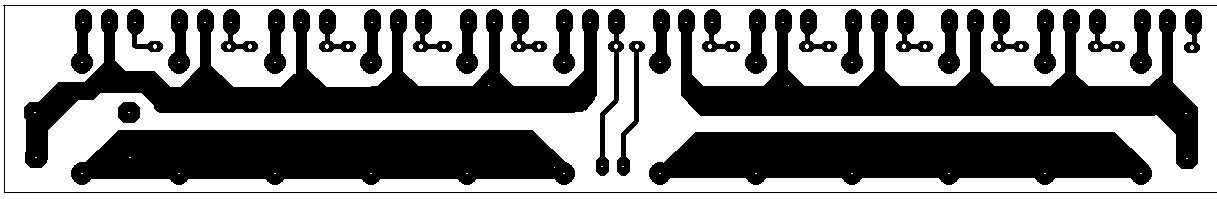

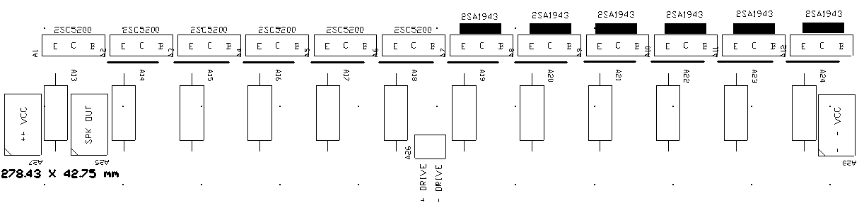

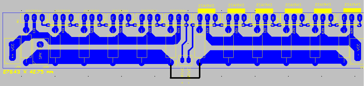

Has any body making H900 ever felt the need of adding more transistors to the output.
so here it is PCB+ LAYOUT to add 6pairs of additional transistor . and this can used for VERTEX also.
regards
Sekhar
