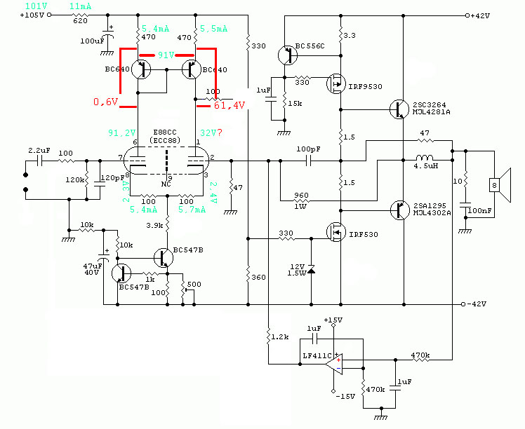

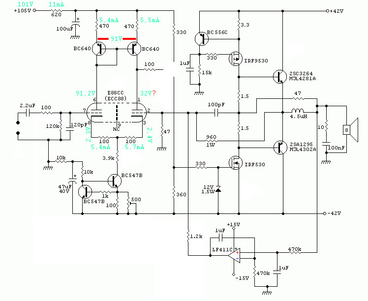

Dont know if i mesure it correct, but, i desolder mje350, and then mesure e88cc,because it burns even two 0,6w resistors:
Even when i change bc640 with place, the same thing happens, first bc 91V, sec 32V.
Without e88cc voltage ~92V and 0. Voltage on 100ohm resistors, below e88cc similar ~-41V.

OK, this look more normal. Now bring back MJE and 960R resistor. There should be some DC voltage on output, but I do not expect 42V.
But look at voltage between collector/emmiter of bc640:
the current mirror tries to match the currents in the two halves. To do this well, the two transistors should be operated at the same temperatures, same currents, same voltages. This requires that YOU match the voltages, i.e. Vce for both transistor should be fairly close, not 61Vce for one and 0.6Vce for the other.
Same for the Long Tail Pair (LTP):
Match the temperatures and currents and voltages in the two halves of the LTP.
