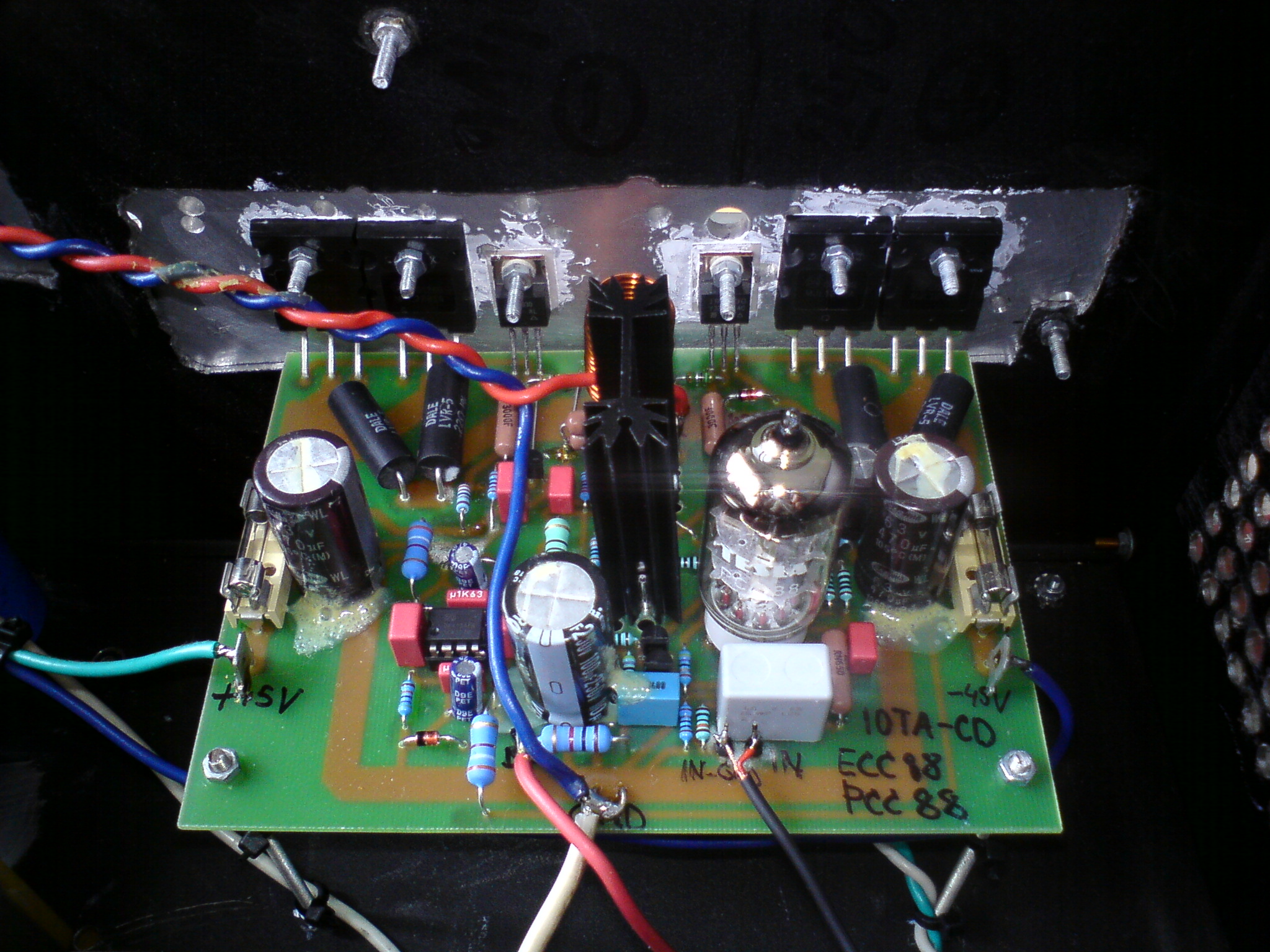

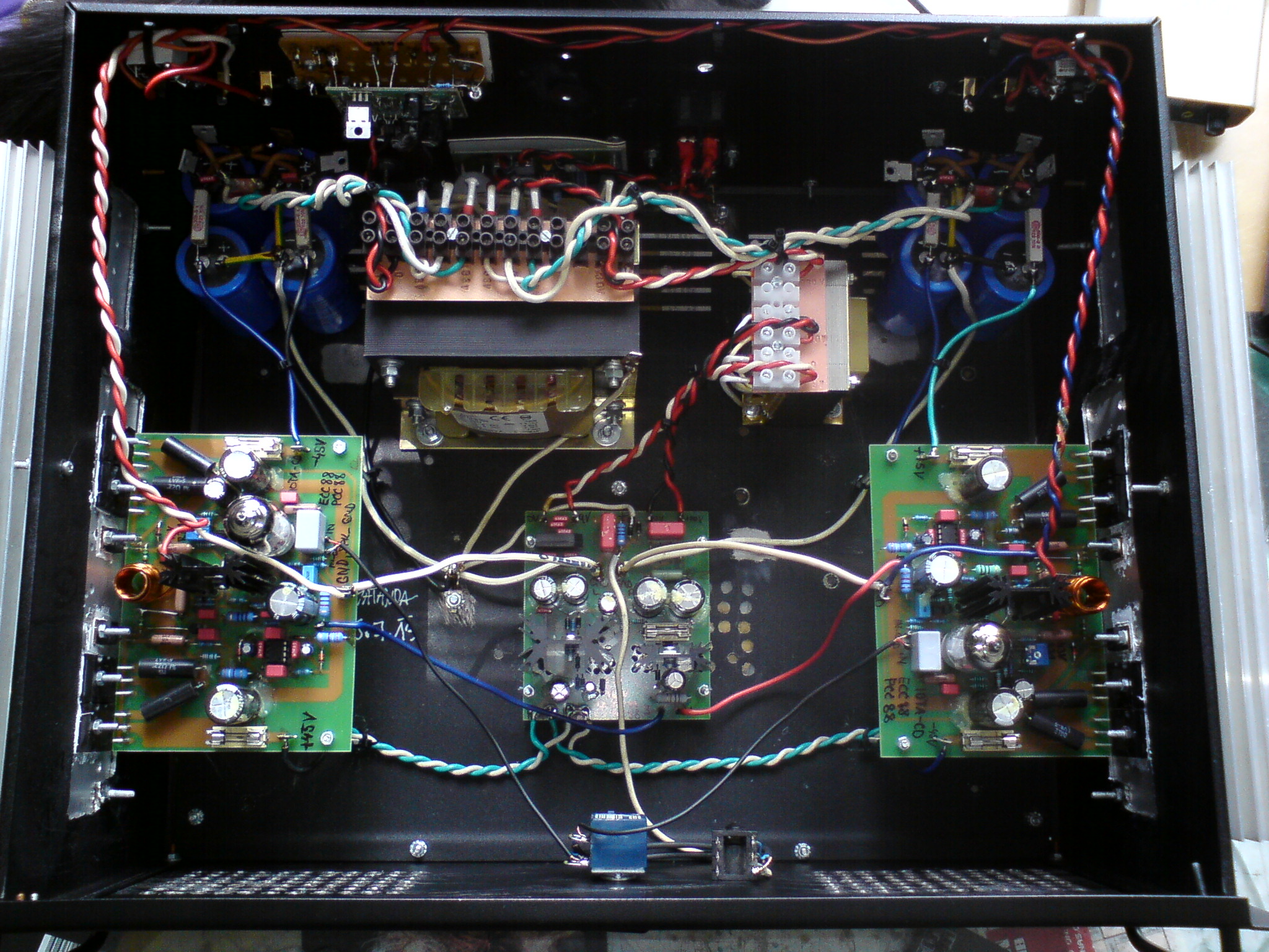

IOTA-CD finally built
Today, I have finished my IOTA-CD build. I have used the same components and rail voltages as in my DOGC-H build.
For input tube I am using Tesla PCC88. Amplifier works very well, no hum, buzz etc.
Now for the sound difference betwen DOGC-H (mosfet input) and IOTA-CD (tube input).
There is definately a difference, not night and day, but it is there.
IOTA-CD is warmer, soundstage seems to be wider and deeper, smoother.
DOGC-H is tighter, punchier, colder in the mids, maybe little more detailed.
Differences are really quite small. Both amplifiers sounds superb to me. It is just matter of taste / flavor.

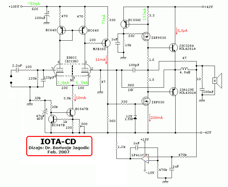

Hi ppl 🙂
I have a problem with this amplifier, i cant turn it on.
I have large dc out -42V, all negative supply, and the MJE350 drawn about 71mA of current, and it smokes 620ohm resistor on HV supply, resistors are like on the schematic.
And what works:
Current on E88cc can be adjusted from 7,6mA-9,2mA, on IRF9530/530 i have 193mA, 3,3ohm resistor. I desoldered the power transistors, they look like good, i can mesure them, so are MJE, IRF. And dont know what to think about it. I soldered both channels, same symptom.
Opamp voltage +-12V tl071.
Dont know what i can say more ....

Something is bad around differential amplifier.
I have built this amplfiier too. In comparison to DOGC-MK3 or DOGC-H which uses MOSFET differential input, the sound difference is very small. So if you wont find the mistake you can built mosfet one, sounds equally good and is easier to built.
Bad tube maybe. Check grid, cathode, and anode voltage. Anode voltage should be around 75-85V, and grid voltage about 2V lower than cathode voltage. Anode currents should be equal too, check BC640.
looks like you should get +42 v until tube is heated.
it's a poor design.
high side and low side should both be off if tube is not heated
Your MJE 350 may be bad as it should be off until tube is heated
collector and emitter current should be almost exactly the same
it's a poor design.
Just another question: What's the purpose of these lowish values of both the NFB resistors? Hey, it's a tube amplifier, regarding the LTP, and these values can easily be 10 to 20 times as high!

It is part of the bridge network, which is needed by current dumping technique to work properly.
