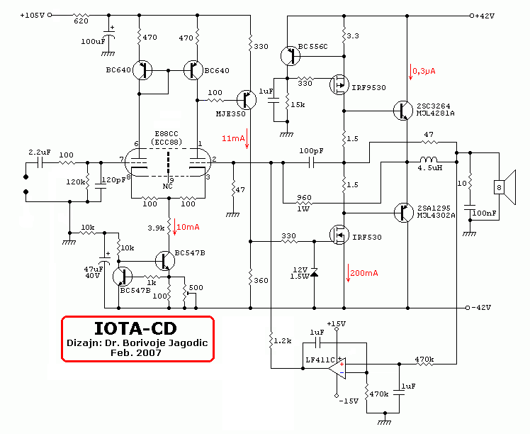

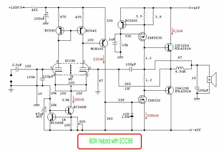

Hi all !
I have this hybrid amplifier schematic with the ECC88.
So look for help with this amplifier.
Comments about this seed and the hybrid amplifiers?

There is nothing to be further developed regarding this one! Design is fully functional, built and presented before 50+ audiences on last audiophile-meeting in Kragujevac on 03 of May 2014. Amp attracted significant attention for beautiful, transparent, precise and natural sound.

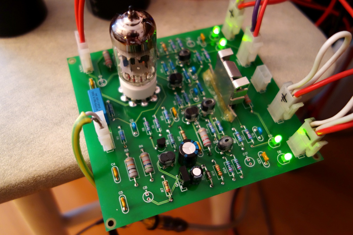

Hi Vostro, see my hybrid front-end project here - Low TIM, low distortion hybrid front-end - maybe this is something you are looking for. It is fully prototyped, tested and documented.
It may be successfully used with a number of power sections, one of then is shown there in my thread, the other good option is Ostripper's Slewmonster.
More detailed measurements are available here - Measurements - Hybrid with tube
Listening impressions will be available over the weekend, though - no doubts - they don't promise to be bad
Terry (still4given) will have some spare PCBs for this design.

Can you please tell me what is the gain of the amplifier and how much feedback does it use?

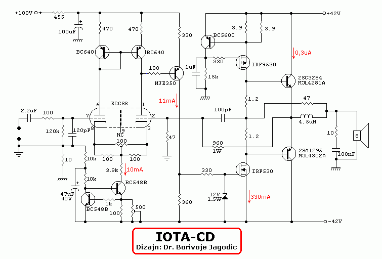

If you are looking at post 5...
I also interpret the schematic as you do, the LTP drives the BJT MJ350 who's sole purpose is to voltage shift the signal from the high voltage front end to the lower voltage output stage. The IRF530 is the VAS and operates with a CCS load to provide a Class A amplifier driving the load through a small 47R resistor. Then the power BJTs provide a Class B/C stage driving the load through the output inductor. The inherent distortion of the BJT power stage is compensated for by the Class A stage using feedforward. Pretty neat altogether.
