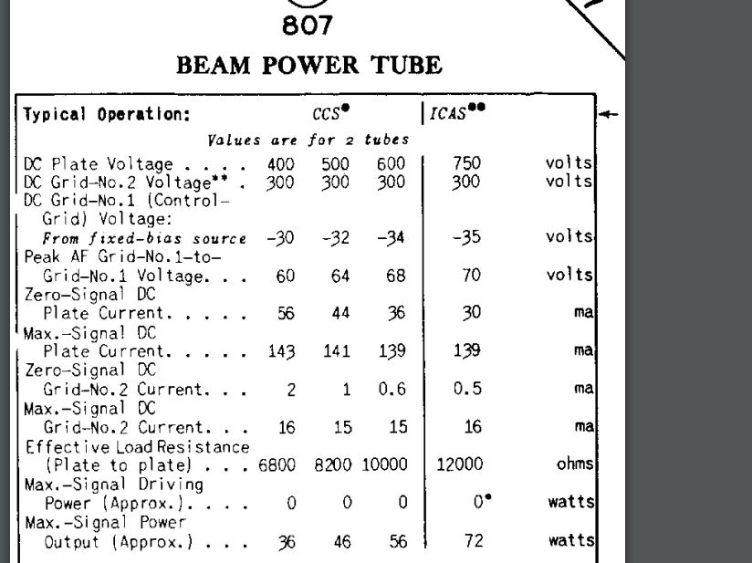

It is a matter of their current capability. If g2 current is small, just naked VR may be sufficient. This is exactly the case of 807 run at extreme plate voltages. Maximum g2 current for a PP pair at 750 V plate and 120 W output in AB2 is 20 mA, well within the limits of octal VRs. In AB1, a string of VRs may have enough current for four 807 screens.

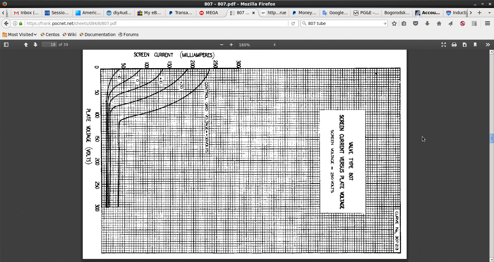

Quick calculation. In tabulated AB2 operation at 750 V, control grids swing 13 V positive at the peak output power of 120 W. Static current draw at Ug1=+13 V, Ug2=250V, and Ua=750V is about 350 mA, and corresponding Rp is 2.1 K. With single tube plate load of 3.6 K (half the optimal P-P load), plate voltage is (750x2.1)🙁2.1+3.6)=276 V. Now, looking at the graph in your post, at Ug1=+13 V, Ua=276 V, and Ug2=250 V, screen current is ~10 mA. So, at maximum signal swing, the tube is very far away from collapse.
What limits output power is not plate voltage swinging too low, but 120 mA steady current capability of the tube (240 mA at maximum power for the pair).
Allowable cathode current limiting power output in AB2 can be seen in data sheets of other power pentodes. For example, the similar 1624 has Ikmax of 90 mA, so power output is limited by 180 mA current draw of the PP pair.

Anatoly - I am reading over again through your post, trying to reconcile what you are saying with the posted graph. If you are talking about tube collapse as exhaustion of its current capability, then there is no daylight between our points. But if you argue that momentary screen current may become excessive at signal peaks, my previous post shows that cathode current capability is exhausted way before screen current becomes excessive.
I am talking about screen grid current peak that extinguishes the VR tube that needs higher voltage to ignite than to glow. You can't have more than 30 - 40 mA current through a VR tube. That means, as soon as screen grid current exceeds this value you are getting nasty distortions. That's why a source (or cathode follower) is needed to power screen grids.
https://frank.pocnet.net/sheets/137/0/0B3.pdf

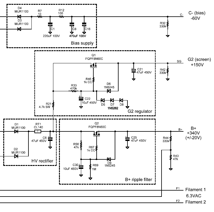

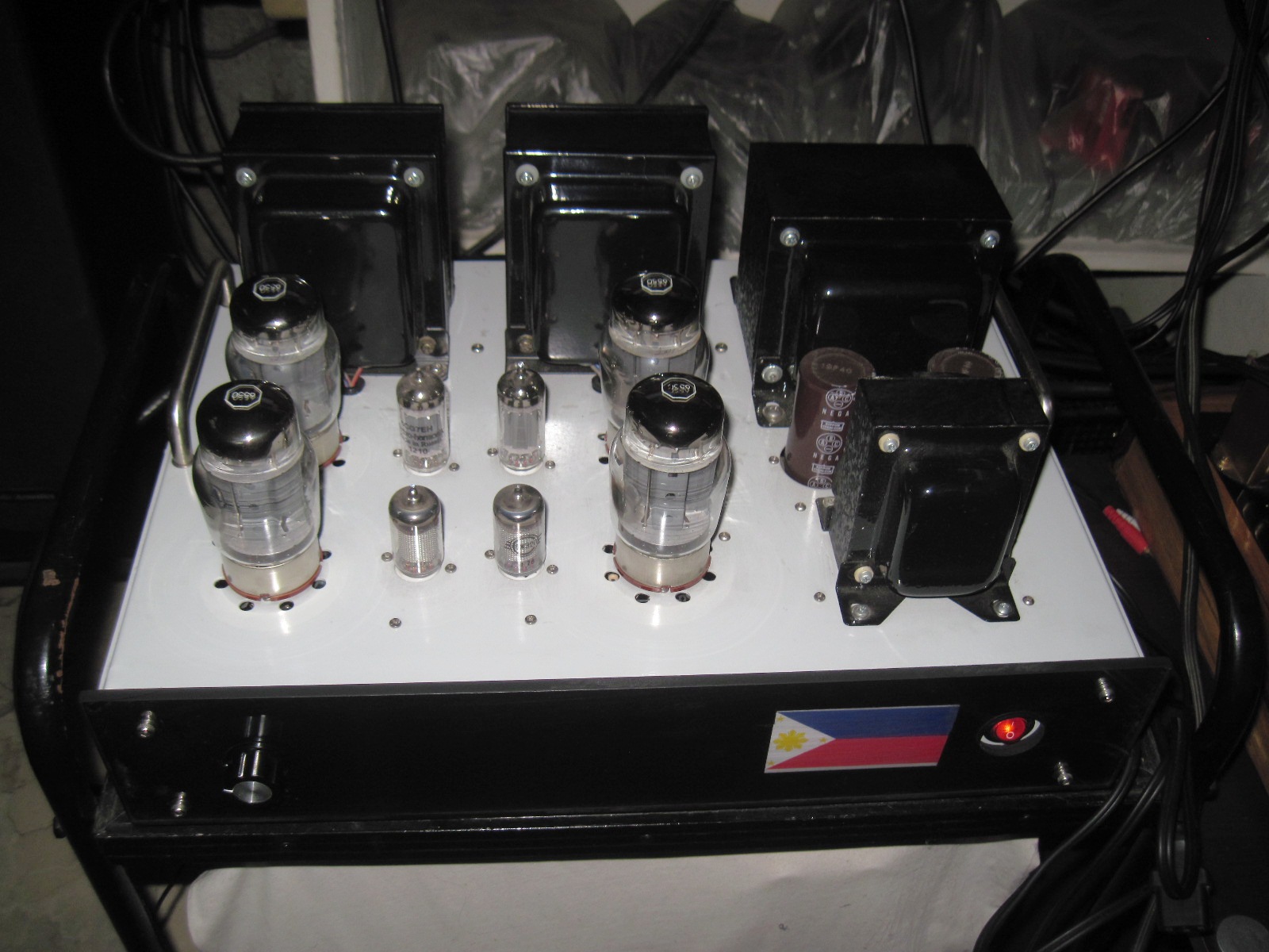

this is a 6550 pp amp that i made using mosfet regulated G2 supply....the owner was very happy....

Let me reveal one more secret: in my amps with 800V B+ and 270V G2 I use G2 current to control anti-clipping input optical attenuator. ;-)
Schematic?
Joking apart, cathode follower after VR tube will solve current problem only to the extent of its own current limitation. That is, for 100 mA current capability, the follower has to run at 100 mA idle current or more. 30 mA of VR tube is plenty of current.

Schematic?
the series device, mosfet follower or cathode follower will pass the zero signal G2 current,this is its idle current. also passes the maximum signal G2 currents...
