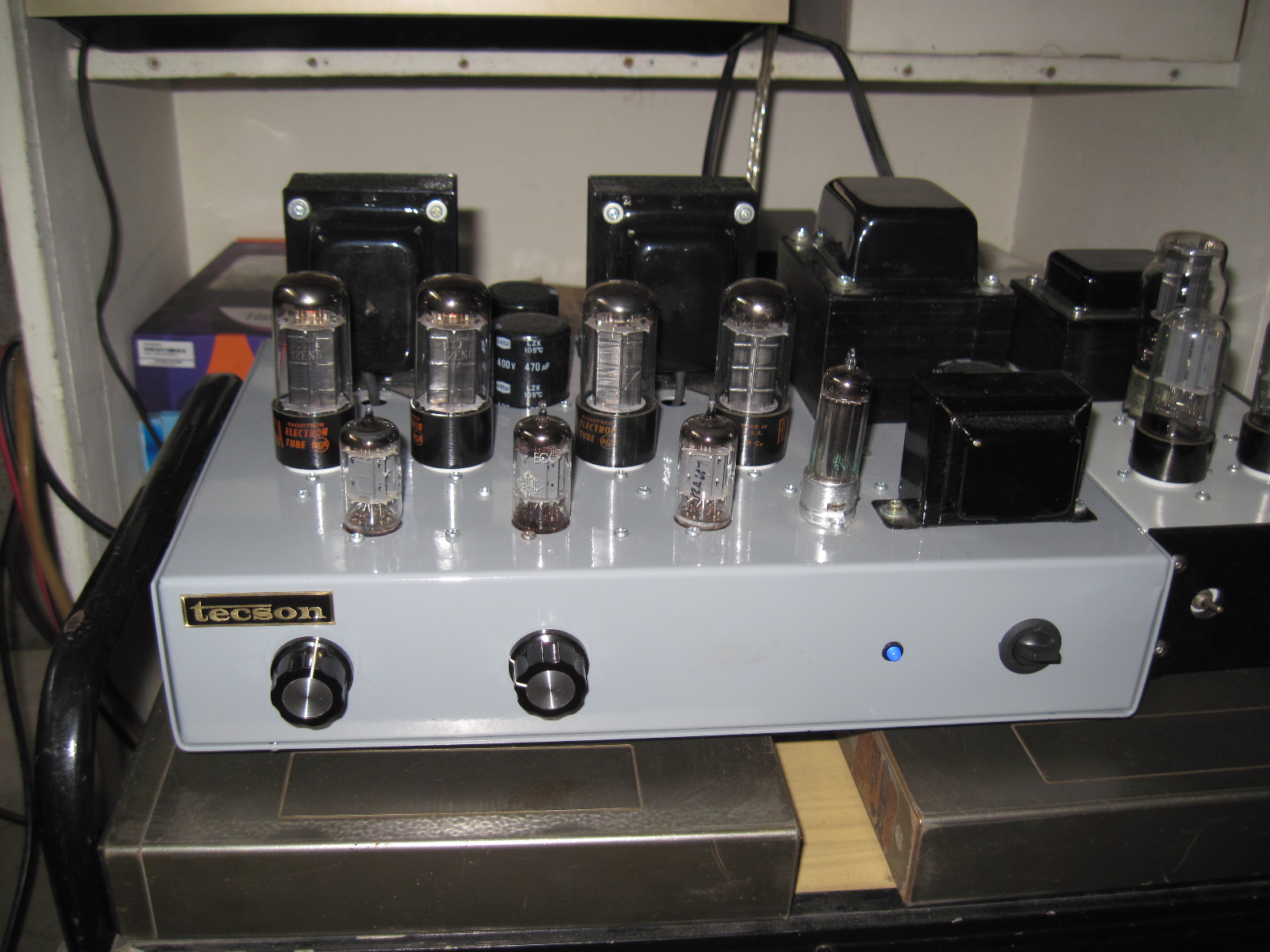

but we are talking 807... when i design, i want to have some leeway for things like mains voltage droops and such....
i have also done a single reg on 4 G2's....

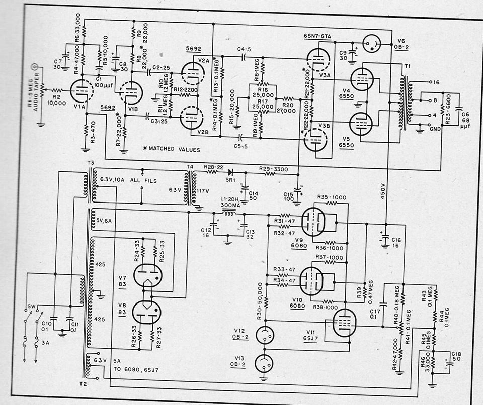

I am out, sorry... PLEASE CLICK HERE TO OPEN THE DATASHEET! - during 2 pages you are arguing about irrelevant topics instead of trying to understand the mistake of powering G2 from a parametric stabilizer with VR tube.
i´ve seen parallel gas-stabs strings in rf amps, each had voltage balancing resistors
fet follie is better..
It would be fine in case of parallel stab Zener, but a VR tube unfortunately has higher ignition voltage than one than it stabilizes when glows, so the follower is the must when powering grids of output tubes in power amps.

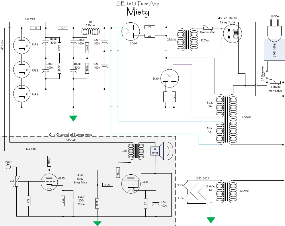

I get it. One thing I don't understand is what's the big deal about VR tube extinguishing. Once it stops conducting, the circuits simply reverts to screen supply via voltage dropping resistor until VR ignites again.
I'm not sure if this matters, but I read that a VR tube going off then igniting repeatedly is not good for their longevity... plus ignition does take a split second or so...enough to be heard in the music.
I have VR regulation in the last amp I made, and there is a definite difference with or without the VR tube ignited...so I'm guessing it won't sound the best upon re-ignition.
I am using the VR tubes to regulate the pre-amp tubes on the last design I made.
I know it is triode SE strapped, but maybe something similar can be used for G2 regulation... I wonder if a thyratron such as a 2050 could be used some how... it can pass more current than VR's and is a diode...
Then again...maybe scrap that idea until I try it out...
I am not arguing that extinguishing and re-ignition of a VR tube is a benign thing. If it happens, it is horrible. If it was about a guitar amp that is on purpose driven into distortion, this is a real issue that would justify over-complicated g2 supply.
But we are talking about hifi amplifier whose 120 W is a reserve to insure lowest possible distortion at its normal use level of 5 W. Even at 120 W, g2 current of four 807 tubes will not exceed the capability on one VR tube set at 40 mA idle, and there will be no extinguishing. 115 W is more than sufficient reserve for any music signal spike contingency.
Anything can be driven into horrific distortion, even an amplifier with active g2 regulation. Just ramp up the input far enough.
